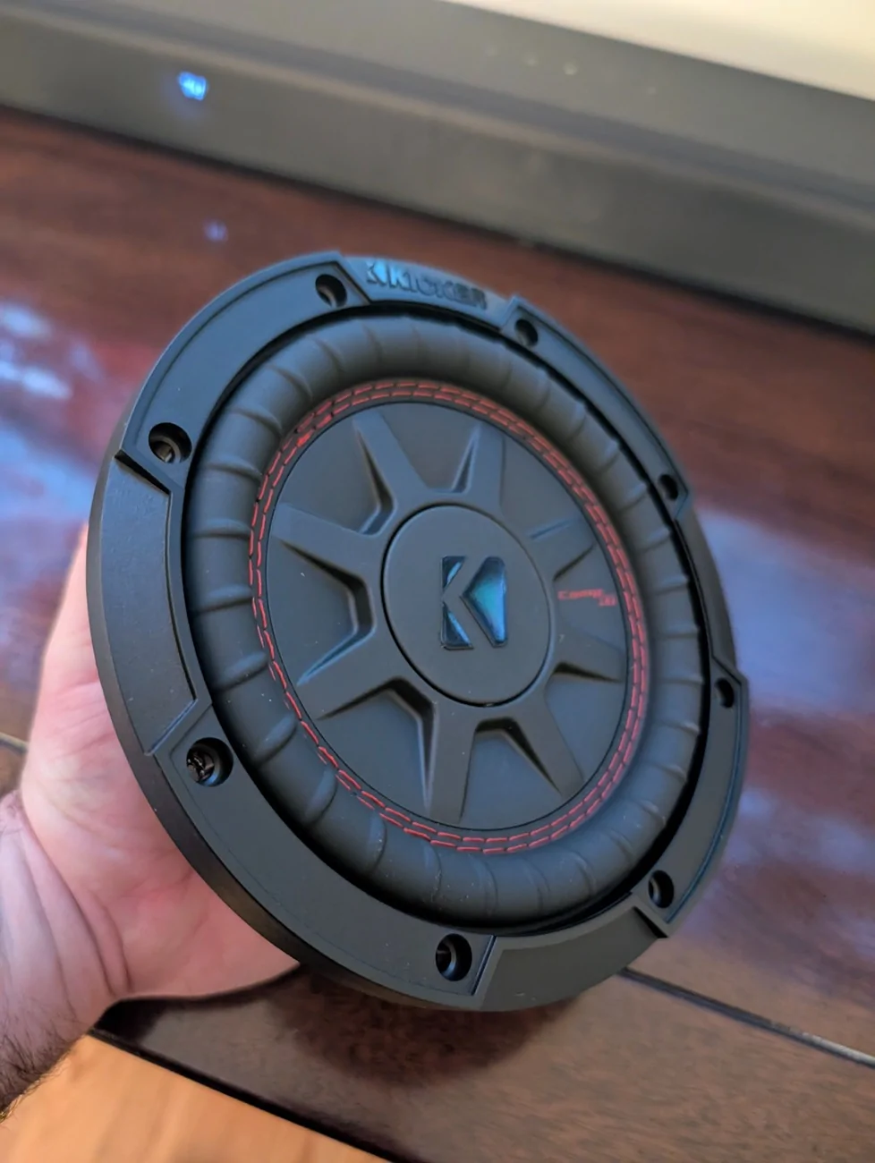

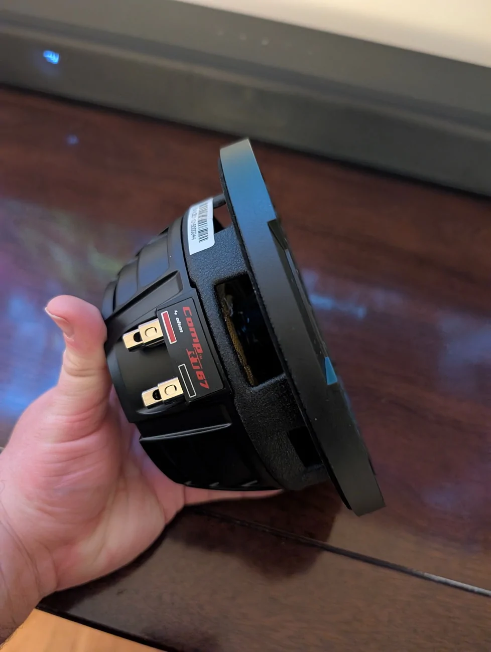

I may be crazy, and please tell me if I am, but I plan on removing the current stock B&O subwoofer "box" and designing a replacement I can 3D print out of ABS-GF plastic. I have a 3D scanner, so I am going to try and design one that will fit in the same area and use the same mounting points and have the optimal volume according to the which sub I intend to use. I am considering either the Kicker 48CWRT67 or a Kicker 48CWRT8, in 4ohm, using the stock amp.

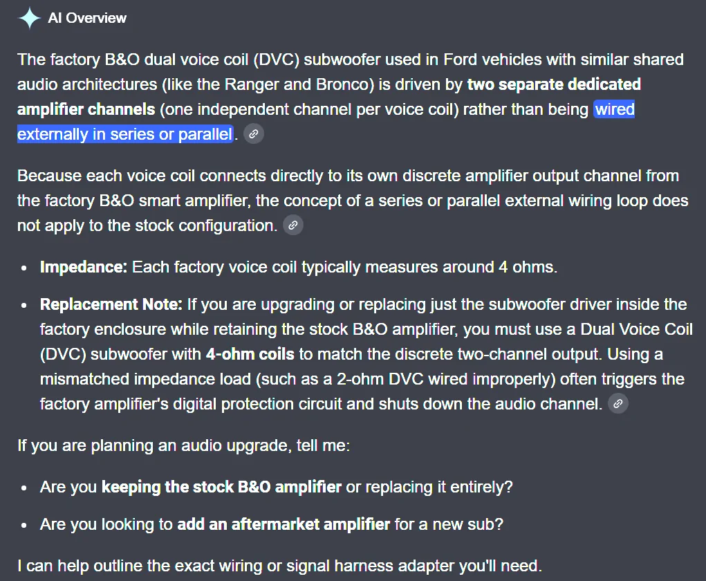

-Should I design a sealed or ported box?
-What wattage does the B&O amp provide to the stock subwoofer?
-What ohm rating is the stock dual voice coil subwoofer?
-Does anyone have any suggestions on how I should wire either of the Kicker subs I am considering?
-Of the two options I am looking at, should I do the 6.75" or 8"?
-Can anyone confirm that this AI provided info is correct?
