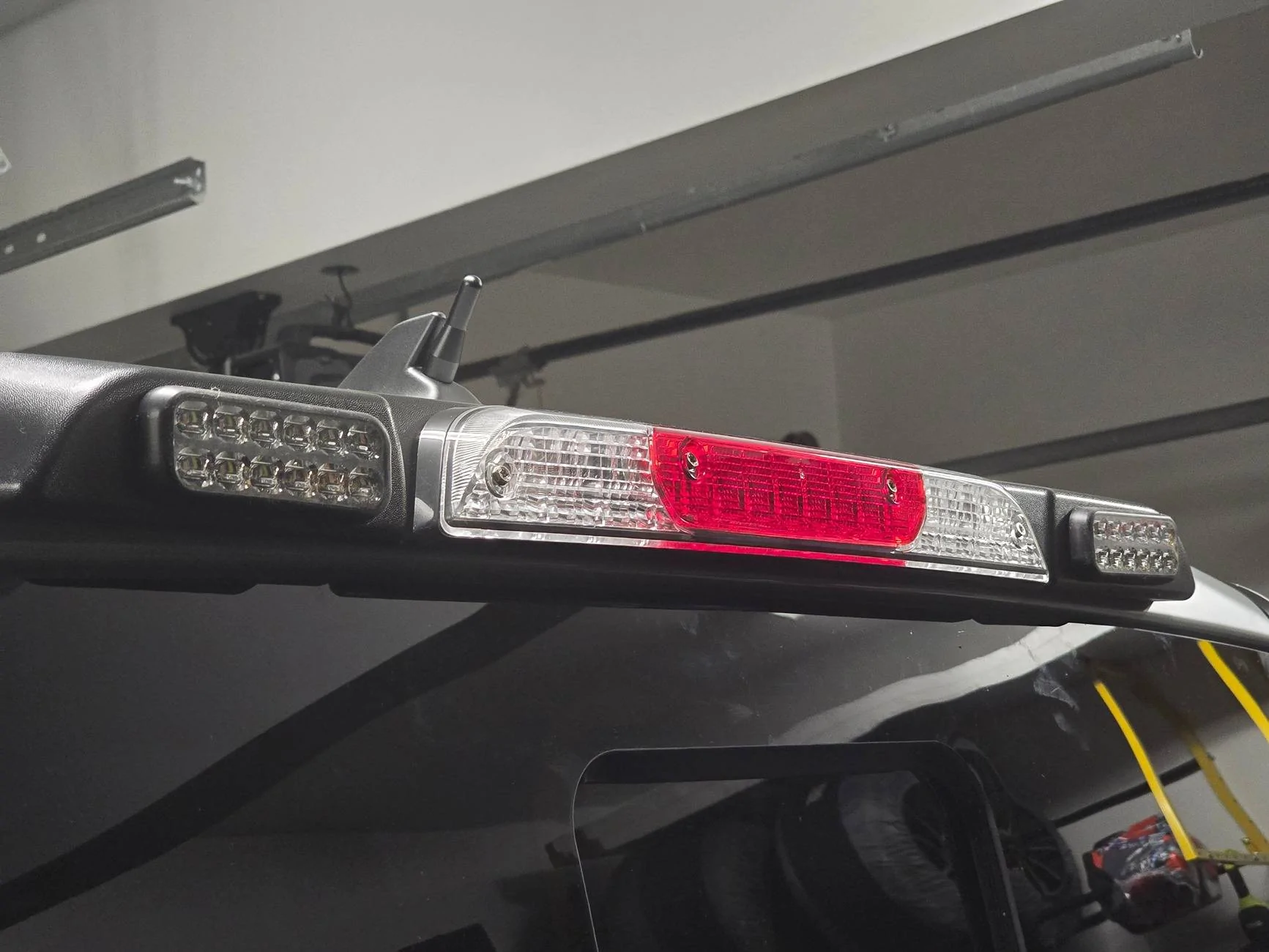

Should fit just fine. Post some pics here or a new thread when you get it installed. I have the GJ waiting to be installed at my house as soon as I get home from this work trip in a couple weeks.

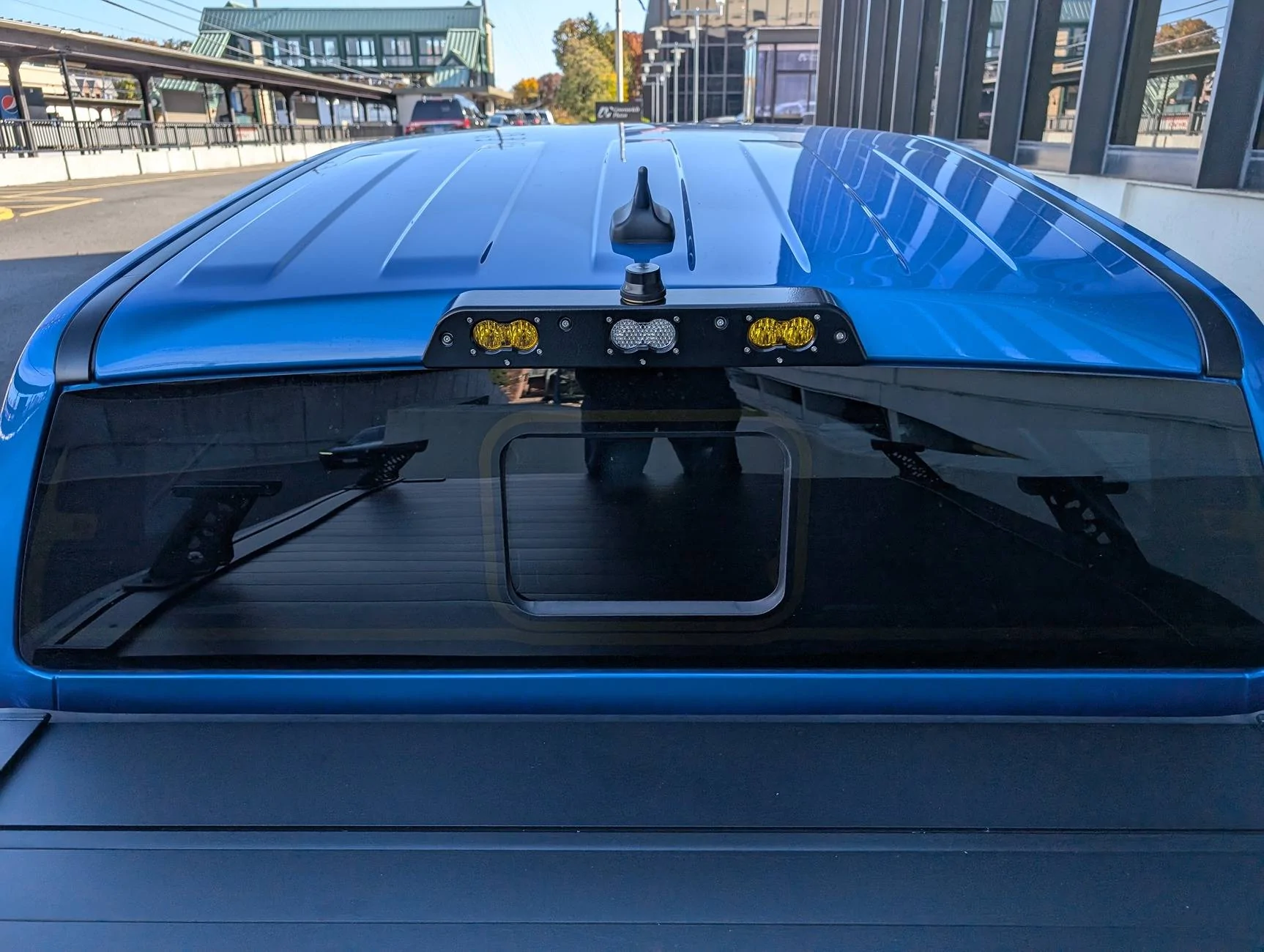

It'll probably be a few weeks before I get it delivered and a few more weeks before I get time to install it. But I'll definitely come back and post how it went.
Funny enough, once they released their "interior chase lights" the reps started saying that I should get the interior chase light for the ranger and the exterior one for the F150 only. But I'm pretty sure it'll fit.

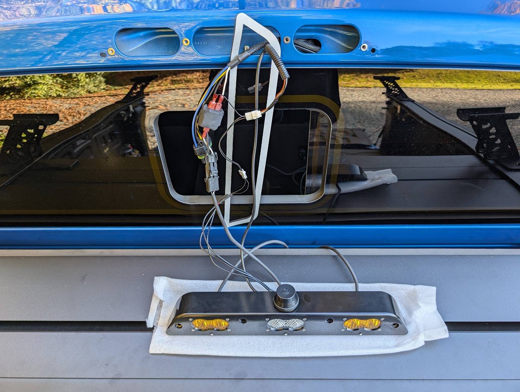

I haven't hooked up the wiring yet. This was intended to be a test fit and one of the plastic screw clips on the ranger decided to break and start spinning, at which point I said F it and pushed the wire through and routed it into the cabin.
This is how it fits. Flush in the back and gaskets make contact with the cab. However the top parts on both sides slightly sit above the cab.
Wind noise problems? I have STEK over the entirety of my truck, else I'd have tried melting the plastic down / softening with a heat gun on the sides. Alternative is strong double sided mounting tape on just the sides and press down the plastic onto the truck.
While I don't think it will leak, I'm also thinking about sticking some rtv silicone sealant in the forward facing gaps on those side/top areas and then covering it with some clear gorilla waterproofing tape just to be extra safe.
Thoughts? Ideas?
Thoughts? Ideas?
Edit: pictures not going through. I'll update asap
One Pic for now -
That’s a bummer it doesn’t sit 100% right. I probably wouldn’t be super worried about it leaking but I would want to close up the gaps somehow. Silicon might be your best bet for that like you had said.

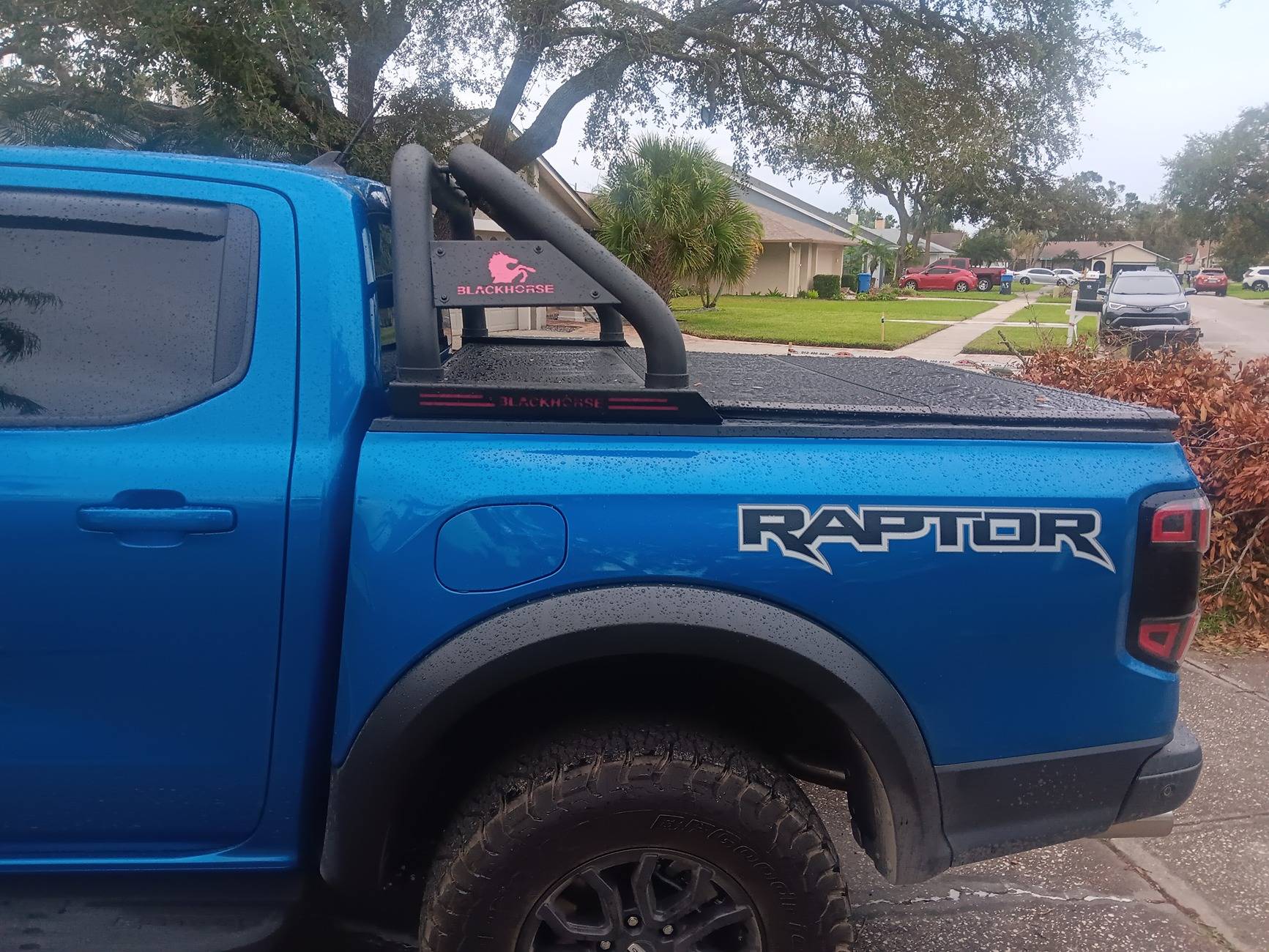

Wanting to get chase lights for my RR preferably ones for the 3rd brake light area like the ones RPG, GJ Motorsports or Bulletproof Diesel offer. Anyone know if any of those will fit or any other options?
I bought a blackhorse that is tonneau cover compatible and run the 3rd brake light wire down to the frame all the Way back to the left rear light where the harness plug is and tapped in the brake light wire and covered it in wire loom then secured it to the frame harness

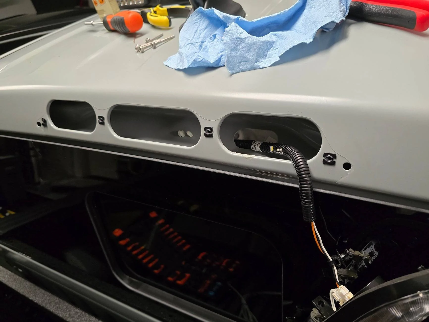

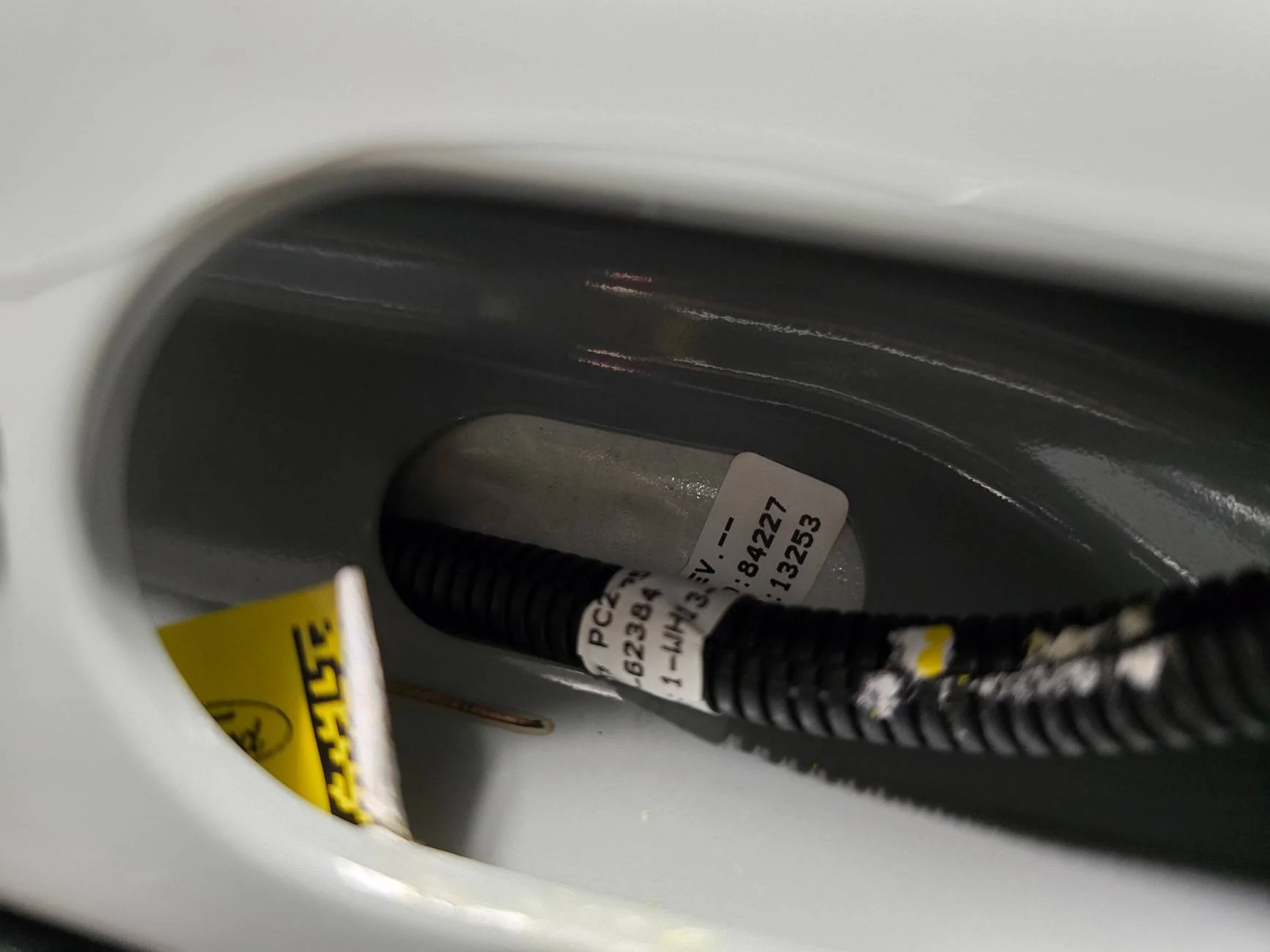

I did mine today. I ended up using the open space where the 3 holes are behind the brake light to run my wires into the cab instead of inside under the headliner. I couldn’t get the wires through for the life of me when I put them through wire the brake light harness comes out
I tried that space first and couldn't figure out where exactly it connected to the inside of the cab, so I went this route instead.
