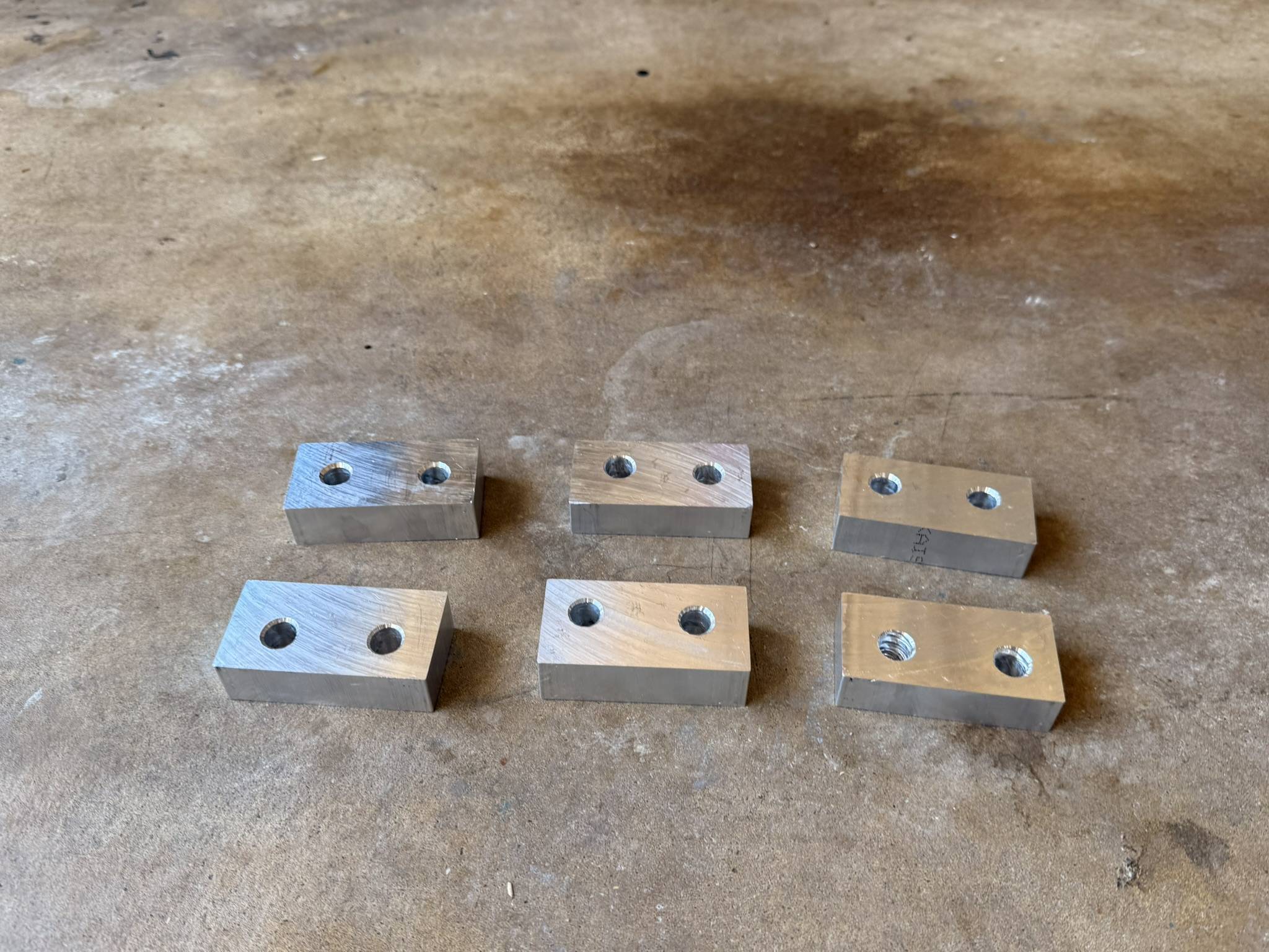

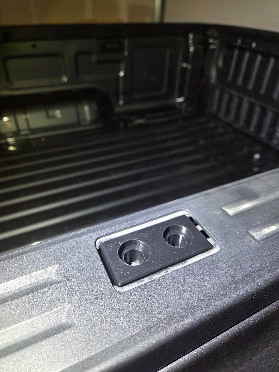

I have a block of delrin on the way that I plan to make my own stake pocket spacer from.
I agree. You can push the moldings down 1/2" with just finger pressure near the pockets. It would bend the T slot rails on the elevate rack the first time you put any substantial weight on it. The spacers are a good idea. The block you have coming big enough for two sets? Lol
There might be enough material for a competent and thoughtful machinist to squeeze out 12 spacers, but unfortunately I am none of those things and will likely hack up the first 2 pretty bad before I figure out what I'm doing.
LOL! I ordered a block of Delrin last night. All I have is a band saw and drill press so not sure what I can do with that. Might try to see if one of the guys at work can do it for me.

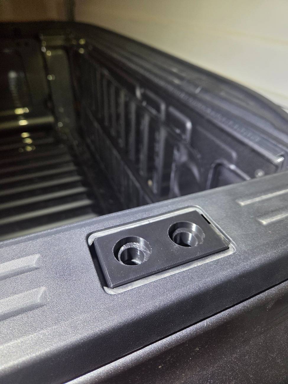

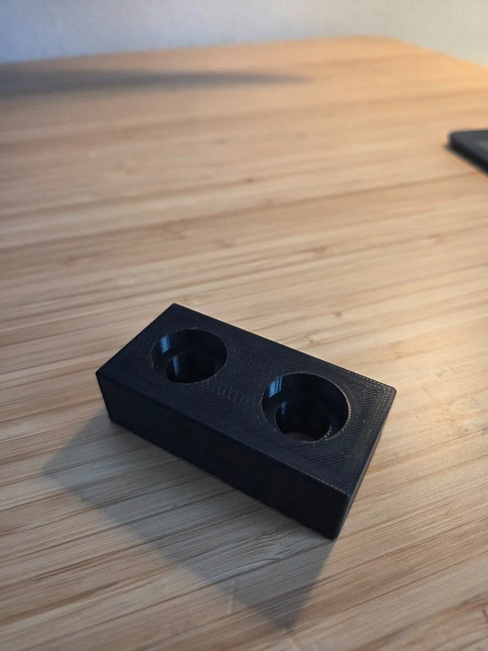

I created and 3d printed my own out of ASA filament. Only time will tell how durable they will be, but they feel solid. They were printed at 100% infill. If anyone want's the STL files let me know and I can send them your way.

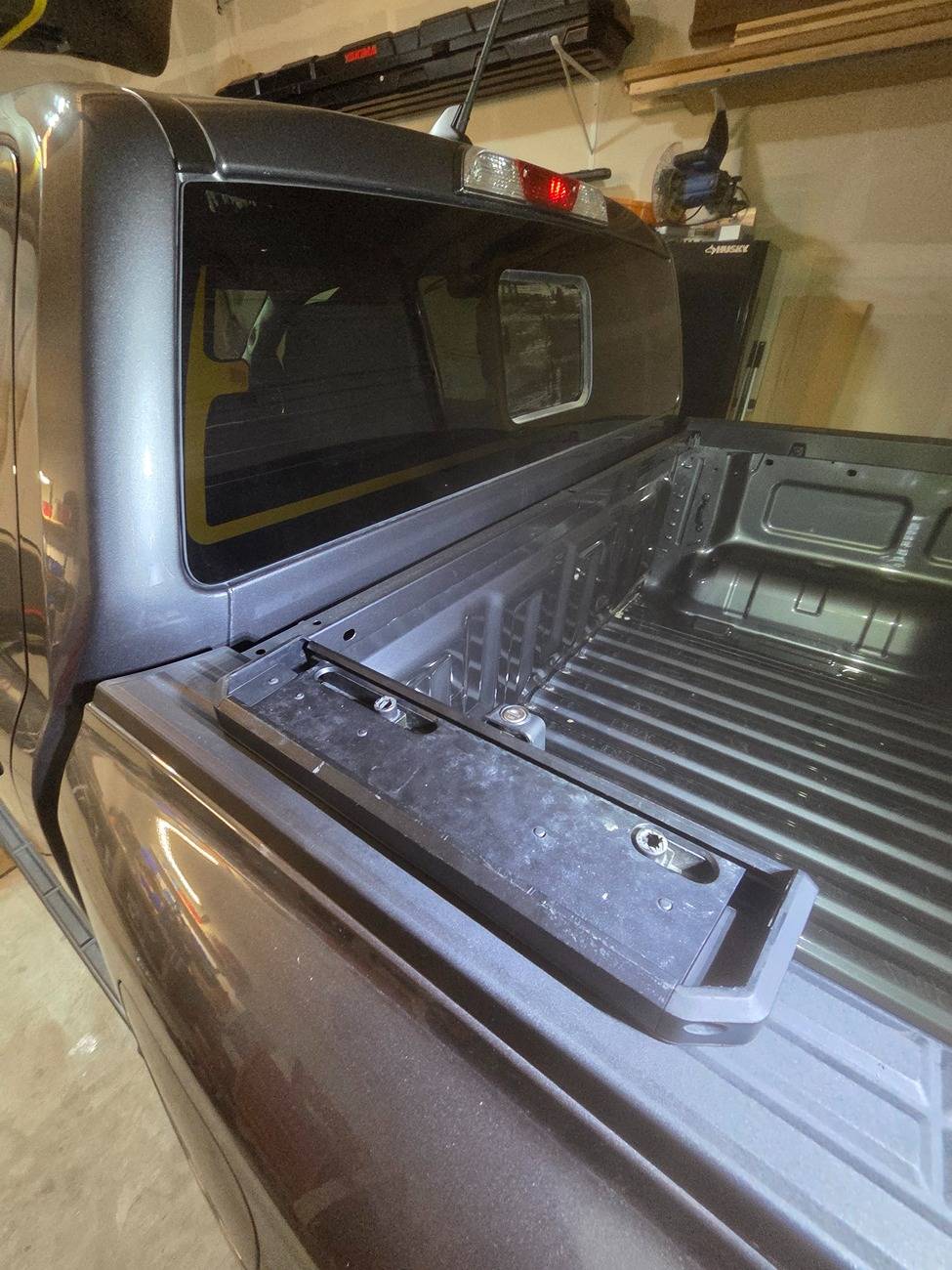

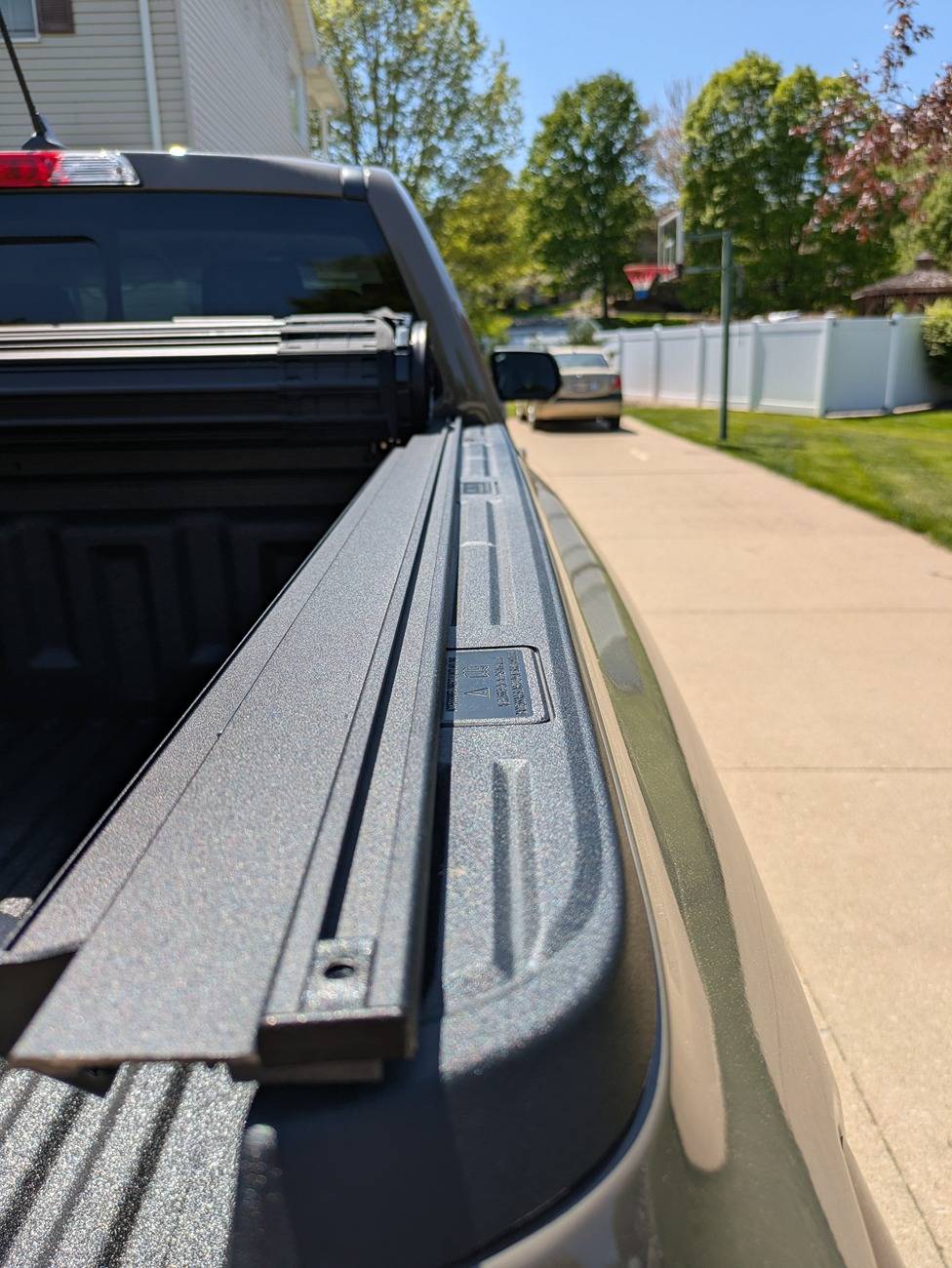

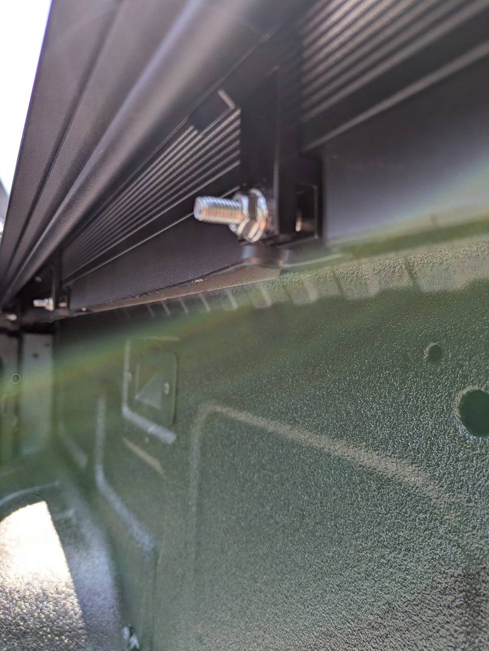

I don't yet have a rack, but I did manage to grab a couple of pictures of how the BAK Revolver X4TS installs in the 2025.

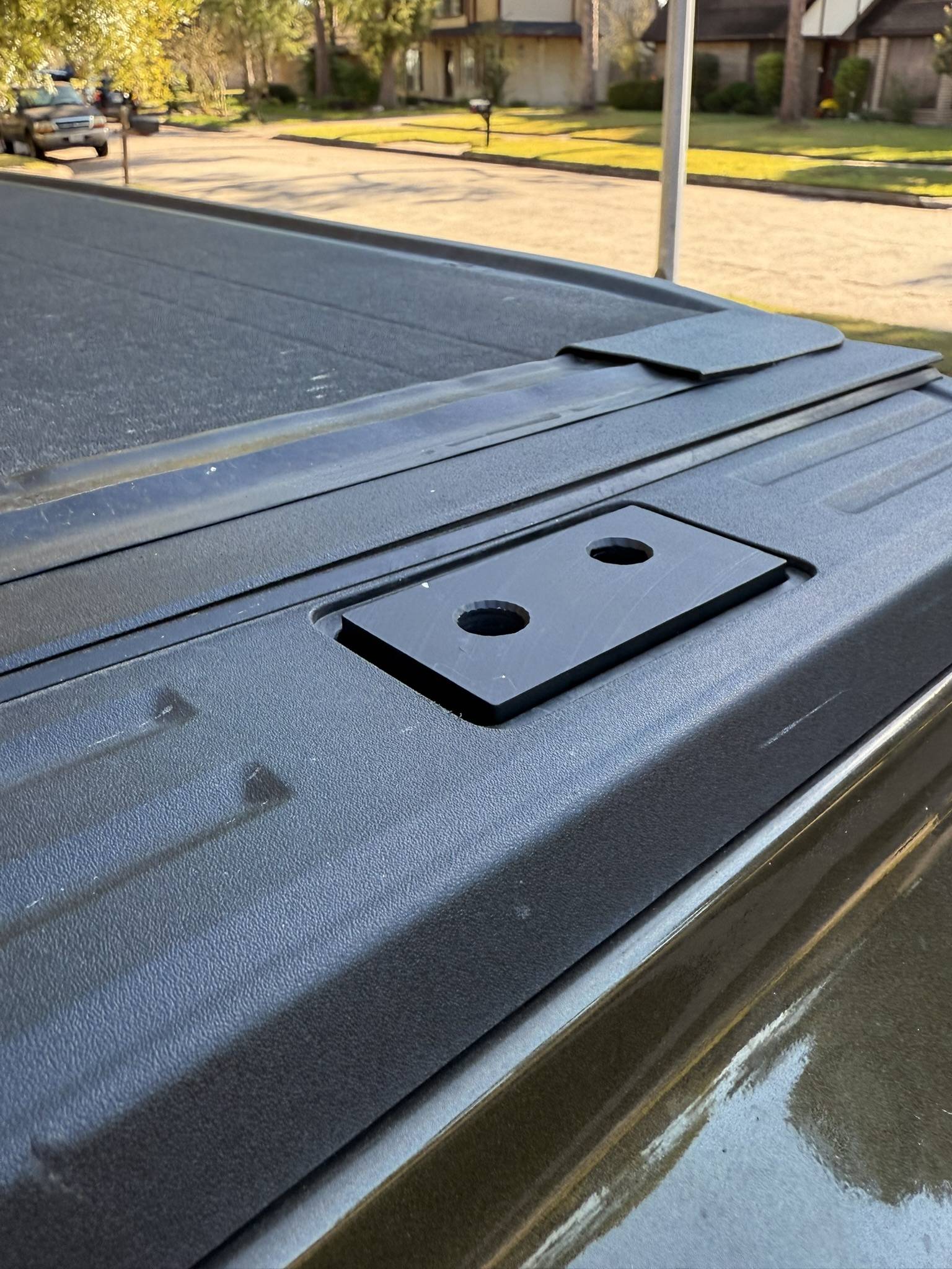

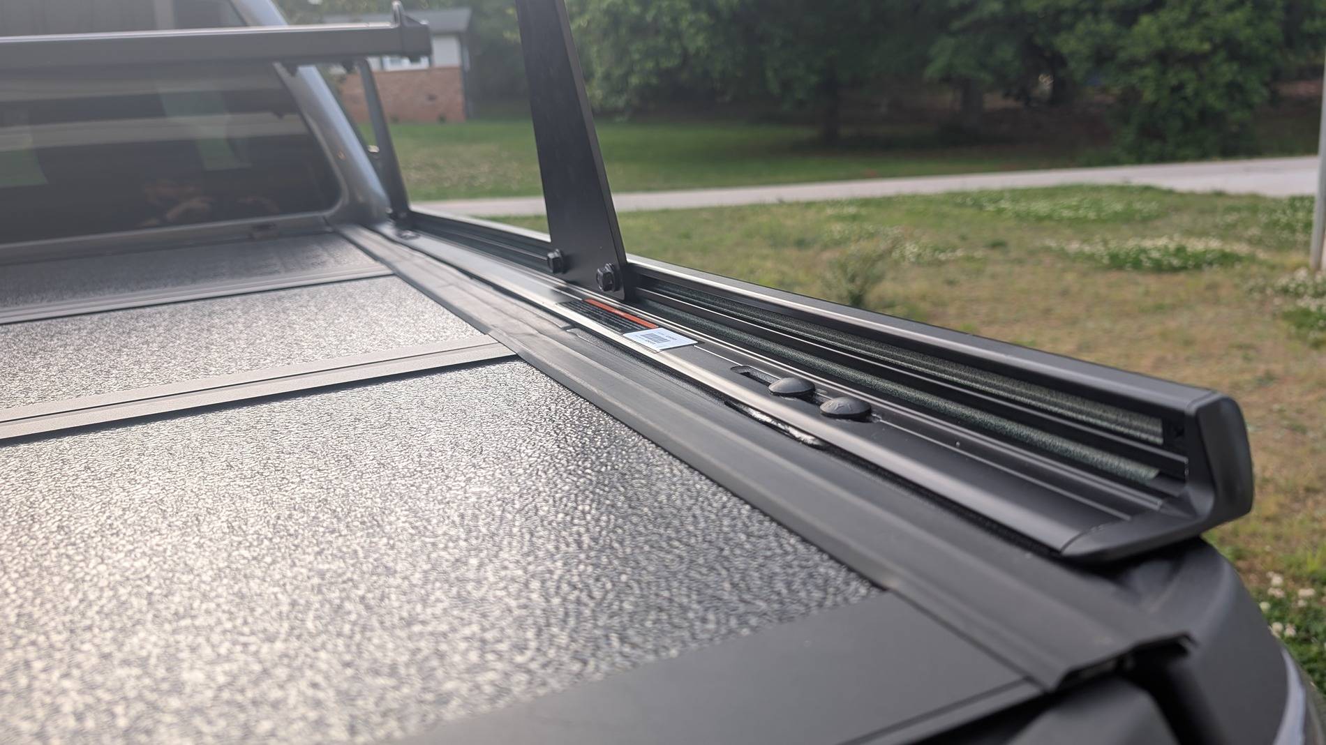

The Adarac bed racks use aluminum spacers that sit on the stake pockets, then the t-slot rails mount to the stake pockets. I haven't loaded up the rack much yet, so I can't comment on strength.

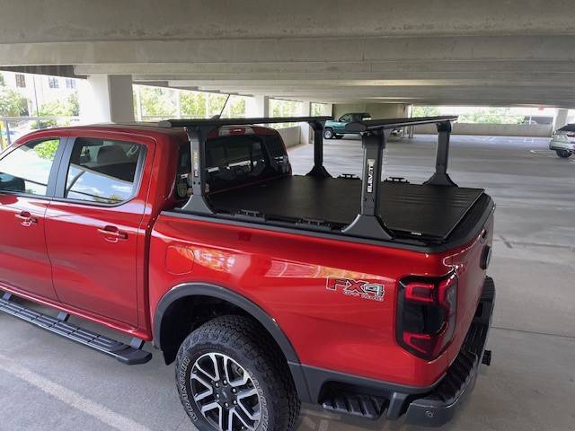

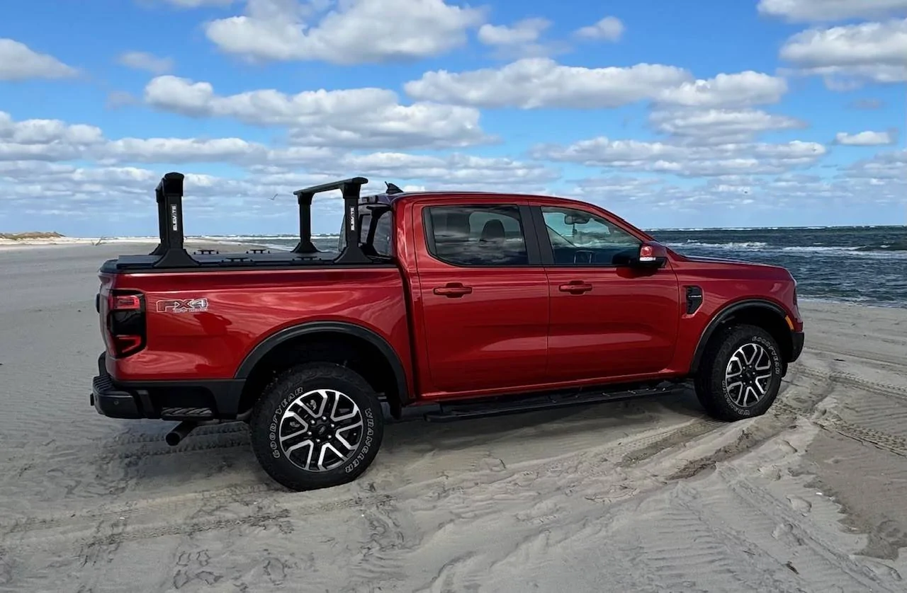

I went wih the Elevate Rack. I wish there was more adjustability though.
