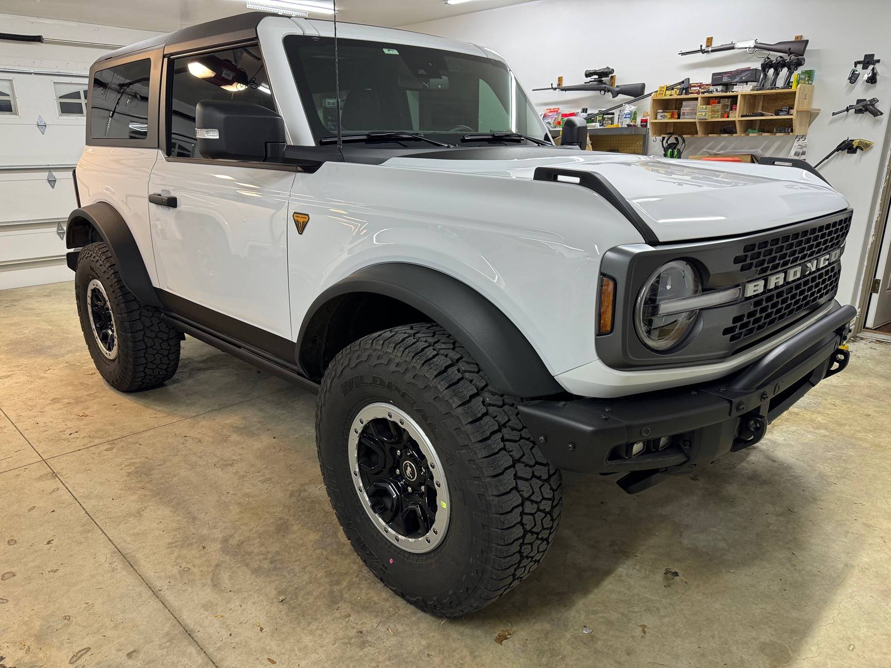

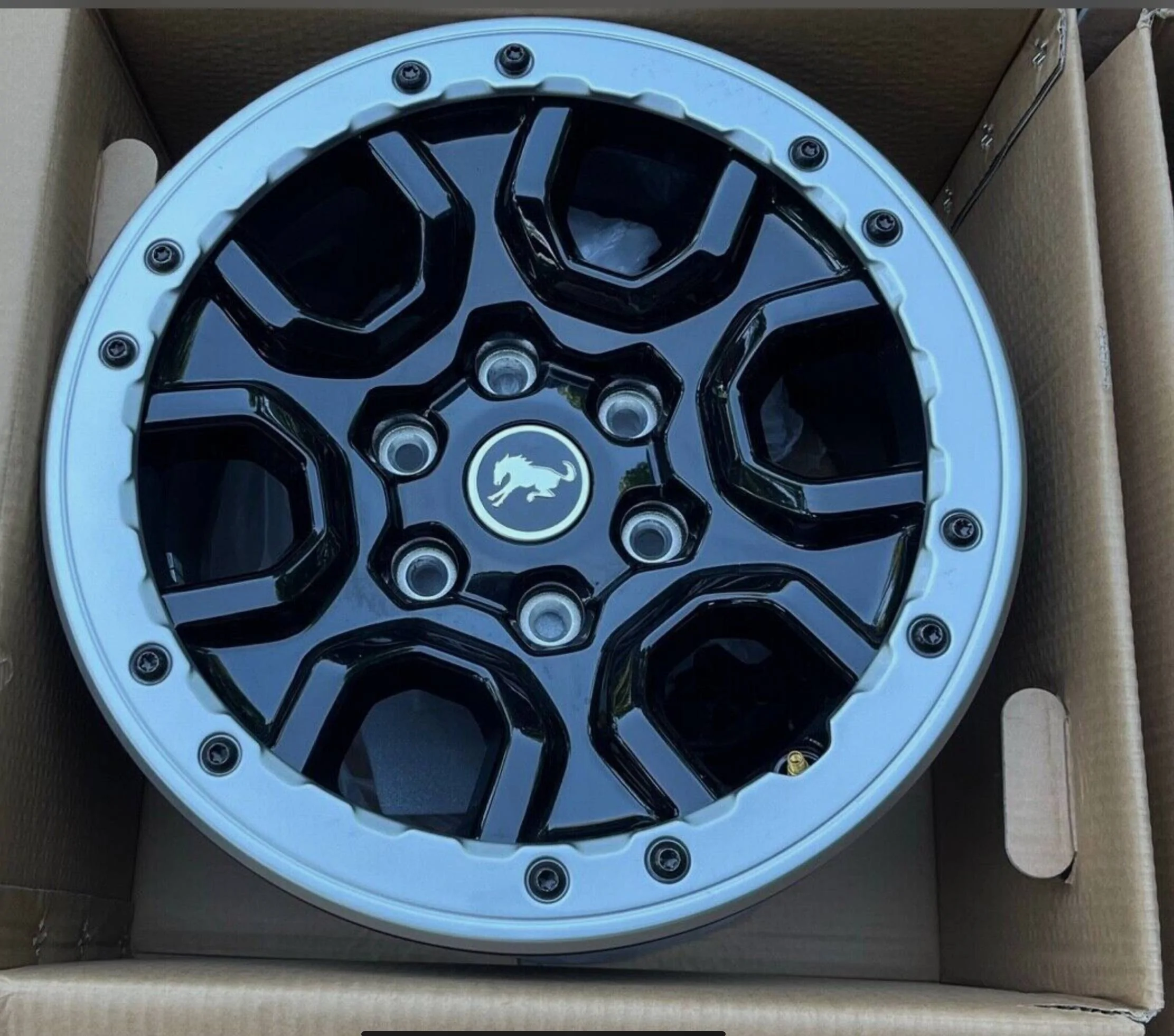

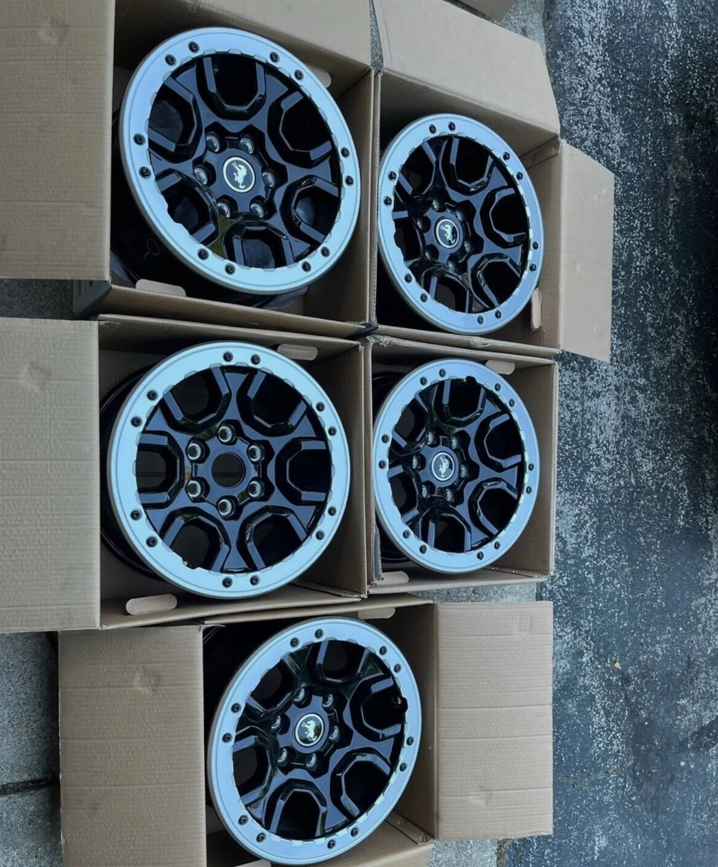

Been researching and doing some math with the tire and wheel specs the past few days. Ordered the Rims off eBay today.
I am going with these factory Ford Bronco SAS 17”x8.5 +30 offset bead lock capable rims.
‘I think they look good on my Bronco. Very similar design to the OEM Ranger Raptor wheels coming on my Ranger Raptor. However really not liking the way they look in the RR +55 offset. I think the +30 from the Bronco looks much better with that deeper offset look.
Ford Ranger Wheels & Tires sorted: 295/70R17 34” tall 12” wide +30 offset / Update +30 offset now running Falken AT4W P285/70R17s IMG_4441
Ford Ranger Wheels & Tires sorted: 295/70R17 34” tall 12” wide +30 offset / Update +30 offset now running Falken AT4W P285/70R17s IMG_4442
Same wheels on my Bronco only with 35” tall 12.5 wide tires.

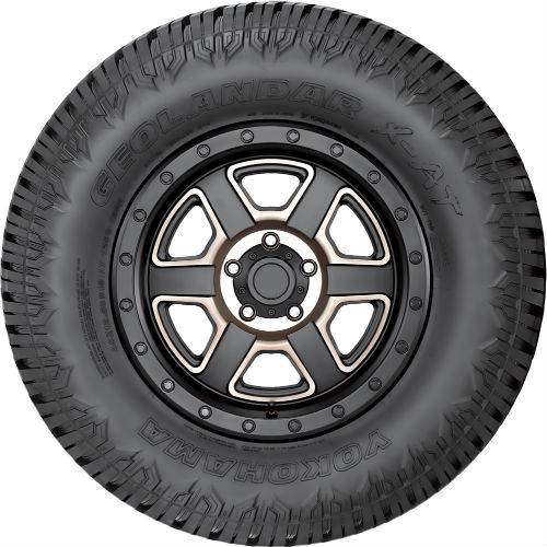

I am going to order the tires next week.

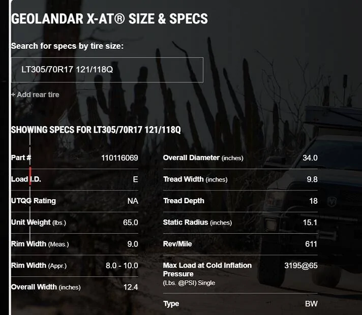

‘I am going with a 34” tall 12” wide Yokohama X-AT LT305/70R17 load range E (10 ply)

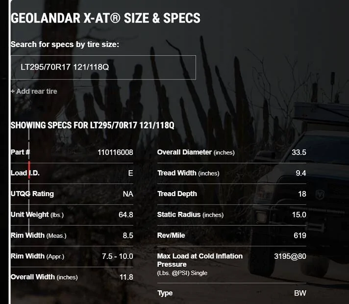

I am thinking I may chicken out on the 305 and back that tire size down to 295/70R17.
Still same Yokohama tire.
1/2” narrower and 1/2” shorter.

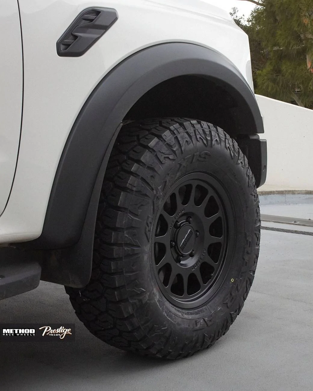

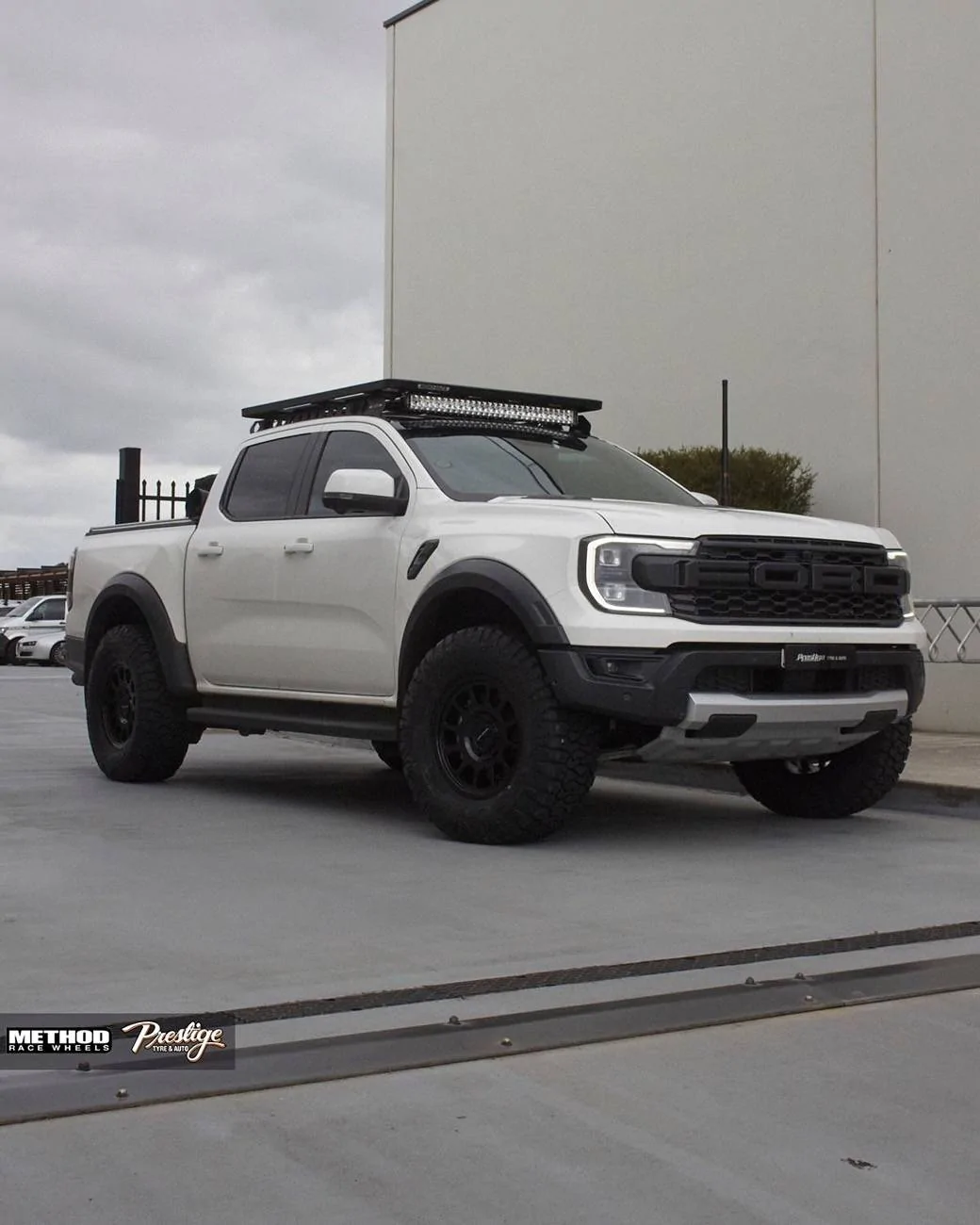

Found some pics of 295/70R17s , I believe the rims on this truck are a +25 offset.
Those wheel wells look pretty full, stance looks good, with this 295 +25 setup.
Thinking no reason to push a potential rubbing issue or getting poke I don’t want.
If I can get it to look this good.

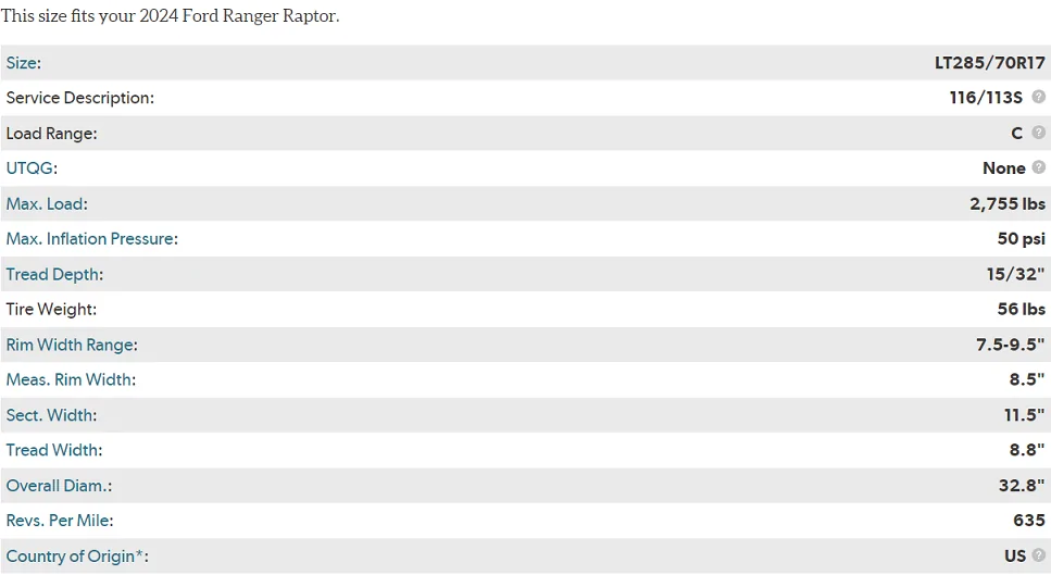

Here is the stock tire spec if anyone is interested.
I find it helps with math to sort out what I want to do, to know what exactly it comes with.
Ford Ranger Wheels & Tires sorted: 295/70R17 34” tall 12” wide +30 offset / Update +30 offset now running Falken AT4W P285/70R17s 1711384036863-q3

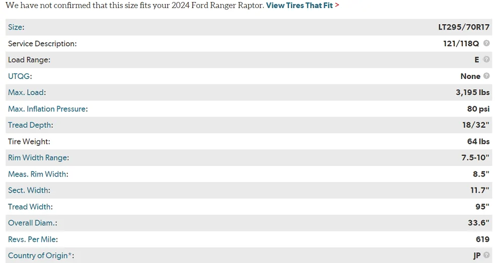

Vs
these two specs I am trying to decide on.

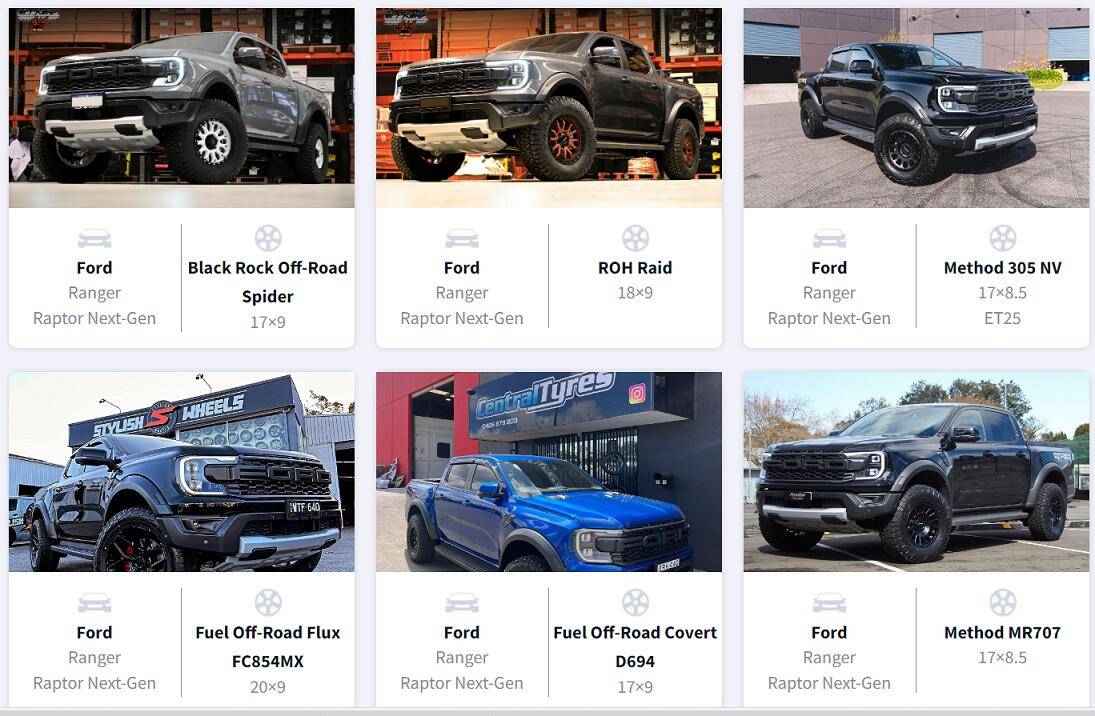

Found this website that has a pretty nice gallery of 6G RR with custom wheels and tires.
I find looking over pics of different setups with different tires and wheel offsets in particular very informative when researching the right stance or look that I am wanting to create.
Ford Ranger Raptor Next-Gen Aftermarket Wheels Gallery | Wheel Front

I ordered the tires this afternoon. Went ahead with playing it safe, order the 295/70R17s Yokohamas.

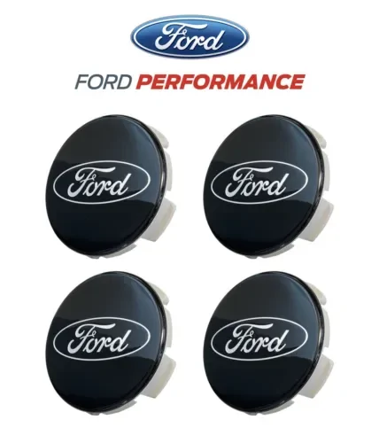

Order some Ford center caps to replace the Bucking bronco caps.
Fingers crossed they fit and look good on those Bronco SAS rims.

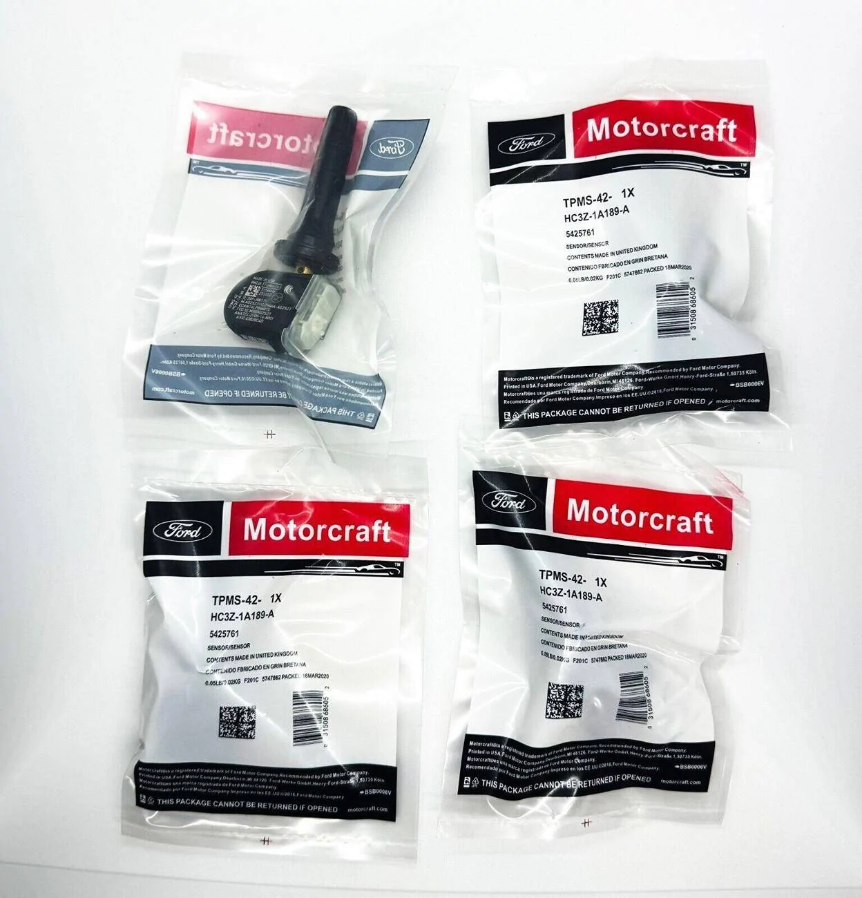

Also order some Ford TPMS sensors also fingers crossed they read and all goes well with these as well.
Ford Ranger Wheels & Tires sorted: 295/70R17 34” tall 12” wide +30 offset / Update +30 offset now running Falken AT4W P285/70R17s 1711568636549-2o
Should be correct.
This was the description on Ebay.
4-PACK HC3Z-1A189-A Ford Motorcraft TPMS Tire Pressure Monitor Sensor TPMS42
Part Numbers:
TPMS42
HC3Z-1A189-A
HC3T-1A150-BA
Fitment:
For Ford Expedition 2018 - 2021
For Ford F-250 Super Duty 2017 - 2024
For Ford F-350 Super Duty 2017 - 2024
For Ford F-450 Super Duty 2017 - 2024
For Ford F-550 Super Duty 2017 - 2024
For Ford F-600 Super Duty 2020 - 2022
For Ford Fusion 2017 - 2020
For Ford Ranger 2019 - 2024
For Ford SSV Plug-In Hybrid 2019 - 2020
For Lincoln Continental 2017 - 2020
For Lincoln MKC 2018 - 2019
For Lincoln MKX 2016 - 2018
For Lincoln MKZ 2017 - 2020
For Lincoln Nautilus 2019 - 2024
For Lincoln Navigator 2018 - 2021

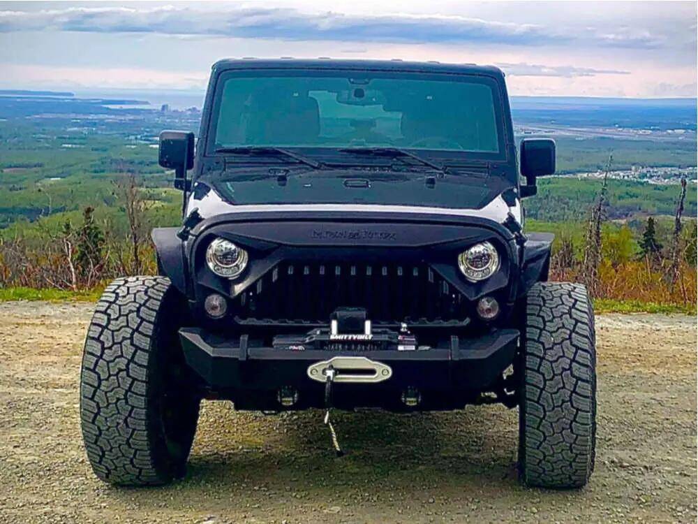

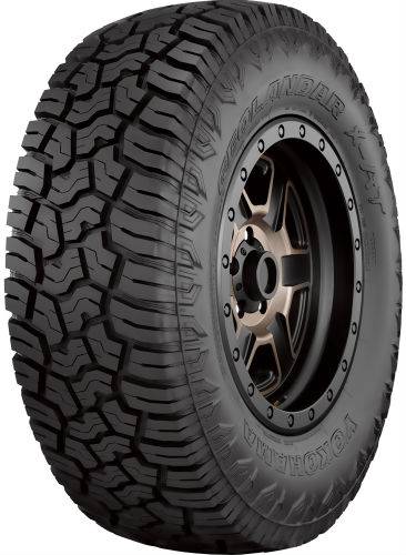

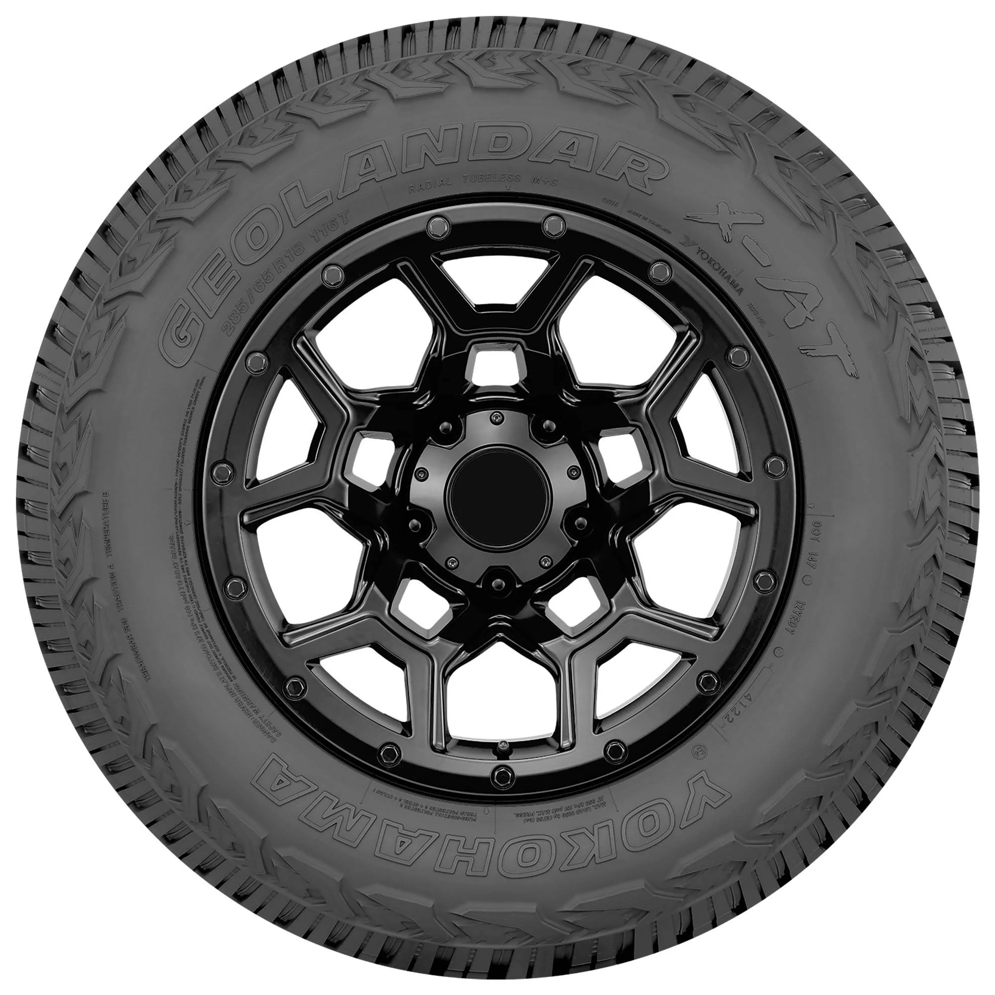

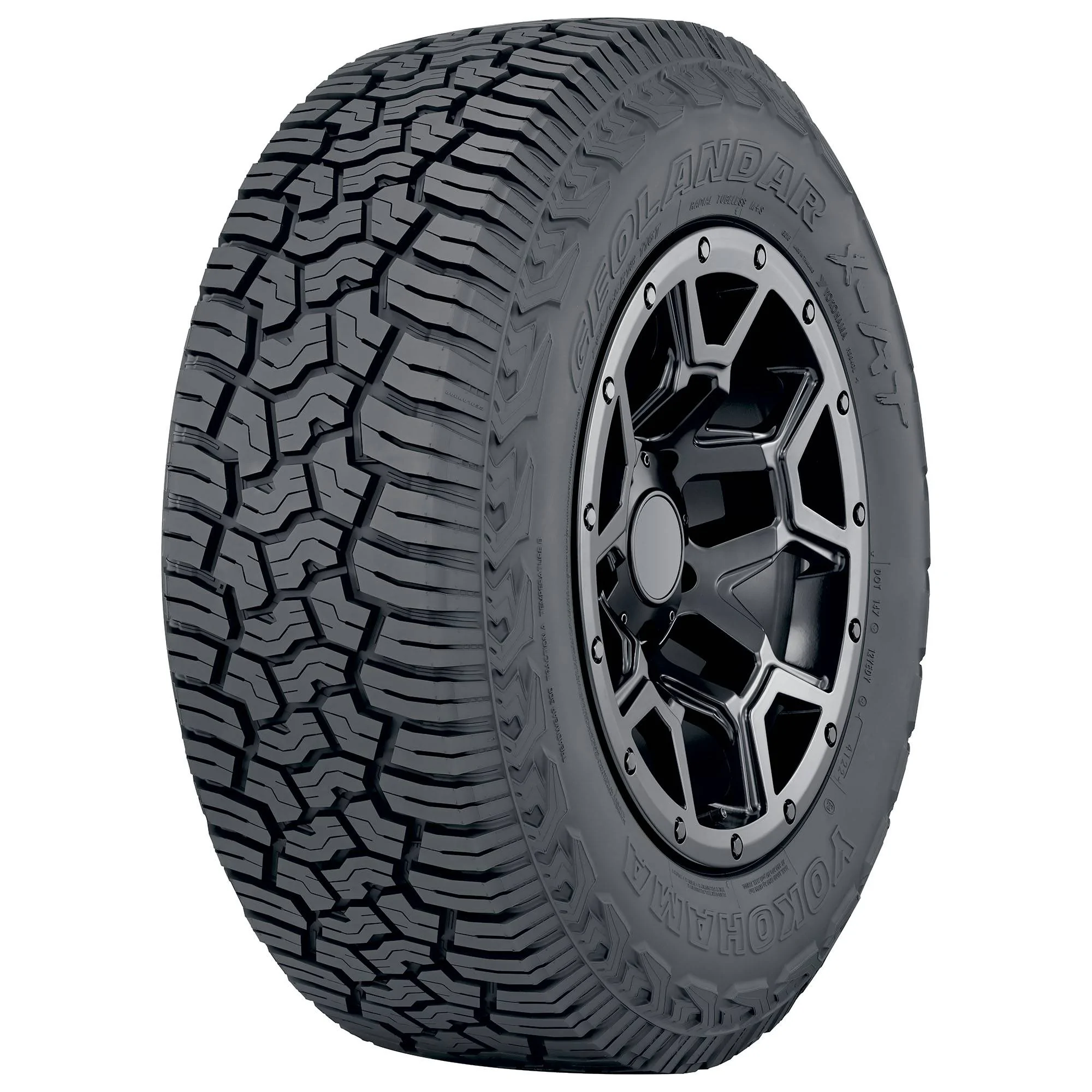

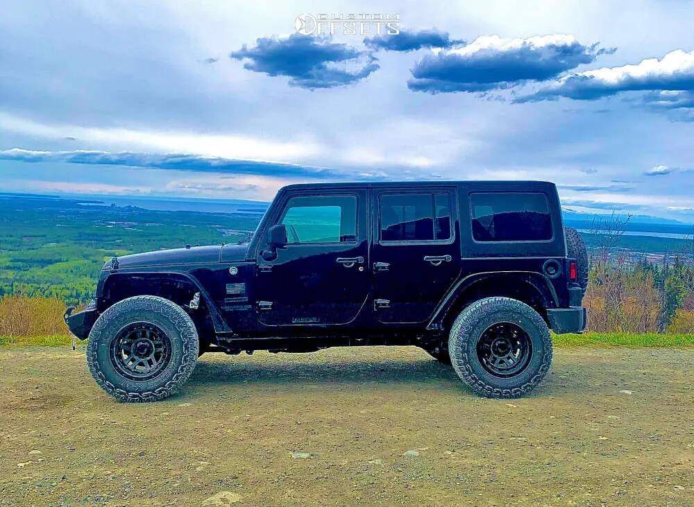

I did find a few pictures of a mounted Yokohama 295/70R17 tires.
They are on a Jeep but I do like seeing pictures of the actual tire I am getting mounted and not some generic stock picture.

I ran those Yoko X-ATs on my Bronco. Really great tire overall with one caveat which was they were slippery on wet tarmac and would hydroplane and spinout from a stop. Off-road they performed great for an ATX.
I live in the PNW so had to switch them out but if you're in a drier area I think they would be great.
