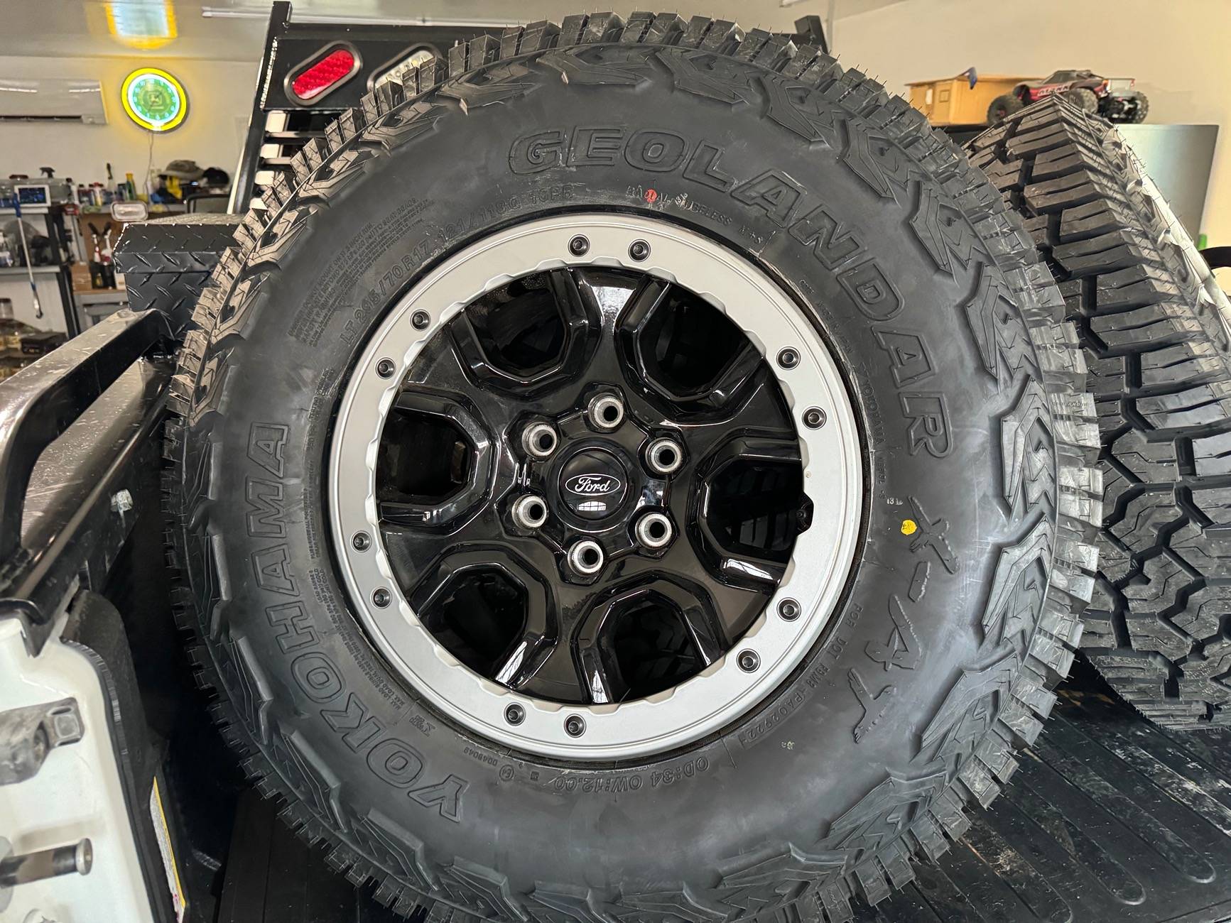

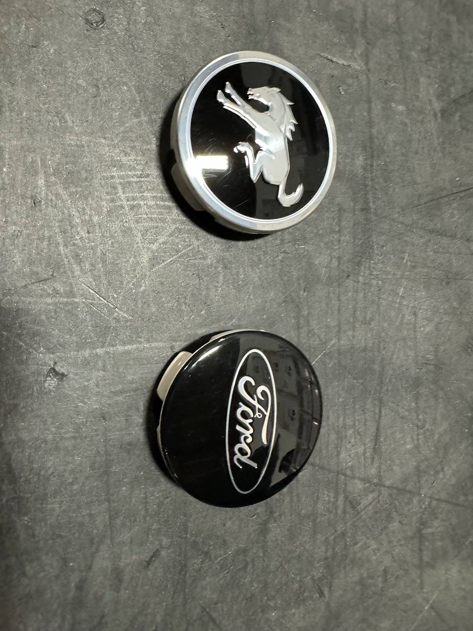

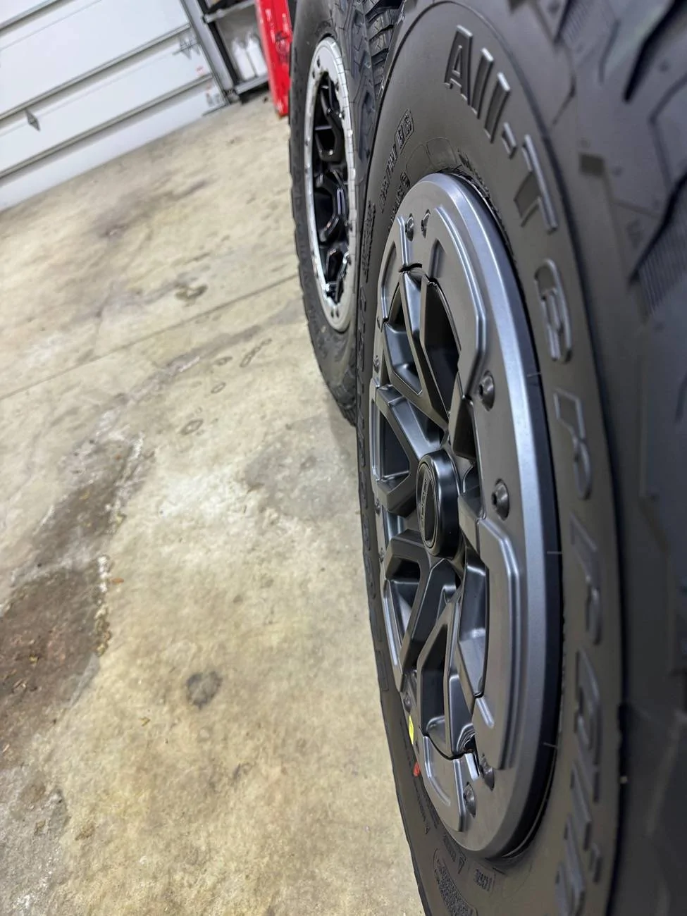

Got to test fit the black ford center caps I bought to replace Bronco horses.
Ford Ranger Wheels & Tires sorted: 295/70R17 34” tall 12” wide +30 offset / Update +30 offset now running Falken AT4W P285/70R17s IMG_7592
The new center caps fit perfect.

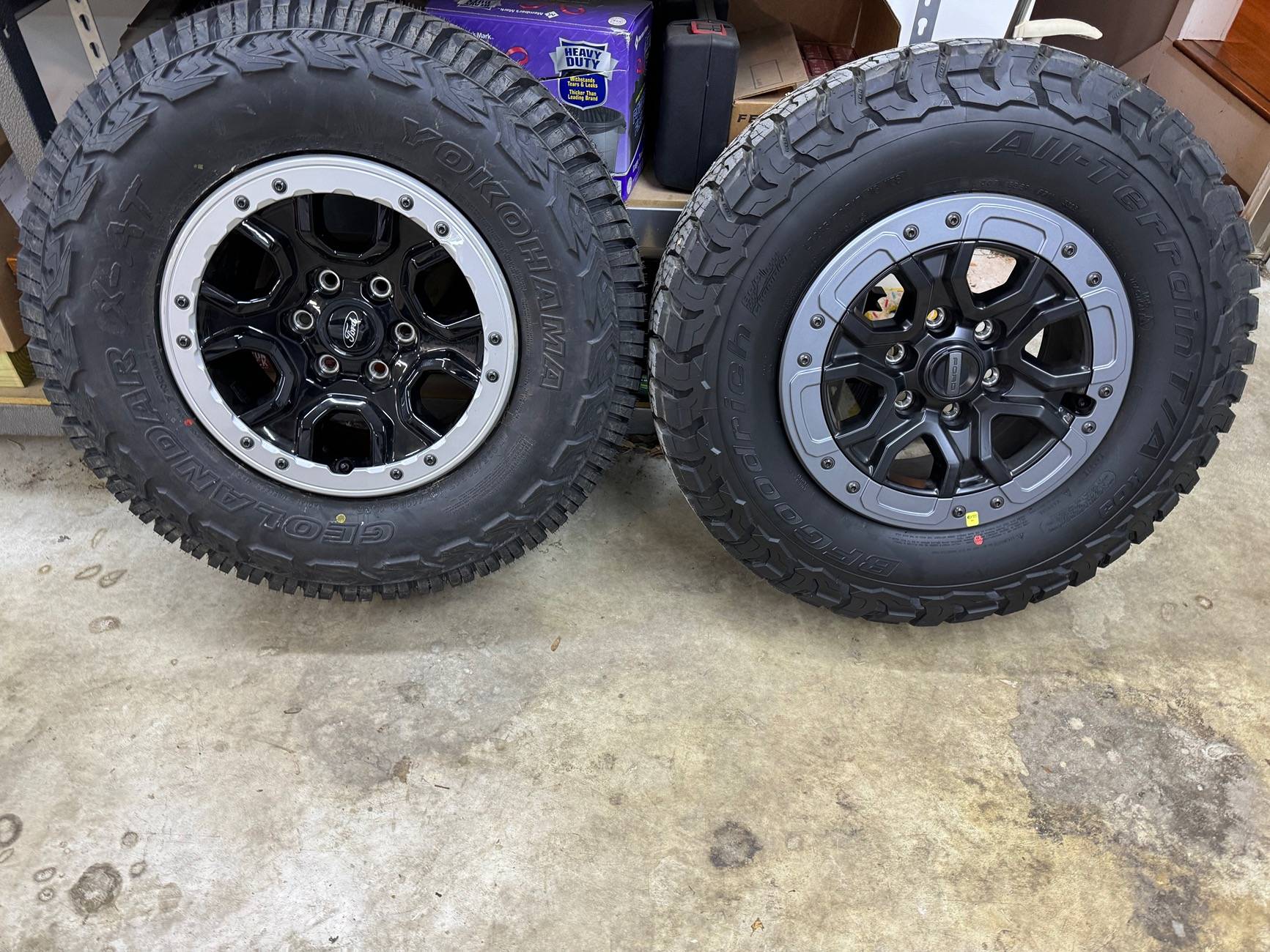

Another thing I am curious to see when the truck gets here is if the rings are interchangeable.
The OEM Ranger Raptor rims that are coming on mine are the bead lock looking rims with the +55 offset but the design looks the same as far as the rim, the rings are slightly different.

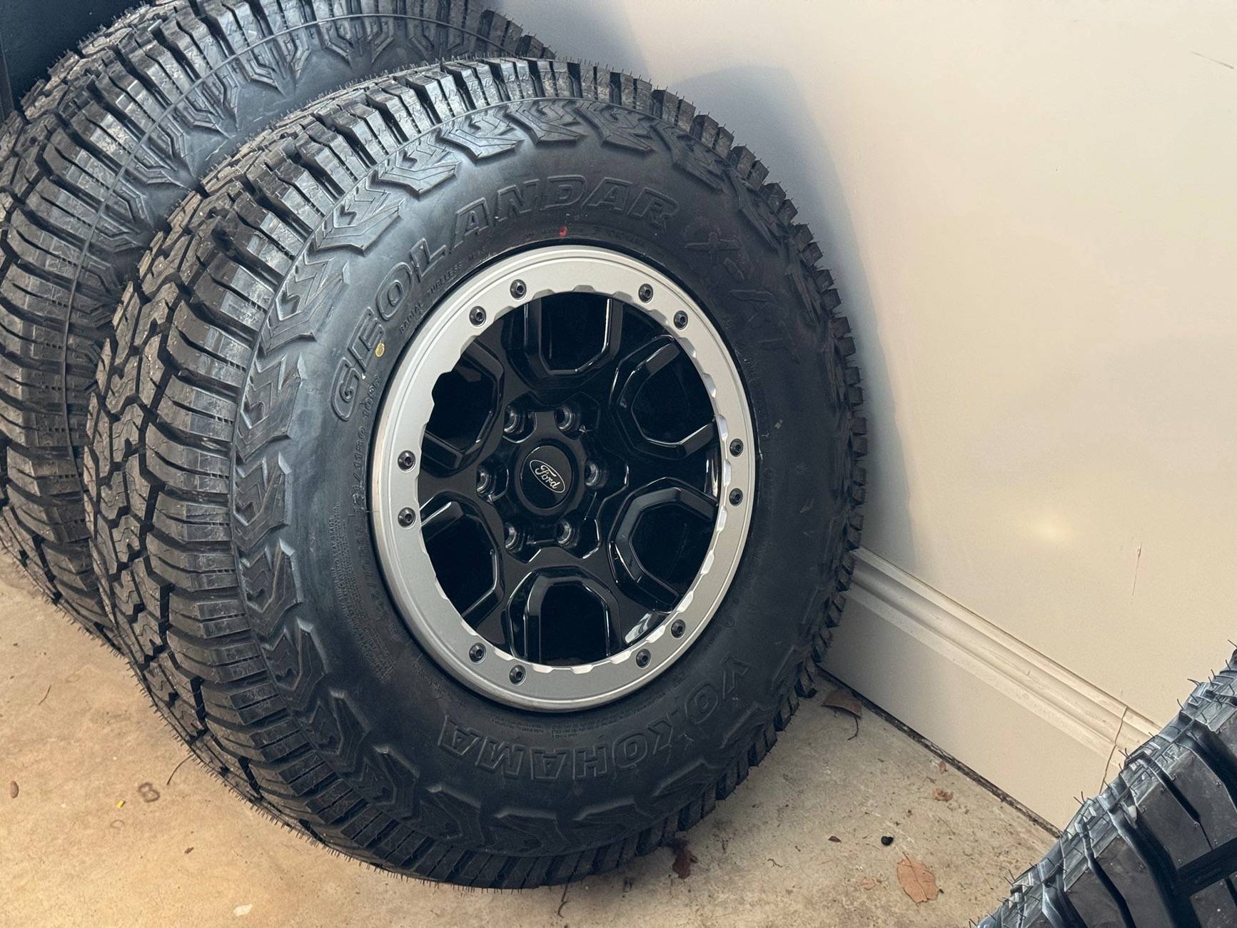

Bronco SAS rims with new 295/70R 17 Yokohama tires are now all mounted up with new Ford TPMS sensors, ready to go on my Ranger Raptor whenever it finally arrives.

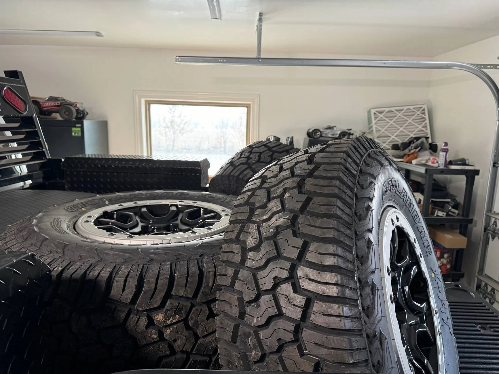

Mine has made it to the final rail yard. Best case is it gets to the dealership later this week and I can pick it up on Saturday. That is best case senario on my trucks ETA.

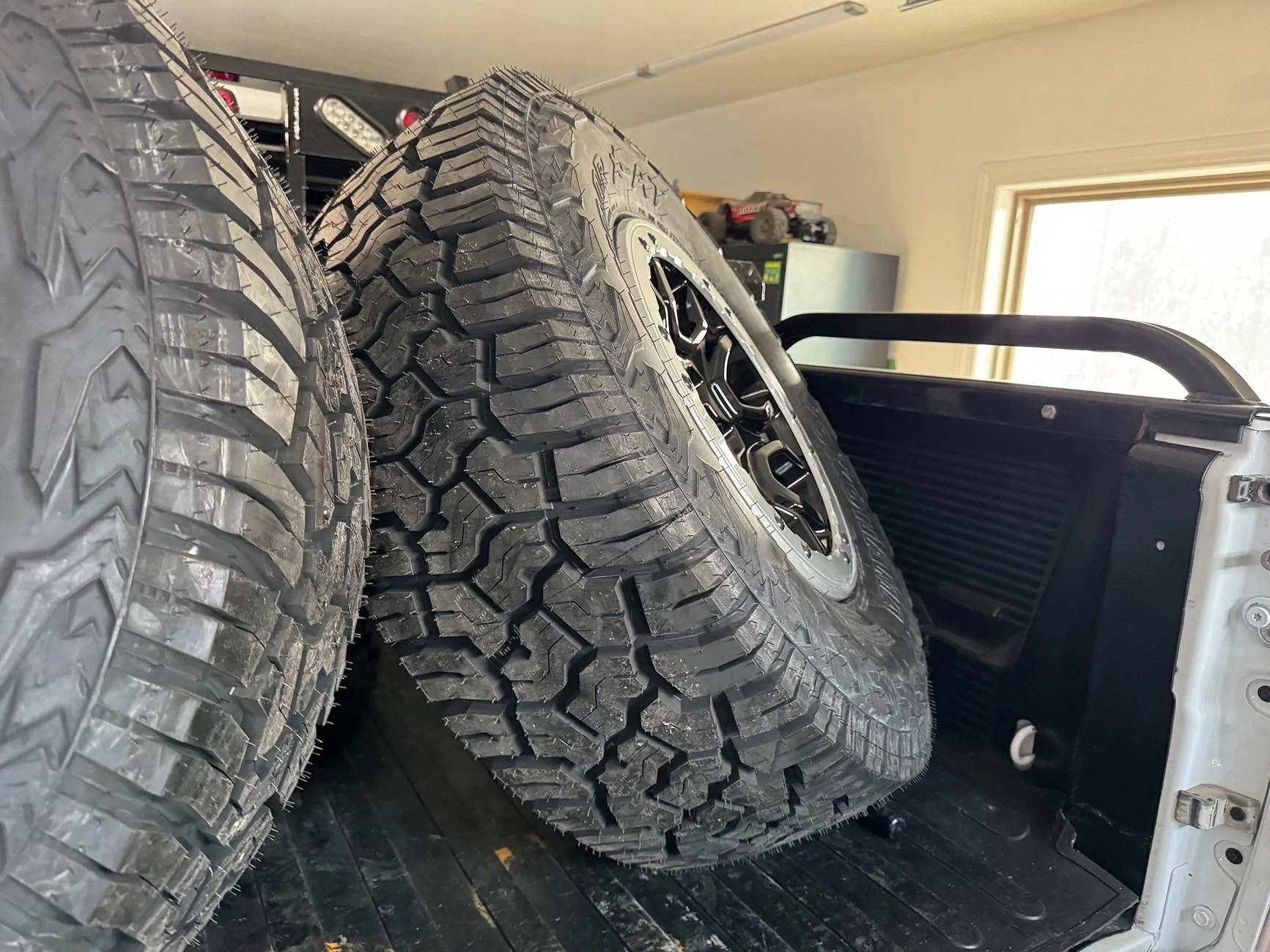

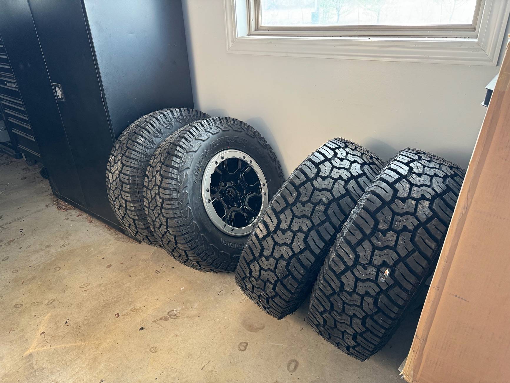

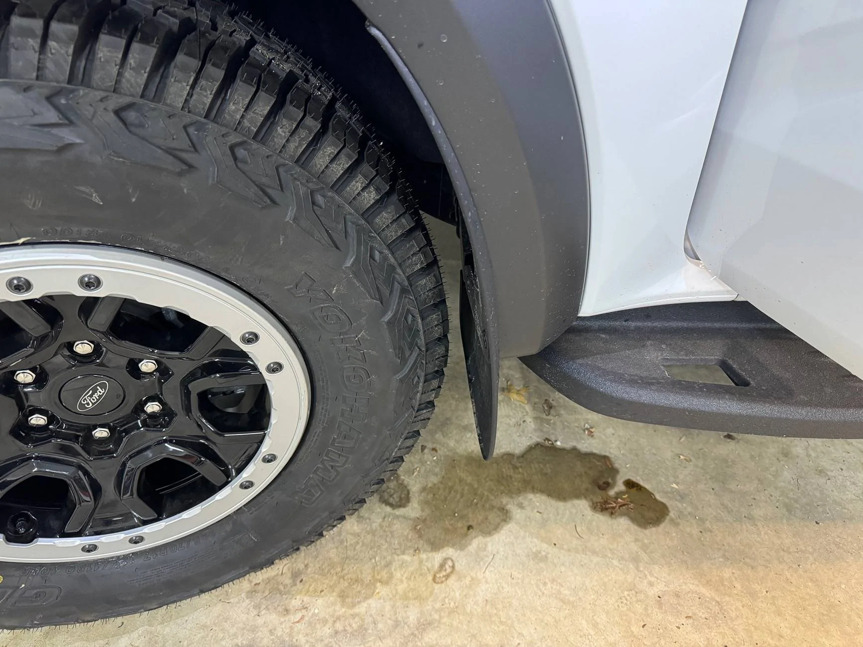

Wheels and tires are all mounted and ready to go setting in my garage for whenever the truck gets here.
2,293
3,054

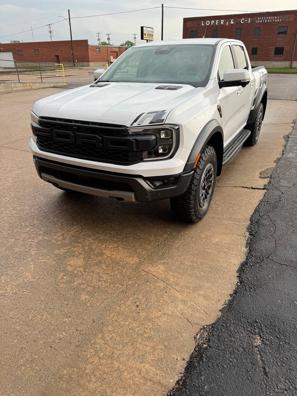

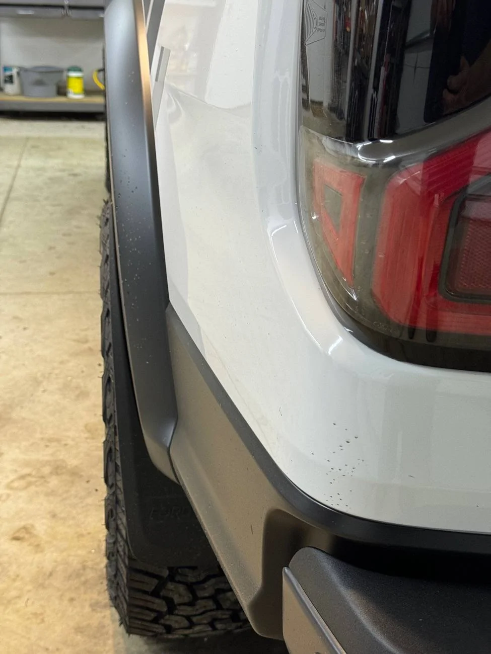

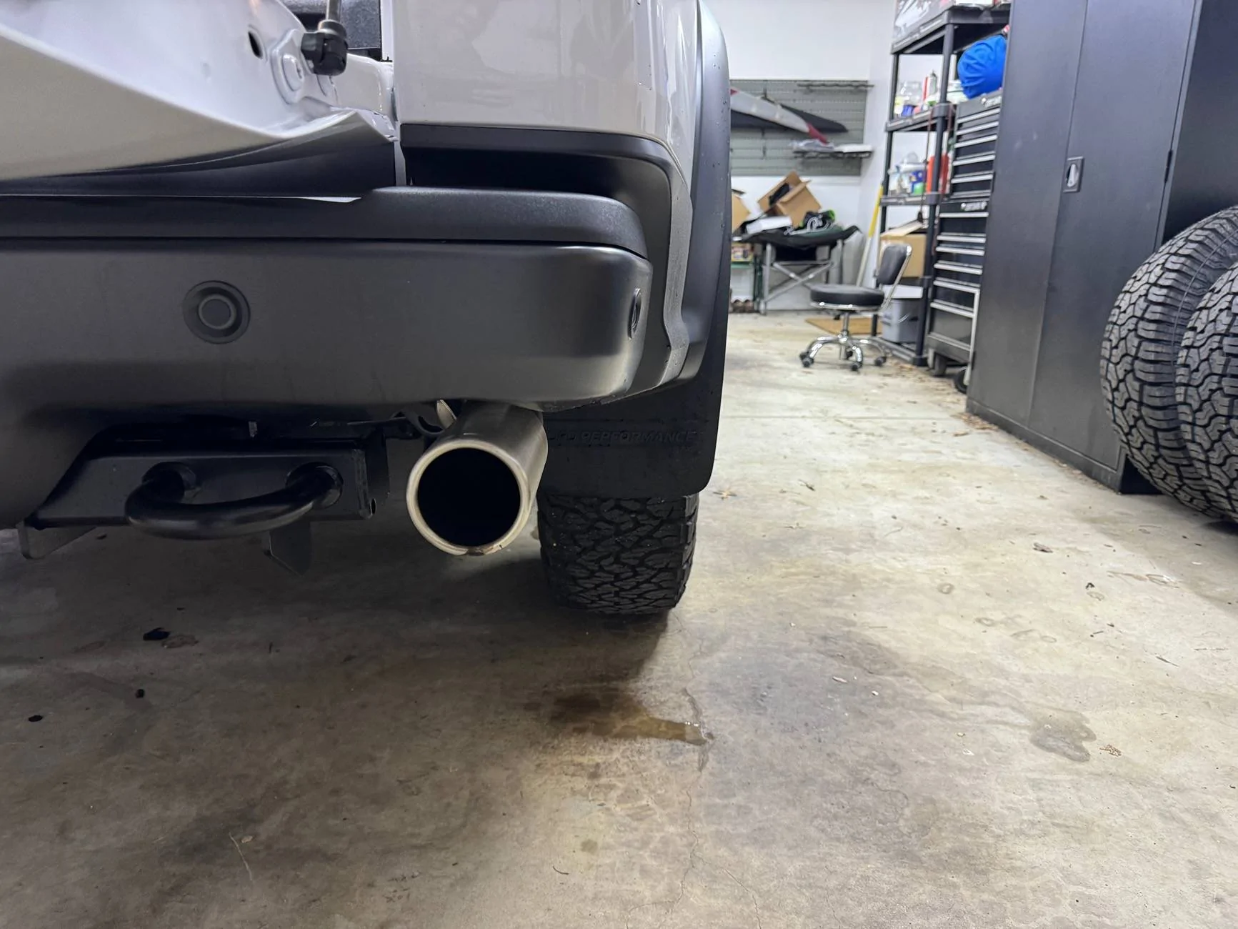

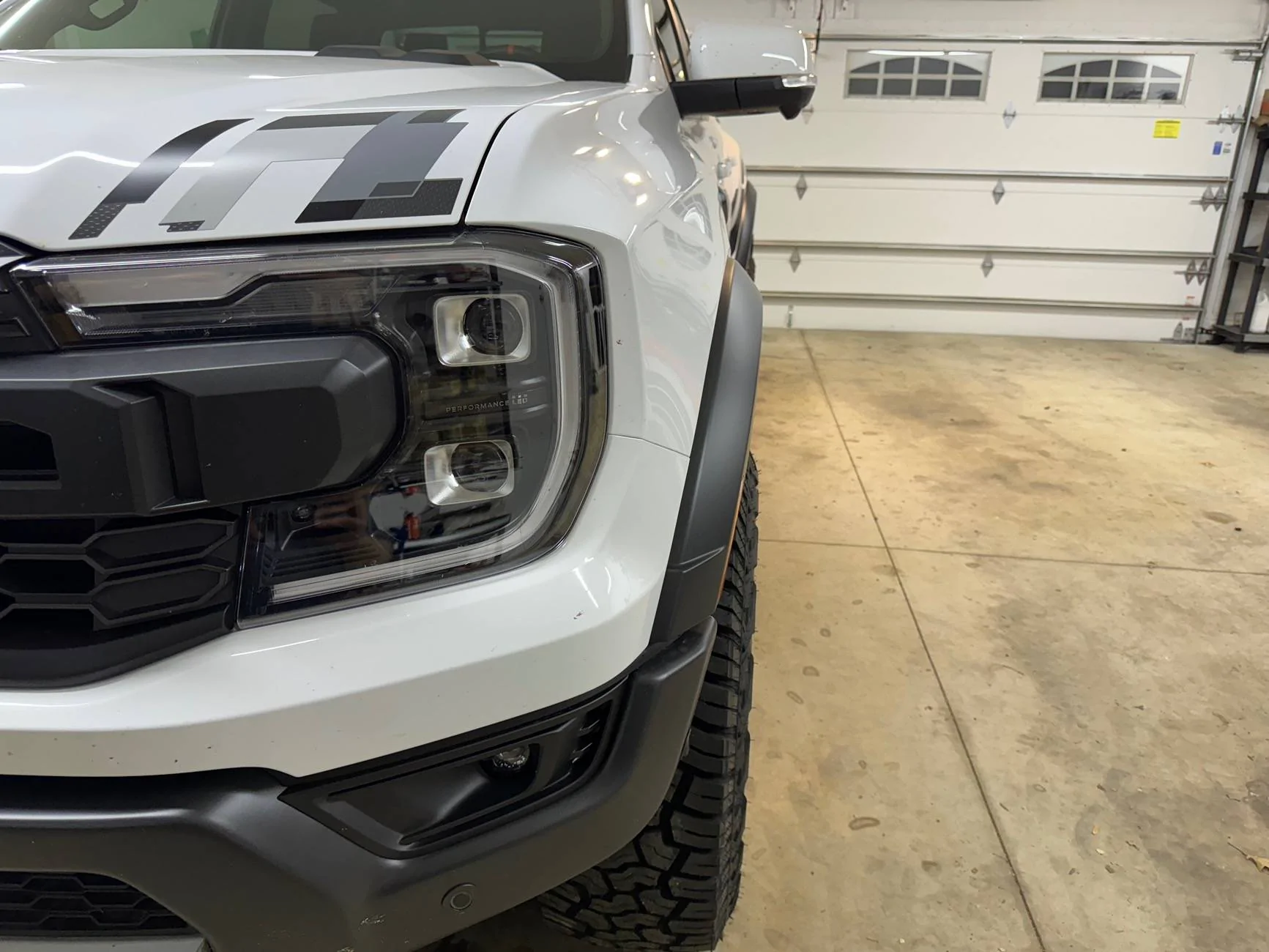

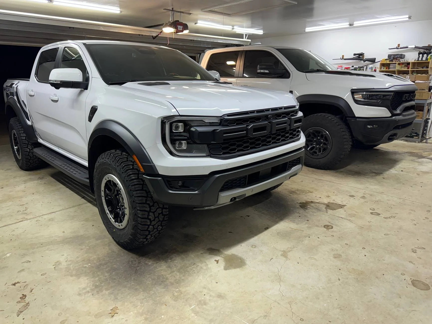

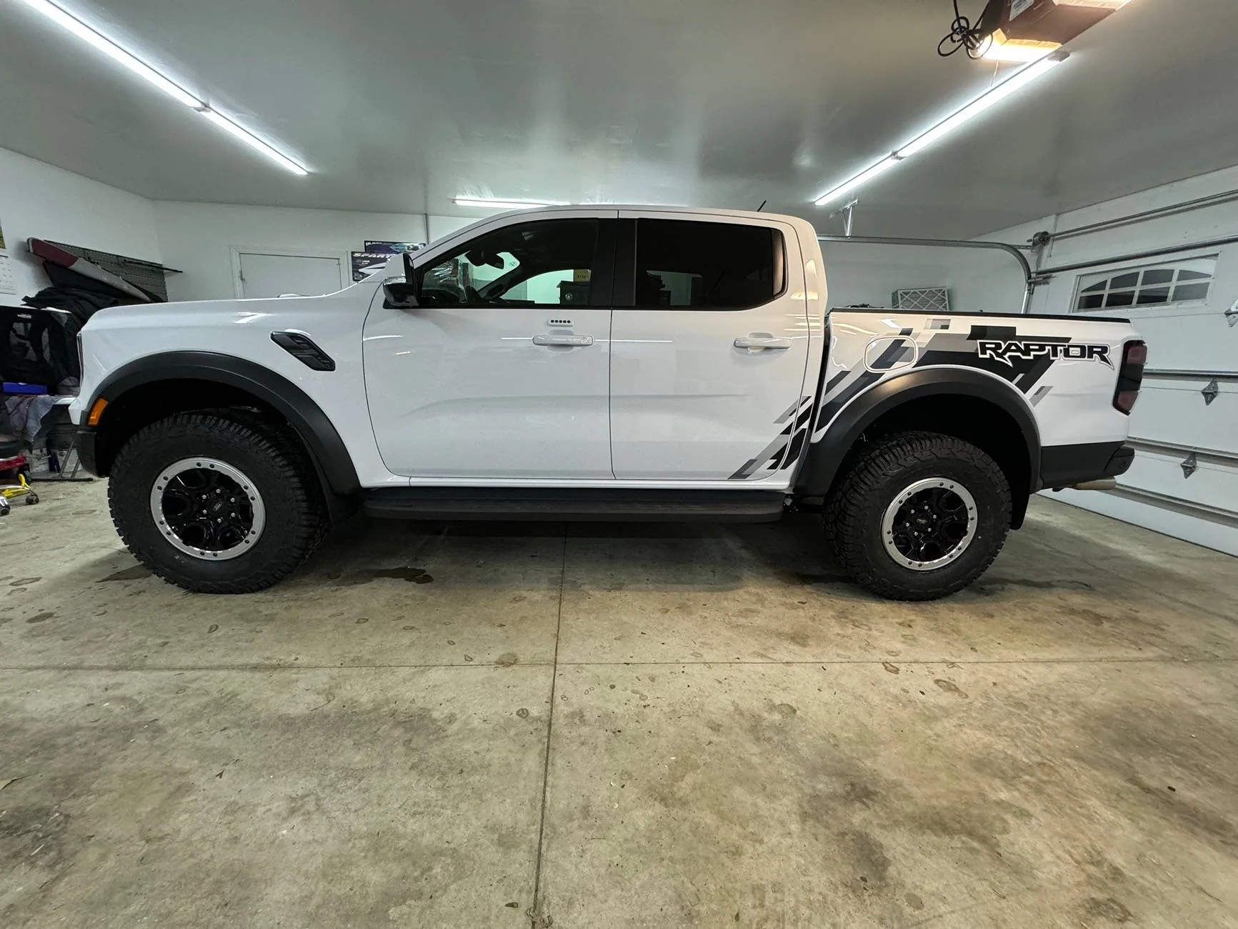

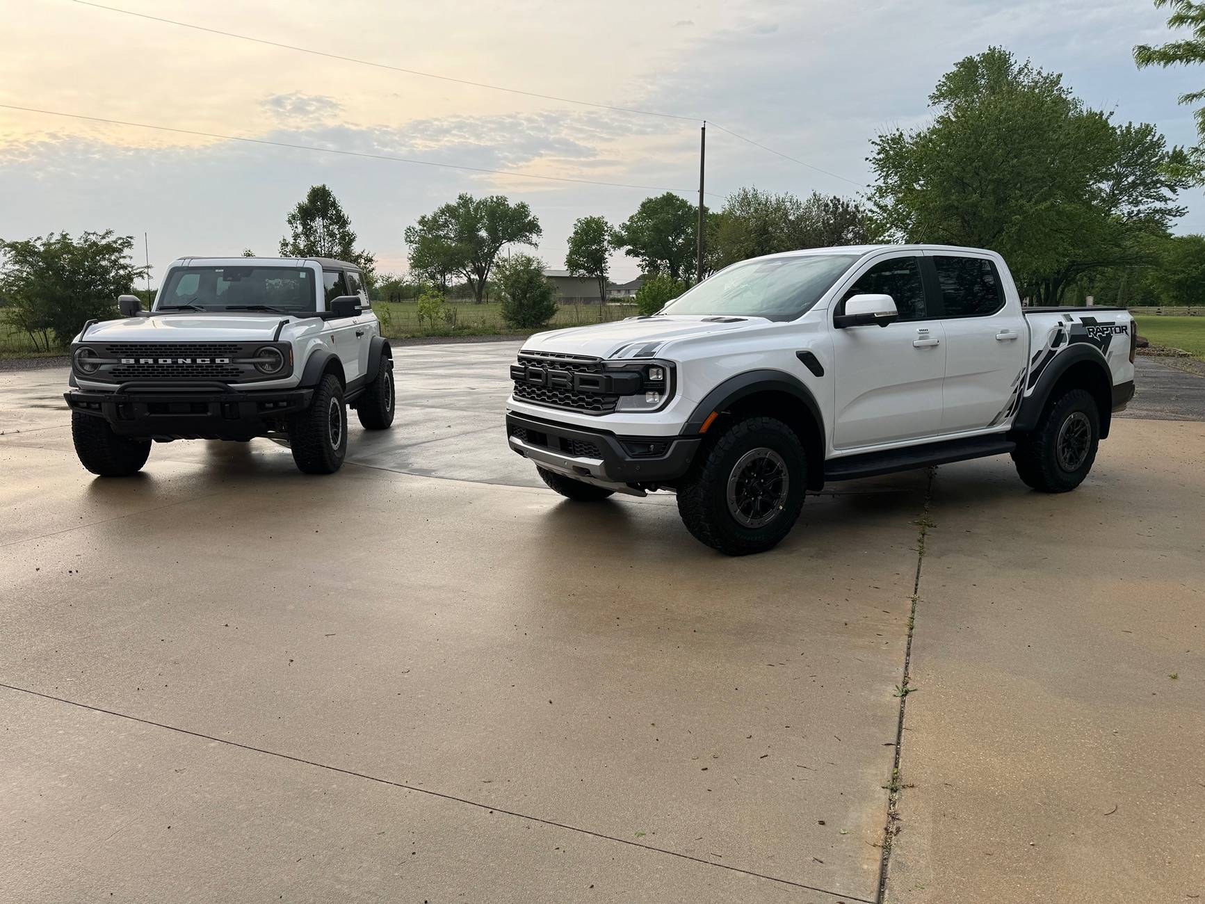

My truck came in last week, got to pick her up today. 5 hour road trip back home in it, and still had the need to get my new wheels and tires installed soon as I got home. lol

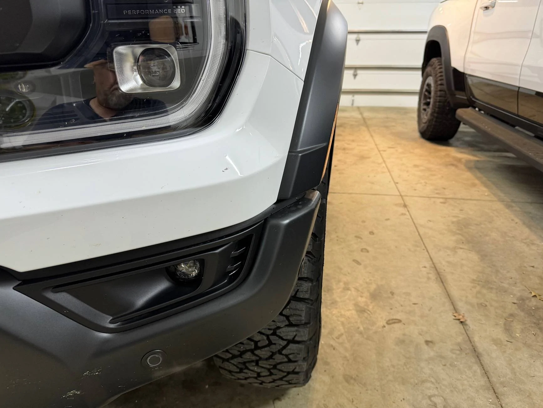

Love how it turned out, stance is exactly what I was after flush without any poke, slightly taller and wider tires too, without lifting and with out trimming anything.
All my plans seemed to have worked. Clearance with the front crash bars is tighter then I would have thought, but They cleared, just barely. Need to do some road testing to verify 100% no rubbing, but stationary testing no rubbing found.
Before and side by side pics.

After pics.

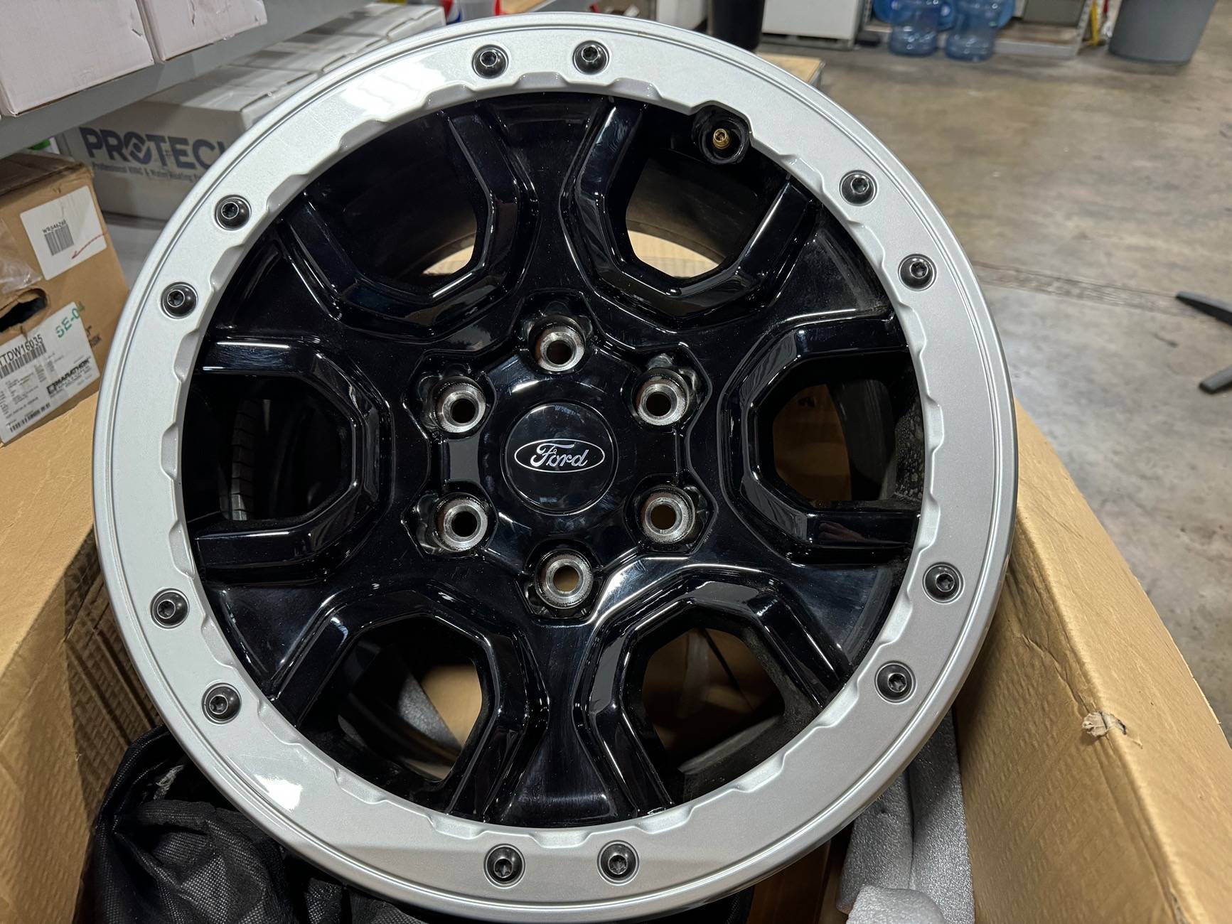

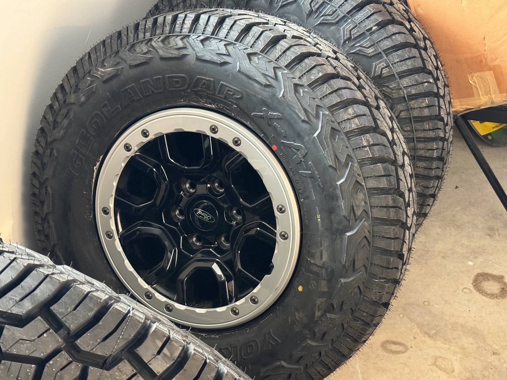

That does look perfect! Are there any Bronco wheels with those specs that don't have the beadlock ring?
2,293
3,054
I am not sure. If you don’t like the bright machined ring they can be color changed, paint, powder coat etc. There might be some in +30 without the rings, just never researched that before.
‘This set came from an eBay seller that specializes in new take off rims.
1200-1500 bucks is the going rate for most common take off rims.

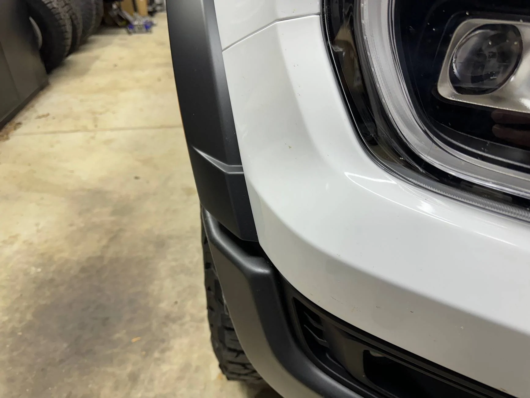

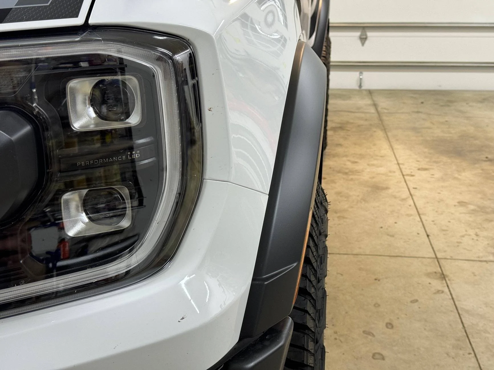

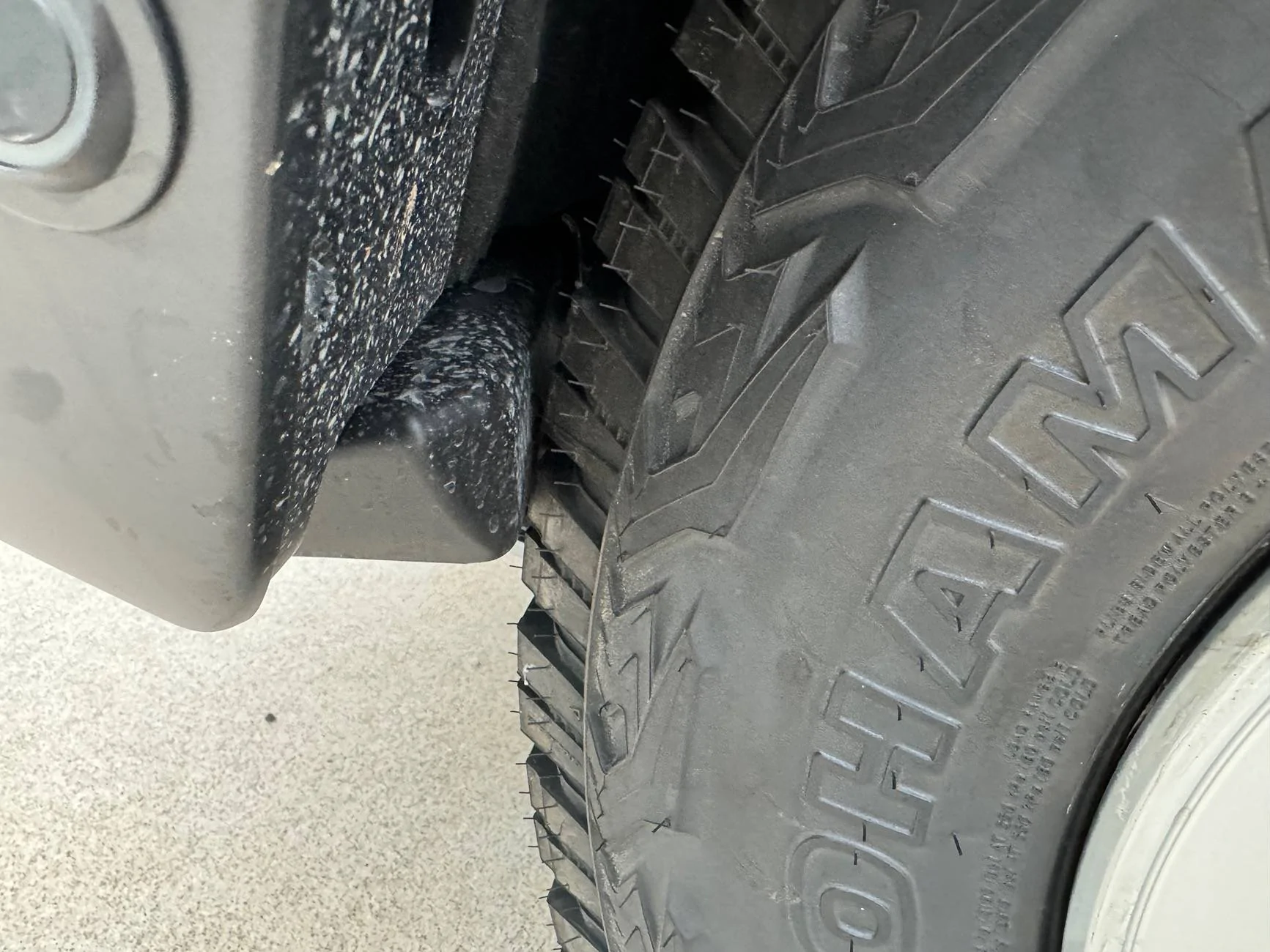

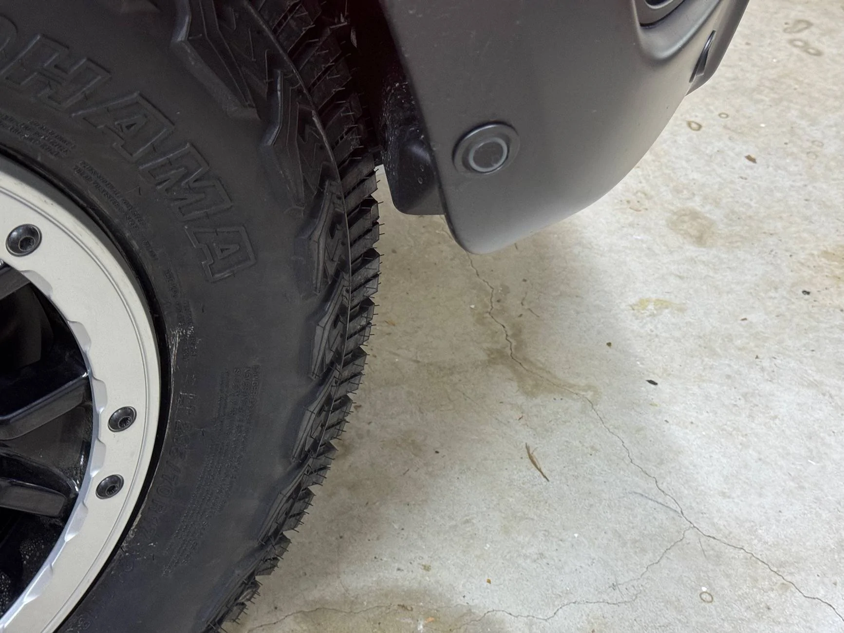

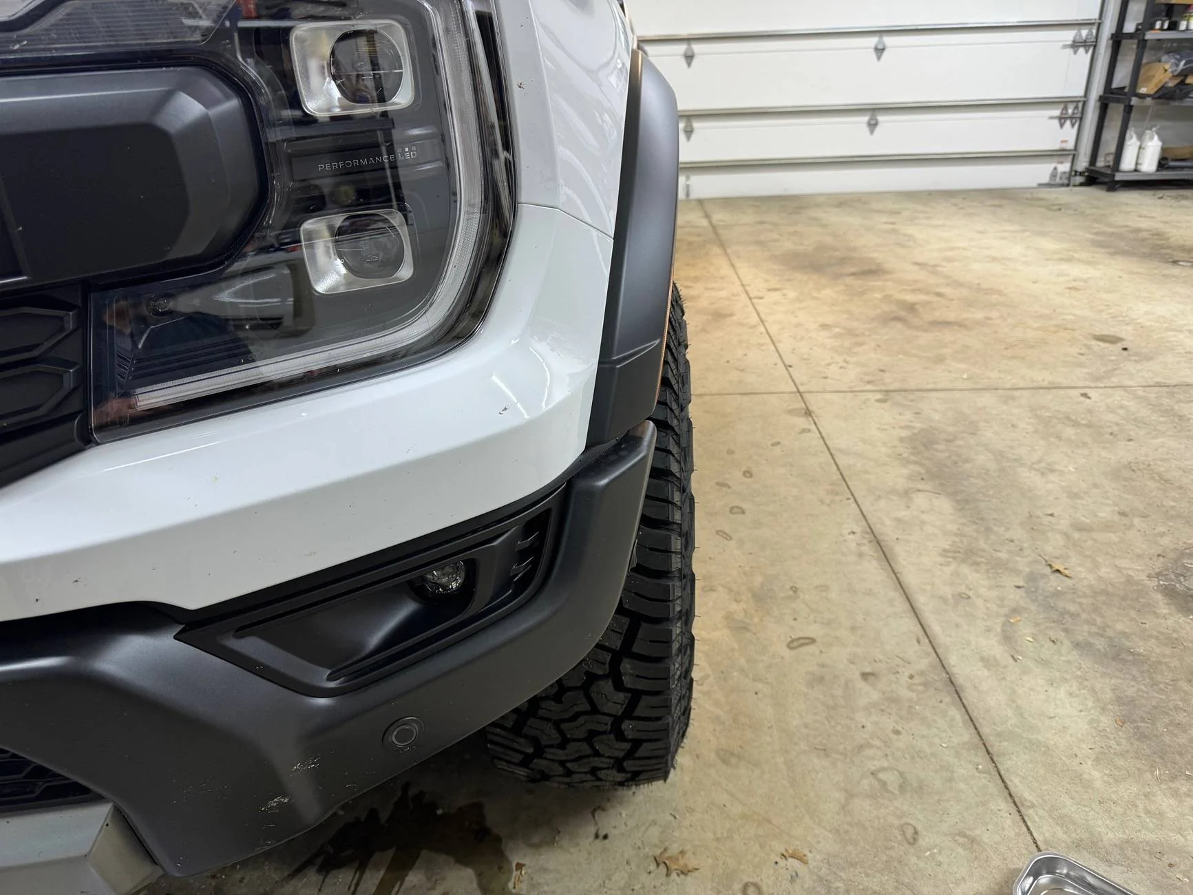

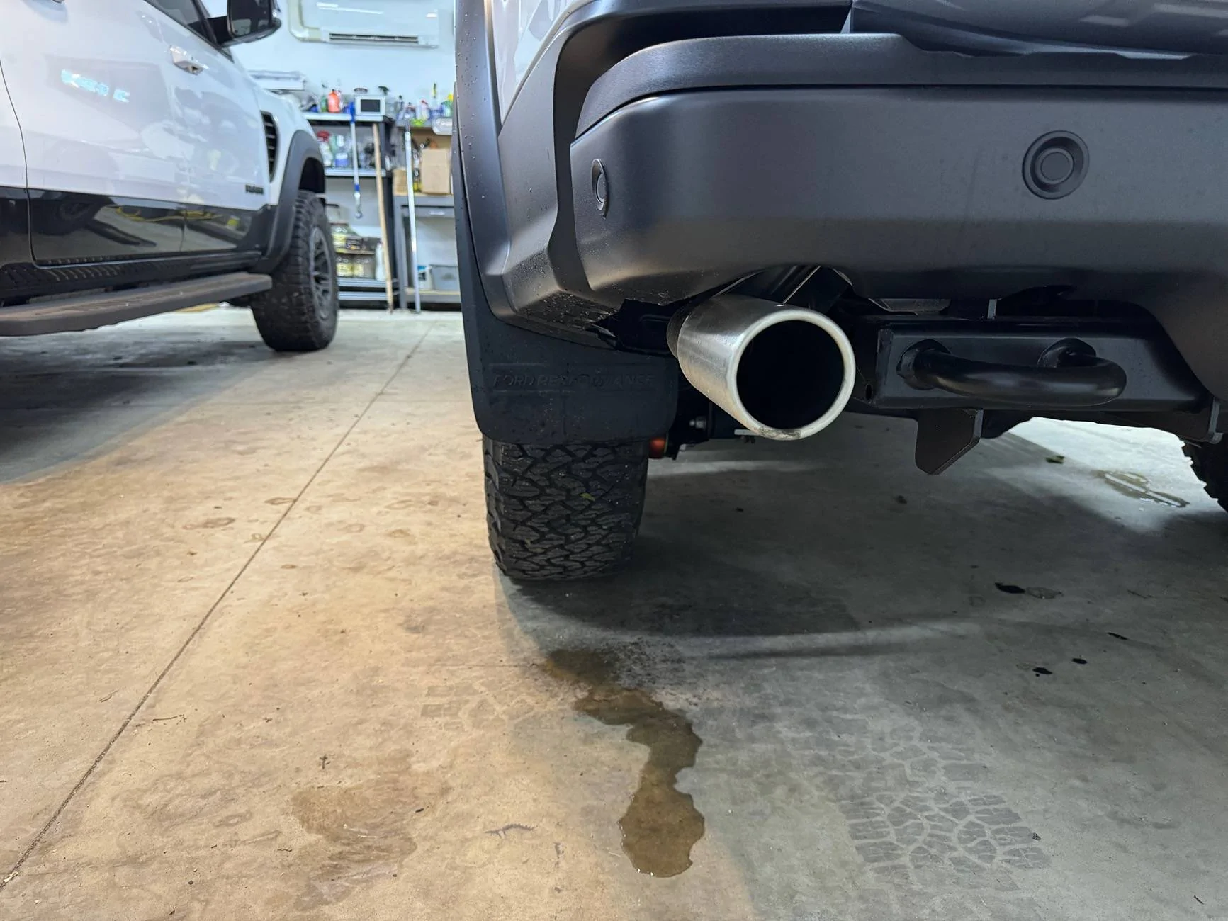

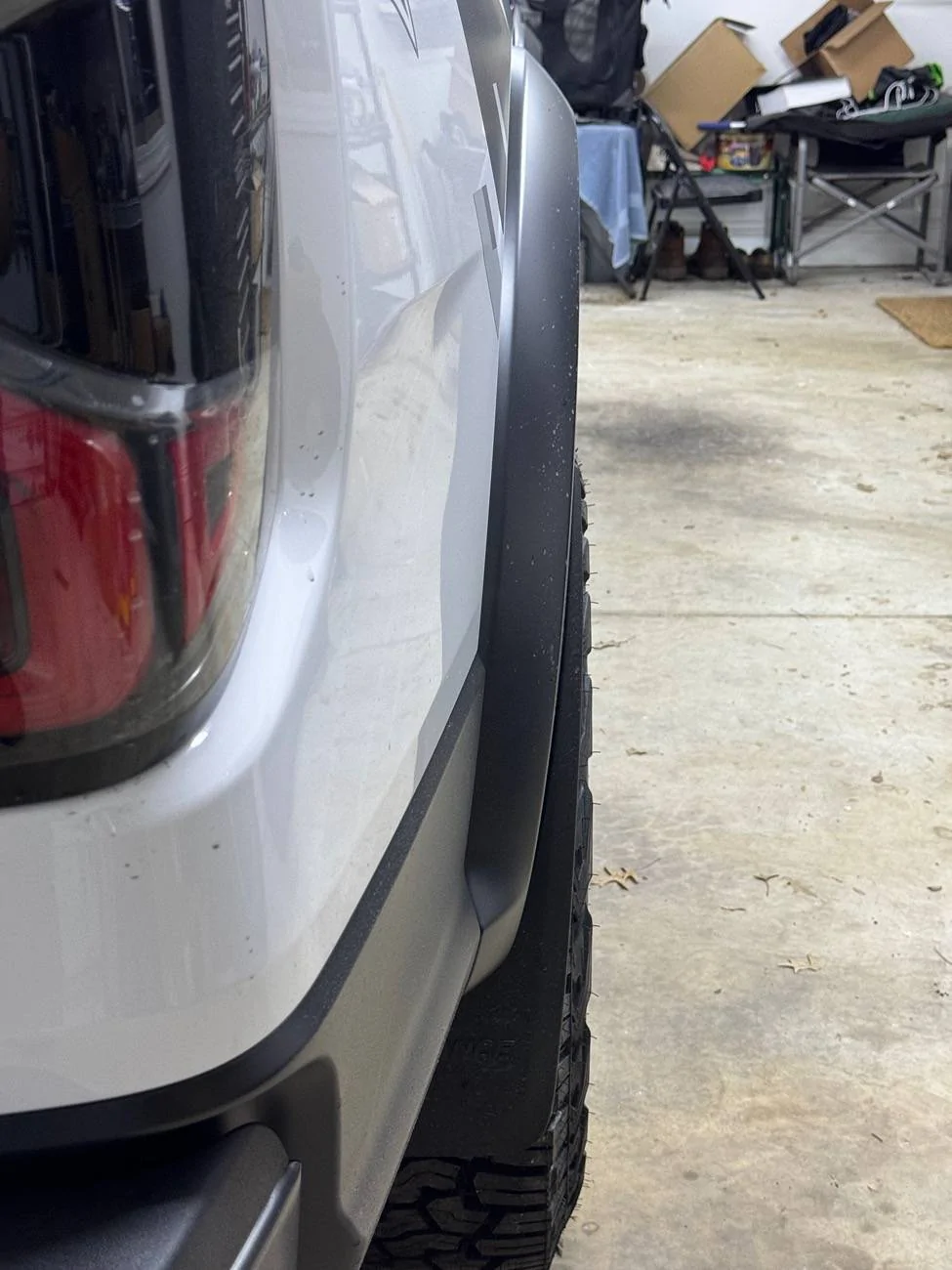

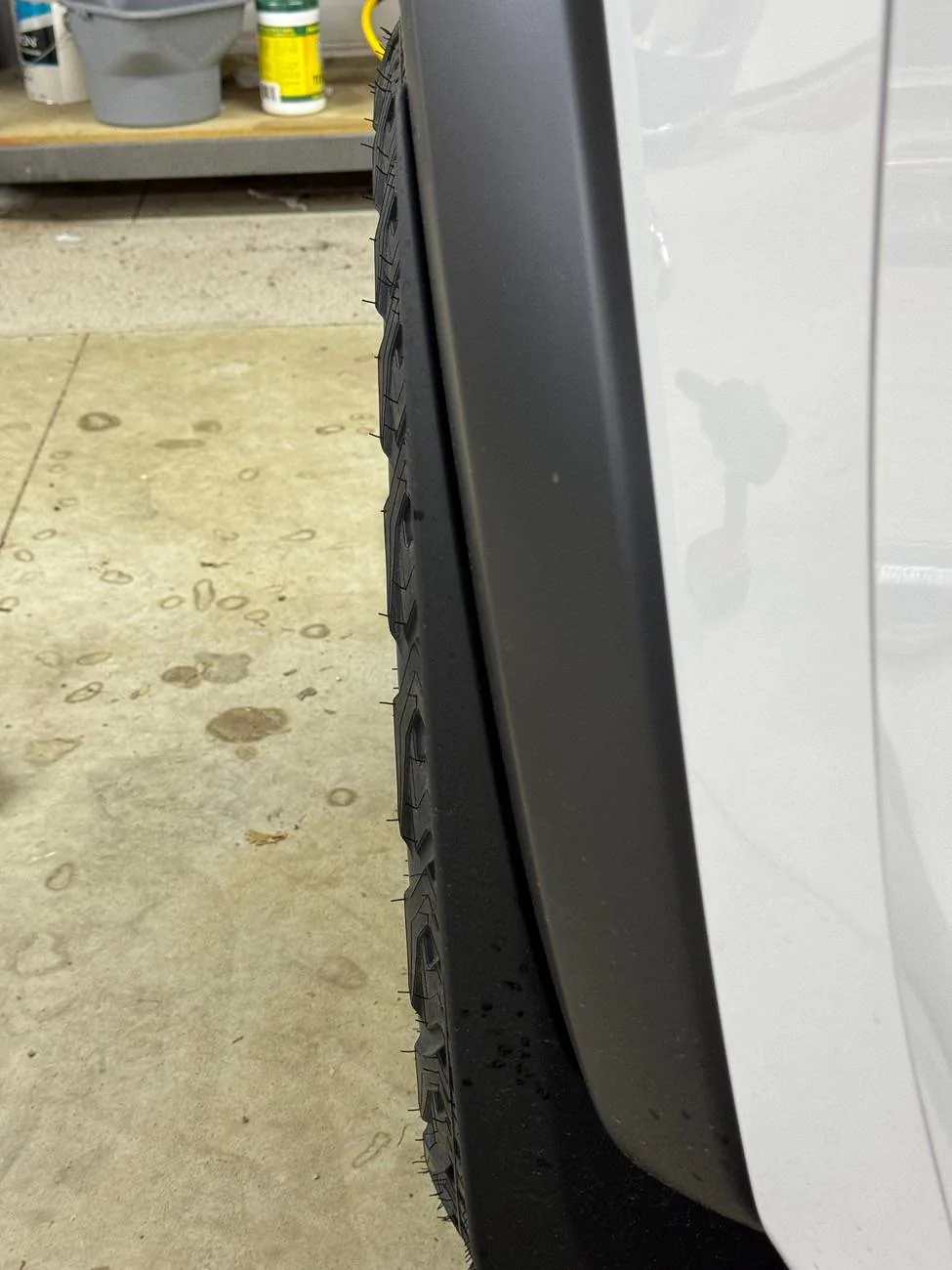

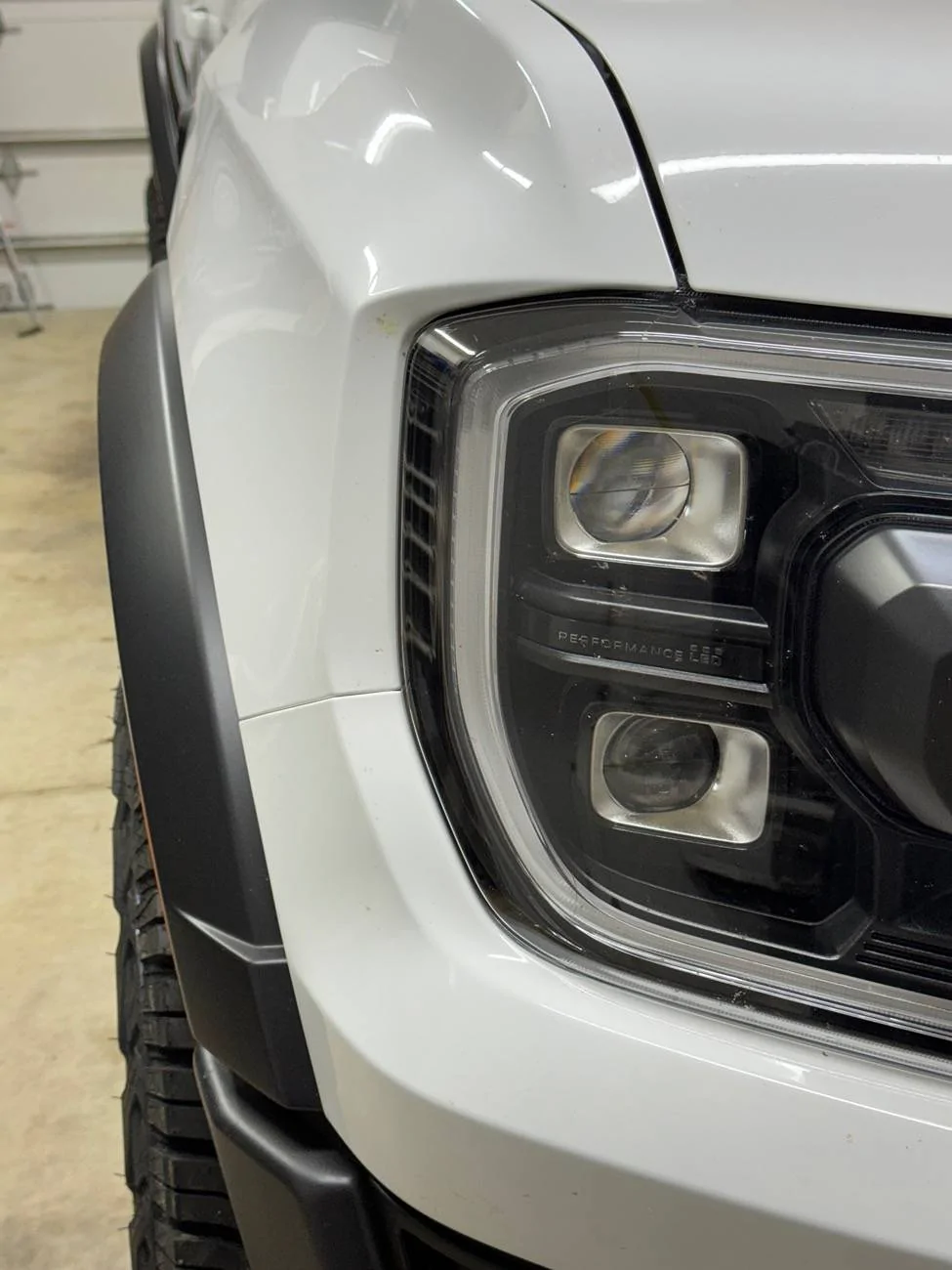

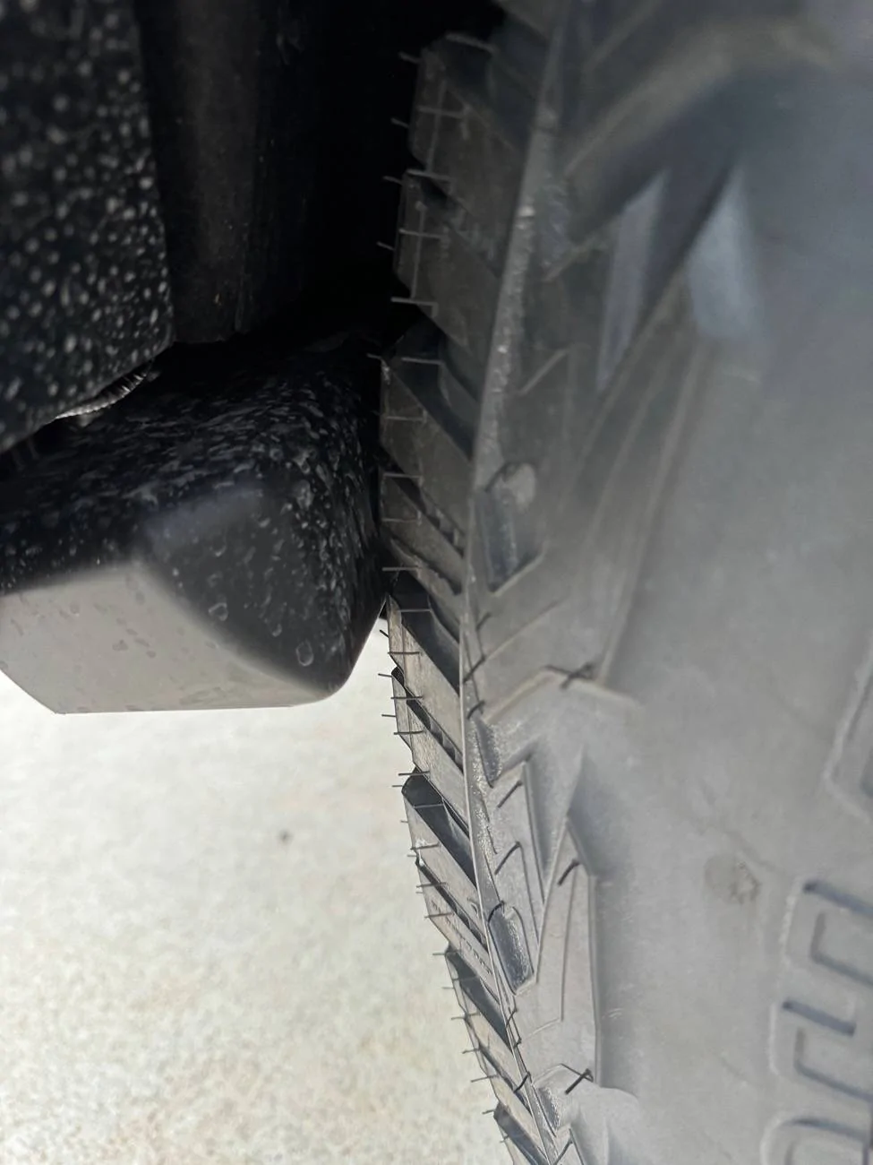

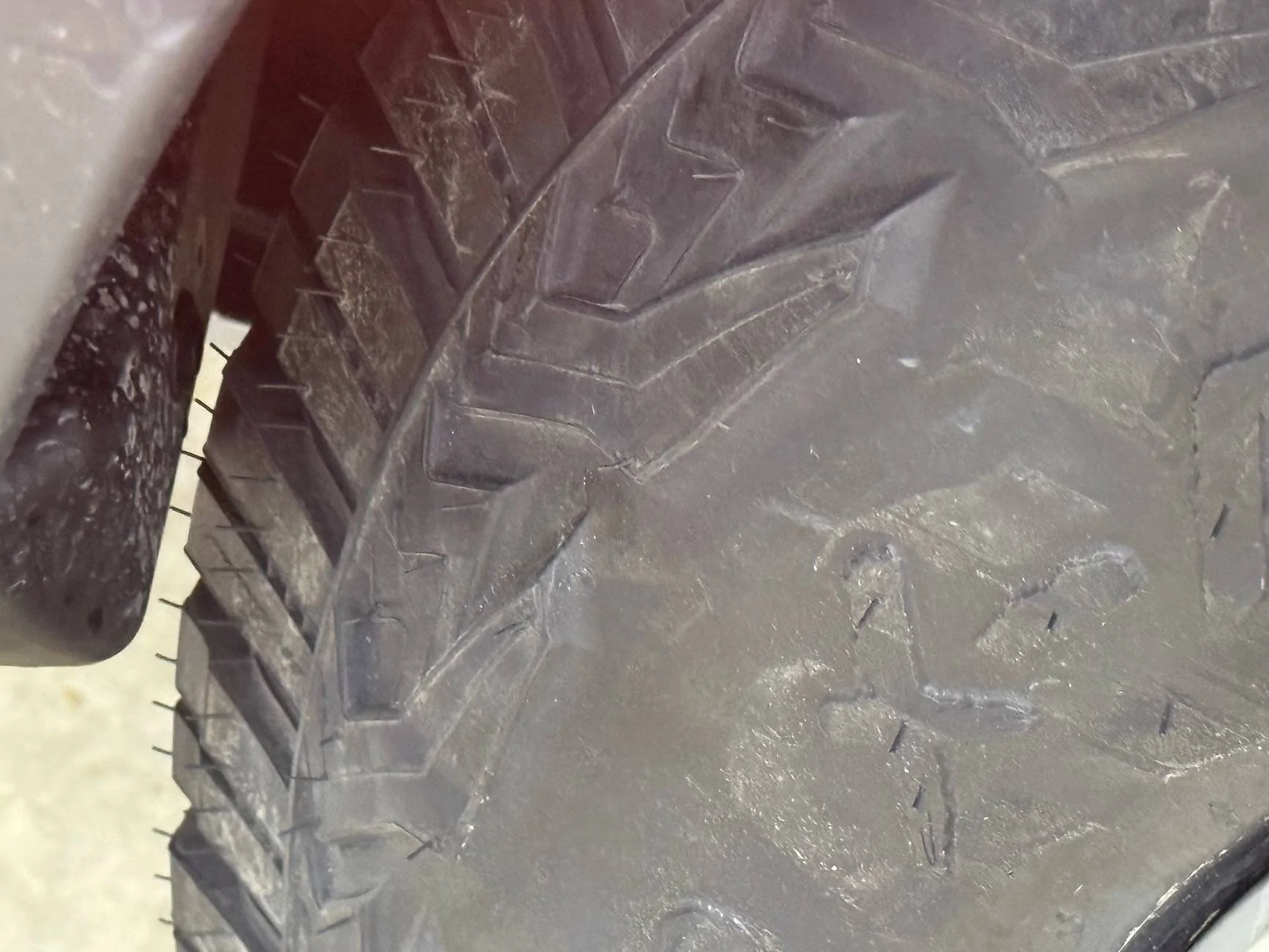

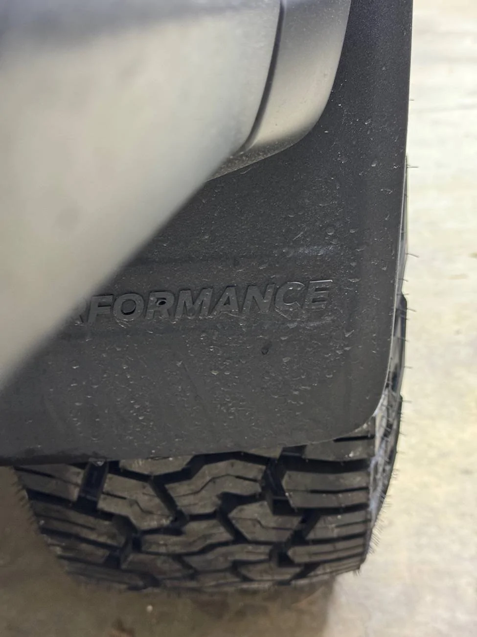

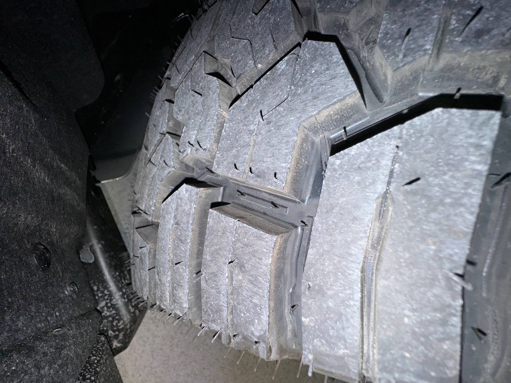

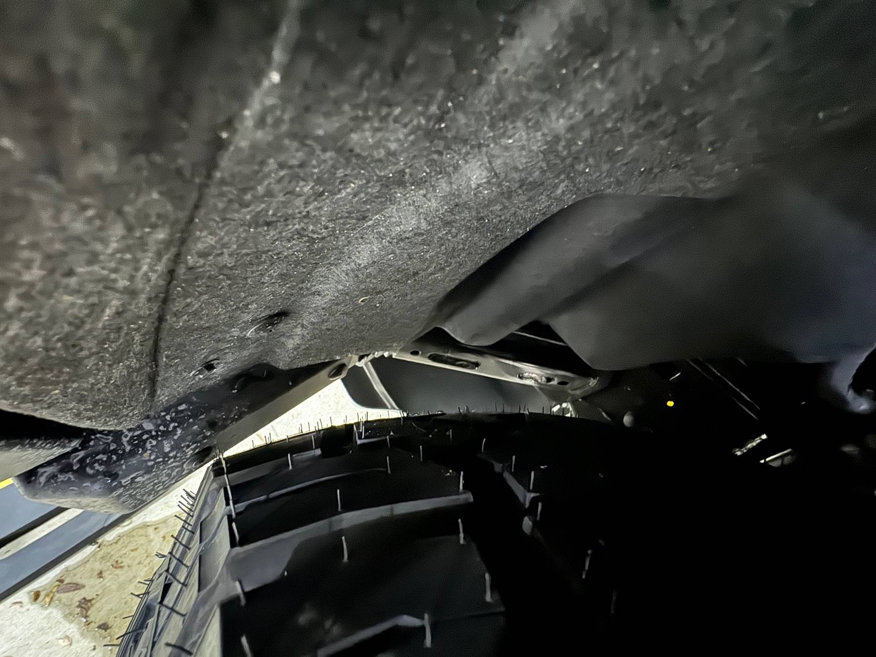

Also grabbed a couple pics of my reverse left front rub / contact with the crash bar, the right side seems to be clearing the crash bar. Only the left side and only when In reverse backing up am I getting any rubbing.
Ford Ranger Wheels & Tires sorted: 295/70R17 34” tall 12” wide +30 offset / Update +30 offset now running Falken AT4W P285/70R17s IMG_8270
Ford Ranger Wheels & Tires sorted: 295/70R17 34” tall 12” wide +30 offset / Update +30 offset now running Falken AT4W P285/70R17s IMG_8268
Ford Ranger Wheels & Tires sorted: 295/70R17 34” tall 12” wide +30 offset / Update +30 offset now running Falken AT4W P285/70R17s IMG_8266
Ford Ranger Wheels & Tires sorted: 295/70R17 34” tall 12” wide +30 offset / Update +30 offset now running Falken AT4W P285/70R17s IMG_8267

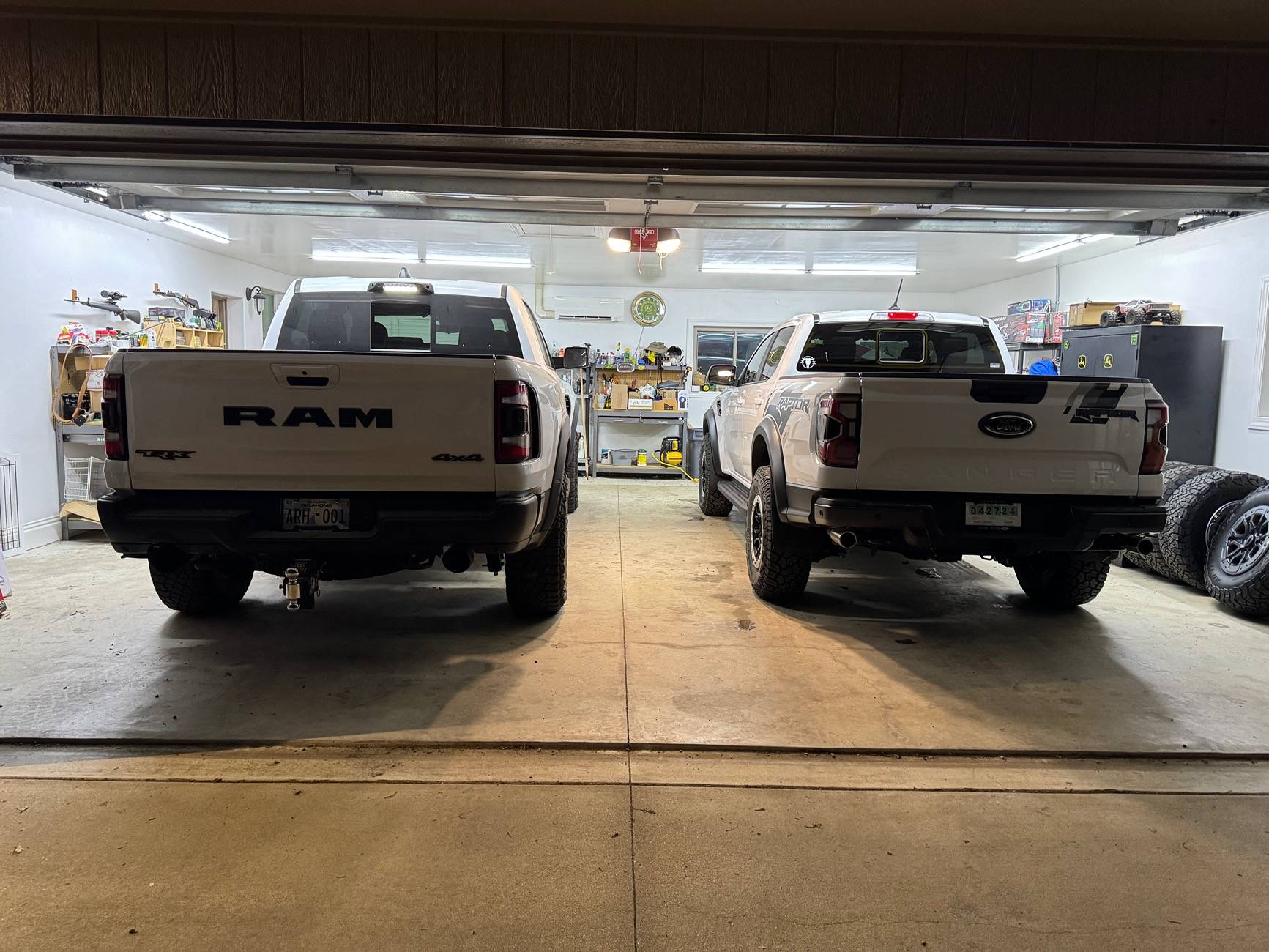

The crash bars look a lot like the ones that come on the Bronco’s or rather get deleted on Sasquatch 35” tire Bronco’s . My Bronco has the Sasquatch pkg so no crash bars, I did buy caps to cover the holes where the Crash bars would have been on a smaller tire Bronco.
Sportshot2
Jerry
Apr 8, 2024
69
65
Wisconsin
2019 F 150 FX4 (totaled) 2021 Acura RDX, 2021 KIA
Love it, guns on the wall and off road trucks in the garage. I am just amazed that you felt the urge to change tires before you even took delivery.
