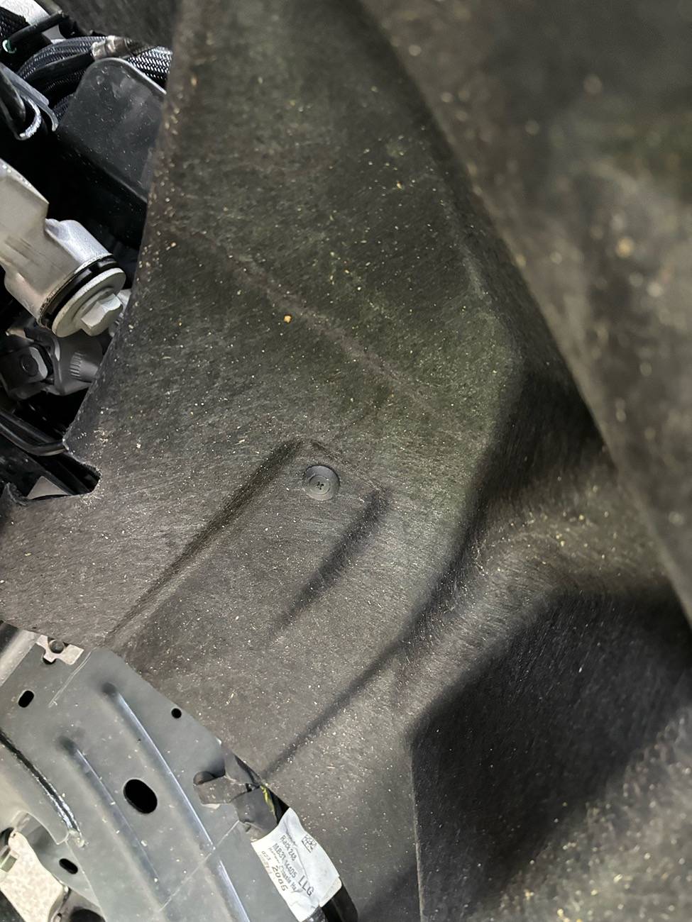

There's no door, but that cut out on the left could be for an extension.
Ford Ranger Access to 2.3 Engine Oil Filter Any Better? IMG_5705

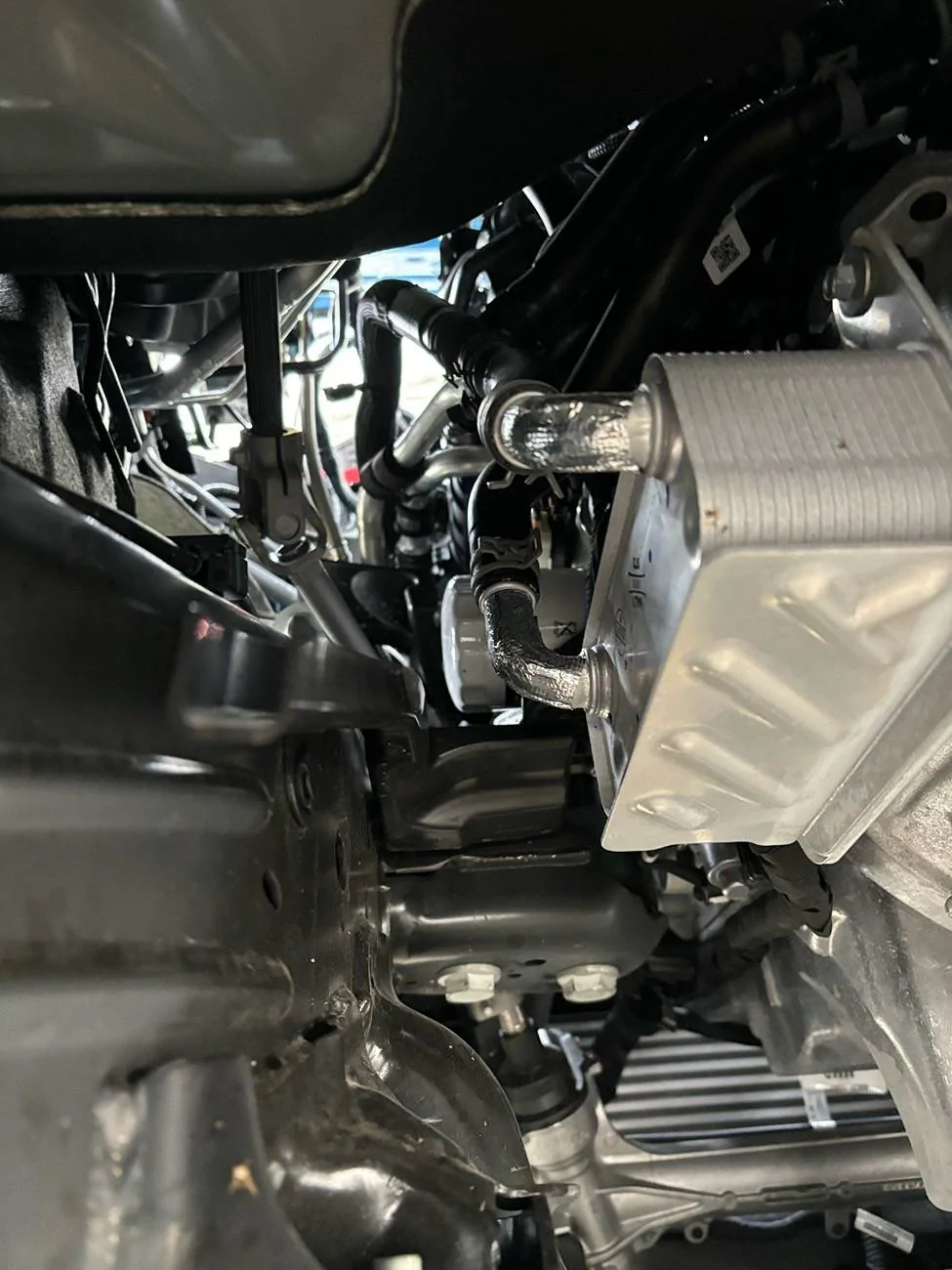

The view from underneath.
Ford Ranger Access to 2.3 Engine Oil Filter Any Better? IMG_5706

Hell of a lot more room in that engine bay for sure, i can look right down at the filter, would have never saw it before. Truck is fresh to me, but I assume it will come out the same way as the old one.
