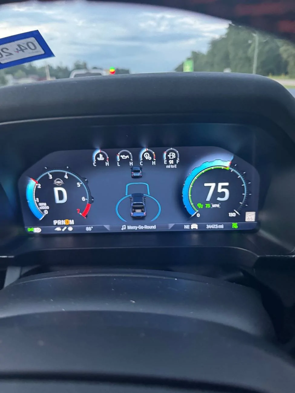

The instrument panel does not appear to show an icon indicating that the vehicle in front of my Raptor is within range. My 5th gen Ranger indicated a solid vehicle image/icon on the screen once the vehicle in front came within range and my speed was being adjusted accordingly. Can someone take a pic of the gauges while using adaptive cruise behind a slower vehicle please? Maybe I am missing something? Thanks in advance!!

Not that easy or safe as you have to be driving and be on your phone at the same time… but if you look on the bottom right of your screen under the speed gauge.,, when you get behind someone you will see the icon of a vehicle ahead of you.., you can also move your center cluster to the screen where it has your truck in the center with a circle around the vehicle and have a rectangle in front of the vehicle and leave it there., it should also respond when a vehicle is ahead of you.

How do you "move your center cluster to the screen where it has your truck in the center with a circle around the vehicle and have a rectangle in front of the vehicle and leave it there" I don't know where that option is.

What I meant is your main screen in front of your steering wheel.. not your infotainment center… this is what it will look like in its max size
