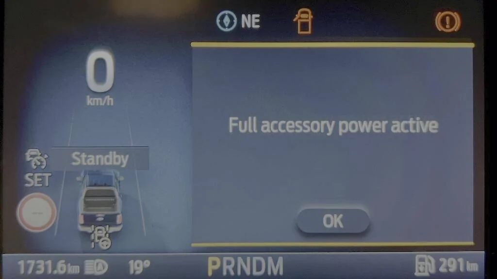

That said, I can't get IACC + TSR to work properly? TSR picks up traffic signs perfectly but IACC does not automatically adjust the cruise speed when TSR picks up a new traffic speed limit sign:
Ford Ranger Intelligent Adaptive Cruise Control + Traffic Sign Recognition | Automatically adjust Cruise Speed 1734905084641-r7

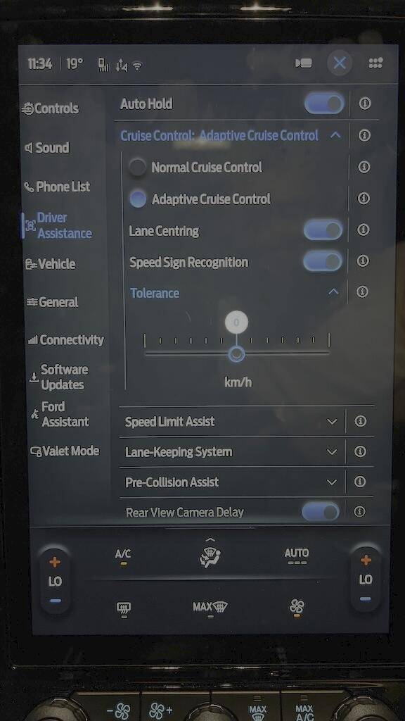

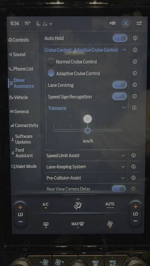

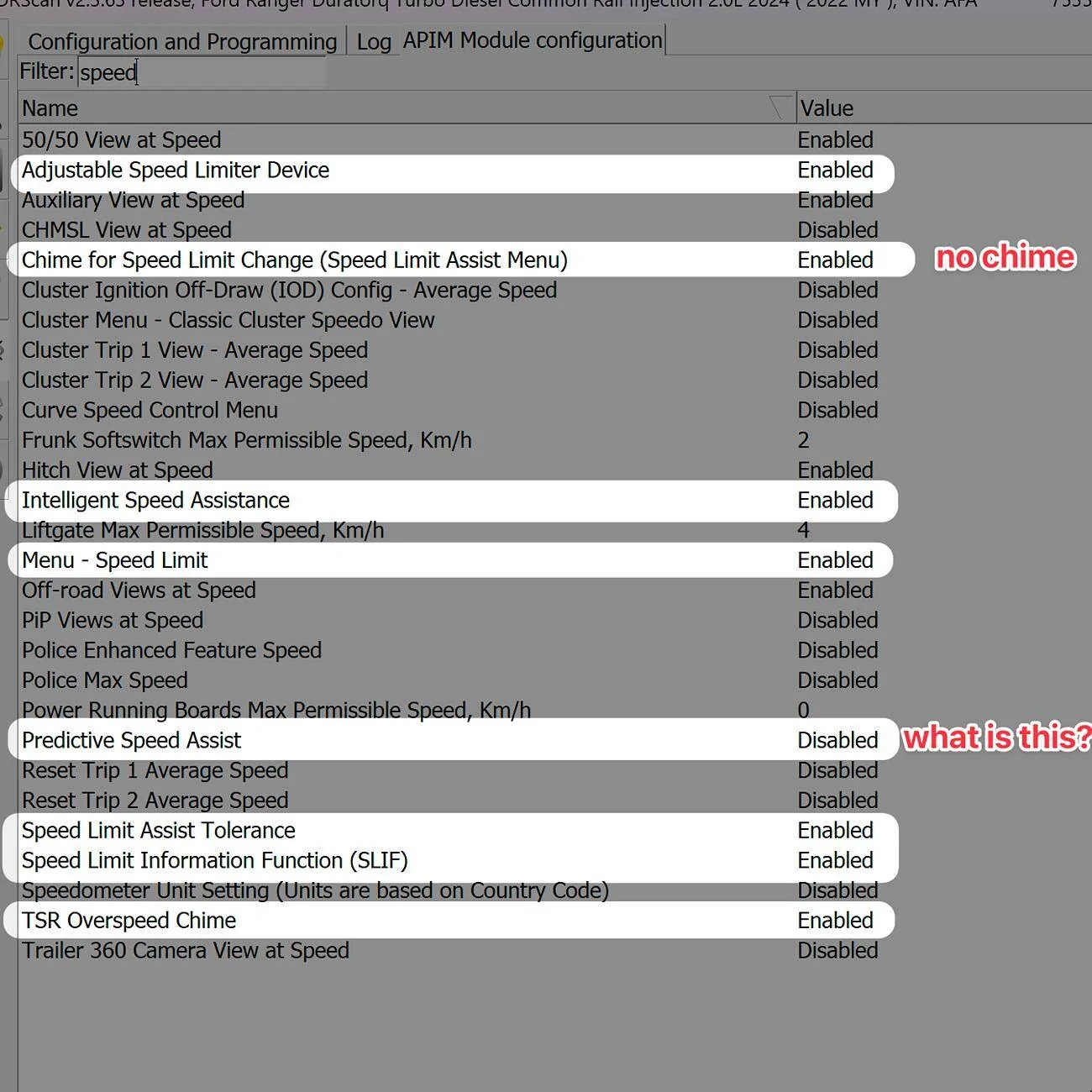

In SYNC, under the Adaptive Cruise Control menu, all the settings are there, including the tolerance slider but those don't seem to have any effect, like I'm missing a configuration setting:
Ford Ranger Intelligent Adaptive Cruise Control + Traffic Sign Recognition | Automatically adjust Cruise Speed 1734905110624-
I just can't seem to get the speed of the IACC to adjust based on what TSR picks up.

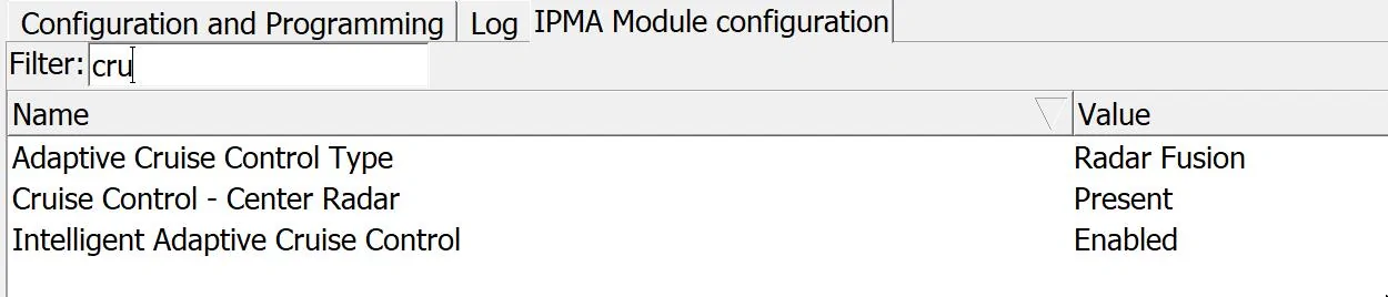

Ford Ranger Intelligent Adaptive Cruise Control + Traffic Sign Recognition | Automatically adjust Cruise Speed 1734902317158-ts
Ford Ranger Intelligent Adaptive Cruise Control + Traffic Sign Recognition | Automatically adjust Cruise Speed 1734902336292-km

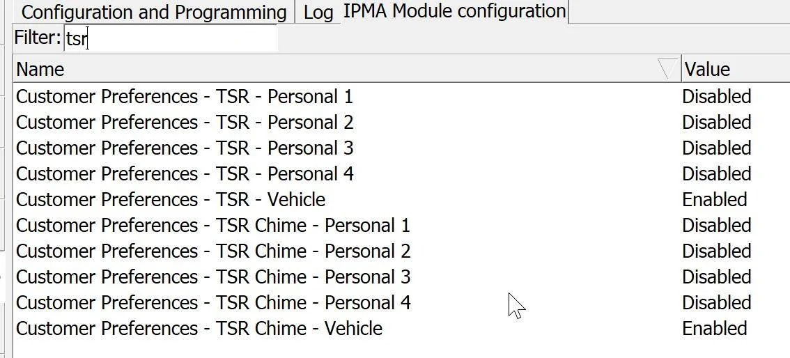

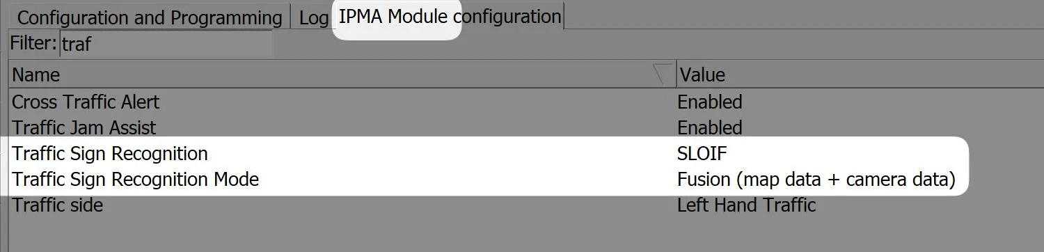

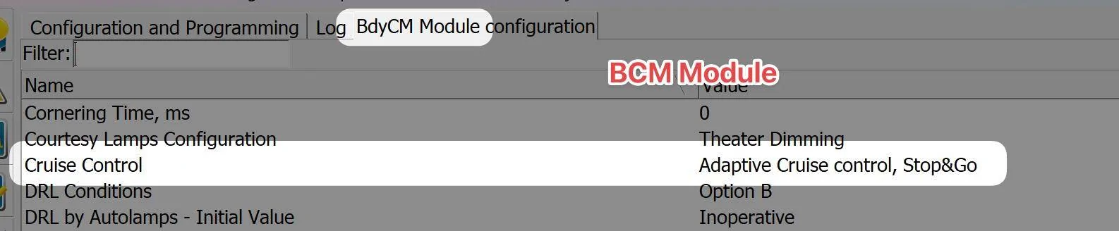

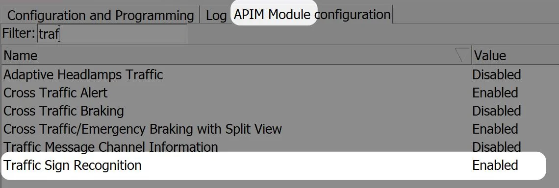

I've tried both SLOIF and SLIF options in "Traffic Sign Recognition":
Ford Ranger Intelligent Adaptive Cruise Control + Traffic Sign Recognition | Automatically adjust Cruise Speed 1734902357418-6d
Ford Ranger Intelligent Adaptive Cruise Control + Traffic Sign Recognition | Automatically adjust Cruise Speed 1734902428898-3a
Ford Ranger Intelligent Adaptive Cruise Control + Traffic Sign Recognition | Automatically adjust Cruise Speed 1734902444657-u
Ford Ranger Intelligent Adaptive Cruise Control + Traffic Sign Recognition | Automatically adjust Cruise Speed 1734902405897-9q

Have you manage to get it to work? Try to enable predictive speed assist. For me it is working.
On the same topic, how did you manage to make the limiter to work with TSR? I did all the changes but when I try to enable it in sync it moves back to manual.

Hey Alex77, what did you enable exactly in Forscan? I have given up on enabling TSR and IACC ar this point.

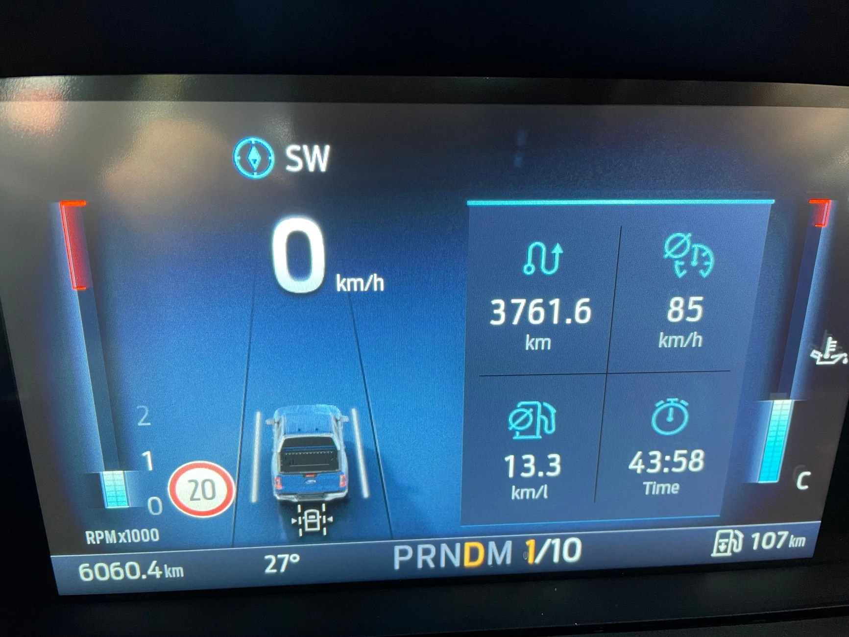

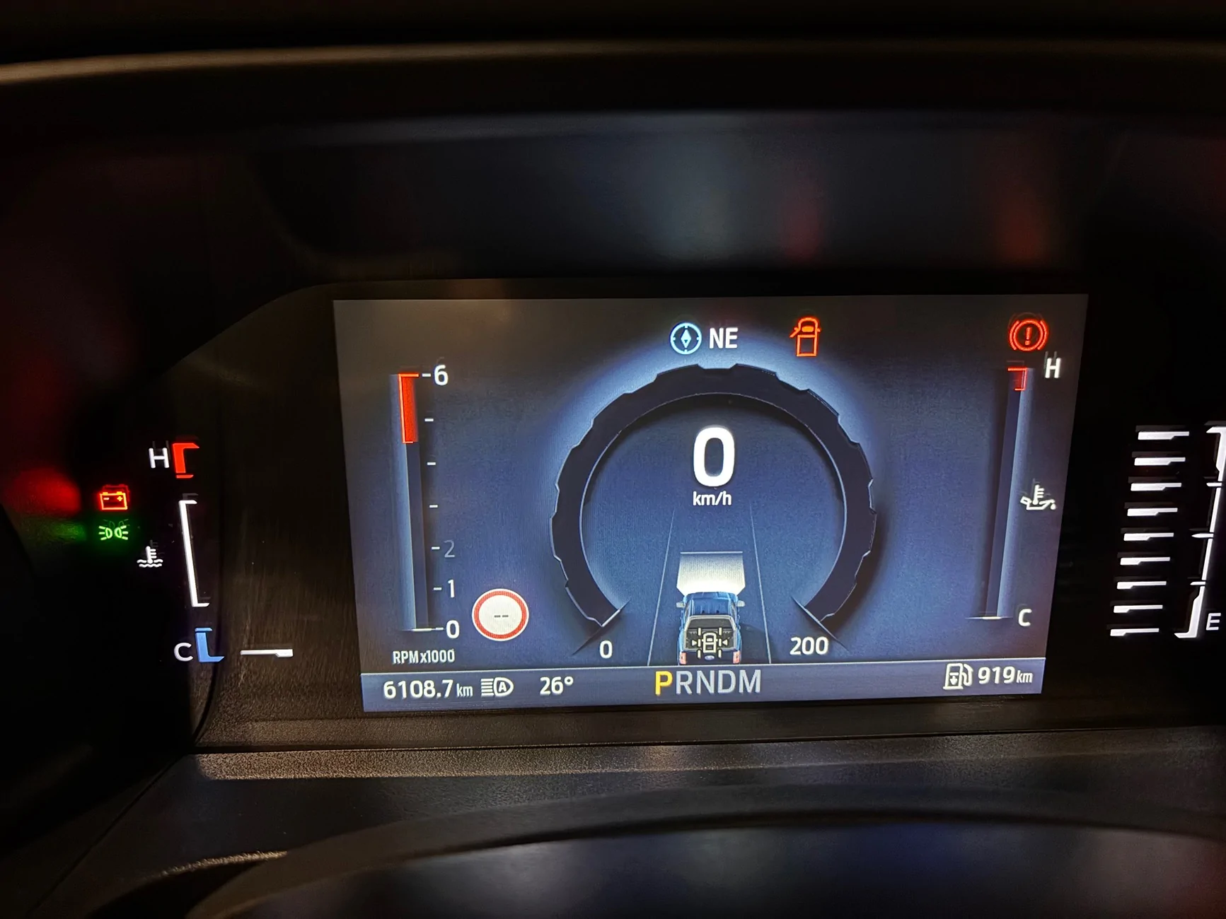

Any idea on how I can get the Speed Sign on the Cluster to use the Speed data from the built in Navigation and not only when it reads a sign?
If you pass a sign it would show and a while later it would show (--)
My previous 2023 XLT showed the speed all the time, assuming it got it from the Navigation.

Ford Ranger Intelligent Adaptive Cruise Control + Traffic Sign Recognition | Automatically adjust Cruise Speed IMG_0415
