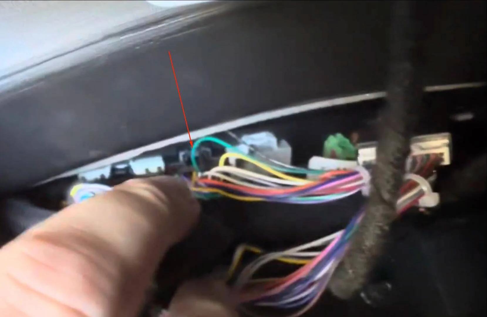

Video of one of my first drives running OP in the ranger last summer.
When you connected under the dash, did you connect to the unused gray connector, or the black connector? Thanks. That is my last step for my install.
Behind the cluster? I believe it was the left most connector that it could fit into. You remove the connector that's in there, plug the harness into it, and then plug the connector you removed into the other end of the harness.. the 3d printed looking thing. USB cable goes into the center piece of the harness and the power cable goes from that down to the ODBC port.
See picture. Red arrow pointing to connector. From video linked below.
Thank you, a lot.
