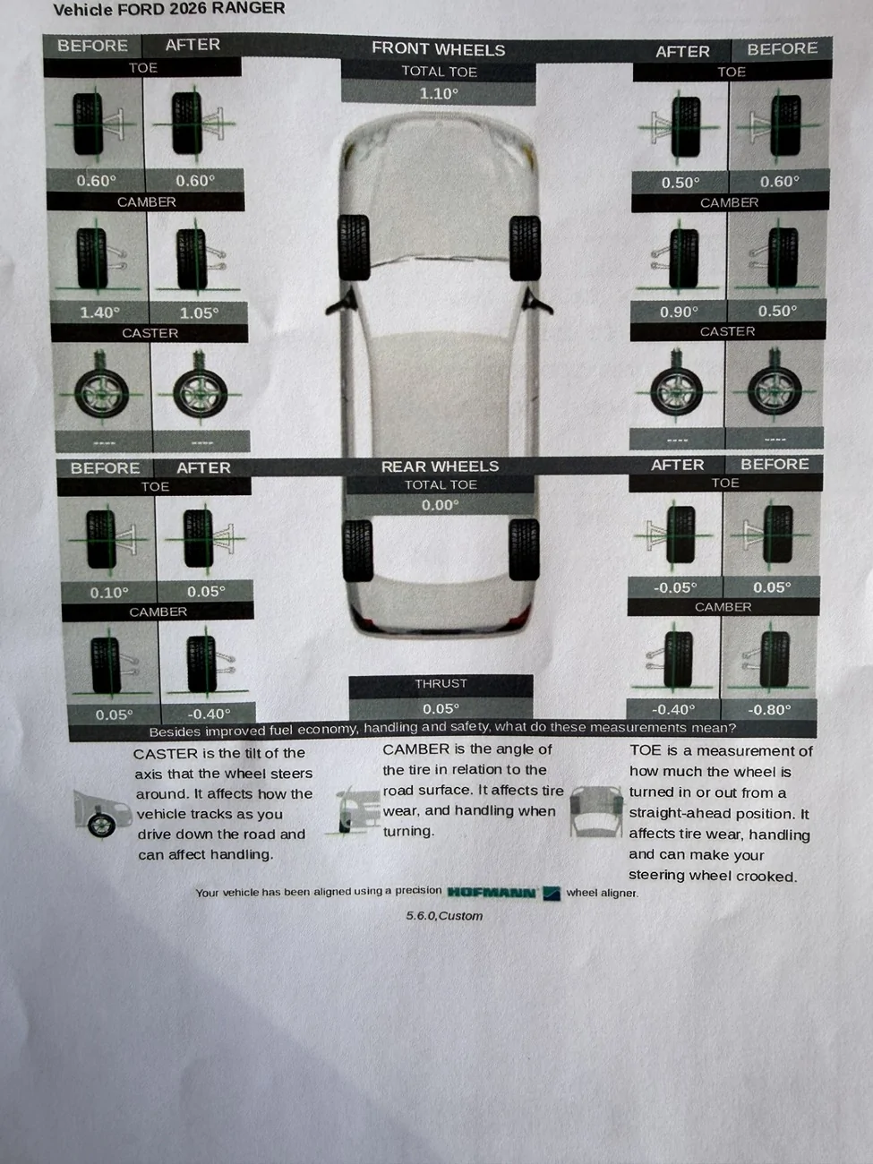

Do these numbers look good for a ford ranger 2026 with a 2" leveling kit and 265/70/17? Thanks!
DOZIKK New Member First Name Lex Joined Jan 27, 2026 Threads 1 Messages 2 Reaction score 1 Location Montreal Vehicle(s) Ford Ranger 2019 May 20, 2026 Thread starter #1 Do these numbers look good for a ford ranger 2026 with a 2" leveling kit and 265/70/17? Thanks! Sponsored
superj Well-Known Member First Name Jason Joined Feb 8, 2025 Threads 41 Messages 3,551 Reaction score 3,301 Location Corpus christi texas Vehicle(s) 2024 ford ranger, 2019 wrangler, 2018 mazda3 Occupation Retired May 22, 2026 #2 They are all in the green so i geuss they are ok. The right rear is alot more camber then the left rear though, double
Bluestra1n Active Member Joined Aug 31, 2025 Threads 5 Messages 25 Reaction score 35 Location Pennsylvania Vehicle(s) 2025 Ranger XLT 2.7 May 22, 2026 #3 It’s strange they didnt record your front caster. There should be an oem spec for that. Sponsored
