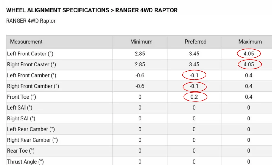

This is what I requested they do after my 2" lift and 35s
