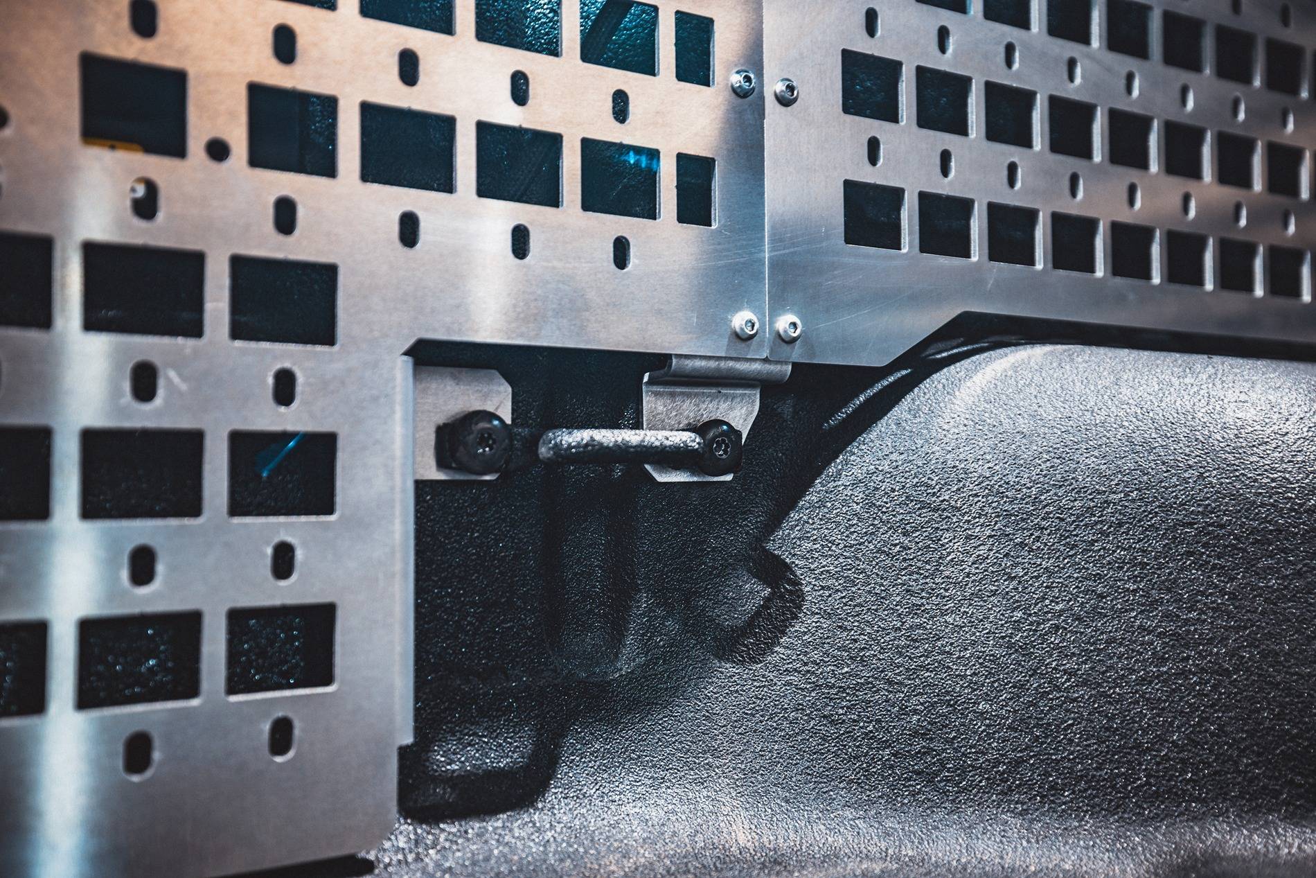

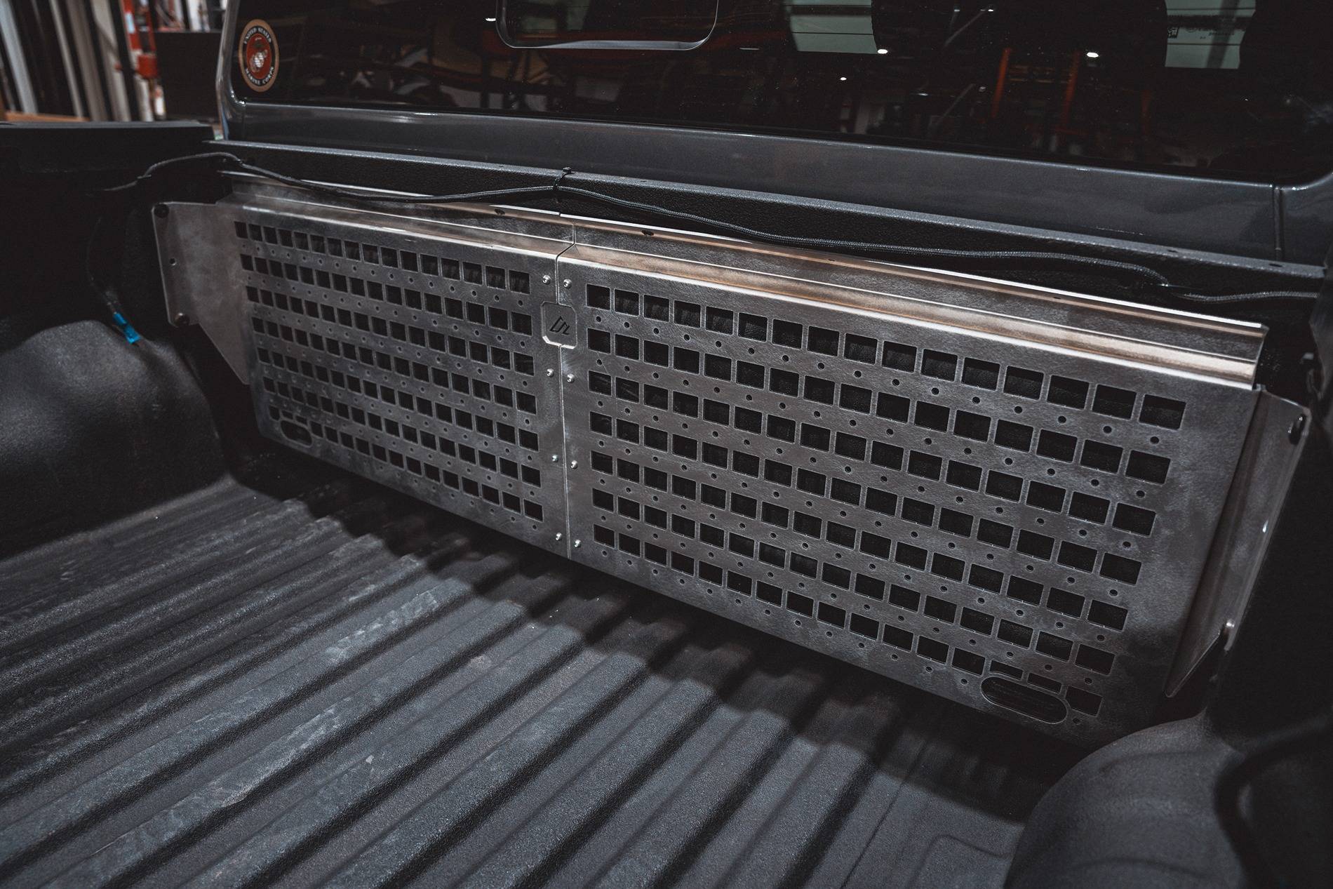

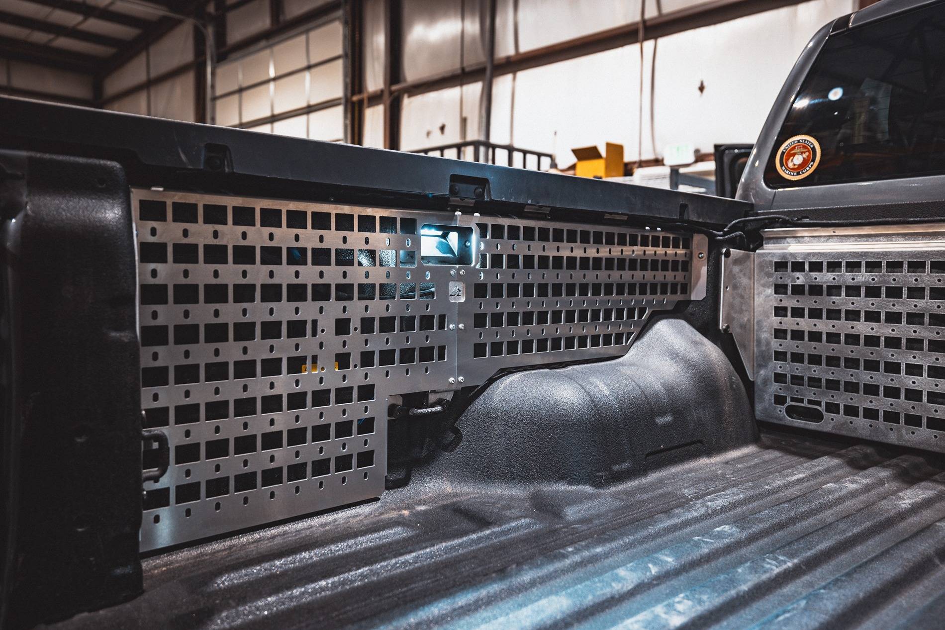

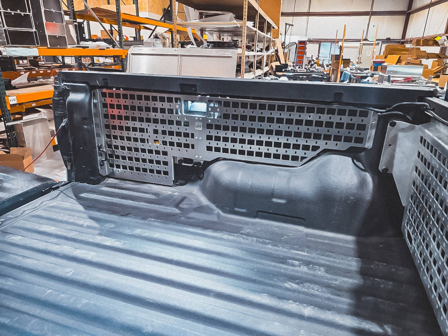

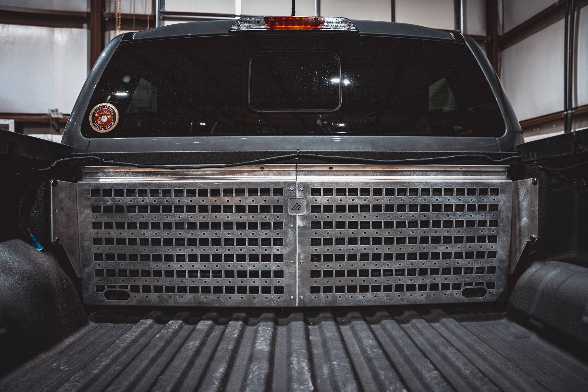

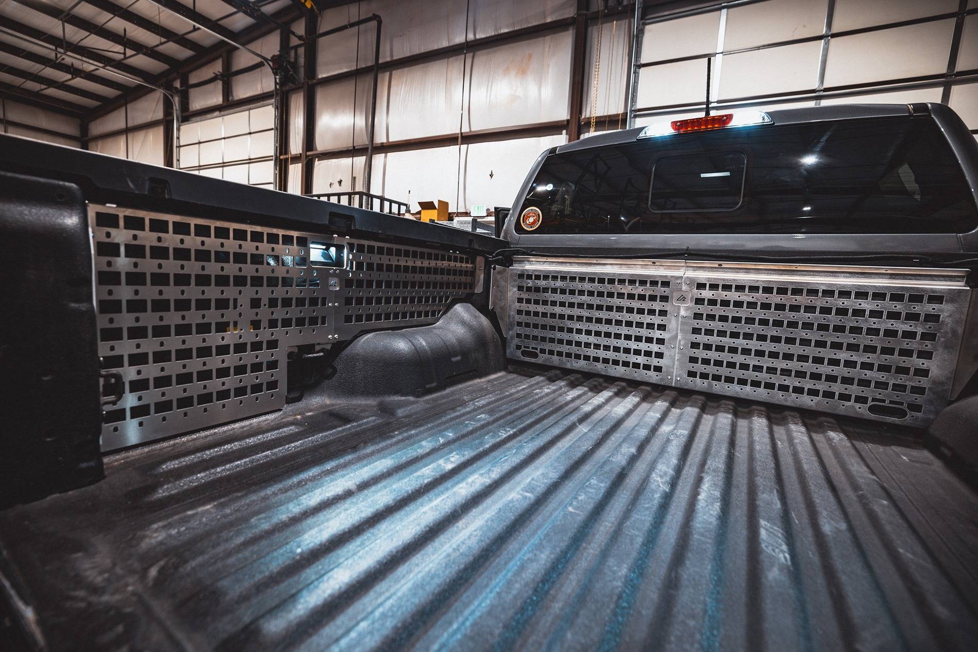

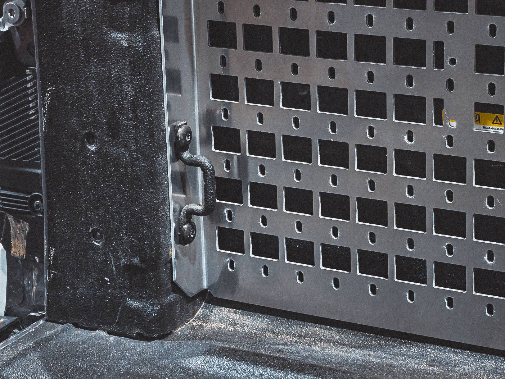

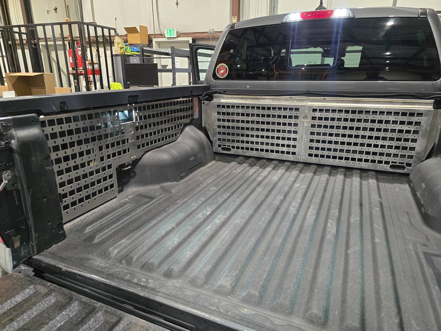

I made these today. They will be for sale in the next week or so. Lots of options coming for the rear half of the side panels (Packout, rotopax, power panel access, etc.)
How much space is there between the bulkhead molle panel and the bed grooves. I was waiting for you guys to drop the panels but I think my T-MAT system might interfere with the bottom of the panel mounted on the bulkhead. I might have to make some modifications to a couple of those T-Mat panels to get mine to fit correctly. Its either going to slide perfectly with a mm or two to spare or ill have to cut some of my polymer panels a bout 2 inches on the end.

About 1/2". I intentionally kept them pretty tight as to not eat up bed space. If you can show me what you're trying to mount, I'll be glad to brainstorm with you on them.

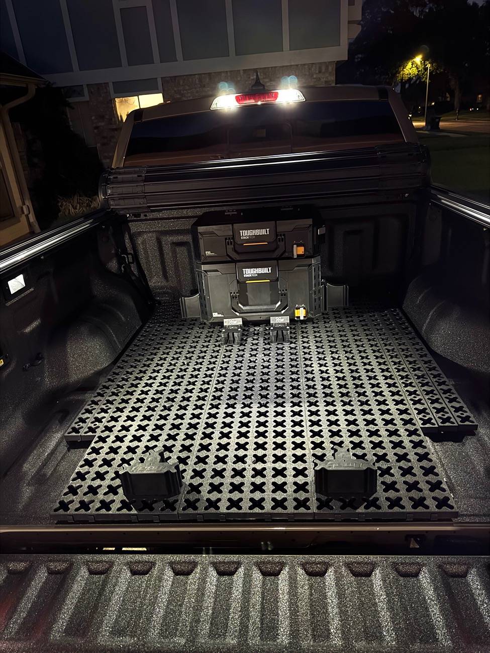

it’s actually this polymer mat system, I think it won’t slide underneath the bulkhead molle panel. They are 0.75in thick.
Might have cut some of my panels so I can shut my tailgate.

How close does it go to the front of the bed; the vertical panel?
