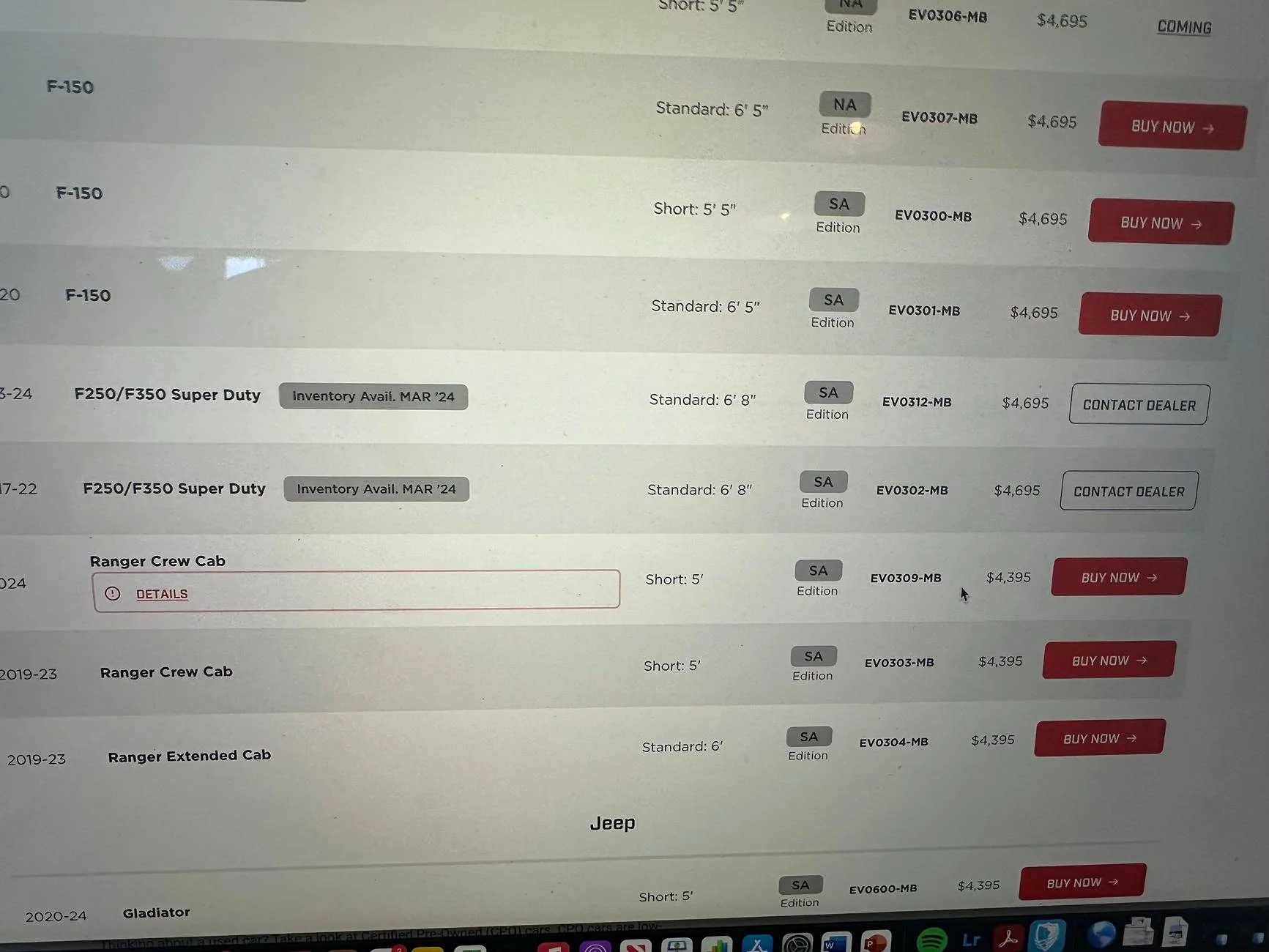

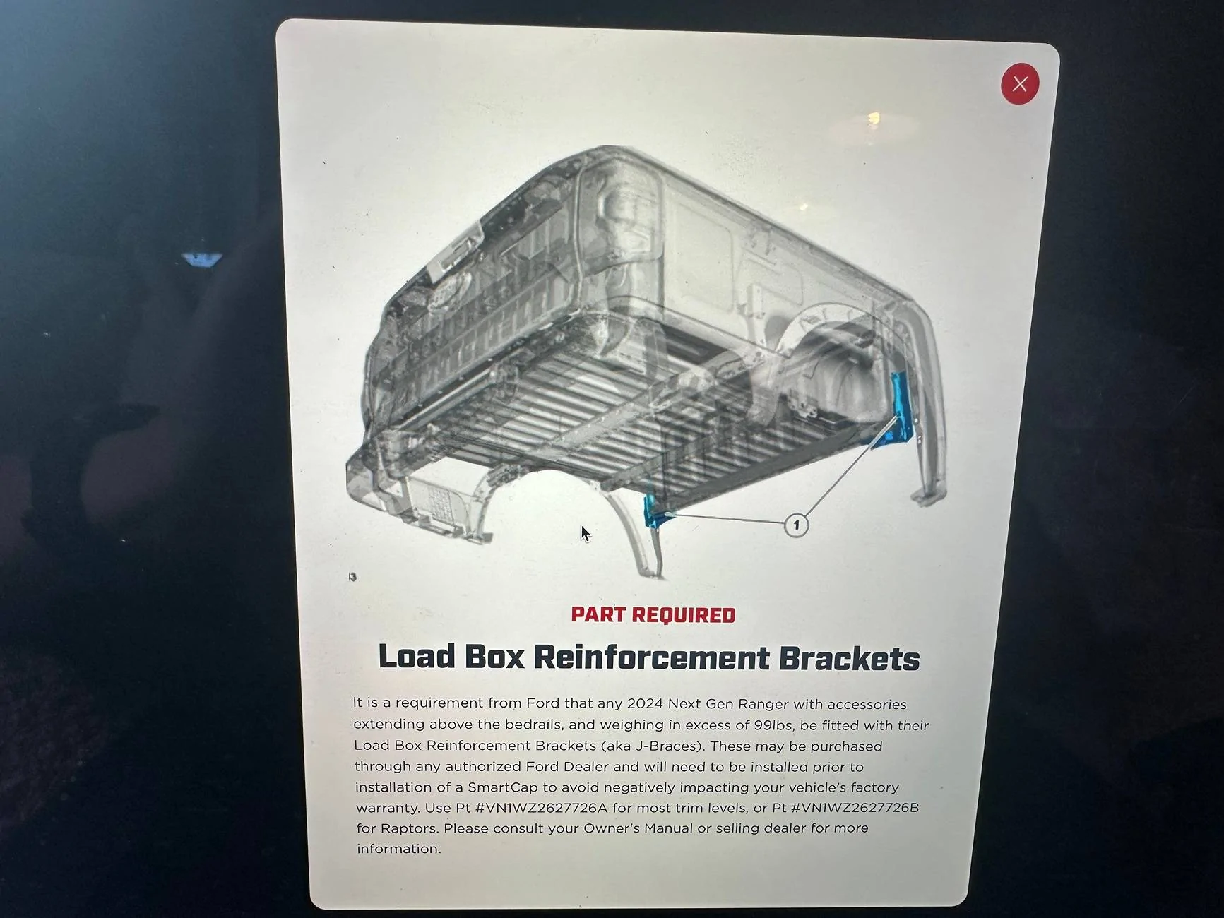

I have been looking at toppers for the Ranger Raptor and was hoping to install the Alucab but they are not available yet and looks like RSI Smartcap is one of the only options for a hard shell topper at the moment. With that, when you go to the RSI website it has a warning that J braces must be installed to support anything mounted to the bed over 99lbs. I have seen this for the international market but can anyone who has taken delivery of their NA Ranger Raptor confirm if these J braces came installed from the factory?
Here is a diagram from the RSI website for reference. Thank you.

yes they are required, you could order them yourself through ford's accessory website or have your dealer order them for you. Mine are at my dealer waiting on my truck... :(
2,296
3,062
Plan to add them to mine as well. I am going to have a crossover style toolbox on mine with a lighted headache rack with side grab rails. I did read the upfit guide the J brace requirements were anything on top the rails over 88 pounds.

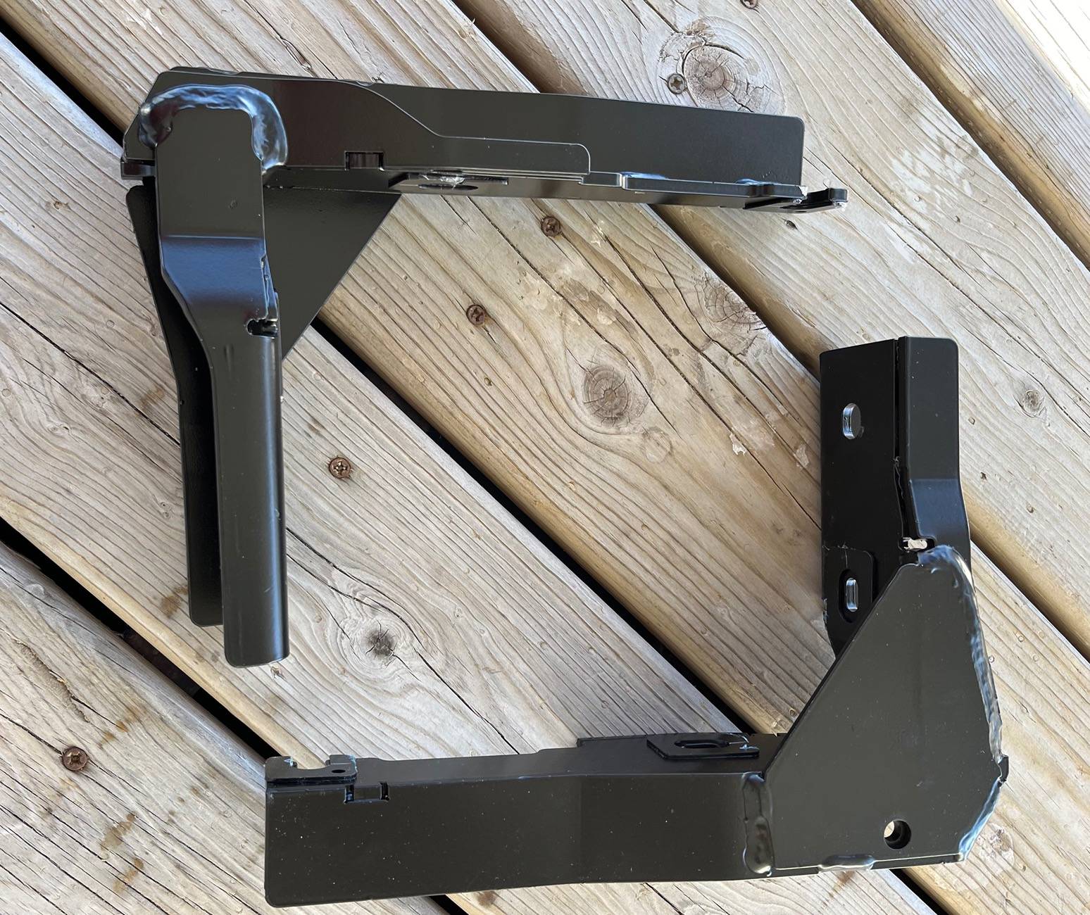

I ordered and received the J-Braces so they were available from Ford. I have not yet received my Ranger yet but will be installing them when it arrives. Just search 'J-Braces' and the posts should pop up along with Ford part numbers

If you look further down in that linked thread you will see that the J-Braces are only included if you order certain Ford accessories like a bed topper.
J-Braces

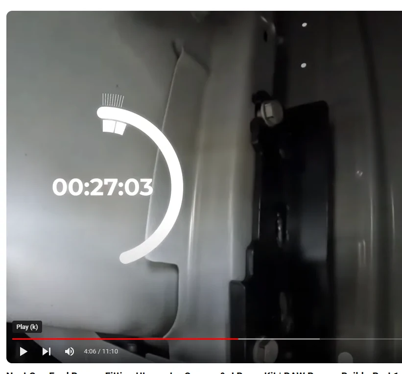

Do you plan on installing them yourself? If so are you going to make a video and post it? I’ve been unable to find a video of how to install them.
Someone else posted this originally - so I am not taking their credit, but this video shows the install.
Looks like at least 30 mins per side. They show it done at 27 minutes, but the fender / wheel liner(s) still need riveted back in and bed put back together. I would guess 1 1/2 hrs total time.
Ford Ranger Are J Braces required for topper install on NA Ranger Raptor? 1712147921336-yt
Next Gen Ford Ranger Fitting Utemaster Canopy & J Brace Kit | BAW Ranger Build - Part 1 (youtube.com)
