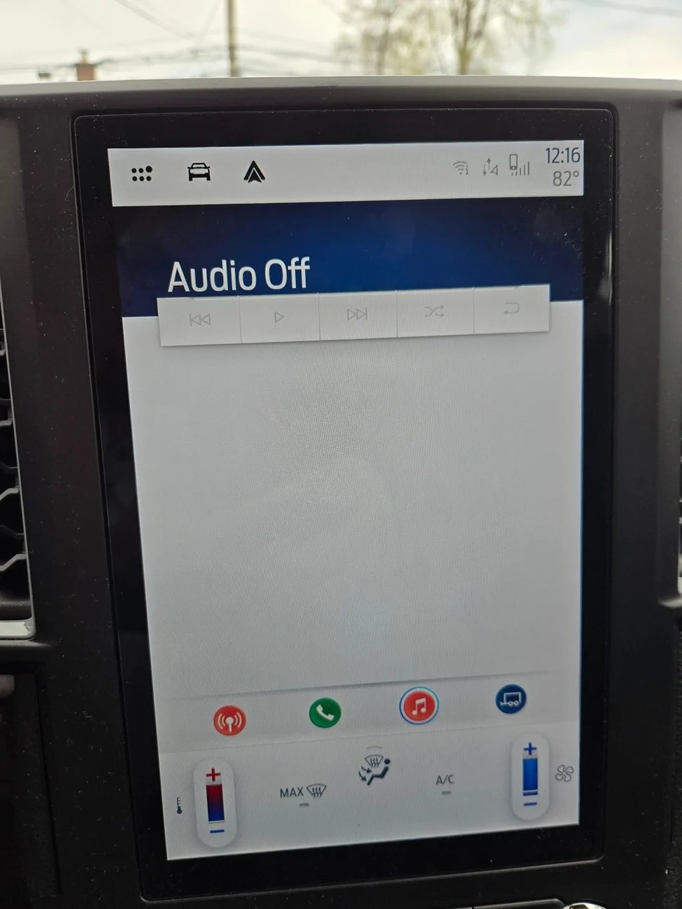

This AM I started my vehicle and system was preparing audio source I was greeted by the message "Audio Off". I pushed the On/Off button with no results. I checked the Sync and Android connections and they appeared to be connected. My maps worked fine, it looks like any attempt to connect to any audio source gives me "Audio Off".
Anybody else experience this? Any solutions?

Thanks to all for the suggestions, the problem has been solved. Apparently I dislodged the Audio fuse while tapping in for dash cam.
