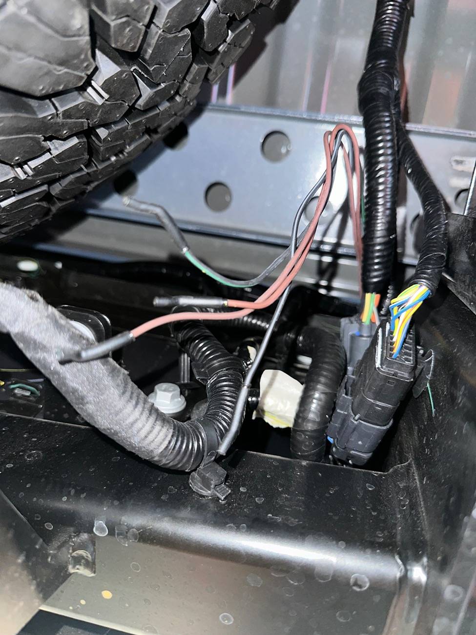

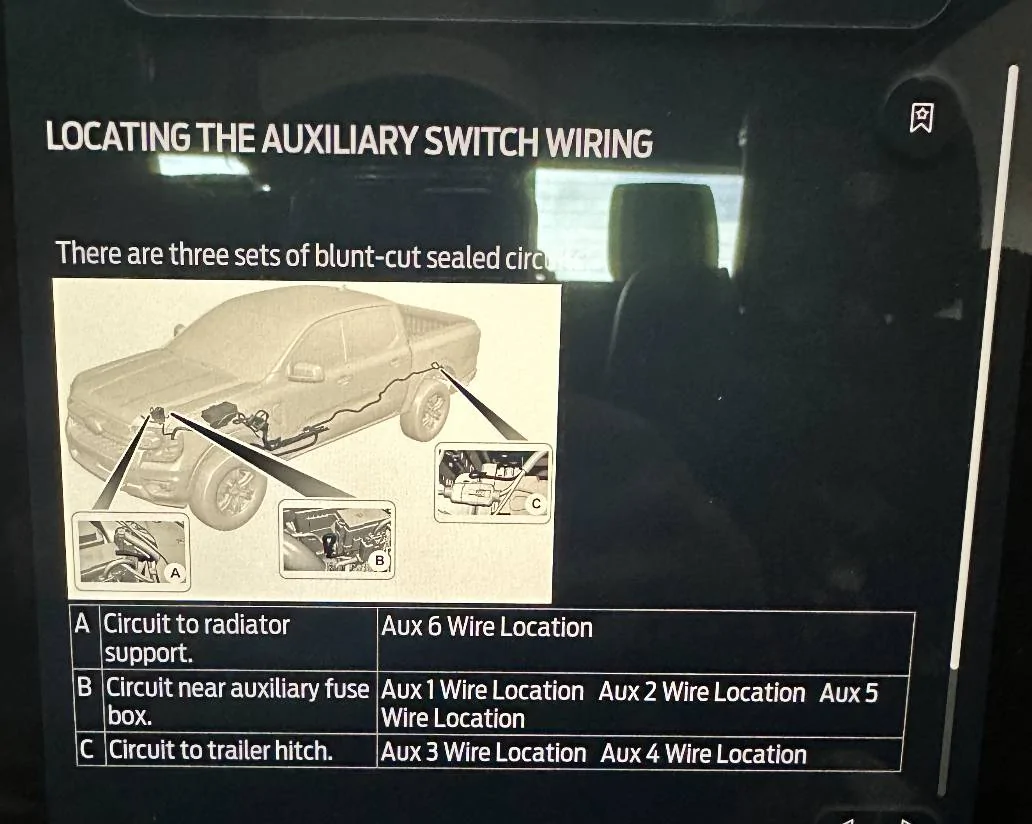

can anyone point me what To look for in area “C” for aux 3 - 4 i am having a difficult time in locating the wires.
Body builder guide says it's suppose to be near trailer towing electrical connector.
Ford Ranger Auxiliary switch location IMG_1011
They are folded up in there behind the bumper/tow bar. Brown ones are positive hot just gotta guess to see which is which switch.
