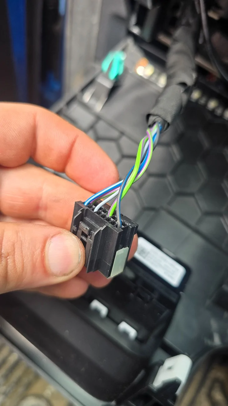

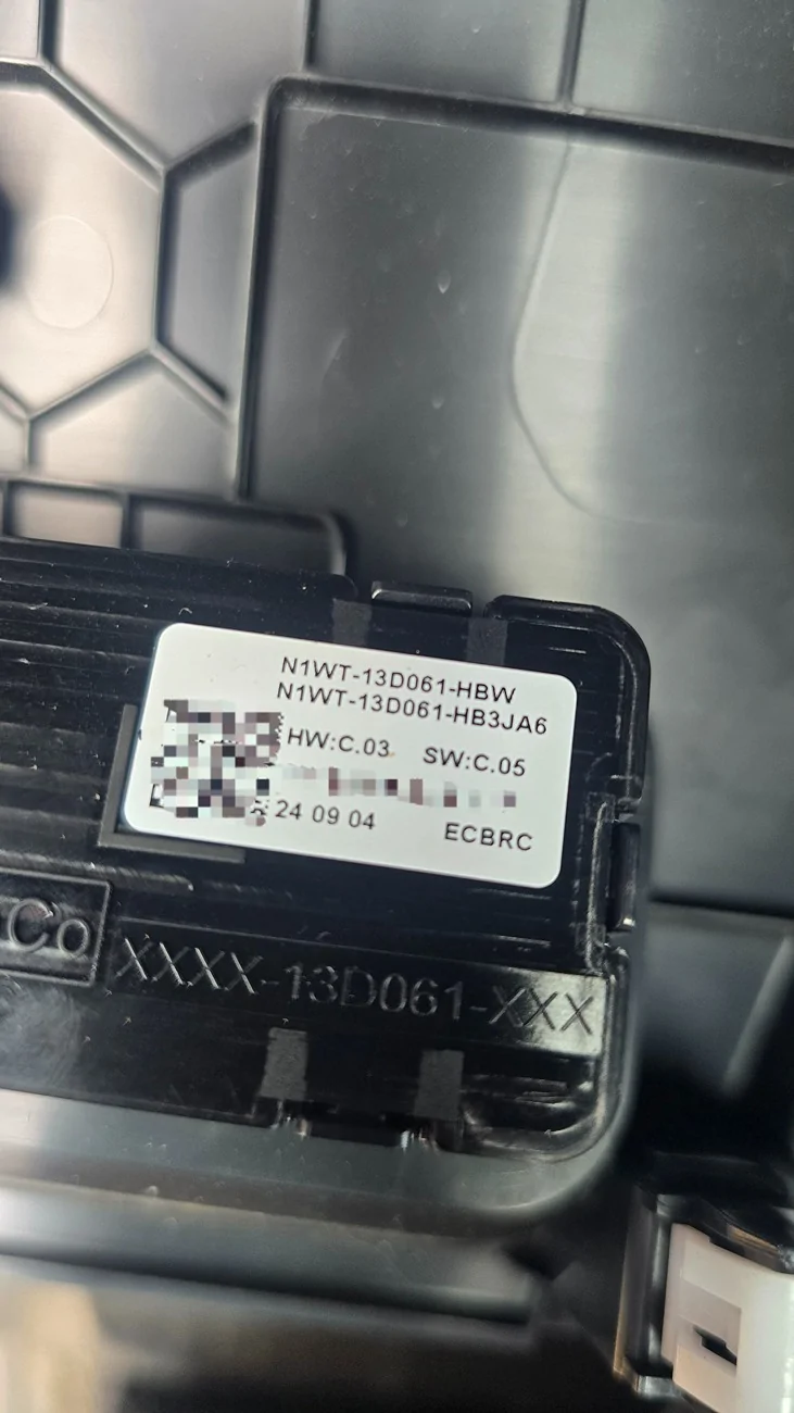

You likeing my earlier comment, reminded me about this. and I just so happen to be sitting my truck. so I took a pic, I have 5 wires in my switch plug. see if you have the 5 wires in same pin locations, if you do, should be a direct swap.
unsure if need to fiddle with forscan or not, but if you have same 5 wires, in same pin locations thats a great sign.
and part # of my switch if you need it.
Ford Ranger Cargo light switch placement/replacement 20260611_143140
Ford Ranger Cargo light switch placement/replacement 20260611_143152
