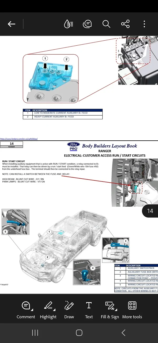

Has anyone actually found the blunt cut high beam and park light wires that are supposedly near the bcm? according to the ford body builders guide, theres 2 blunt cut wires. one for park, and one for high beams. right now I have my diode Dynamics D-Switch night wire trigger off the trailer marker light fuse, witha fuse tap in the engine bay, and Im getting ready to find a high beam trigger. and apparently theres 2 blunt cut wires behind the kick panel. before I dive into it. I figured I ask for a quick find.
Ford Ranger High Beam blunt cut wire location Screenshot_20250820_102240_Adobe Acrobat
Ford Ranger High Beam blunt cut wire location 20250810_131122
