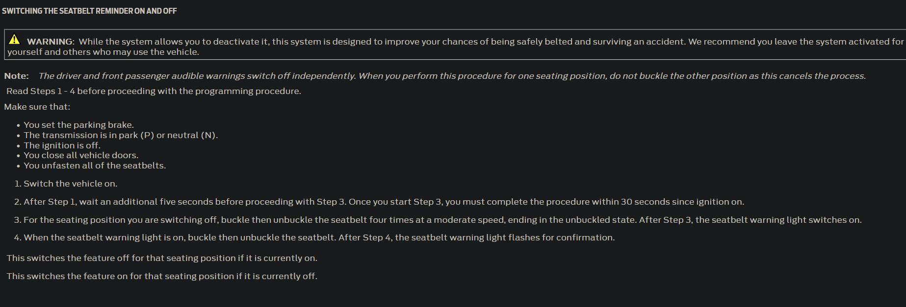

Hey Mike, I followed the procedure that I referenced in the manual. It did not give me a positive confirmation that it took, however, it seemed to solve the problem.

Same here. I have the same issue when two passengers are in the rear seat, center seat position empty I get the nagging alert and have to buckle the unoccupied center seat position.
I too followed the procedure and completed sequence within the 30seconds .. but no “confirmation “ of success.

Looks like I got hit with this seatbelt issue today. Had someone in the rear passenger side seat, had the middle cup holder down with a drink in it, and the middle seatbelt sensor would not stop beeping with a red indicator on the display. They removed the drink, put the cup holder up, and the error was cleared.
Tried to turn off the sensor as described in this thread (page 57 of the owners manual), and I could not get the warning light to flash for confirmation. Hmmm. I'll try again tomorrow I guess.
