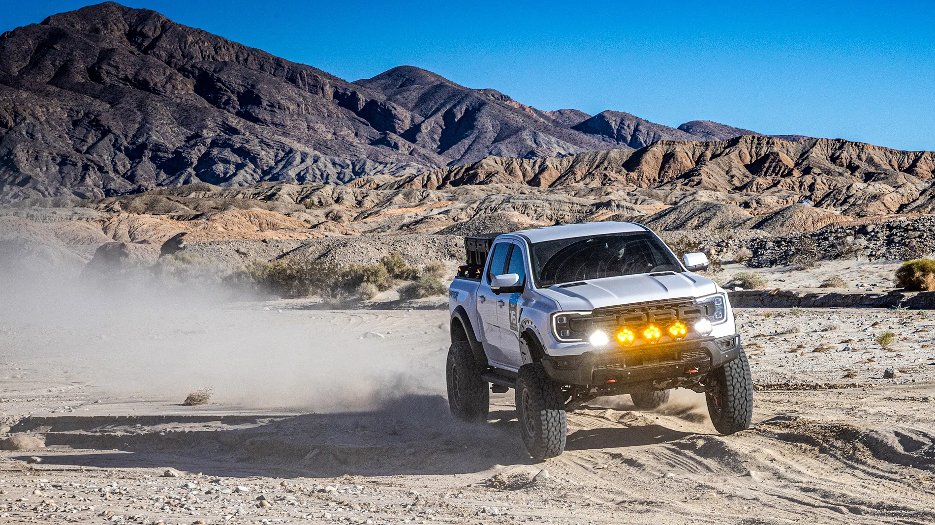

Your video was a HUGE inspiration in this build. I can't thank you enough for posting in earlier this year.
Yesterday was day 1 with EXO in Baja and was a blast! The rig drove far beyond expectations and was faster and more nimble than most of the full-size Raptors with many of them dragging their rear diffs through the San Felipe woops.
RR is AMAZING.
Thank you! I agree, it’s such an amazing little bad ass. I’m flying out to pick mine back up the Friday and can wait to show everyone the new upgrade! It’s eating me alive keeping it a secret lol.
But awesome rig man, enjoy the hell out of it!

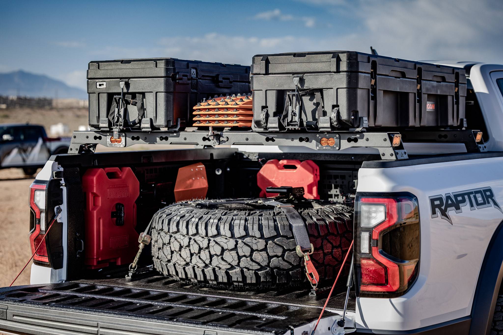

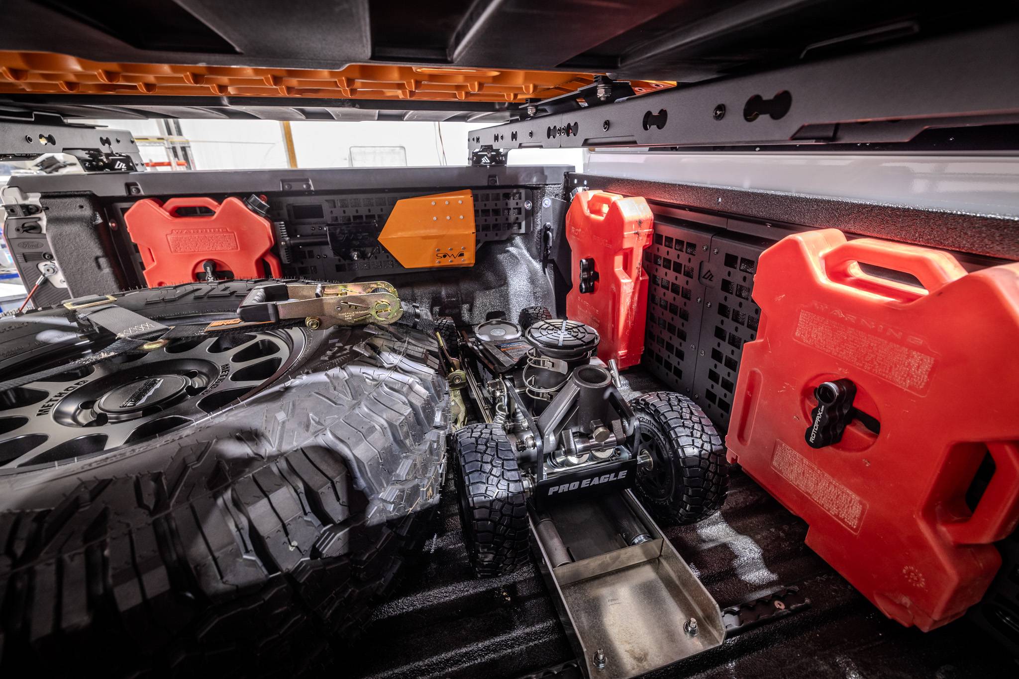

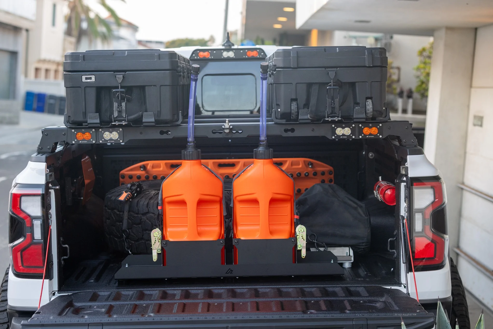

What rails are you using on the floor of the bed to secure the tire and jack?
Great question and this is "do as I say, not as I do." The original builders used a basic system and had to drill holes in the bed. Not happy because we then had to add more holes when we relocated things.
Suggest @American Adventure LAb rails that they subsequently developed. Sorry I don't have pics of those. We now hove amazing layout with 37" tire, Pro Eagle Jack, AAL gas can holders, integrated ARB dual brushless compresesor and integrated power for Starlink plus MaxTrax Xtreme boards, shovel and fire extinguisher.

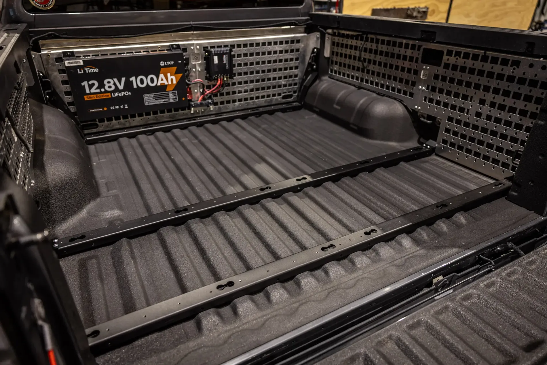

Thanks for the mention!
Here's some more info on the BASE rails - https://americanadventurelab.com/product/ford-ranger-bed-attachment-system-base/
