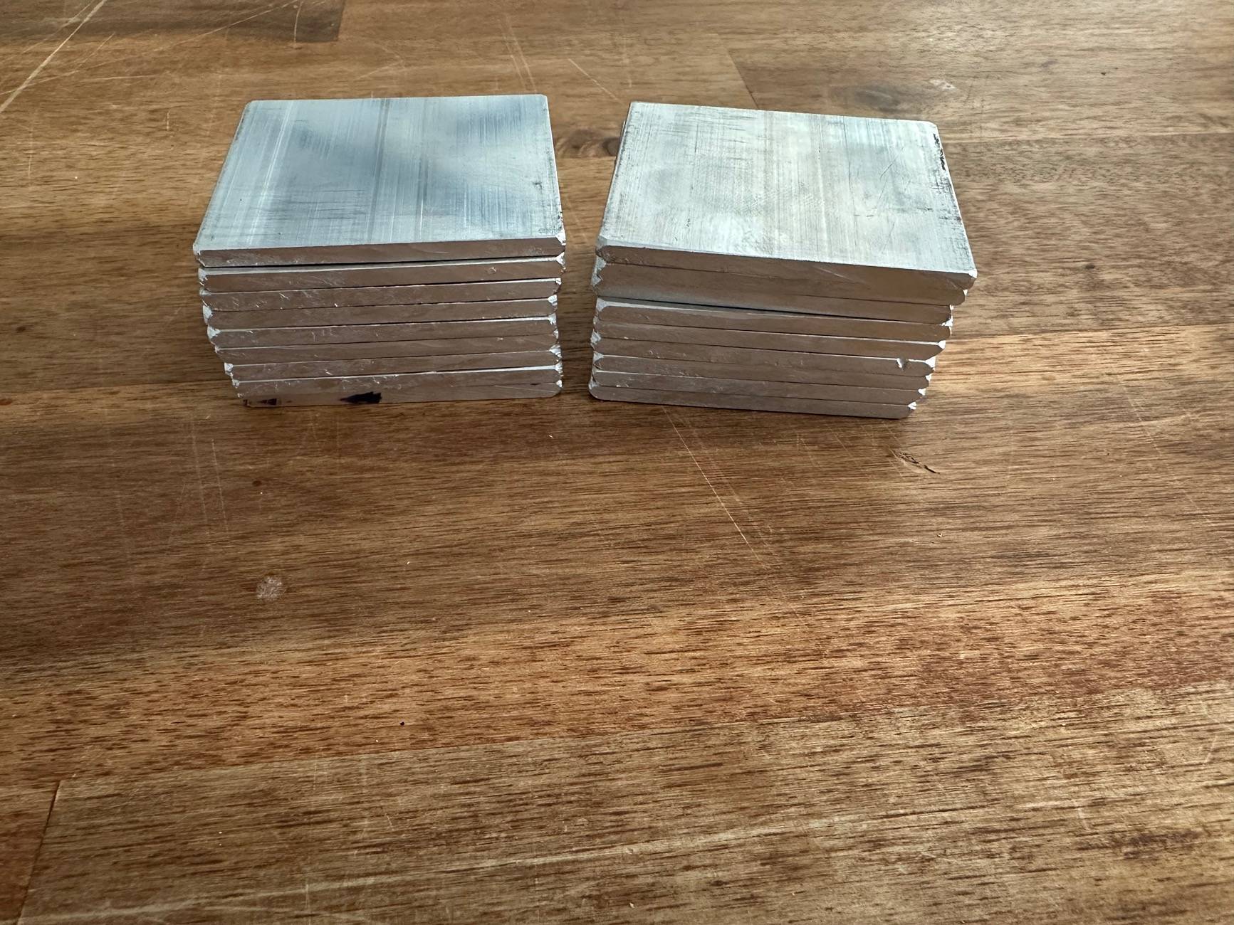

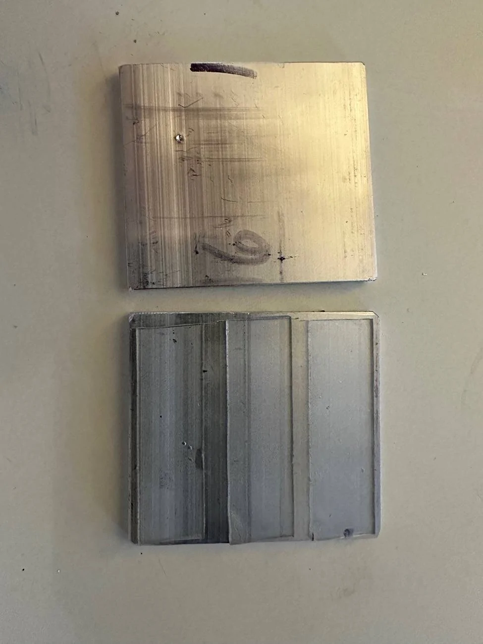

To address this, I made spacers/shims for the gap between the bed rail and the caps. Two pieces of aluminum cut to 1 3/4” x 2” and connected with a few strips of VHB tape.

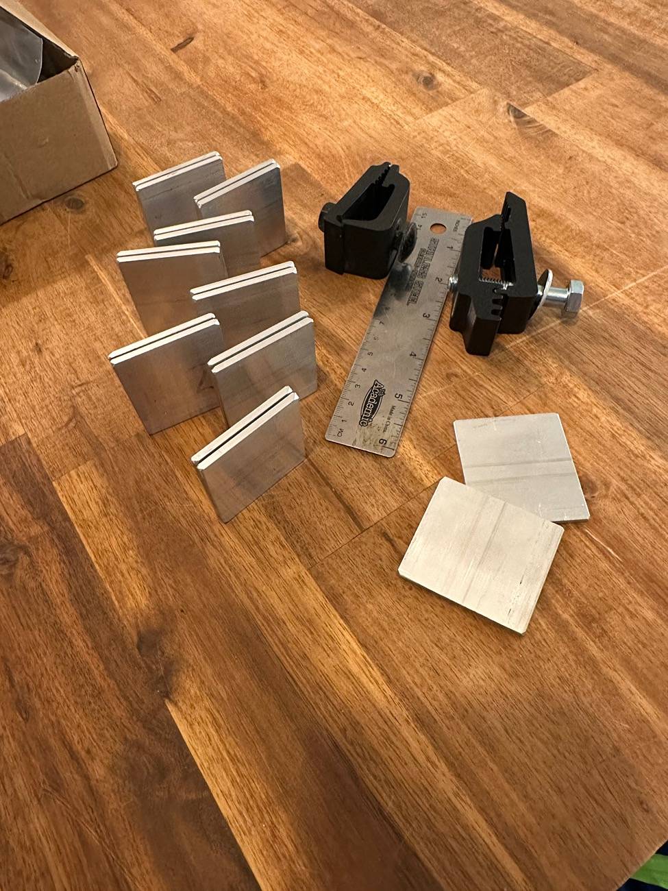

I opted for a new set of clamps that are adjustable. There are three lengths you can choose from. They should work on either the middle or longest setting.
I’m tackling this project Saturday. It looks like it should fit. I’ll add a few pics of the clamp locations and material details if everything goes as planned. For now, here’s a couple pictures of the spacers/shims and the old & new clamps.
