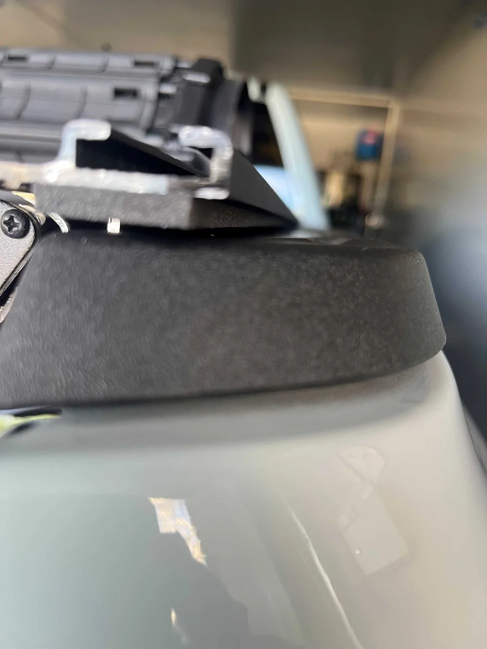

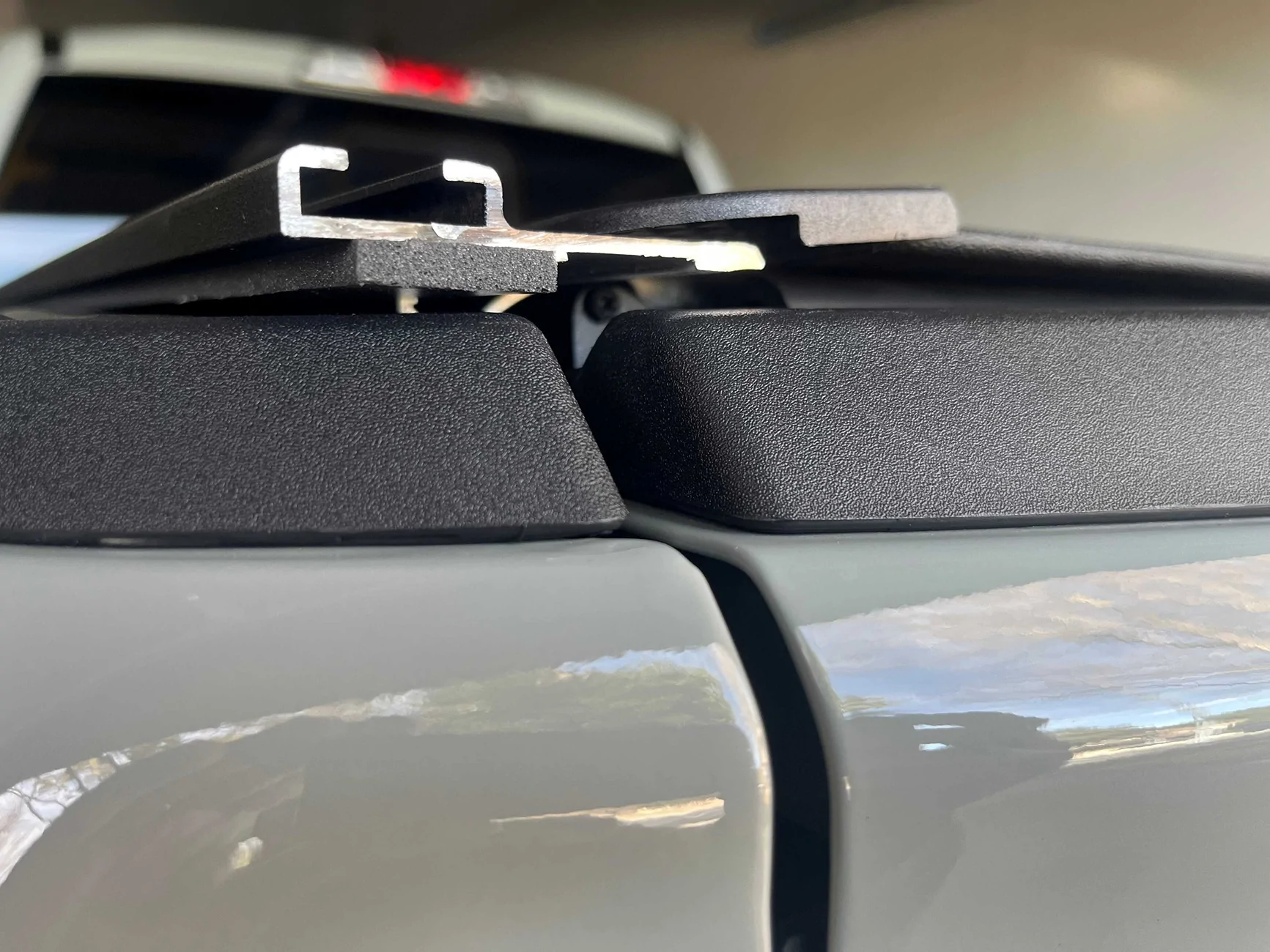

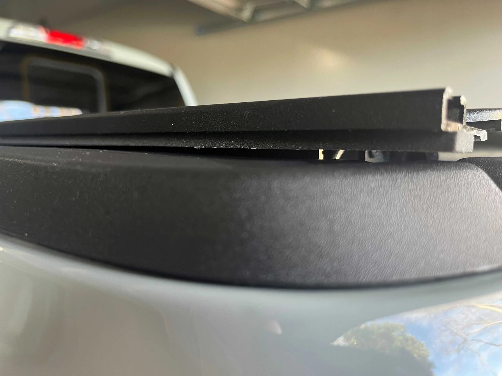

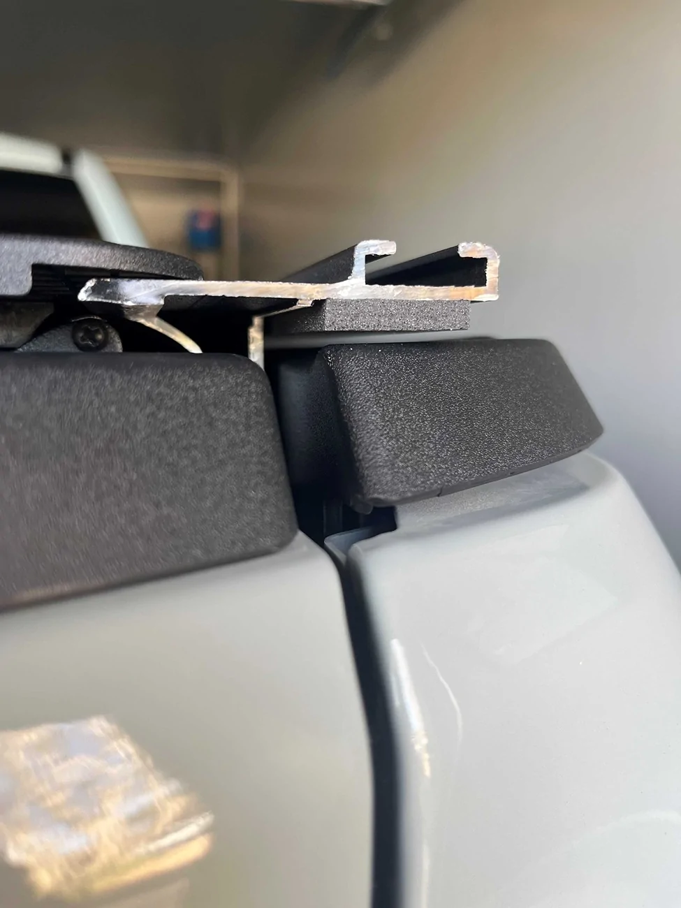

I ordered one of these a year ago from RealTruck on Amazon and was so disappointed I shipped it back the very next day. Very poor fitment with big gaps between the bedrail and tonneau rails at the tailgate end (see pics). I'm considering giving it another shot. Is there anyone with better success who's willing to share pics? Maybe the one I got was warped or something...

i dont have pics but having a second set of hands/feet to put some weight on the rails while tightening down eliminated my gaps.

Get a rubber mallet, half-tighten the clamps then tap the rails near the clamps so that the rails lay flat. Mine did that until I used a mallet and it lays perfectly flat now. These do take some tinkering, but once its properly installed it is satisfactory. I also put some spacers at the front end because I had a small gap at the tailgate.

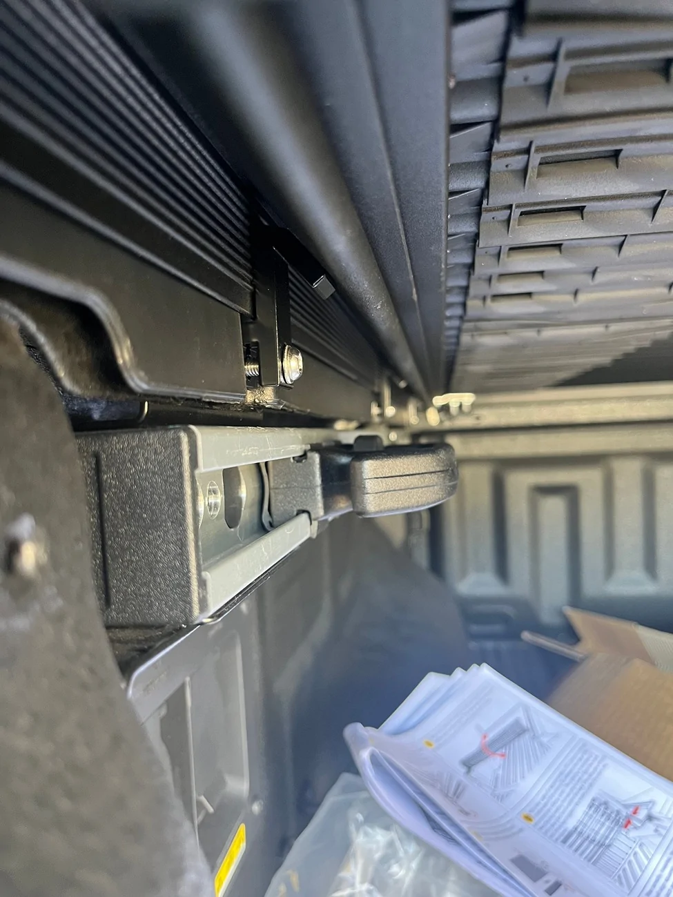

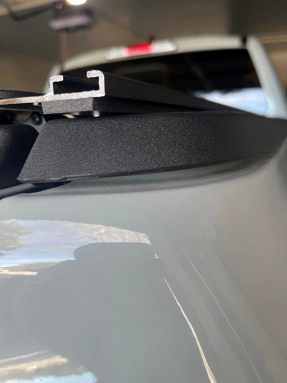

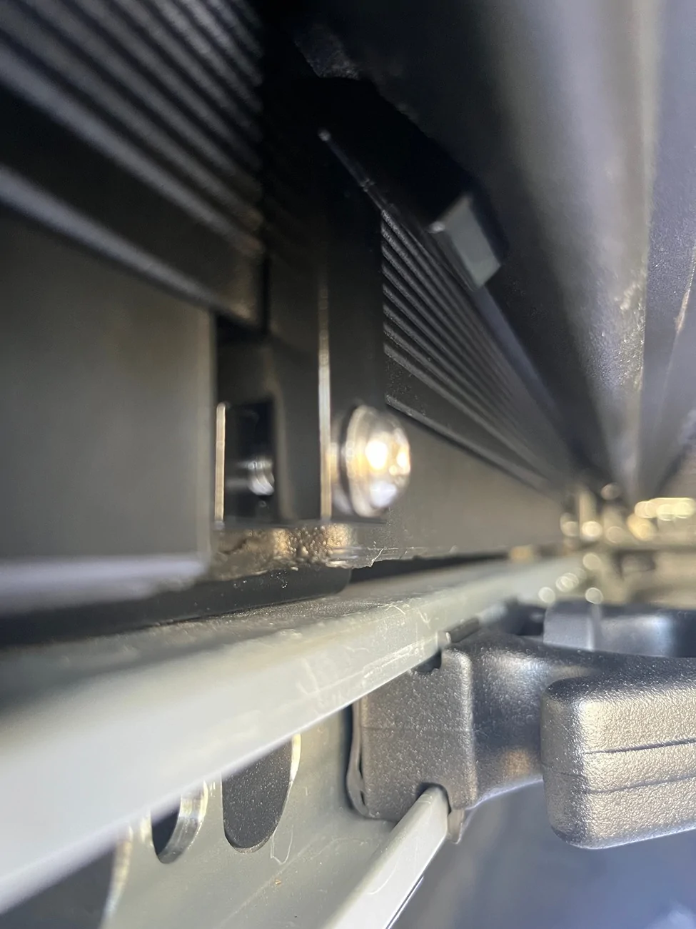

Thanks for the input! I took some pics from the underside as well. Where the clamps engage the rail it looked like either the clamp or the rail would have to bend to get them any more snug. Maybe I gave up too soon and a few taps with a rubber mallet would've fixed it, but I admit by that point I was pretty torqued!

Pretty hard to tell how much room there is (if any), but it would probably only take a couple more of those ridges to engage with the clamp to get it to lay flat. Thats why you half-tighten it - once you tap it with the mallet the additional ridges engage and then you can fully tighten it down. The rail or bed trim might also be slightly warped.
