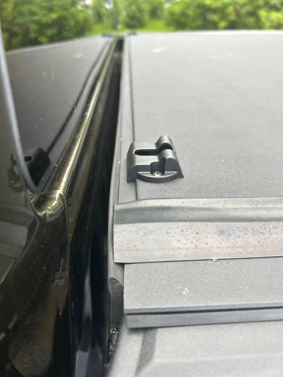

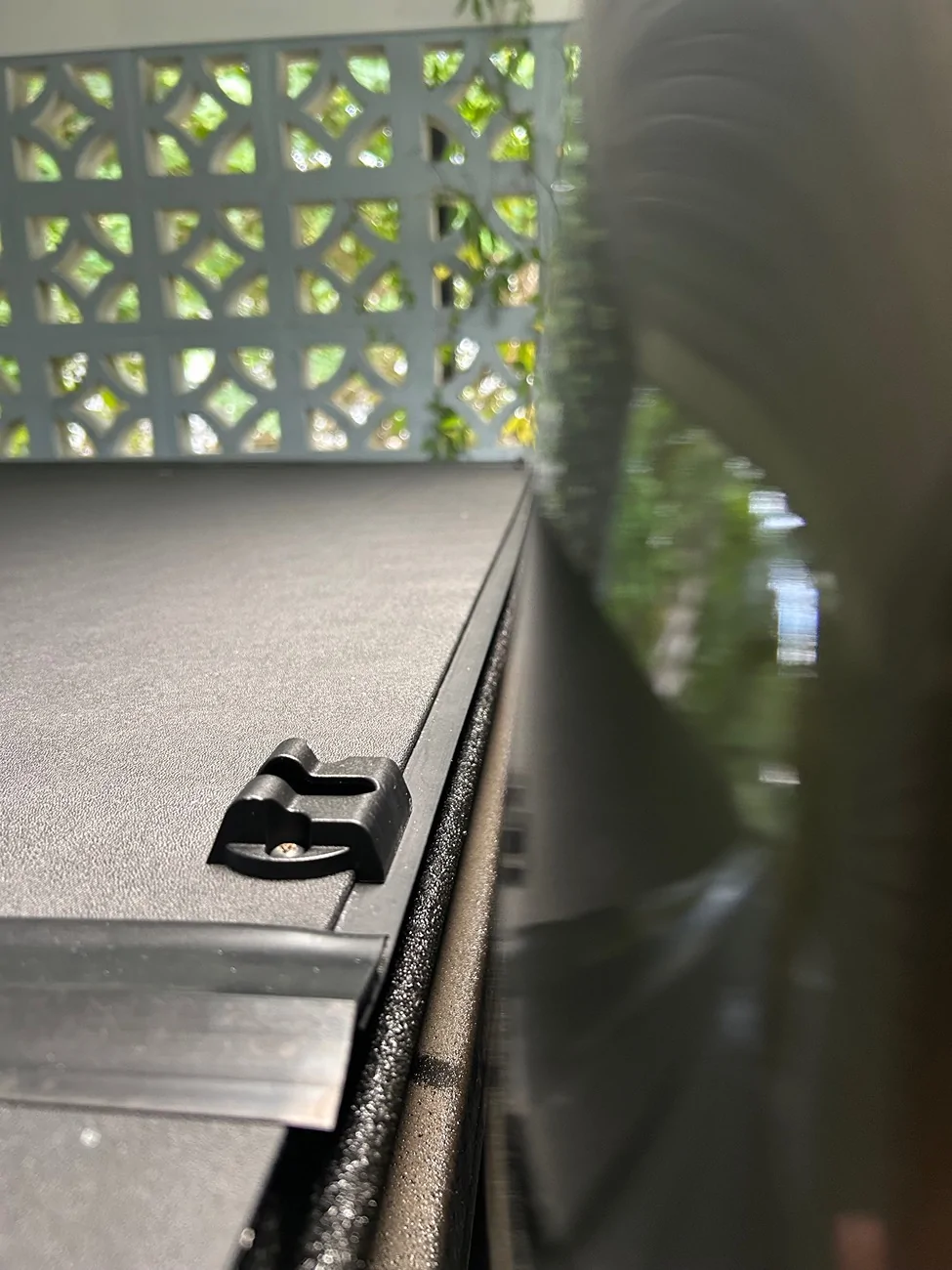

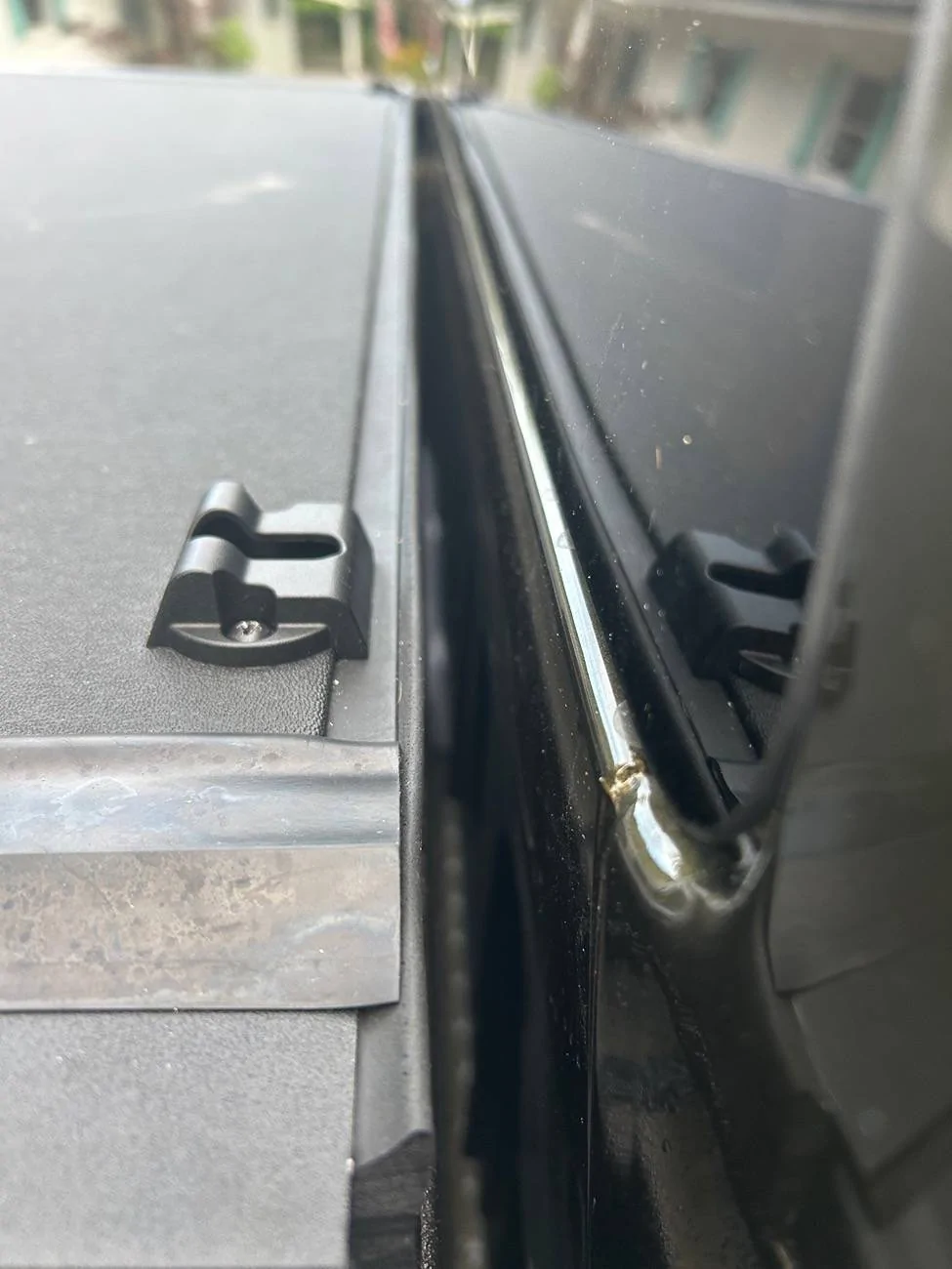

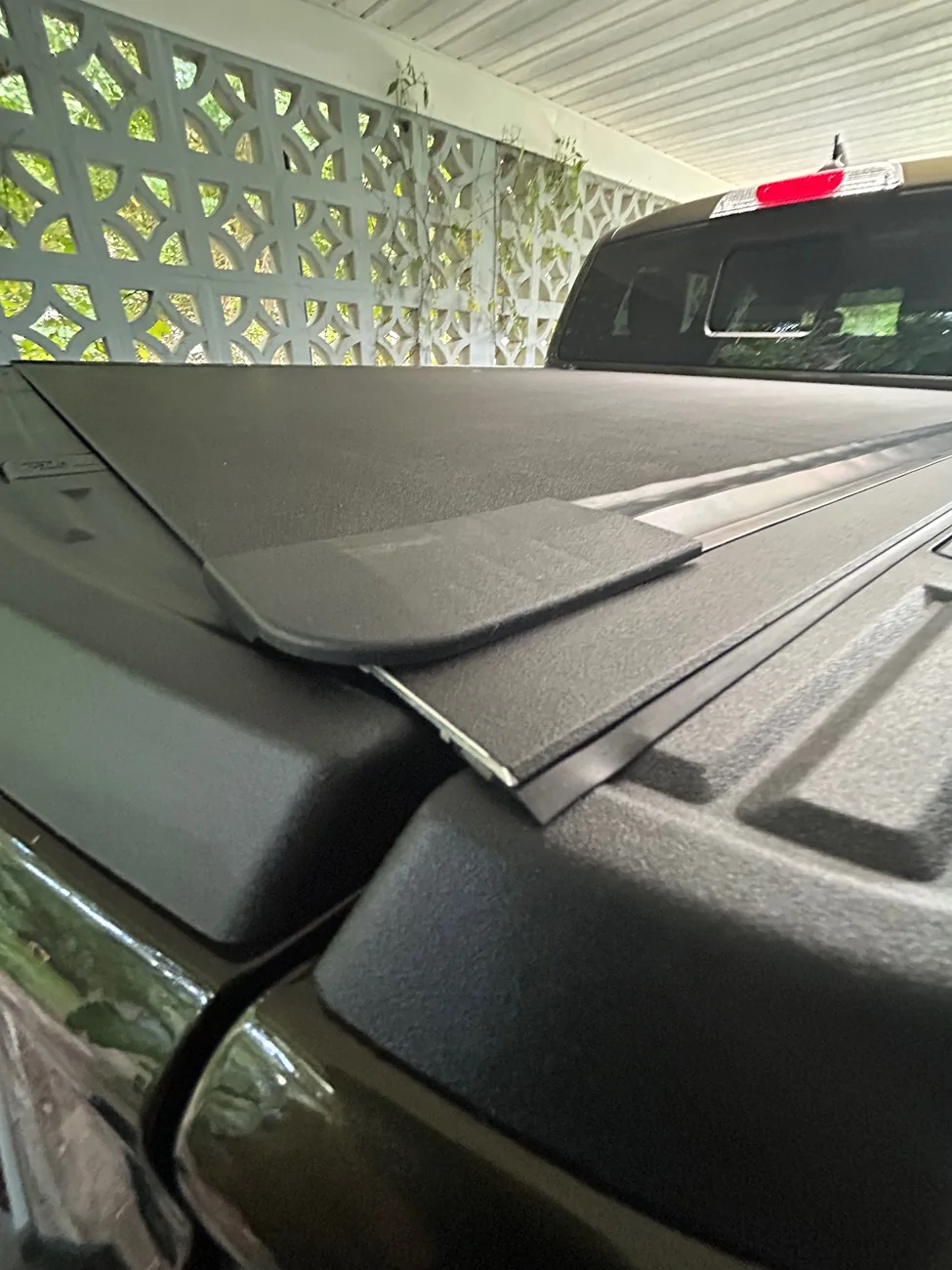

Installed mine on a ‘25 RR. The instructions have sections for the 24 & 25. Mine only came with the scalloped 24 bulkhead seal. Apparently, there’s a different Square seal for the 25.
I had a hard time figuring out which way to orient the BH seal. If I placed it per instructions, with the flat side facing the back of the truck, it seemed like the font of the cover angled up and didn’t lay flat.
I placed it as pictured and the cover sits flatter.
If I move the cover back toward the tailgate, I get D seal contact, but the front of the cover seems short.
I ordered some 1”x1” and 1”x3/4” weatherstrip from Amazon to see if will fit flatter.
I had some water intrusion last night on the front passenger corner when it rained.
Wondering if i need a longer cover sent?

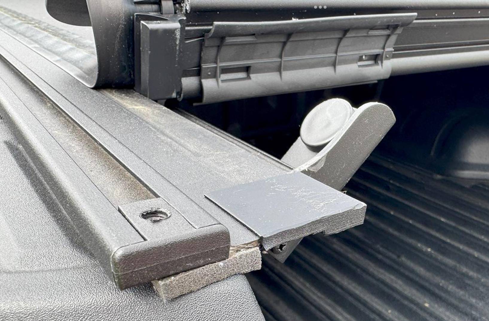

I'm a bit disappointed in the quality of the cover. The hardware is crap, I replaced all the nuts and bolts after one snapped on me installing. One of the clamps doesn't grip the rail well enough to hold down the end securely, so I may see if I can find an aftermarket one. Real Truck has been non-responsive and the only email I got was not helpful at all. At some point I will probably take off the rails and replace the weather stripping with something thicker to seal better. The cover works well enough and I can modify myself, but for the price the fit and finish really should be much better.
I finally got around to trying to install mine yesterday on my 2025 Ranger Raptor (April 2025 production) and I agree that the QA is generally lacking. Both of my side rails came with numerous scratches on the top visible surfaces, misaligned seal along the sides of the rails, really rough cuts on the ends of the rails and missing paint. I'm filling out the registration right now, so I can open a warranty ticket to get the rails replaced and get the missing 2025 install parts (mounts and and bulkhead seal). The overall quality and attention to detail looks more like $900 product than a $1400 product. They really need to figure out a better way to handle the sharp corners on the rails when you open the tailgate.

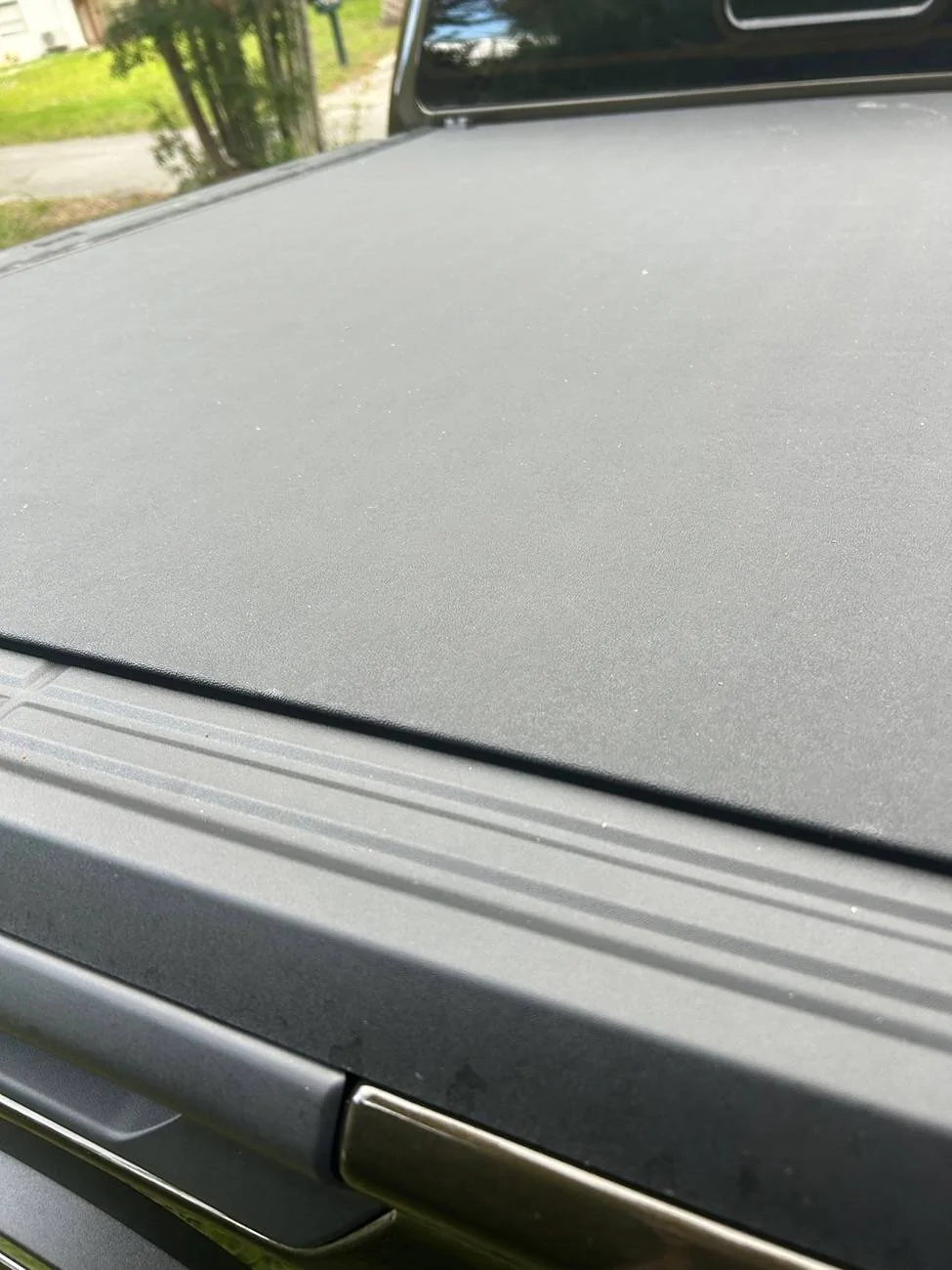

an update on mine. i got some 1x1 closed cell weather strip from Amazon and reinstalled. much better fit. i get some water intrusion on each corner, but the middle stays dry enough.

for the sharp corners on the rails, i used a safe side file and broke the edge on the corner and sharp edges where the aluminum was cut at the factory.
