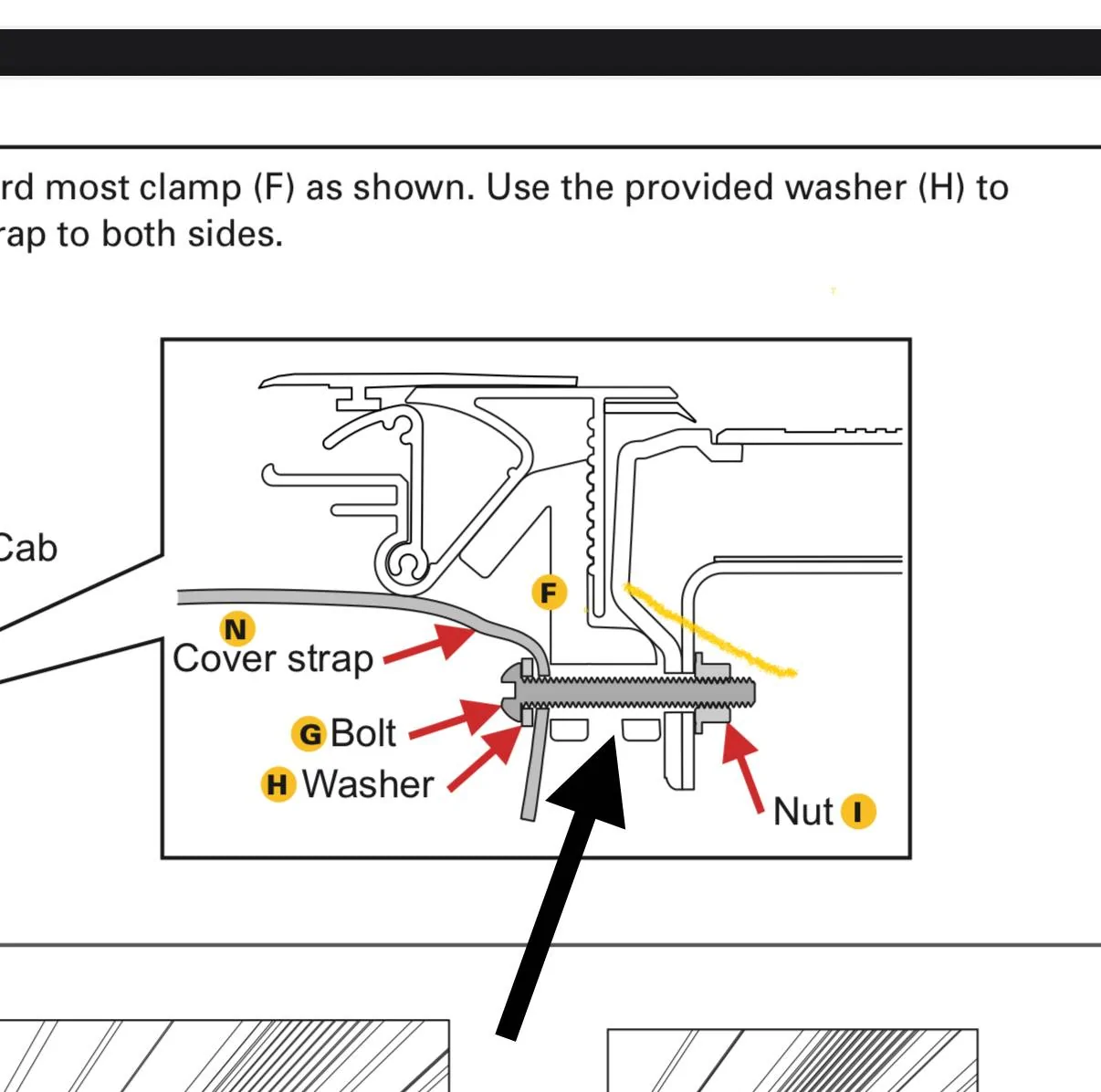

For those of you with the “h” shaped clamps for the 2024 version - I suggest installing the strap grommet in the space with the arrow in the attached photo. The way the instructions show to install the strap will fail. Bolt>washer>bracket leg (NOT grommet) > grommet > bracket leg > hole > nut.
