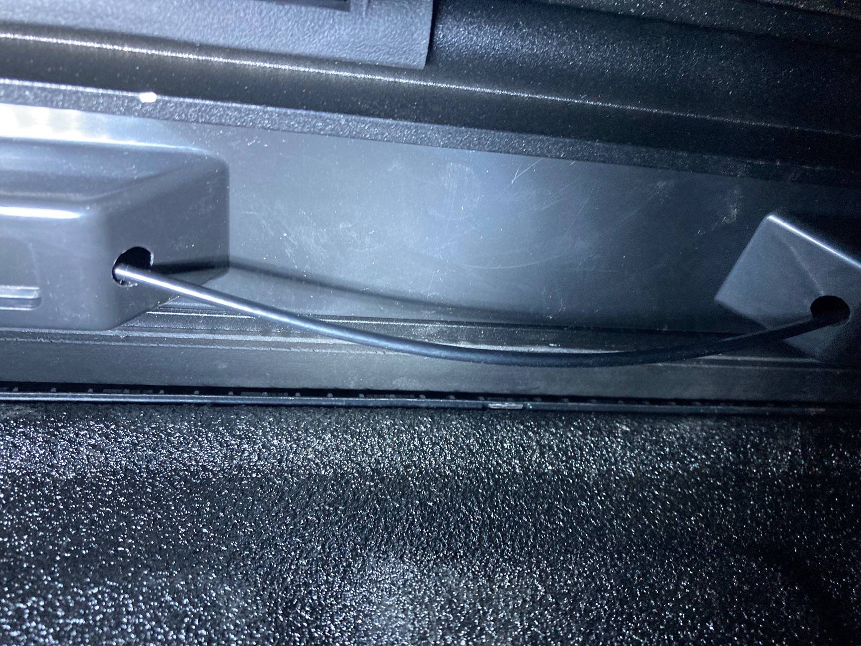

I just picked up my new 2025 Ranger 2 weeks ago today, and just this past Friday I installed the BAK Revolver X4S.
At this time I would caution against ordering that product until BAK has a chance to figure out what's going on. I have supplied them with numerous photos and measurements so they can investigate.
The bottom line right now is the the cover is not long enough to even reach from the front to rear edges of the side rails, and the rear edge of the cover is sitting in space above the lower front edge of the tailgate cover. The image below shows the gap and this is with the rear edge of the cover aligned with the rear edges of the side rails.
I can tell you this is not a new issue. There was a forum discussion last fall about fitment issues. I was part of it. The X4S and X4TS are the same except the rails have a track on them for accessories. The cover design was wrong and it was impossible to align the cover bolt tracks to the bolt holes on the rails. To their credit, BAK tried very hard, they sent me new rails, but it was clear the cover was the problem. Just a couple of weeks ago they sent me a new cover. I have not been home to install it but I am optimistic. I will say their customer service is excellent. Other than the issue noted herein, the cover fit well and provided “expected” protection from snow and rain. My (first) cover lines up similar to what I see in the pictures. I crawled inside the box with a. Light and had the door shut and that rear
Ford Ranger BAK Revolver X4S Fitment Issues on 2025 Ranger Lariat IMG_8547
seal does make sufficient contact with the edge of the tailgate. The tailgate closes perfectly against the rails and cover. I will add that I think the front foam seal provided is too thick to compress sufficiently and allow the rails to sit ideally against the bed rail. When I get a chance to install the newly provided cover I will use an aftermarket seal or cut down the foam where it makes connection with the rails.
