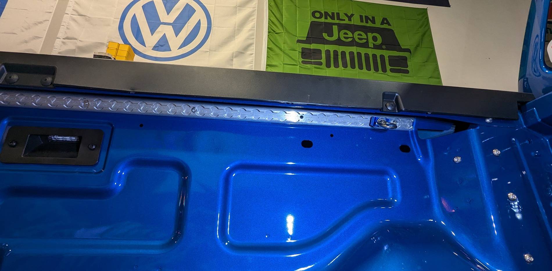

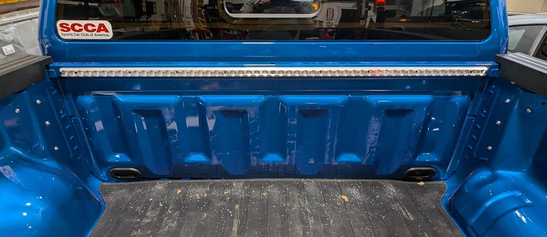

ADVNTURR
Sep 6, 2024
61
111
Cleveland, OH
For that rail on the bulkhead did u just use the existing holes there with rivnuts or what?
I used the center slotted hole which I'll use with a nut and fender washer. I'm using the two existing M8 weld nuts for the ends (won't be able to place the tie-downs on the end). For the rest I drilled on 6" centers and will be using nut and fender washer. I try not to use rivnuts when I don't have to for higher pull-out loaded items like this.
The track I'm putting under the bed rails is using mostly existing weldnuts but there are a few places where I am drilling and using rivnuts to keep the span short between attachment points.
