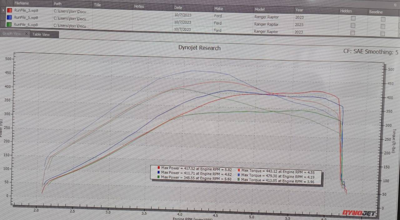

I installed on mine a JB4 tune, JB4 meth, Fabulous Fab CAI, and Fenix IC. It went from 345 whp stock to 417 whp on the most aggressive JB4 map with 93 octane. When I did this in 2023 there were'nt much options available for the RR.
I have seen other intercoolers much larger, I would upgrade to one of those, other than that I would stick with the same other items.
I hope the info helps.

Looks good. I’ve been trying to get a sheet from process West on their intercooler and air intake because there is nothing on the website and their distributors said that they have sent them nothing. Really makes me laugh that people would spend that much money and there’s no facts or data to back it up.

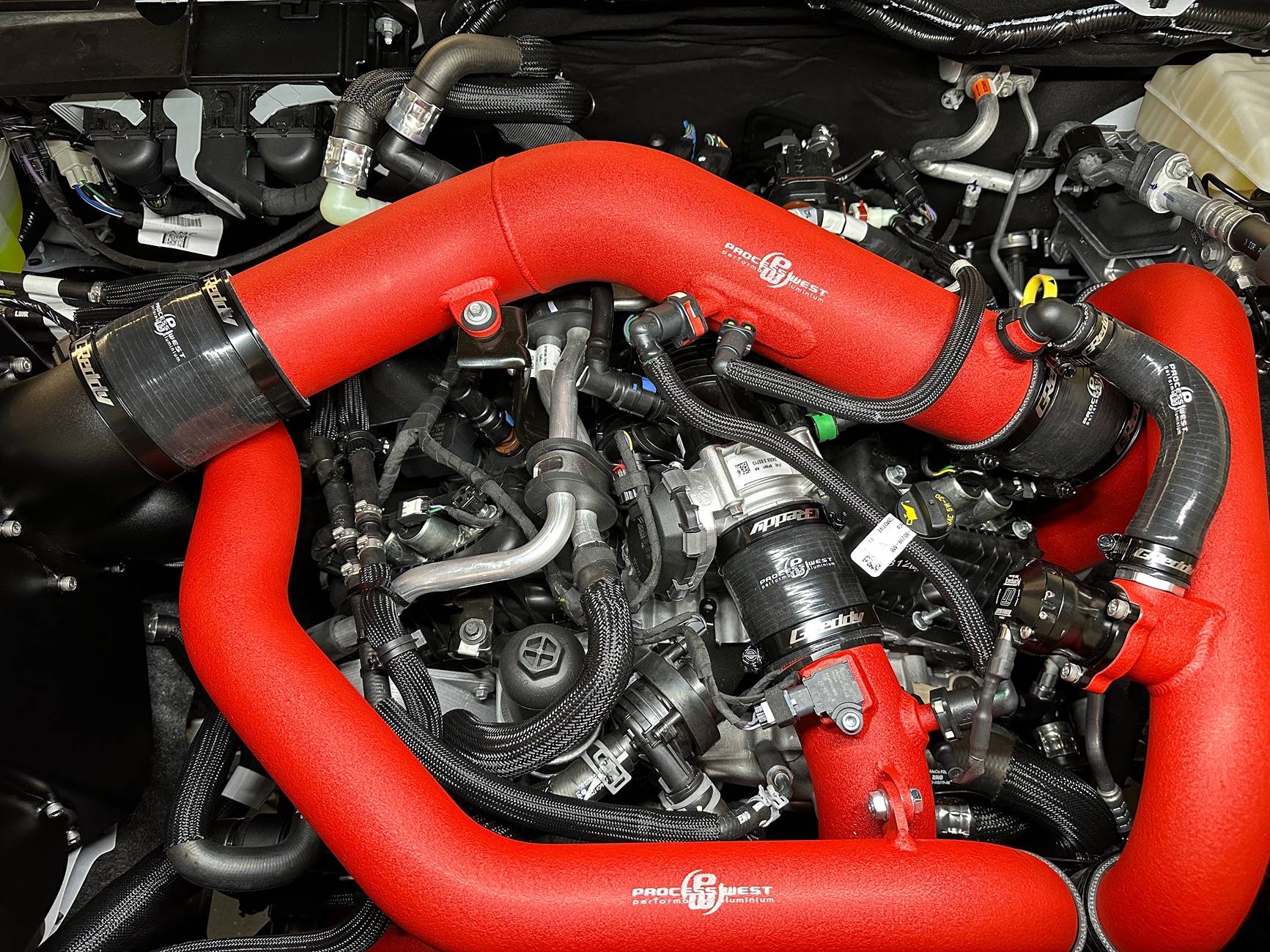

I
Ford Ranger Best Intercooler/High flow airbox upgrade? IMG_7665
Ford Ranger Best Intercooler/High flow airbox upgrade? IMG_7671
Ford Ranger Best Intercooler/High flow airbox upgrade? IMG_7664
I went with the FP tune full PW kit Turbosmart blowoff valve Wagner intercooler & Borla Atak Exhaust so far happy with the quality of the PW intake & intake tube and all the intercooler piping everything fit perfect and looks great also Wagner intercooler fit well and the Borla sounds great probably going to the ZFG tune as I want more power
Ran a 13.30 @ 100.80 on the street (dragy)

Sweet set-up and I see that you have the same CARB stickers that I have in my Injen/CVFabrication Bronco down here in the 310!!! :):):)

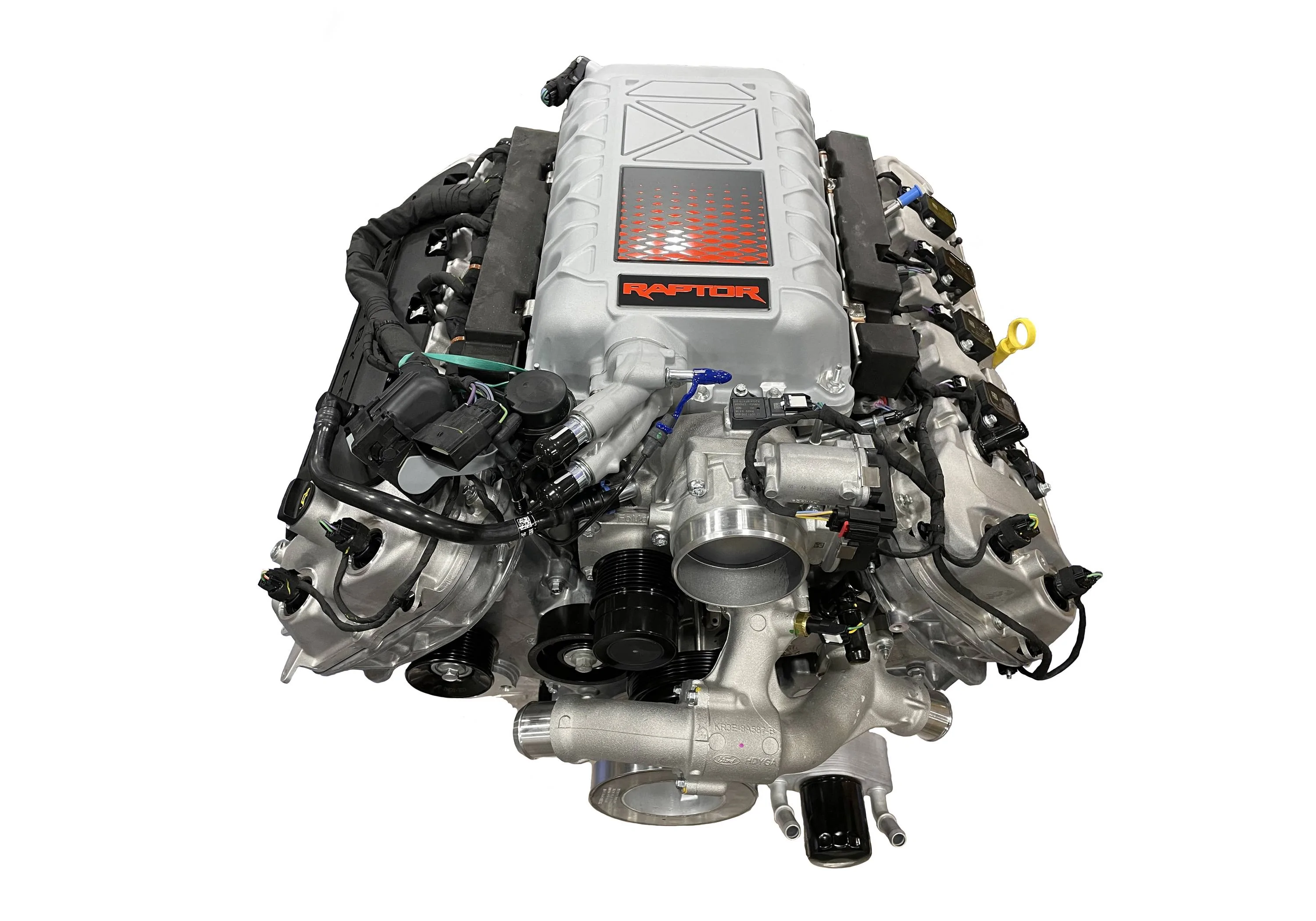

It's a roomy engine bay. If I do keep this truck a long time it will likely go under transplant surgery for a Coyote 5.0 with SC or maybe even a 5.2 Raptor R crate motor.
If Ford gets a wild hair to add a Ranger Raptor "R" with 5.0 and I'm upgrading for sure.
My god, I couldn't imagine putting this monster under the hood of my R/R!!!

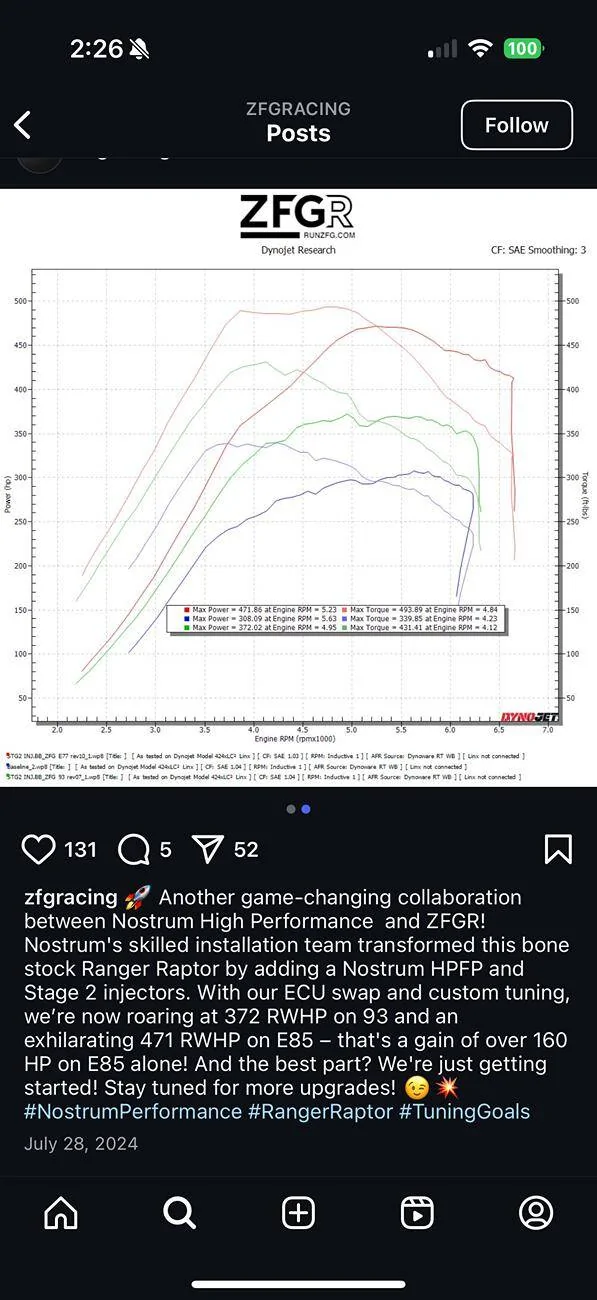

Nobody has more experience tuning the 3.0 EB than these guys…
Even with an upgraded fuel pump and injectors they aren’t making 500hp w/ E85.

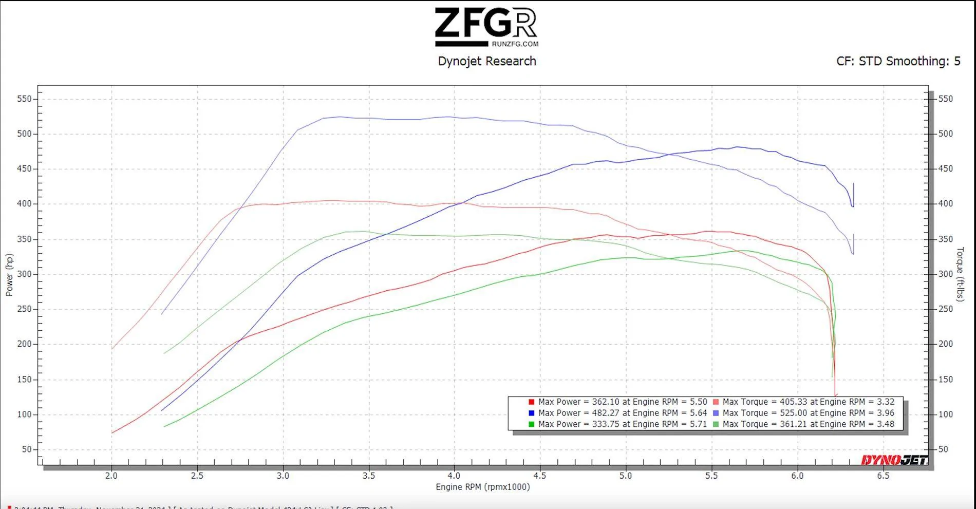

Sorry, I'm late to the party. This post by ZFG that you're referring to is part of a bigger build that tested different performance products, and along the way we provided data to the companies, while also sharing some publicly as well. Here was a stock truck with only a fuel upgrade. We are at 500 rwhp and over 500 lb ft tq on 93 pump gas with only ZFG tuning, FenFab intake/Charge pipes/catted downpipes. The rest is stock. No fuel mods. Only reason its not more hp and tq is we stopped there to test the transmission. Here's dyno chart and video.
RR ZFG Tuned
Ford Ranger Best Intercooler/High flow airbox upgrade? Screenshot 2025-03-14 at 9.47.29 AM

We are. Intake, DP's, Charge pipes, tuning, 93 octane stock fuel system & stock intercooler.
@Catalyst You're right, as long as it can inhale and exhale, stock fueling will get you there.
In @AlpineBike defense, some of the first data we put out was with upgraded fueling, so it was a little misleading. But was part of our build process.

Would love to see dyno results of this without SAE correction!
What was the most power you were able to make with just intake and tune?
Were you really able to notice any flow restriction with the stock charge pipes?

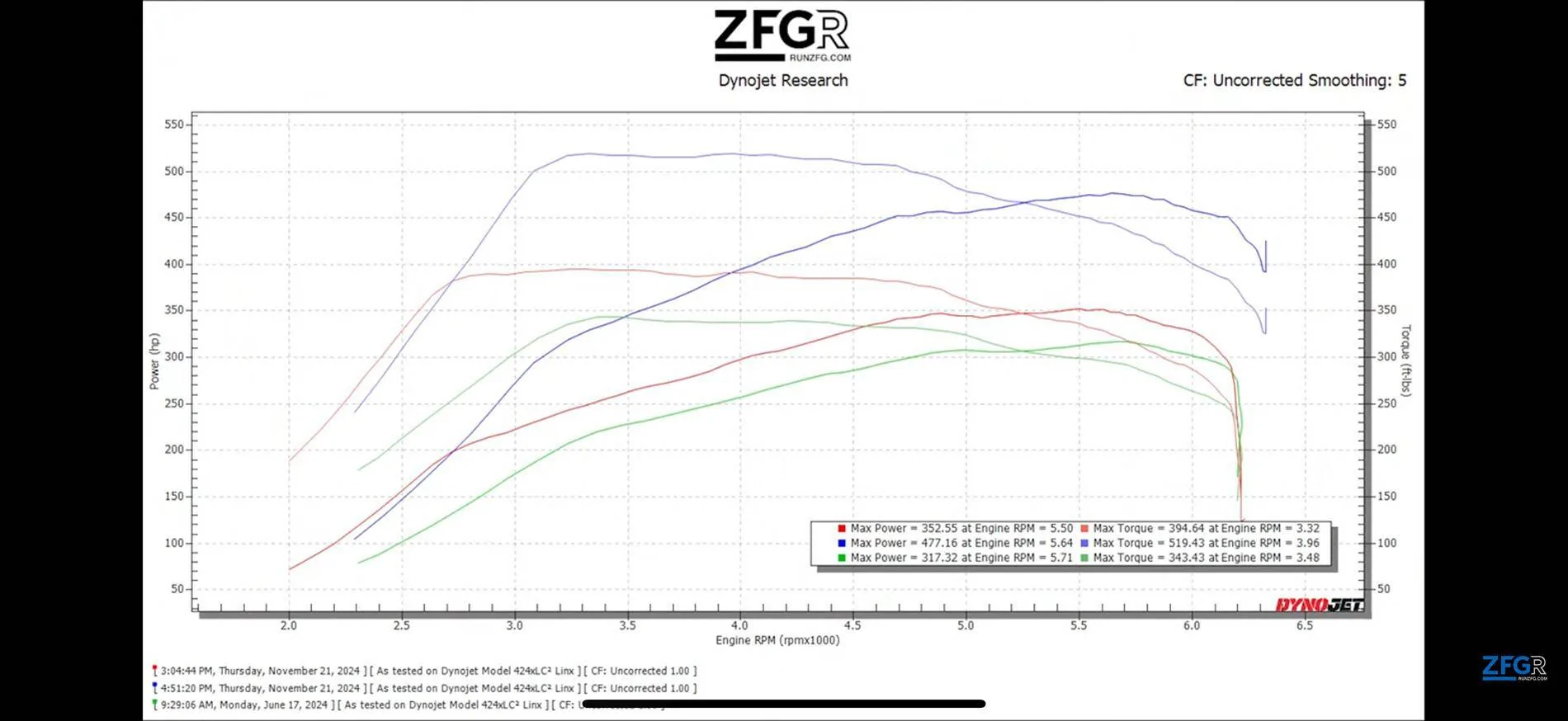

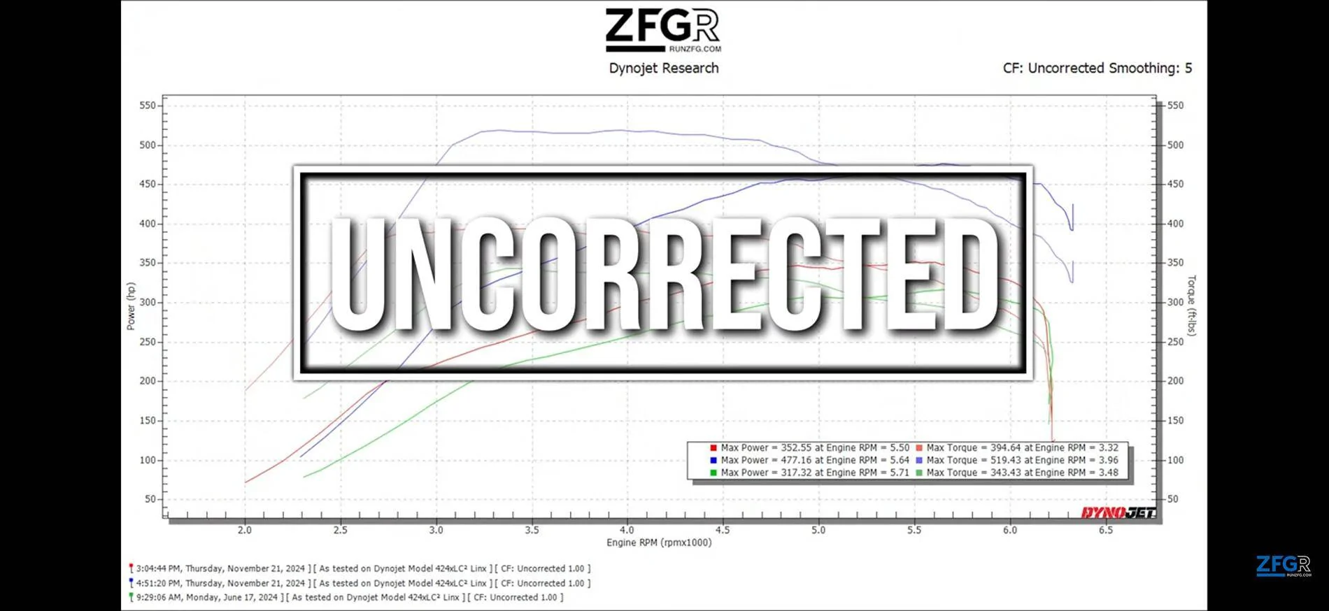

The SAE corrected numbers ensure you’re comparing apples to apples. So if one dyno chart was our pull in Detroit in September-20 below 0 humidity, we still can compare to a pull in Miami July 100 degrees and 80 % humidity. You may already know that, if so I apologize, was just making sure we were on the same page.
The link I posted with that dyno run shows uncorrected as well as corrected. It’s in the post above ☝.
Also here is an uncorrected run.
Ford Ranger Best Intercooler/High flow airbox upgrade? IMG_6319
Ford Ranger Best Intercooler/High flow airbox upgrade? IMG_6320

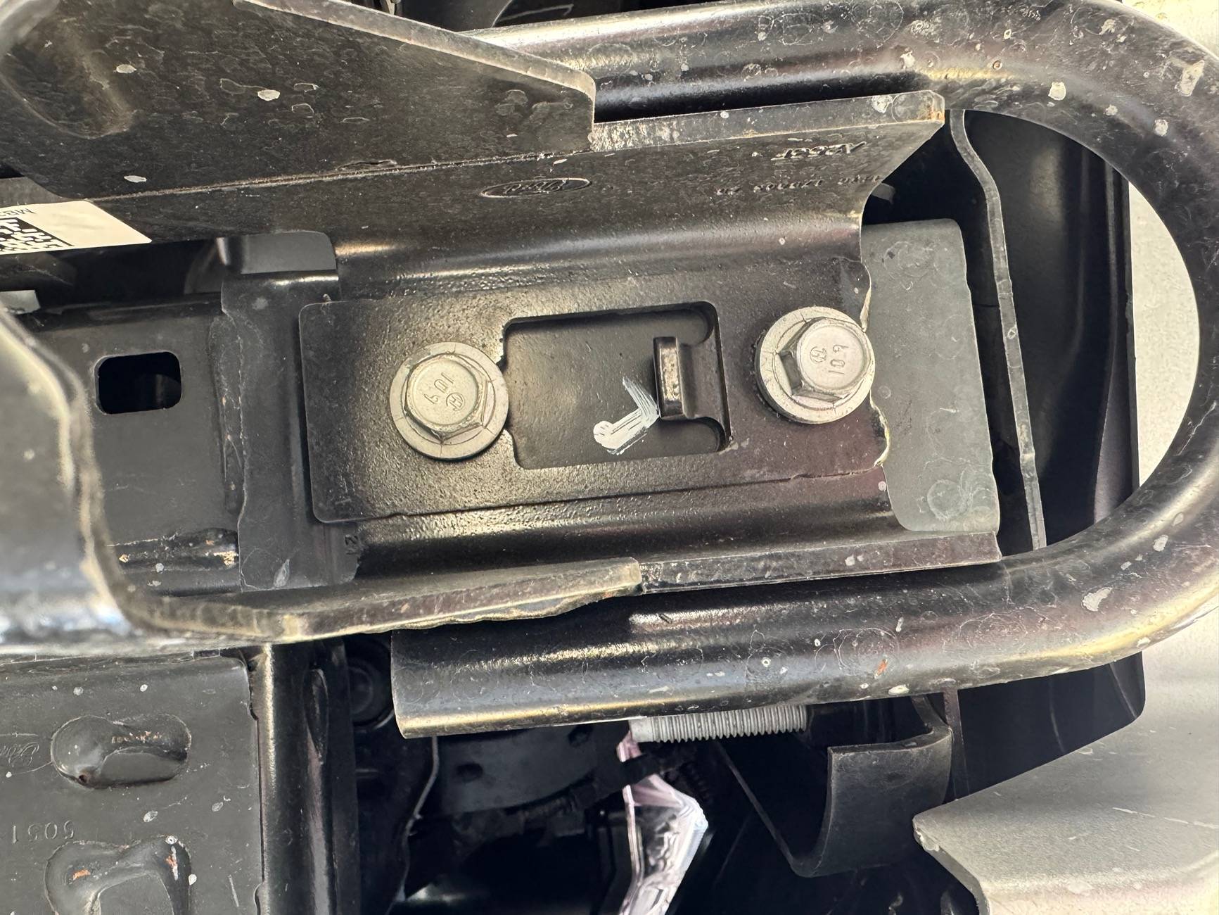

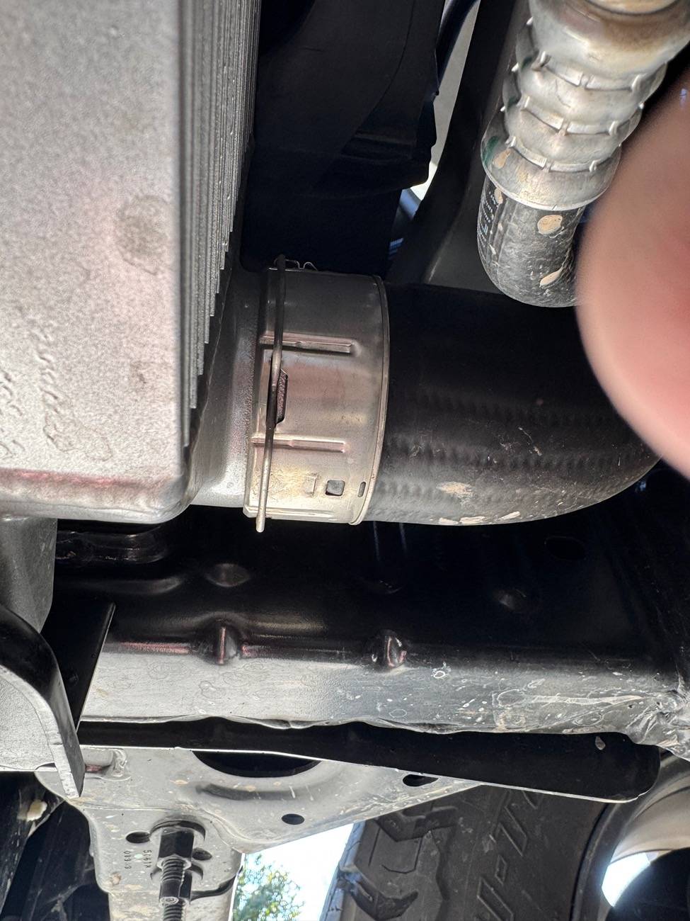

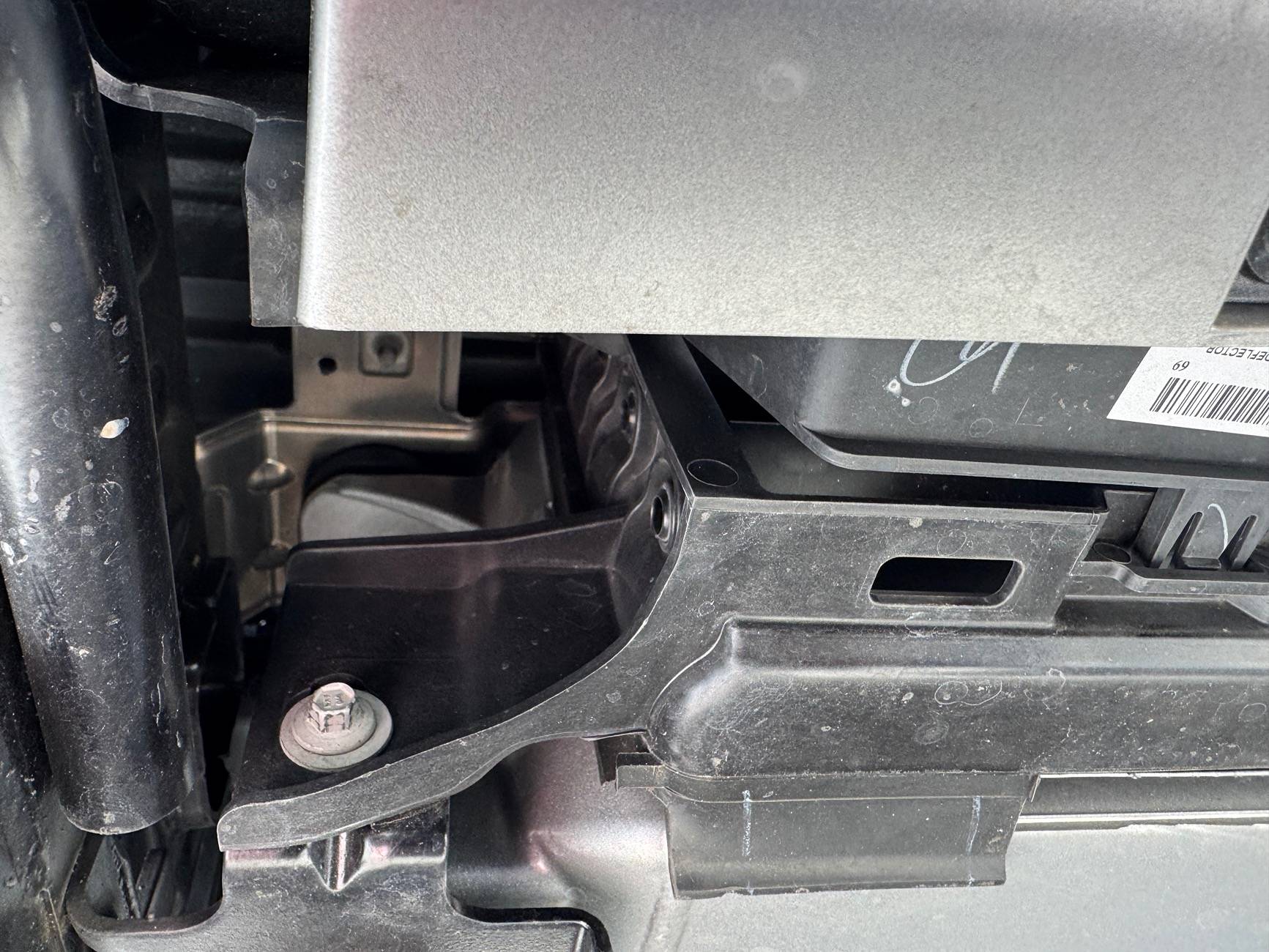

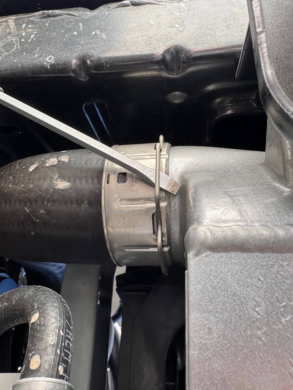

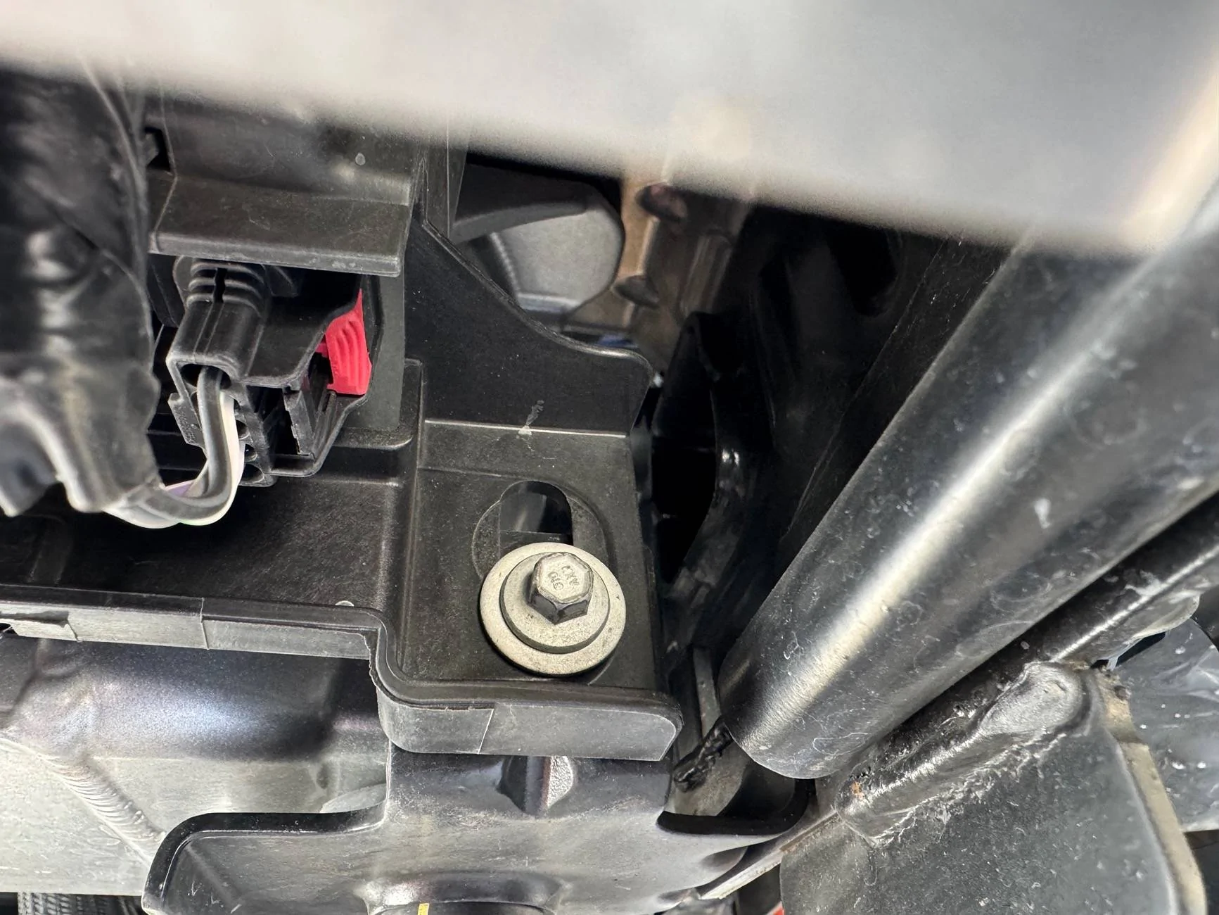

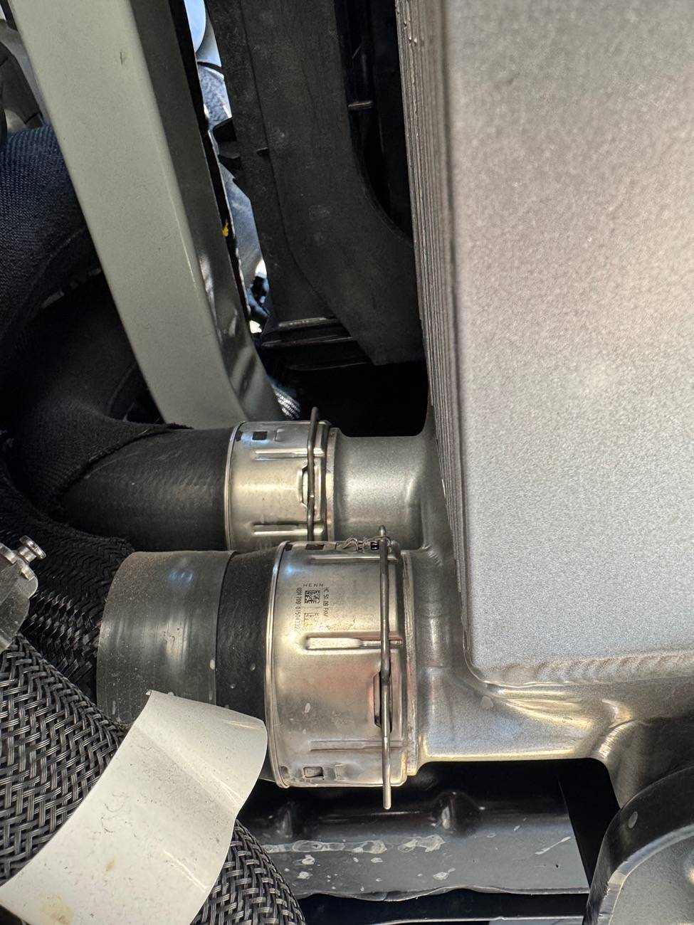

I’m incredibly happy with the COBB intercooler! Now the only time I see elevated IAT’s is sitting in traffic, and as soon as you start moving, those readings drop to within a couple degrees of ambient.
The install took about 30min. I’ll post some pictures I took during the install, and then grab a picture from the front tomorrow.
Ford Ranger Best Intercooler/High flow airbox upgrade? IMG_0500
Ford Ranger Best Intercooler/High flow airbox upgrade? IMG_0503
Ford Ranger Best Intercooler/High flow airbox upgrade? IMG_0505
Ford Ranger Best Intercooler/High flow airbox upgrade? IMG_0502
Ford Ranger Best Intercooler/High flow airbox upgrade? IMG_0504
Ford Ranger Best Intercooler/High flow airbox upgrade? IMG_0510
