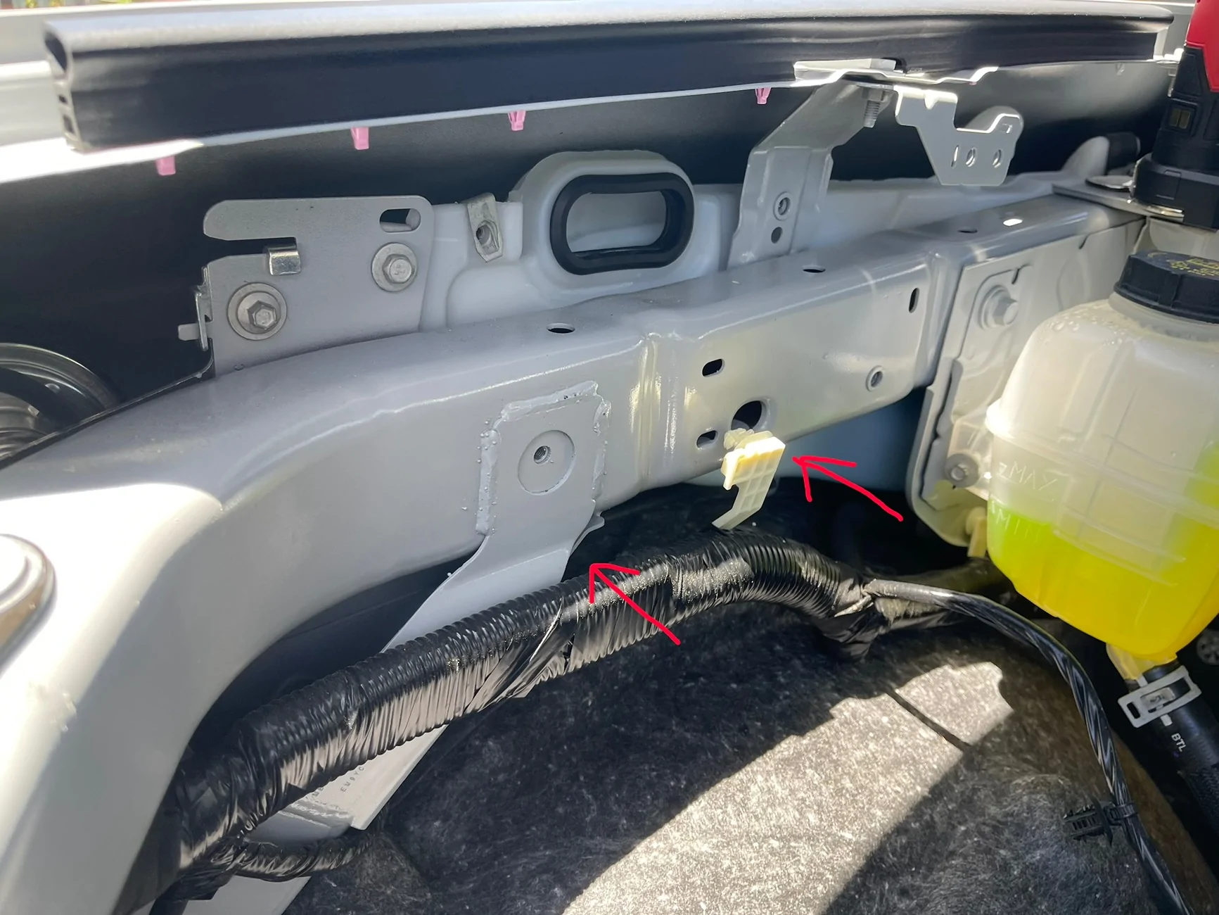

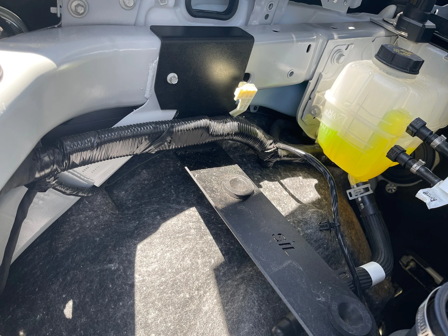

I’m guessing this is yet another change that went unnoticed for the USA 2026 model. There is a different OEM airbox bracket than what I saw on ty Fenwick‘s install video. There is also different bracing along the front corner and wiring loom hold down in the way. Made a 20 minute install take an extra 30-40 minutes. I cut a small notch to clear the bracing with a grinder and just pulled the wiring push pin out of the way. I will go back later and cut the oval hole for the push pin so it can be mounted in the factory location.

This is the bracing that is in the way of the Fabulous Fab bracket and the wiring push pin.
Ford Ranger 2026 USA RAPTOR fitment issue Fabulous Fab Airbox IMG_6062

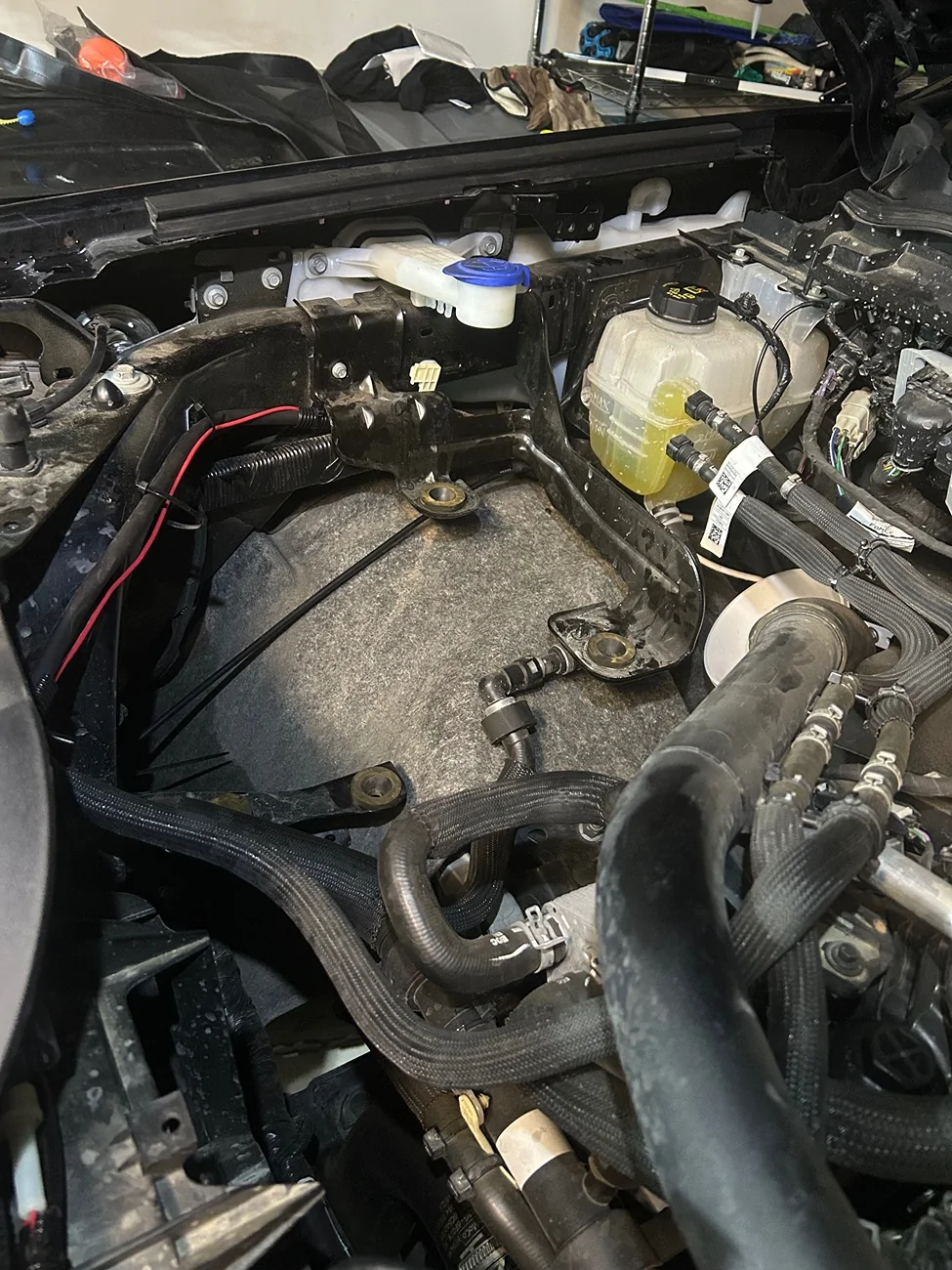

RRaptorscallion0331
Colin
May 6, 2026
200
138
I’m going to reinstall my S&B CAI later today do you want me to snap a pic of the same location for comparison? I plan on getting a fabulous fab intake system with snorkel eventually…
sdca7718
Aug 8, 2025
69
87
VA
‘26 RANGER RAPTOR ‘20 EXPLORER
Might as well, I have only seen the Aus Raptor engine bay from YouTube. I’m sure there are a few differences from the US version.
RRaptorscallion0331
Colin
May 6, 2026
200
138
Here ya go!
Ford Ranger 2026 USA RAPTOR fitment issue Fabulous Fab Airbox IMG_0174
Ford Ranger 2026 USA RAPTOR fitment issue Fabulous Fab Airbox IMG_0173

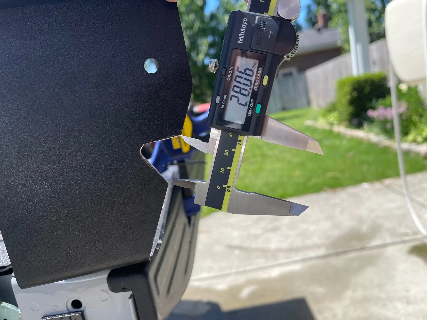

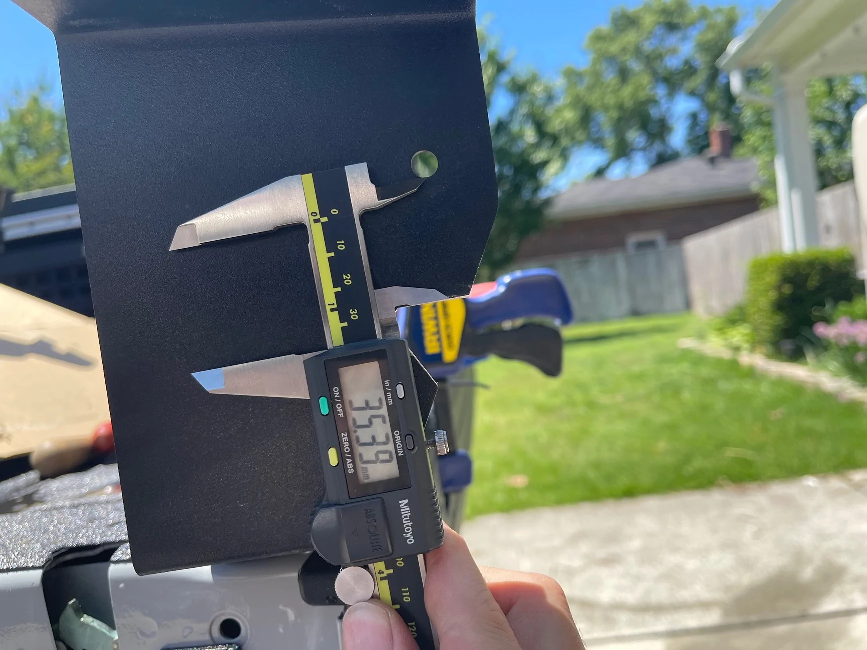

Hey Guys,
Nelson from Fabulous Fabrications here, Thank you for sending me a link to this forum post and alerting us to the changes made on some of the USA Ranger Raptors. As much as we thought the Ranger Raptor was meant to be a Globally Universal Platform, (minus LHD vs RHD changes) it appears this brace is going to make things interesting for us.
We've now heard of two vehicles that have encountered this issue, so i appreciate you giving it a go to make it fit. I've passed that information onto our other customer and he was happy to do the same thing. Using your measurements (and thank you for showing this in Metric units), we can probably make some easy adjustments to our bracket to allow for the variation with the US Model. But that only helps us on the Cold Air Intake Version for future orders.
I'm going to try and get some measurements and reference points, and if you guys are willing to help, we will try and work something out to make sure the inlet for our Snorkel version isn't going to be completely blocked by that extra brace that you have both found on your models.
Thank you again for bringing this to our attention so we can address it before it becomes too big of a problem.
Cheers
Nelson

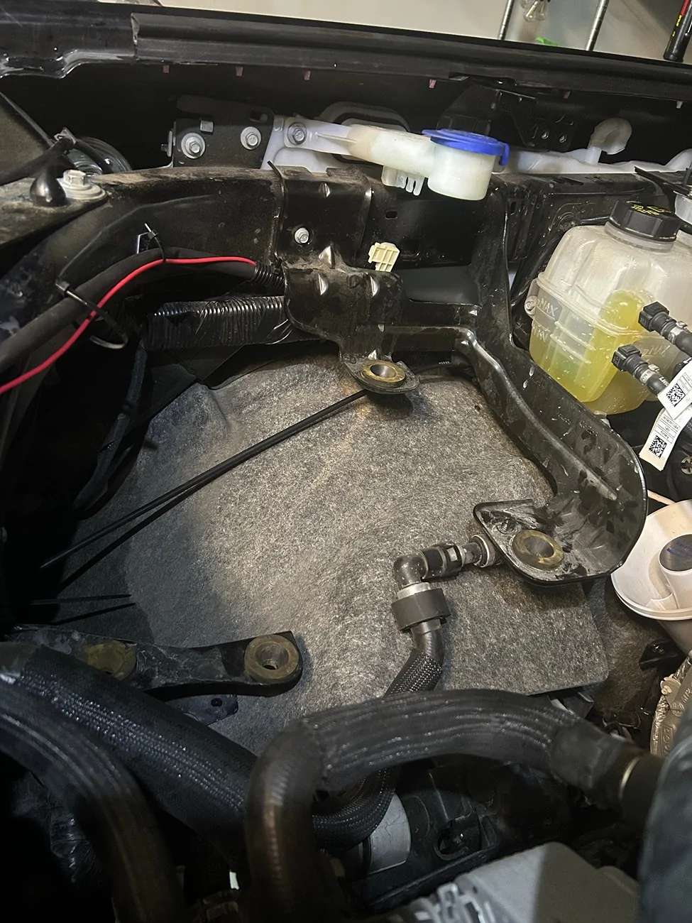

Re-installing stock airbox this evening before I head to the dealership tomorrow to see about someone looking at my driver-side turbo. Here’s a little better picture since i had to remove my PA speaker that melted a little next to the down pipes…
hey @nelsonion is this a deal-breaker for the fabulous 4” snorkel and twin airbox kit?
Ford Ranger 2026 USA RAPTOR fitment issue Fabulous Fab Airbox IMG_0448
Ford Ranger 2026 USA RAPTOR fitment issue Fabulous Fab Airbox IMG_0449

I know i'm too late and you've probably put this back together, but what we need to figure out is where that beam sits in relation to the half round section of the original airbox while its installed. Looking from the front Right wheel well into the engine bay would be the easiest to see while the inner Fender liner is removed.
Ford Ranger 2026 USA RAPTOR fitment issue Fabulous Fab Airbox Screenshot 2026-07-21 at 11.12.06 am
Ford Ranger 2026 USA RAPTOR fitment issue Fabulous Fab Airbox 1784598209042-ld
RRaptorscallion0331
Colin
May 6, 2026
200
138
ive made it pretty easy to take the inner fender liner off, I can try that this evening and report back
