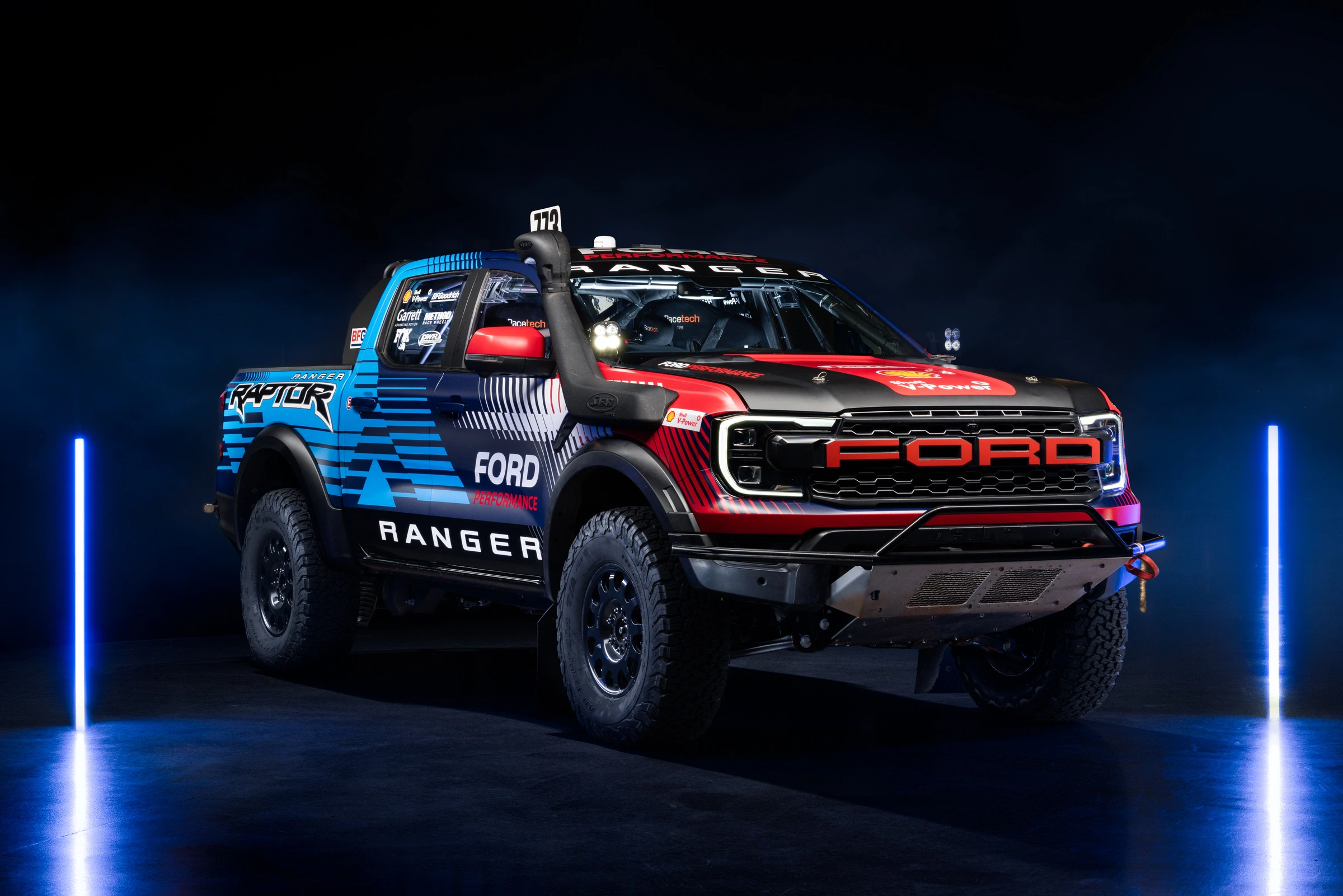

Anyone know what the Ford Team used on there Ranger Raptor when racing in either Fink or Baja?
I heard rumors of AFE Pro Guard7.

They used a snorkel at Finke so probably stock air box?
I’ve watched a few videos on the finke race and all the ford racing engineers said the power train/engine was completely stock. They only added stiffer springs to the rear shocks due to weight from all the equipment in the rear which is required for the race

Stock airbox and filter. They plumbed in a snorkel they flipped backwards to prevent the filter from clogging up and causing issues with the turbos. Not ideal for taking in fresh air but much better than a saturated filter and burning up and engine!
