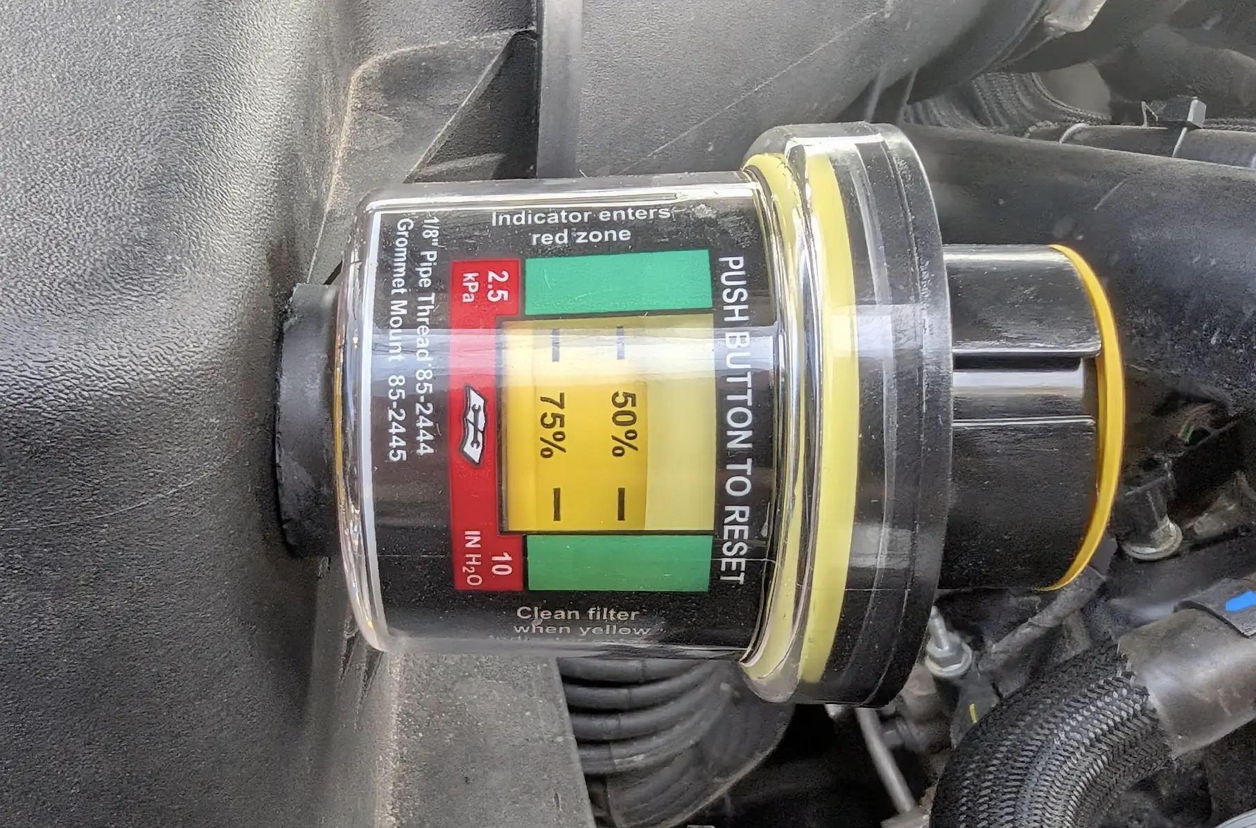

To take a stab at a "Filter Minder" I purchased the K&N version that is calibrated at 10 " of water or very sensitive. Ran the pickup on the full boost through a few gears and checked to gauge. It was maxed out.

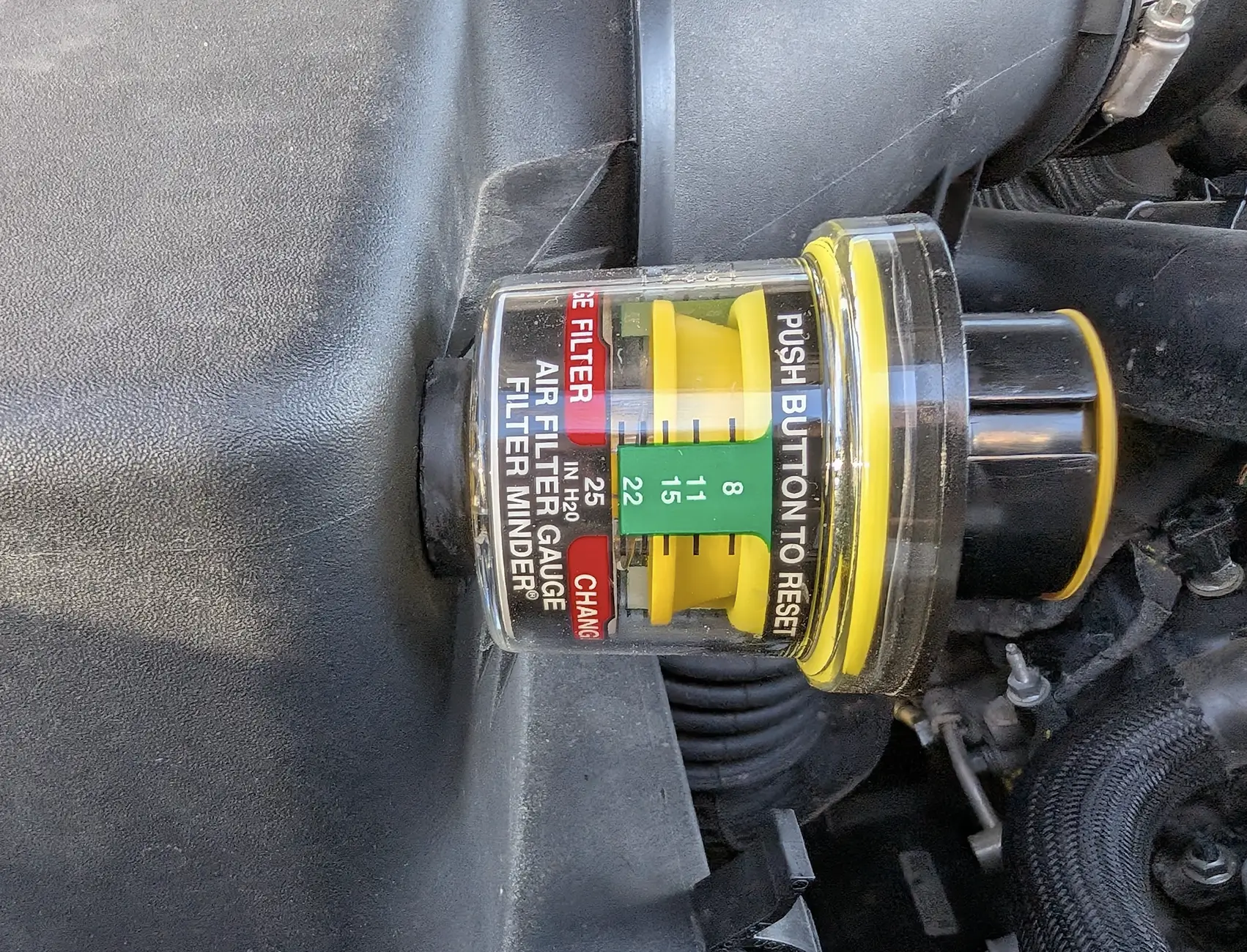

I then acquired a WIX version that is calibrated at 27 inches of water (....or about 1 PSI). I did a full boost run and got this result. This is on the factory air filter that looks like new but does have 18K miles on it.
Ford Ranger Air Filter restriction tracking 1771350834608-i
While it looks like a lot of restriction, it is less then 0.5 PSI.

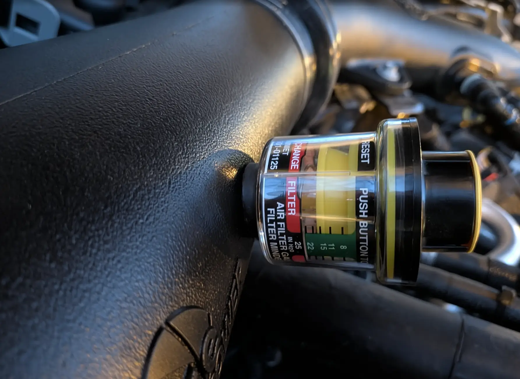

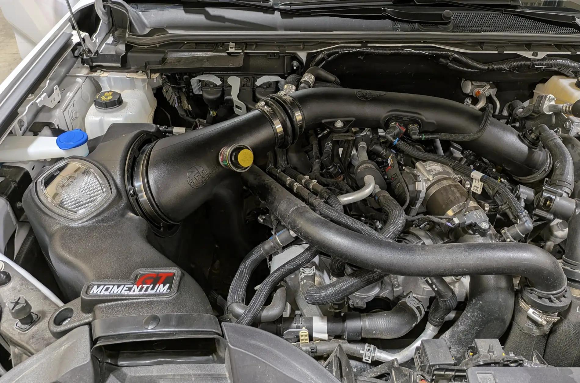

Just wanted to update. I did add a CAI. I went with the AFE given they have as an option to their CAI the Pro Guard7 filter which is 99.7% (....is that 100%?) but it gives up air flow. So, I went with the Pro Dry S which to me seems like a happy medium between flow ability and filtering. I do oil analysis so if silicone goes up...might have to switch to their Pro Guard7.
What I was surprised with is the restriction value based on a full power run and the vacuum it created between the new filter and the engine was almost identical to the factory filer and air system. You can see where I added the "Filter Minder".

Here is the Filter Minder after a full power run. I do see upper 20s lbs of boost for a very short time initially, then around 24 - 25 lbs tops in the gears above.
Ford Ranger Air Filter restriction tracking 1779301711661-72
Just curious for those engine builder's testers.....I was expecting a little less vacuum with the AFE filter vs factory. Priority one for me is keeping dirt out as good as the factory filter. The truck has plenty of power.
The AFE kit went in fine, well made. Filter looks awesome and well made. Only way for air to get in is the factory front scoop.

I was suprised the factory filter (....still had in at 20K miles) vs this AFE CAI with there Pro Dry filter had the same vacuum restriction between the fitler and the engine. I would have expected this AFE fitler to flow a little more air thus lower vacuum restriction. Its not worse then a factory filter but....as installed does not flow more. If the gauge I am using is a valid way to access air flow after the fitler??
