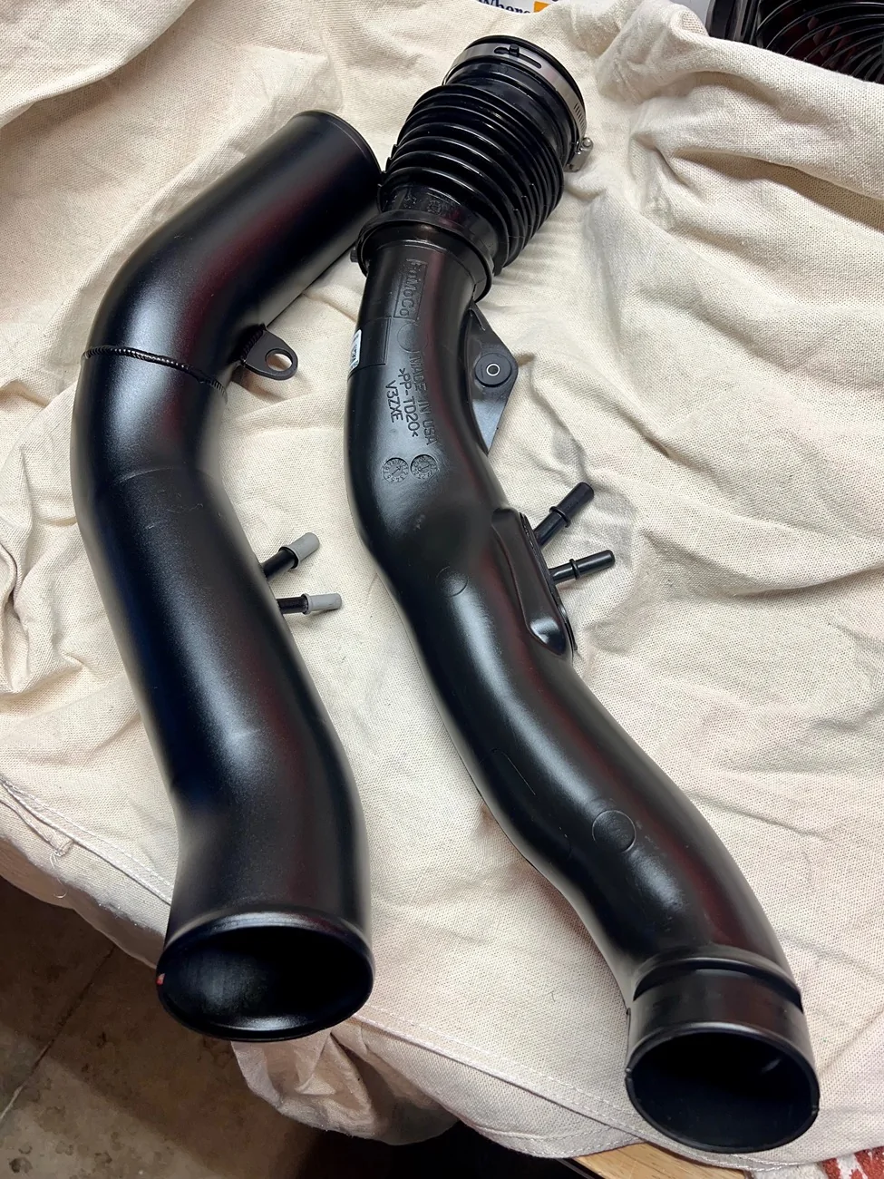

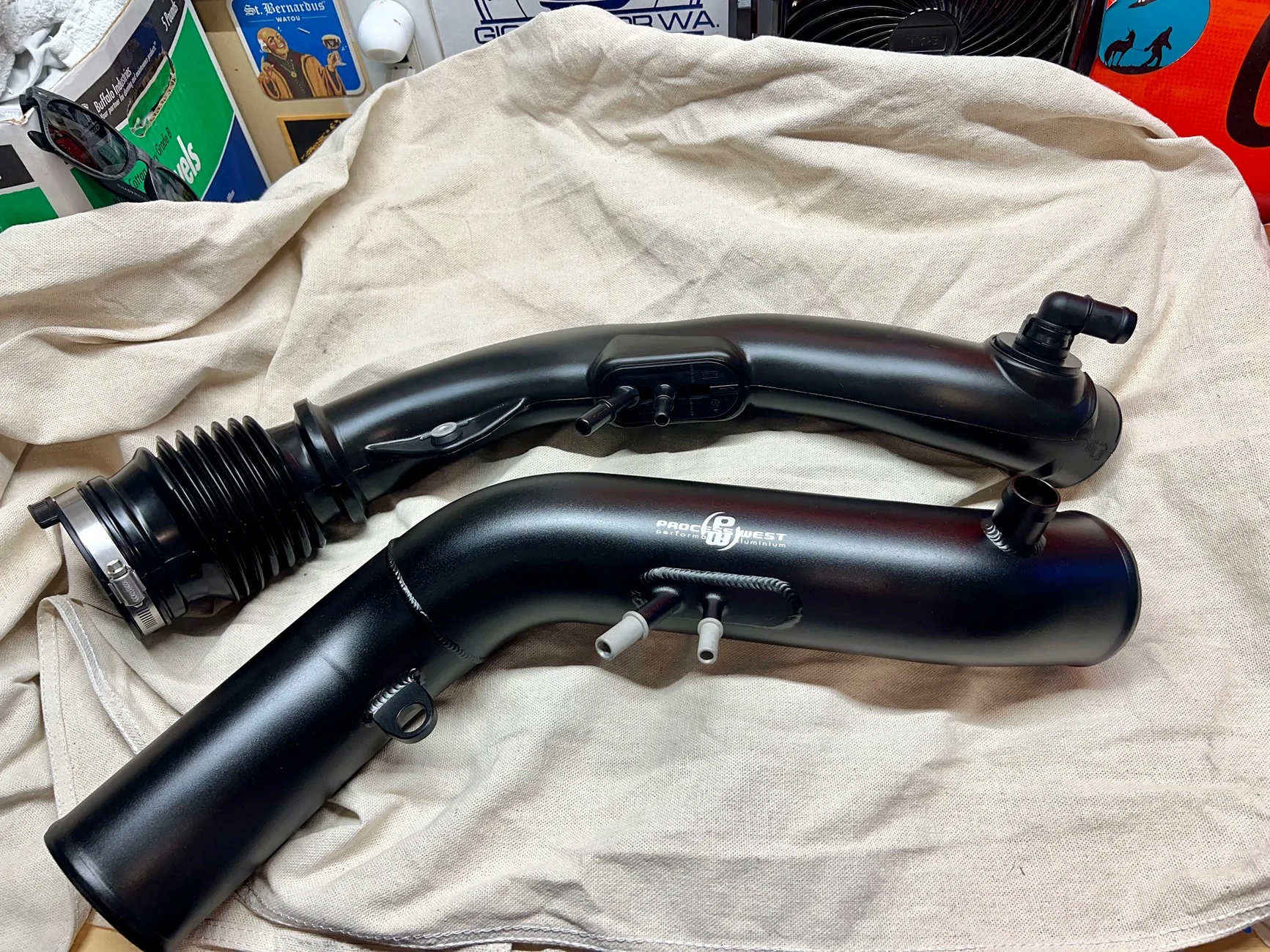

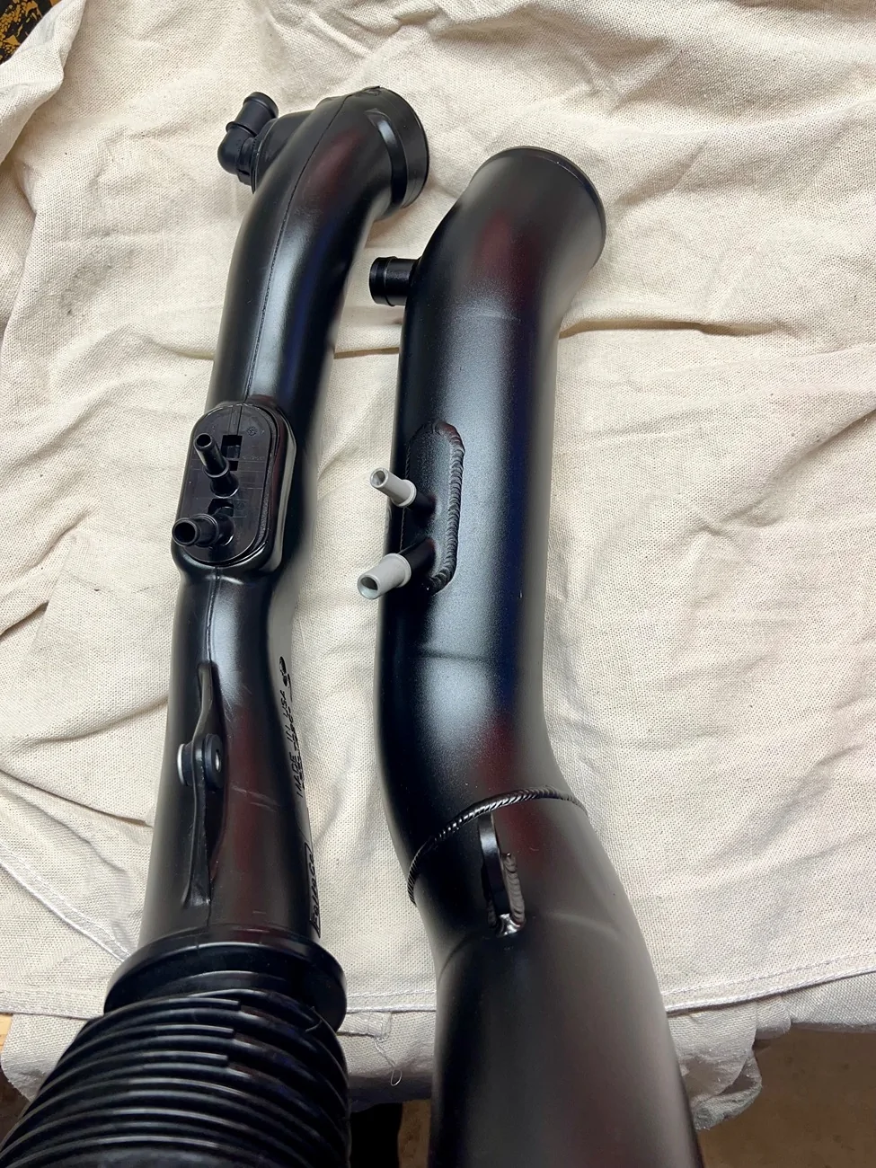

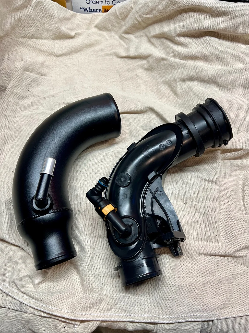

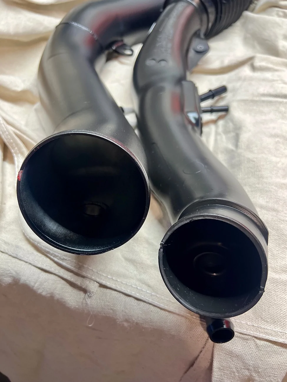

I installed the PW crossover pipe. Huge difference in the size and how soft and smooth the bends & transitions were. Great kit and easy to install. As far as the air box goes, there’s much debate. A lot of CAI have horrible sealing or moderate filtration and can actually coat the intake pipe with a mist of oil which is not good. That does’t mean they’re all bad. It just was too much of a risk for me so I opted to just run a K&N filter in the factory air box. And with the PW intake pipe this thing seems to love it! Along with a CVF stage 1 intercooler & aluminum turbo pipes this 3.0L RIPS!
Here’s the difference in those crossover pipes. You can see for yourself the drastic difference!

wow!!!!
i didn't even know they made a different pipe. that is a significant difference in size

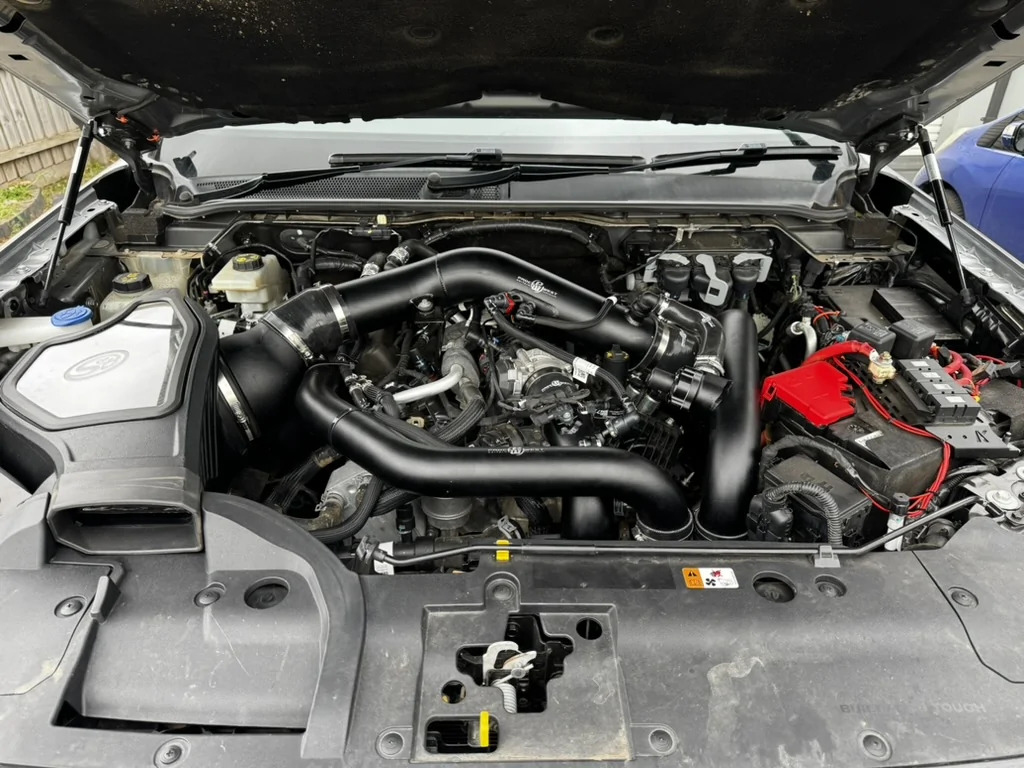

A good aftermarket airbox, quality filter, and larger pipes definitely helps these RR's breathe easier and "wake up". The problem is the filters though. Very few filter at, or above, the factory paper filter efficiency and when you look at how much that means is getting through to your engine, I wouldn't go near them if you want your engine to last. S&B and aFe were the only ones I could find that filter above the factory filter (with test reports) and only S&B offers a paper version. I went with the S&B CAI, paper extendable filter, and pre-filter "sock" connected to the full PW piping (to turbosmart stage 1 IC).
The S&B crossover pipe is larger than the factory one, but plastic. It's decent quality, but I don't trust the smaller plastic hose fittings vs the higher quality aluminium PW crossover. I picked up an elbow to connect the two and it's been great.
With the S&B airbox side panel off it sounds great and breathes easy. For offroad trips I put the panel back on, and soon I'll add a snorkel connected to the side of the airbox.
