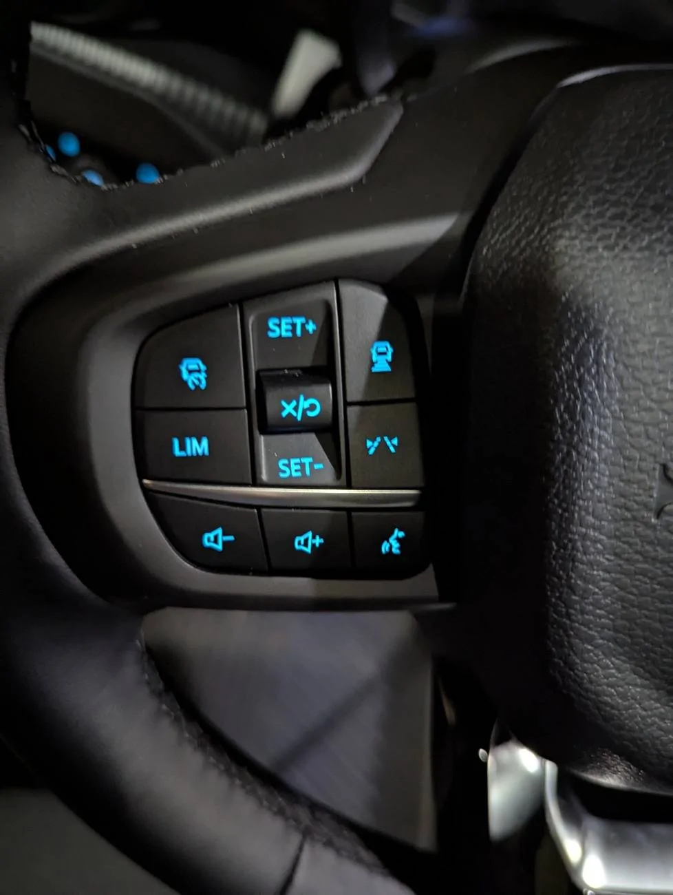

On my raptor this button is active in all cases, but it only works from 65 km/h and the indicator light in the cluster turns green at that moment.

You dont have much options then other than to take it in.
either a module isnt working as it should, or you have a simple blown fuse, although that would be embarrassing at this point.

You would think in either case a code or error would pop up somewhere. Screen. Ford pass. Tomorrow will hopefully tell.

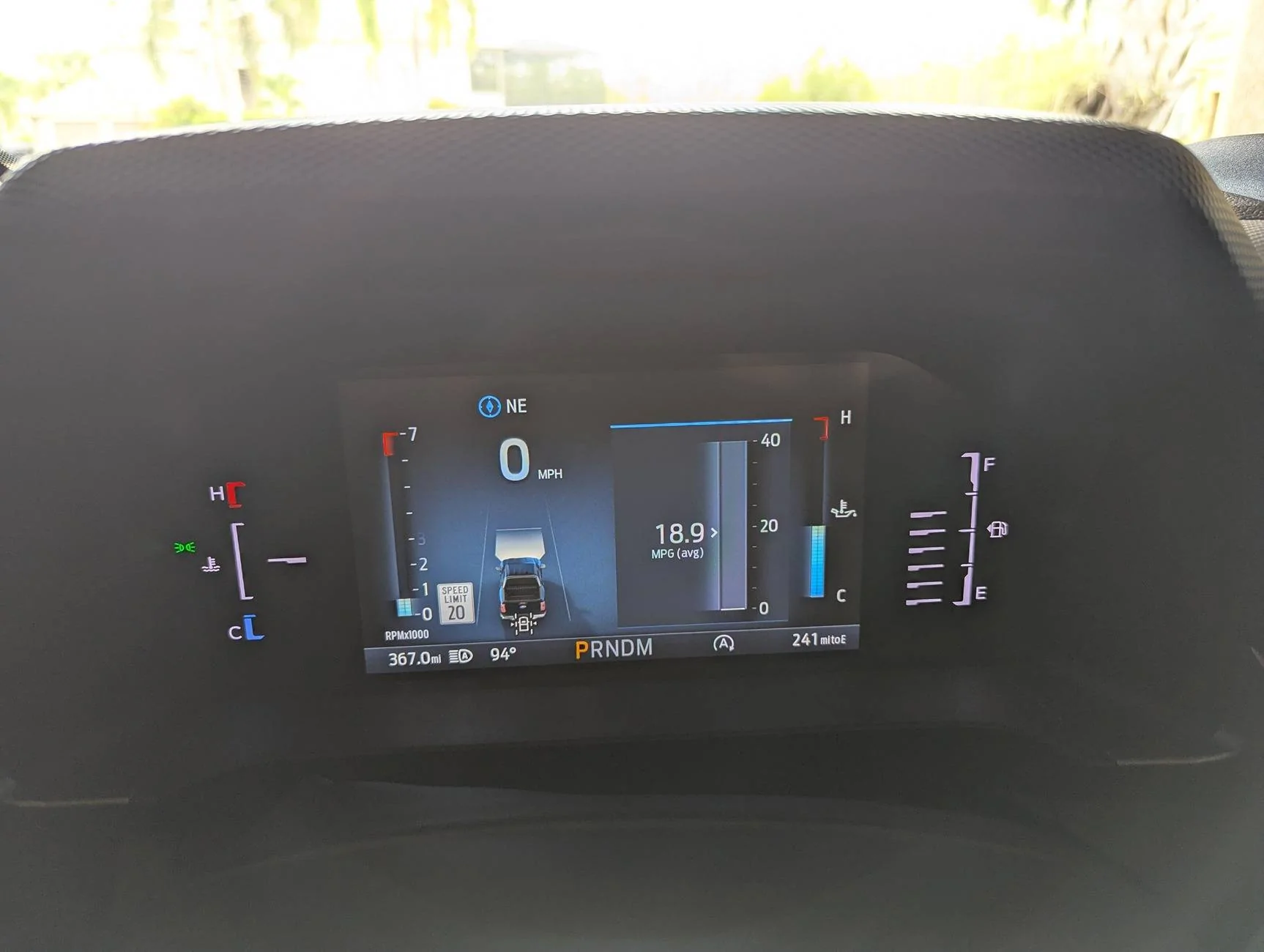

Well took it in to dealership. Confirmed things not working. Just got call. They had to factory reset all modules and reload everything. They state everything is now working ?. We shall see once I pick it up and verify.

That is odd that all of that wasn't working. I've read that things like ACC, lane centering and pre-collision all rely on a single sensor. But seeing that it was fixed by a reset/reload, sounds like it was a software error.
I suggest using the systems at every opportunity, even if it's not needed. Just to be sure the fix is permanent.

Just got it back and unreal that every single thing is now working as designed. K will obviously keep an eye on everything to make sure there is nothing more going on.
Thanks to those who tried to help as it surely was not easy to figure out nor understand.

So that's what the dash looks when everything is working lol

That's one way. There are options on what to show.
