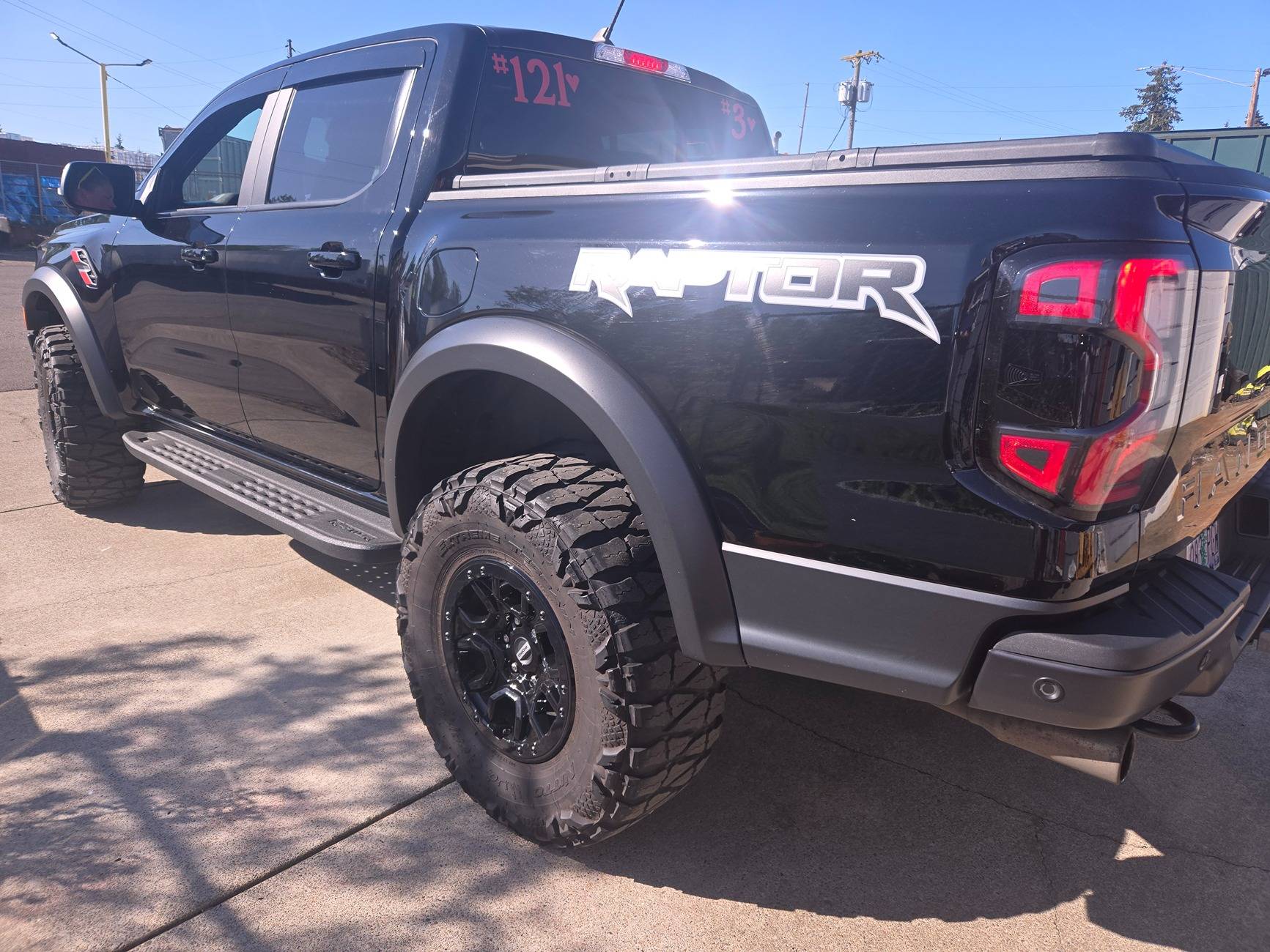

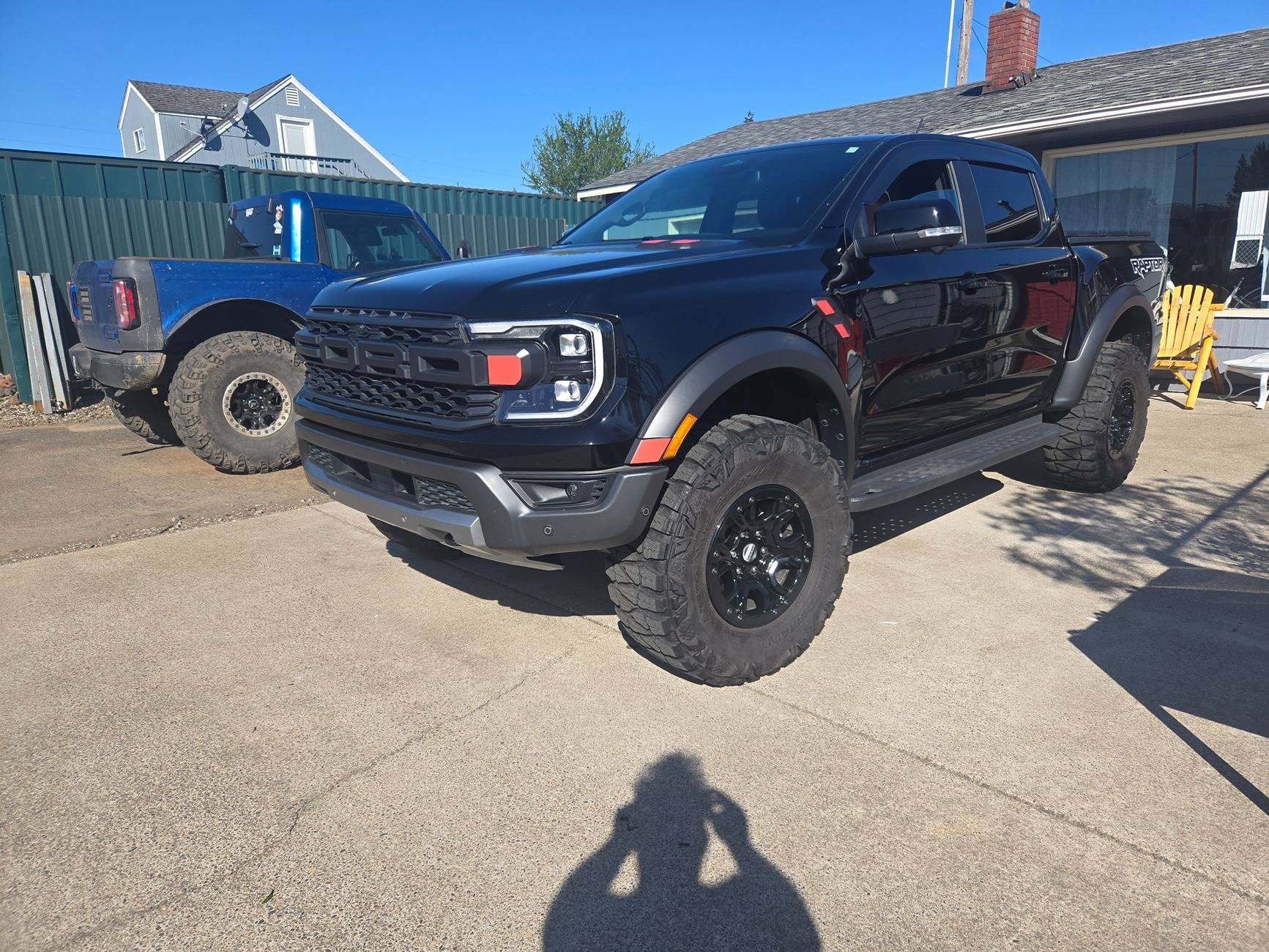

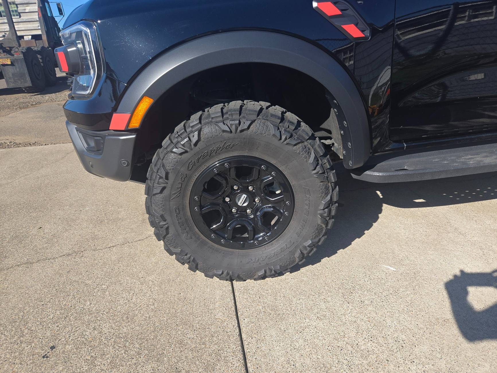

We did the same thing with our Ranger Raptor but instead of using a perch collar, we opted for Leveling spacers instead. 1.5" front and 1" rear. I prefer these because the ride height on the shock absorber is in the same place which also can affect the computerized shocks. Additionally the spring rate is not increased, and the struts still have the full range of motion. This does increase the down travel or droop slightly, and also allows for slightly less compression travel. So it moves the struts range of travel top and bottom limits downward by 1.5 in. In contrast the RPG spring collars just change the ride height by moving the position the Spring Rides on, and the overall shock high and low points remain the same. So at whatever ride height you're at you now have more compression available and less droop available compared to putting a spacer on top of the strut.
We also trimmed the same areas.
Tires are 35x12.50x17 Nitto Mud Grapplers
Wheels are Bronco Sasquatch

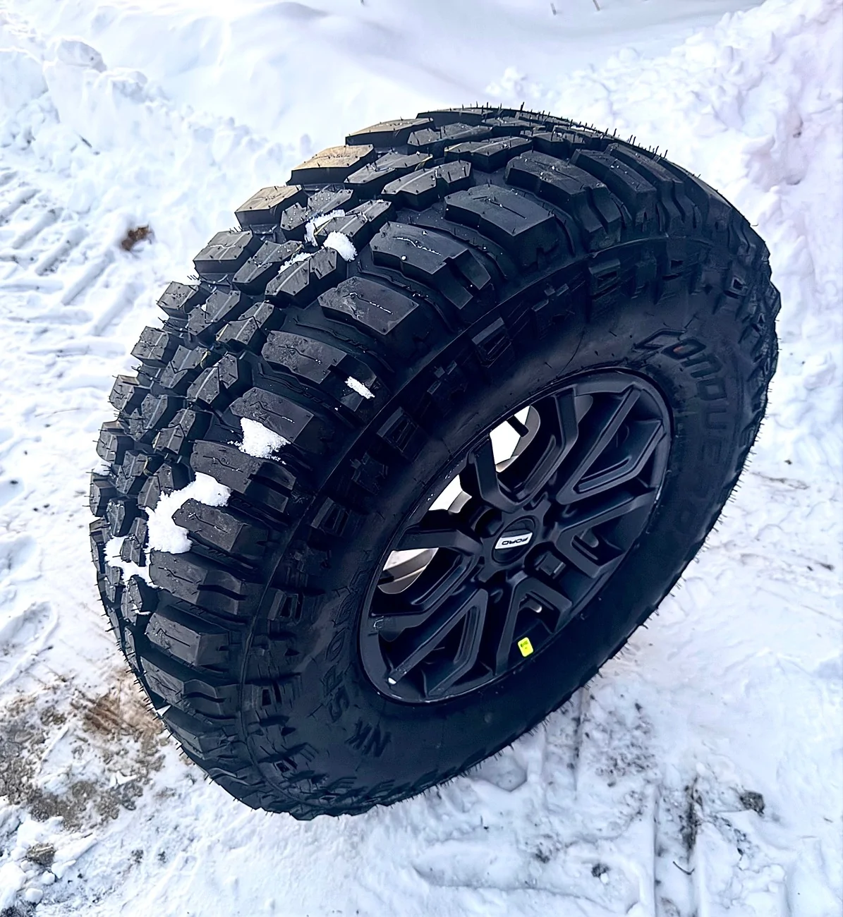

We will see soon if these will rub or not 😅
Quite light 315/70-17 MT 28.0 kilograms so about 62 lbs.

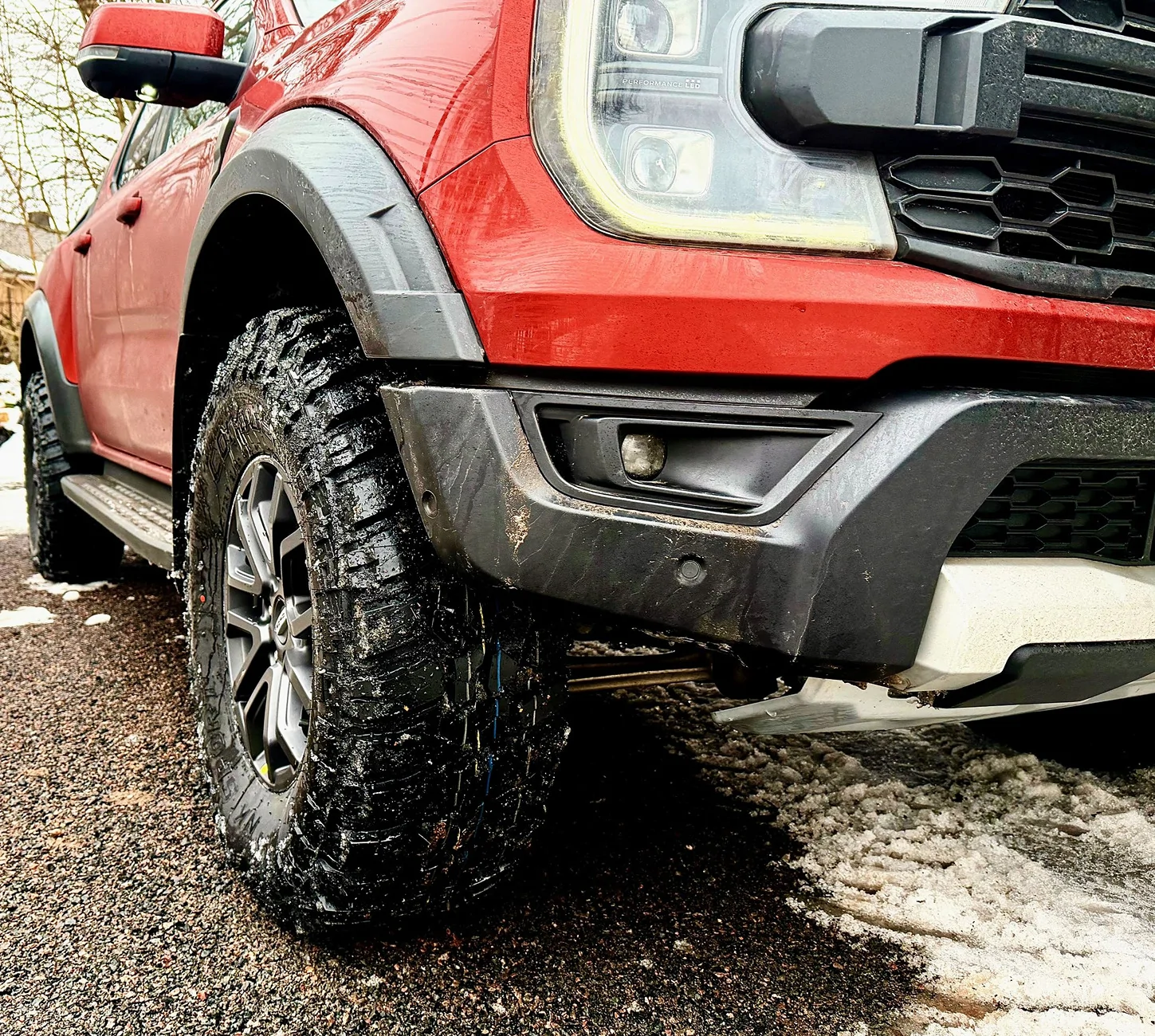

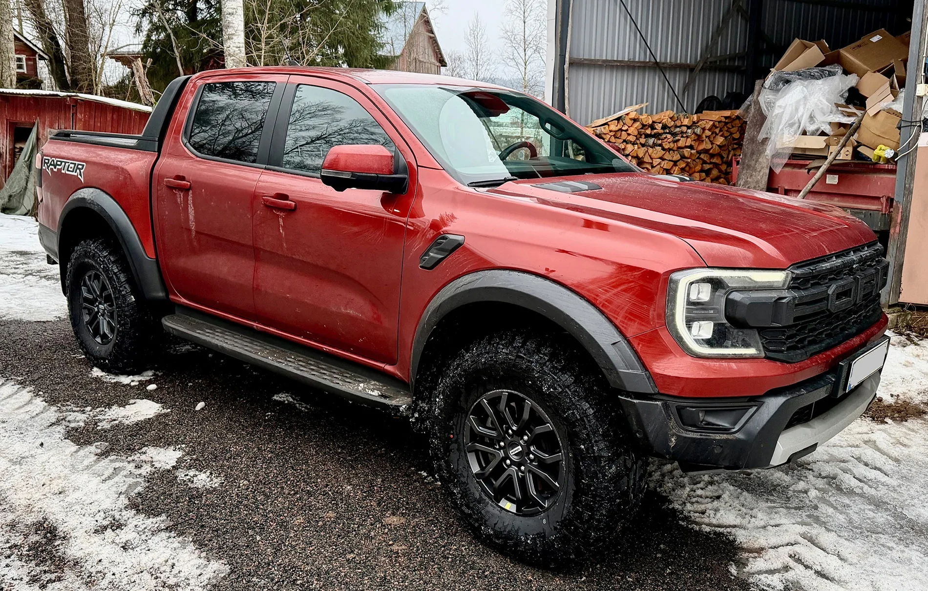

Nankang MT-1 315/70-17 seem to fit perfectly :) They are very lightweight (about 62 lbs) but stll about 34.5" in diameter.
Only real modification was to grind front stabilizer bar top bolt, that protrudes towards the tire over the nut. It was not touching, but just to be 101% sure I cut it 4-5mm shorter and now it sits flush to the nut.
No modifications to mudflaps, front nor back and front tires do not come even close to them.
Perhaps there are some differences in between US and EU versions...? :oops:
