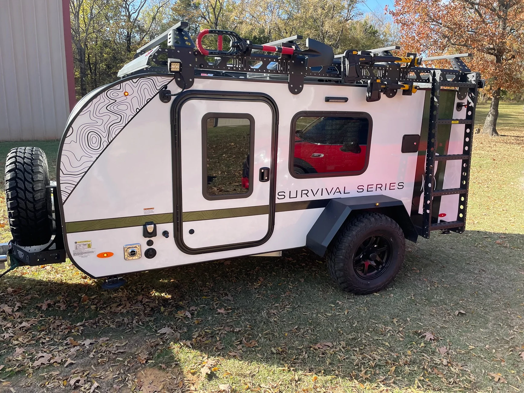

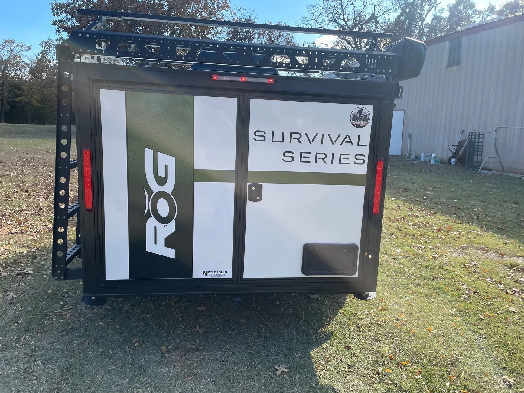

h1k3rb, that is a cool little trailer! Buy a trailer TPMS and remote monitor so you can watch for overheated bearings and air leaks. The tires are probably 50 psi (max) rated, I believe you have a 3500 pound axle. You should *NOT* keep them inflated rock hard, it will beat the crap out of the frame, cabin and your belongings. Weigh the trailer fully loaded with your stuff and water, and use a load/ tire pressure chart for your particular tire to determine how much air you should run. I bet 30 to 35 psi would be appropriate.
Does it have brakes?
What battery type did you install?
What is the payload?

Nice! I’m jealous of the mpg. I bought a Rög square drop in November and averaged 11 pulling it back from Michigan with my dad’s truck. Hopefully it does better locally.
10’ inside?
That's a cool rig!
The weight isn't the big issue hurting mpg with trailers this size, it's the aerodynamics.
Look at those racks and cross bars and side ladder, etc. it's dreadfully to aerodynamics.
