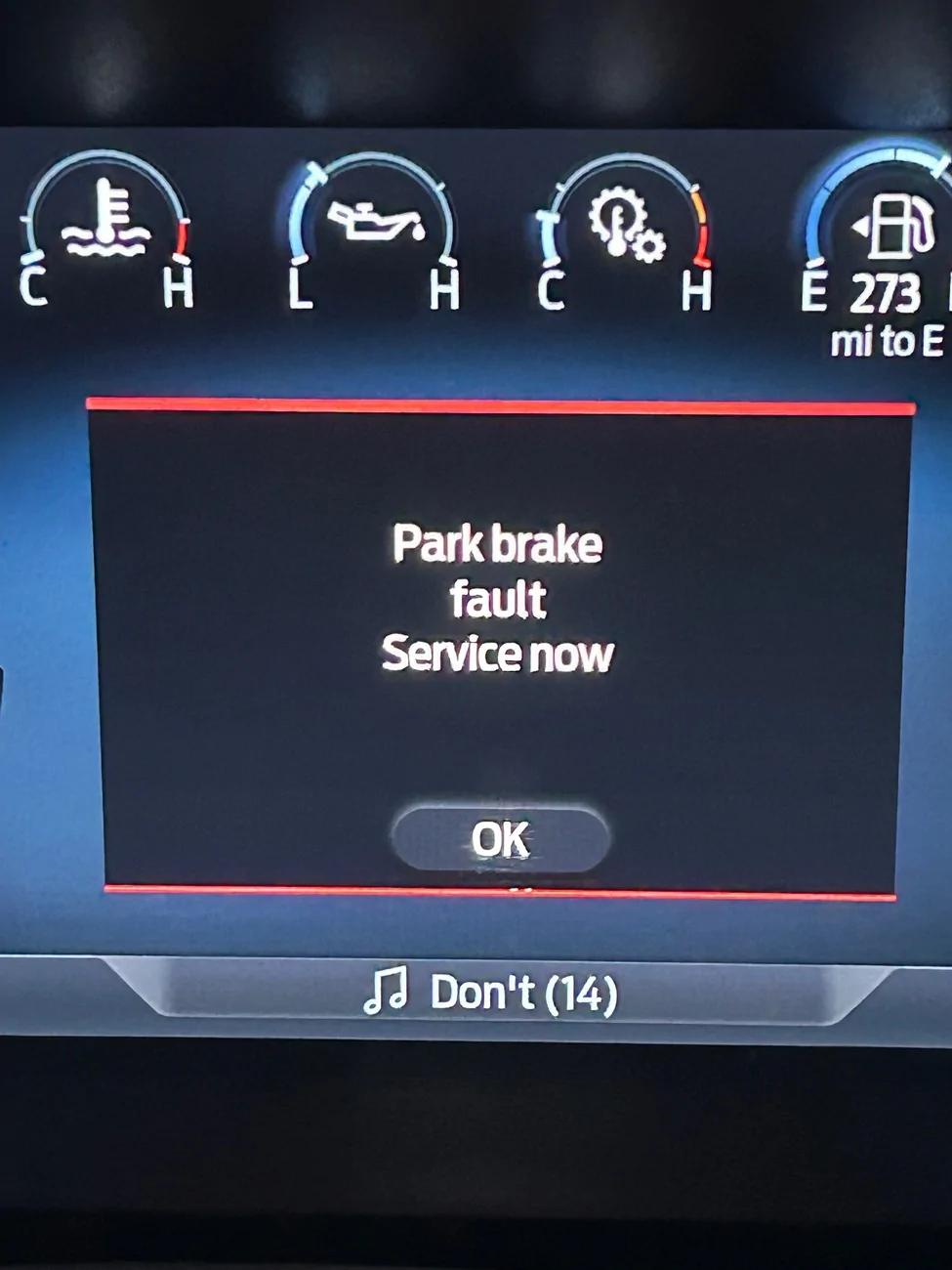

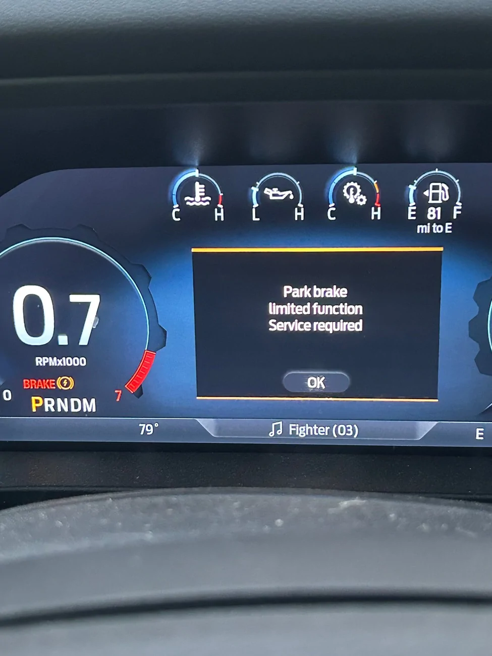

My truck is at the dealer now for the same issue. I am not sure about TSB but it was brake fluid from the caliper leaking onto the motor for the electronic parking brake. Luckily Im still covered under warranty, but Ive been a few other users on here with the same issue.

Yeah, I've seen plenty on the parking brake failures, but mine wasn't that. My error was just a pretty ambiguous "Check Brake System". They had to pull the master cylinder and replace the whole brake fluid reservoir because the low fluid switch inside was intermittently shorting out. Apparently it's a common problem on the Bronco (since there's a TSB about it) but I haven't seen any mentions of it being a ranger thing too on any of the boards.
