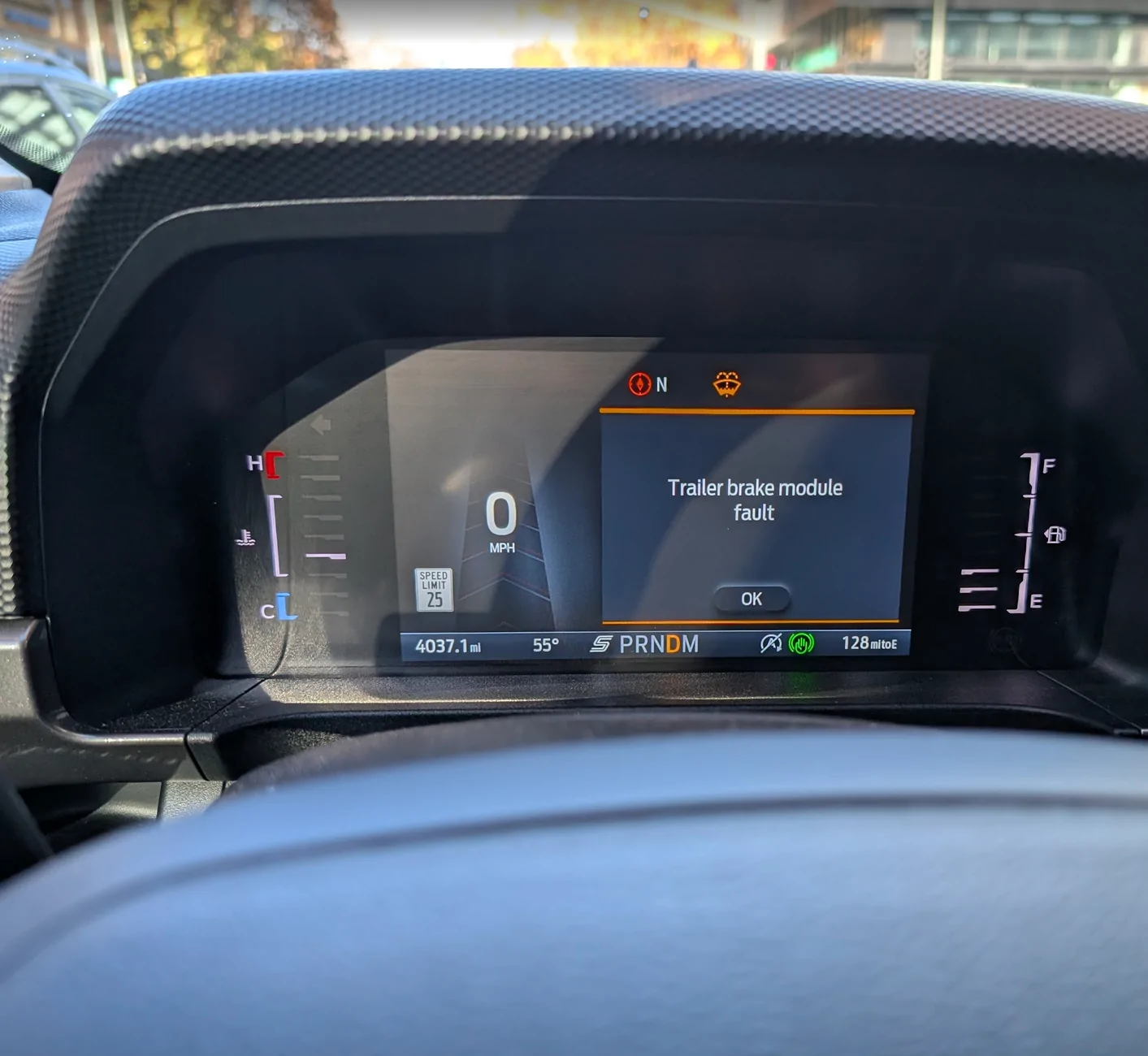

I think I've only seen this error 2 times and do not recall the time/day or environmental factors. I thought it was just a process that did not start or something like that. Anyone with experience know about this error? I do not tow or have a need Yet...
Should I just take it to my dealer and have them check ECU errors etc?

Look this up just might still apply. Had this on my F150.
Special Service Message 53236

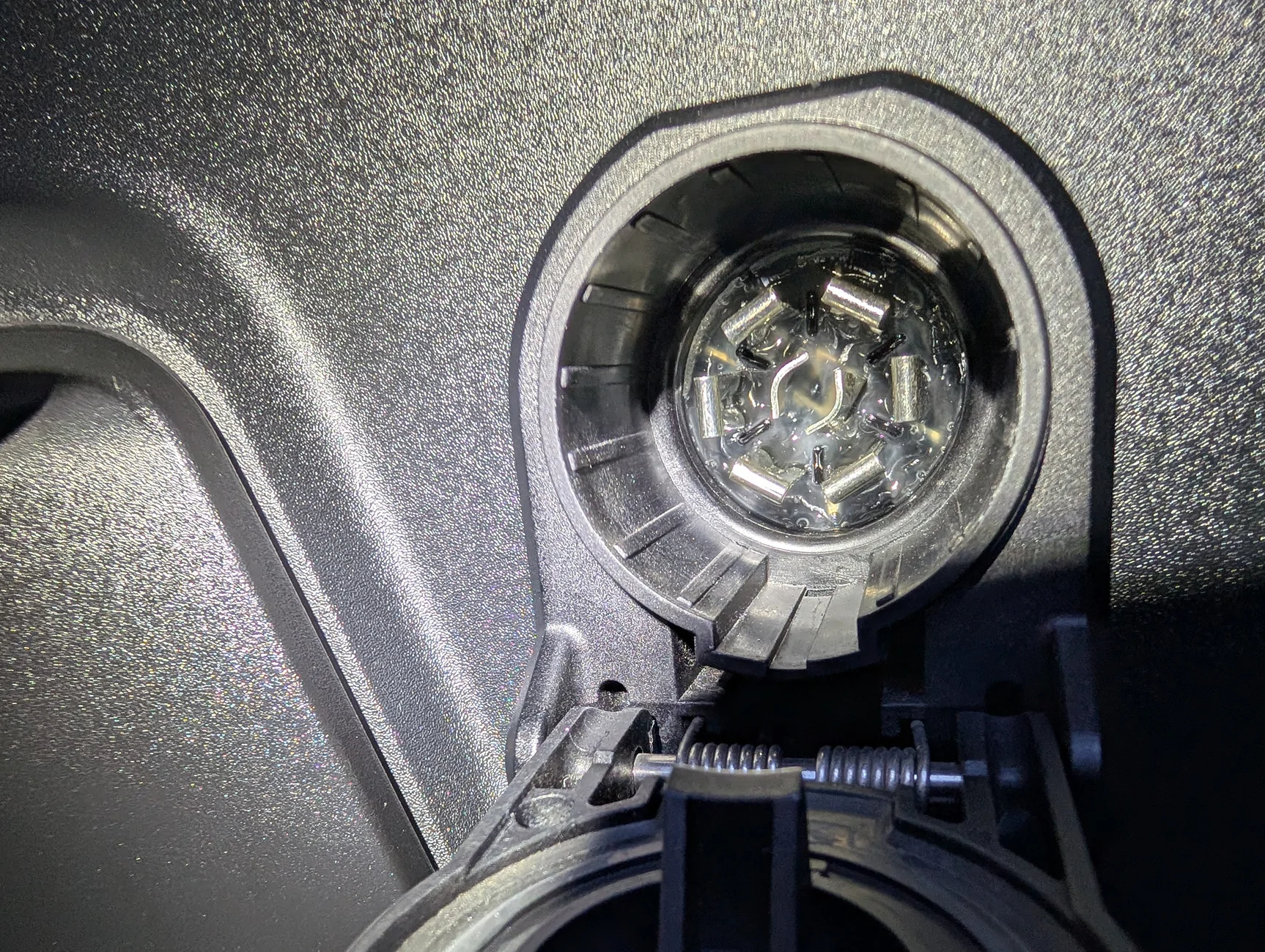

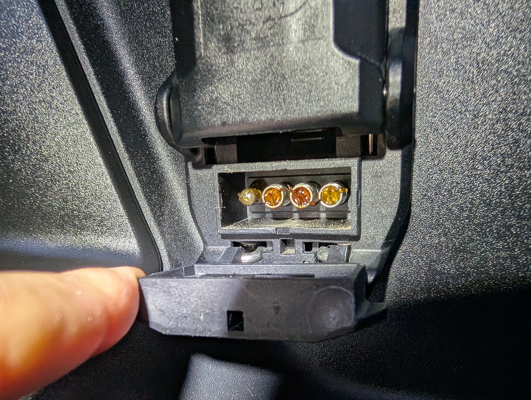

So I went ahead and checked both connectors and they both look like they have grease all over.. I've never tow with this vehicle so how does this happen?

So i texted my friend who worked at Ford for years, now at subaru. He said: "it's meant to be there to prevent moisture and corrosion out. At least that's the theory"
4,137
4,032
it looks factory for corrosion prevention. the three right pins full of grease is the give away because if it came from a trailer plug, the grease would not be inside those three pins so much as the trailer pins push into those

Update: Just got back from my local dealer and they checked all my connections, pins, all the way to the module and found nothing wrong, however there was a update to the module, so they cleared codes, updated module and codes did not come back. So let's hope that's all I hear about this issue going forward.
