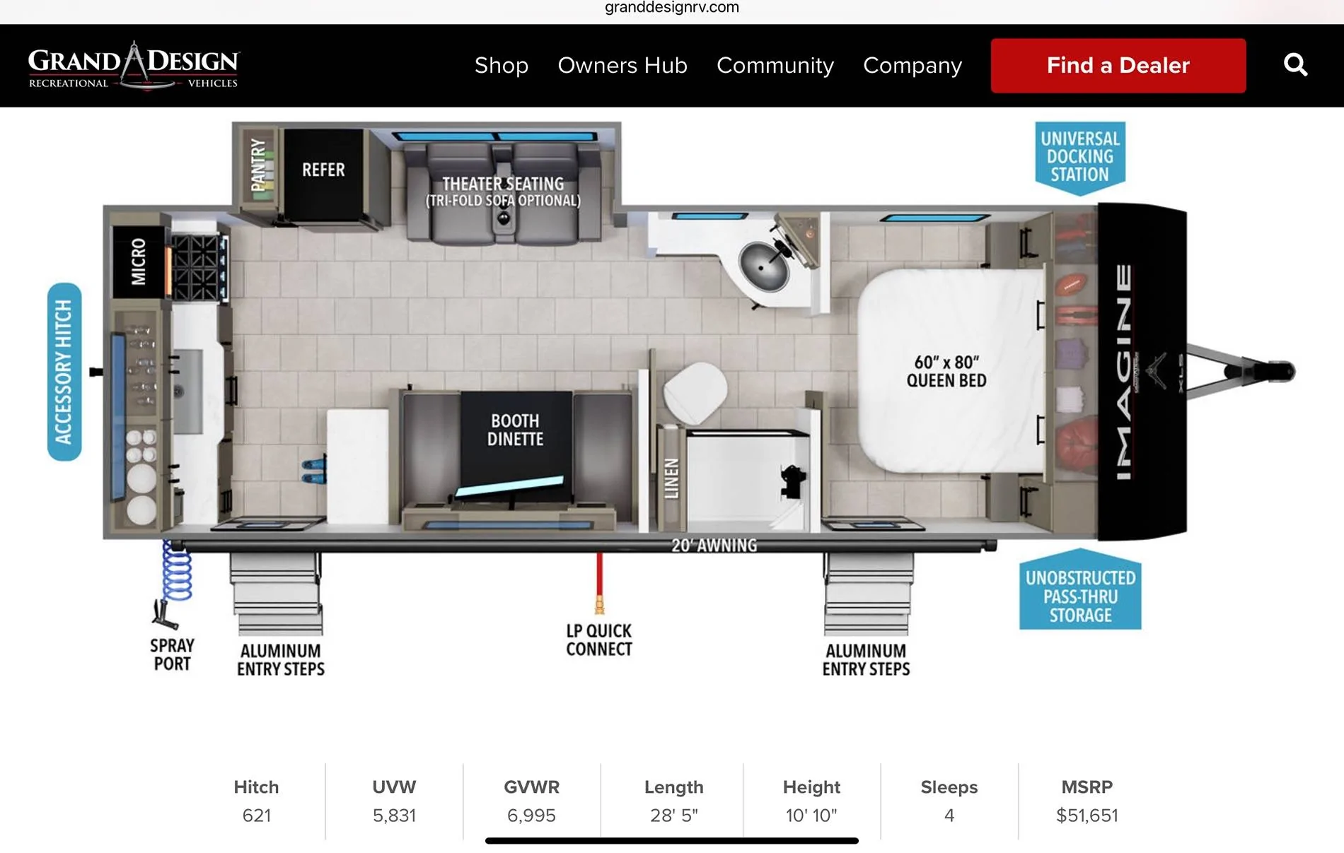

Newbie here. I have a 2024 Ranger XL 2.3 with the tow package.
i am looking at buying a 2025 Grand Design 23lde. The uvw is 5800. Tongue weight of 618.
We will be traveling fairly light with about 700lbs of gear added bringing it to about 6500 lbs. which would be about 85% of max tow.
The trailer is 28’6 long from tip to tail with a 23’ box.
I will be using a wd hitch with sway control. We are mainly east coasters but kids are moving to colorado so i may have to make some west coasters runs. I’ll be using a Curt Echo wireless brake controller.
Does this sound safe or am I pushing too close to the limits?

I myself wouldn't think of towing a trailer of that size and weight. Maybe you could ask the RV dealer to let you hook it up and try towing. That would be with an empty trailer but should give you an idea of how things will go. I have owned 5 different travel trailers all smaller than the one you are considering and towed them with half ton Ford or Chevys over many thousands of miles and wouldn't dream of towing any of them with the Ranger. Just my opinion.
3,632
3,399
that layout in that rv is pretty dang good though. i had a nice 19 footer with full bathroom and i like that layout even better. mine was only 3200 empty and i bet it would have pulled fine with this ranger. full length was only about 24 foot. yours is almost 30 foot, which is long and tall. i think the crosswinds would be terrible with that. ifi t was a lower pop up type trailer, i bet it would be ok
