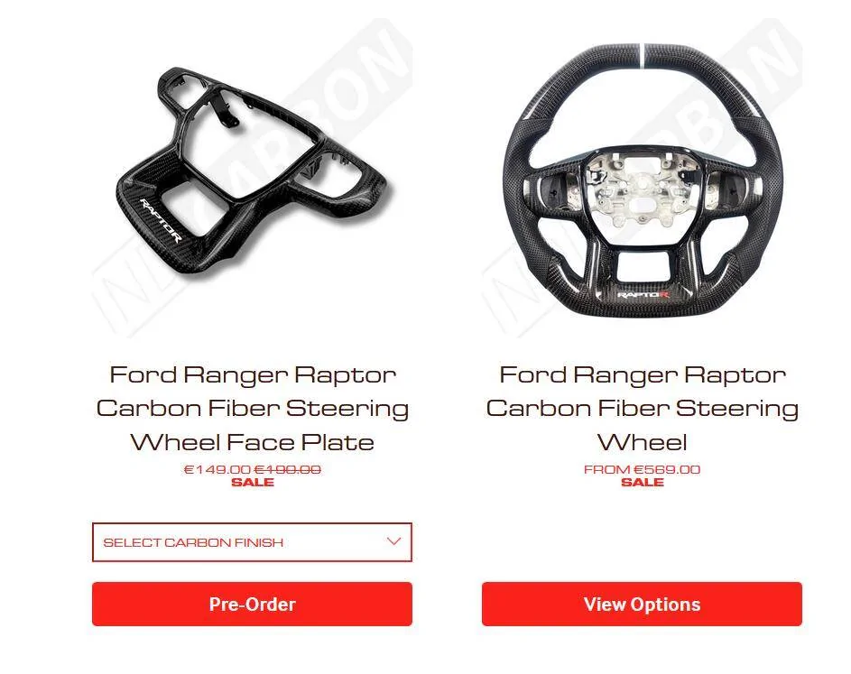

I came across more steering wheel options for anyone interested @ IndiCarbon. Full wheel and just center trim. Lots of other bits too including fenders. Good to have more options.
