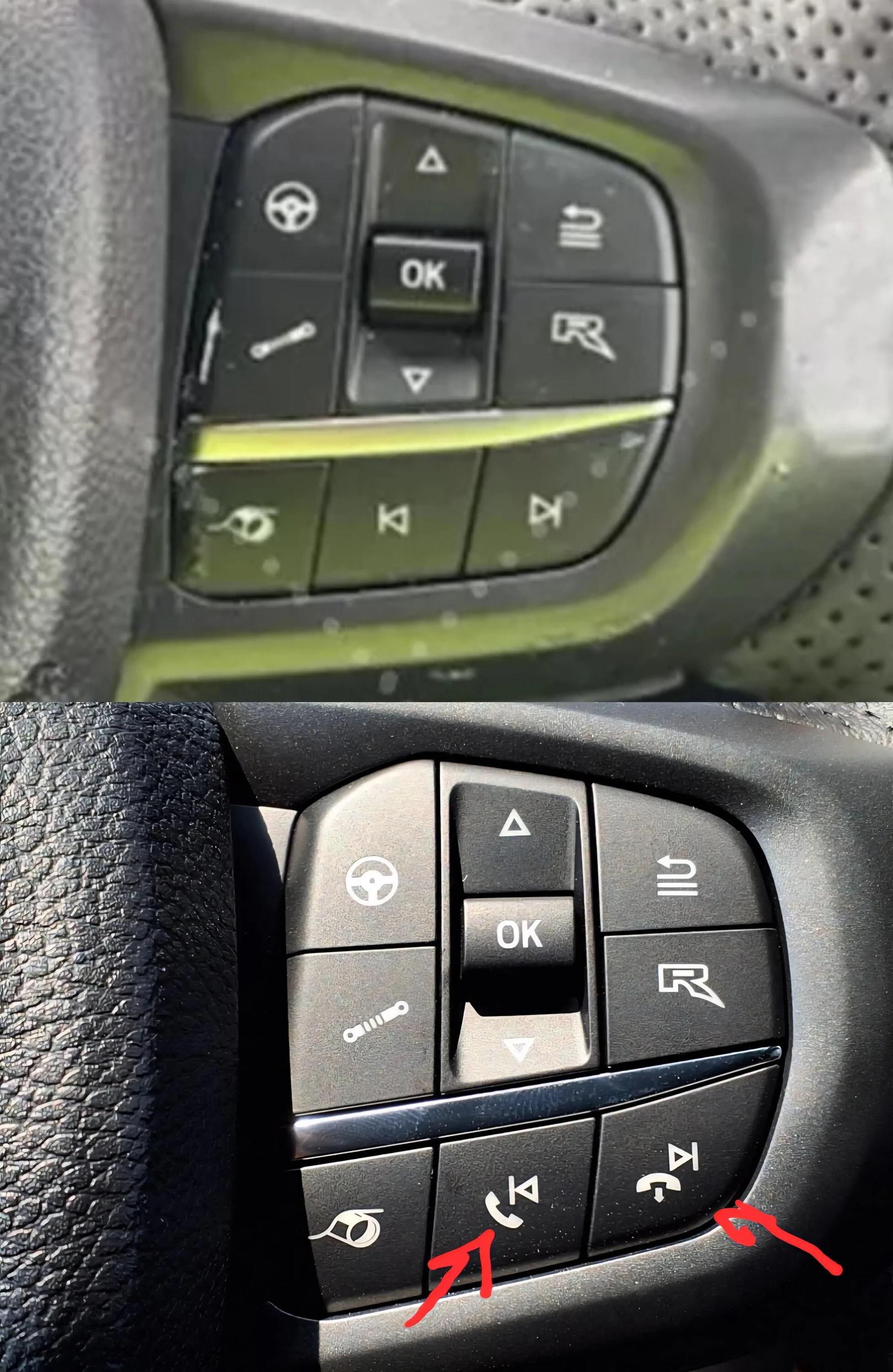

2022-2024 Upgrade. Answer/Disconnect call buttons from the steering wheel.
Mooncat747
Rick
Jul 15, 2025
34
southeast asia
2023 Ranger Raptor 3.0
The 2022 through some 2024 models didn't come with the answer and disconnect call features. I think they were added in 2025. You can purchase the keypad and upgrade your RR to answer and disconnect calls from the keypad. Use Forscan to enable it. And no you cannot just enable the old model keypad. You must purchase the new keypad. So happy to have this now.

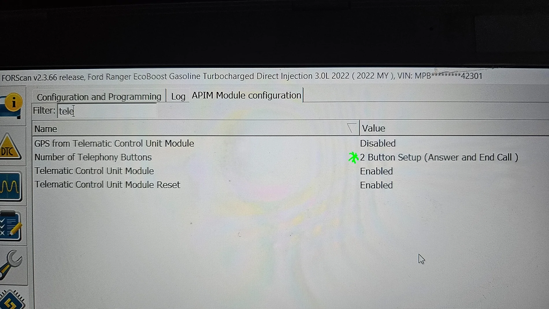

When you say enable it in forscan, is it one where you need to change the code or is it a preset option that you can turn on? Thanks

It's both. APIM module and APIM asbuild, But some vehicles already have it enabled.

It doesn't worked for me.
BTW this AS Built codding are wrong
7D0-01-03 is number of lighting zones
7D0-02-02 is for power flow/climate bar
only possible in configuration I have found is in SCCM.
724-03-01 xxx*-xxxx--
it is type of right button panel on the steering wheel
!!!BE AWARE!!! I played with it and I locked SCCM for 8h with complete aku drained at the end...
