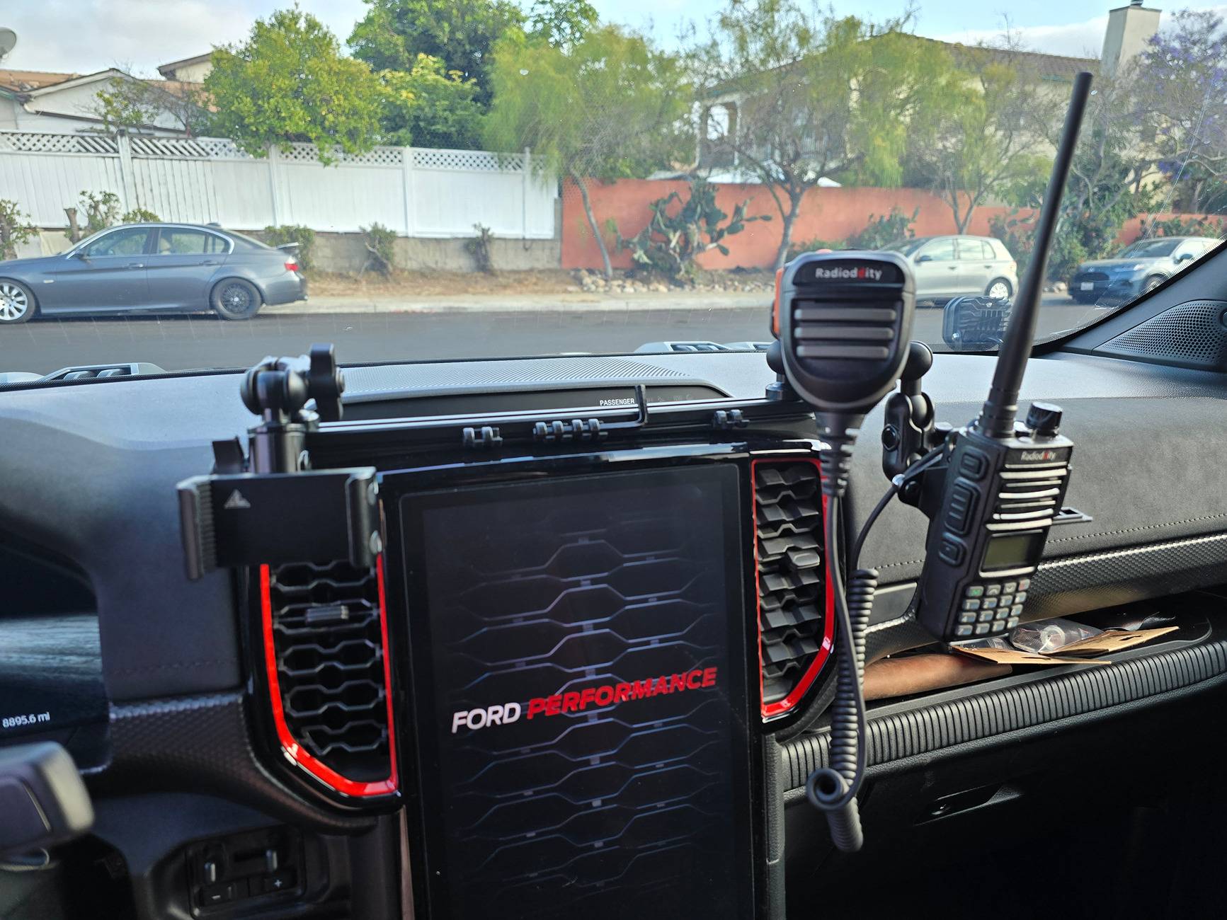

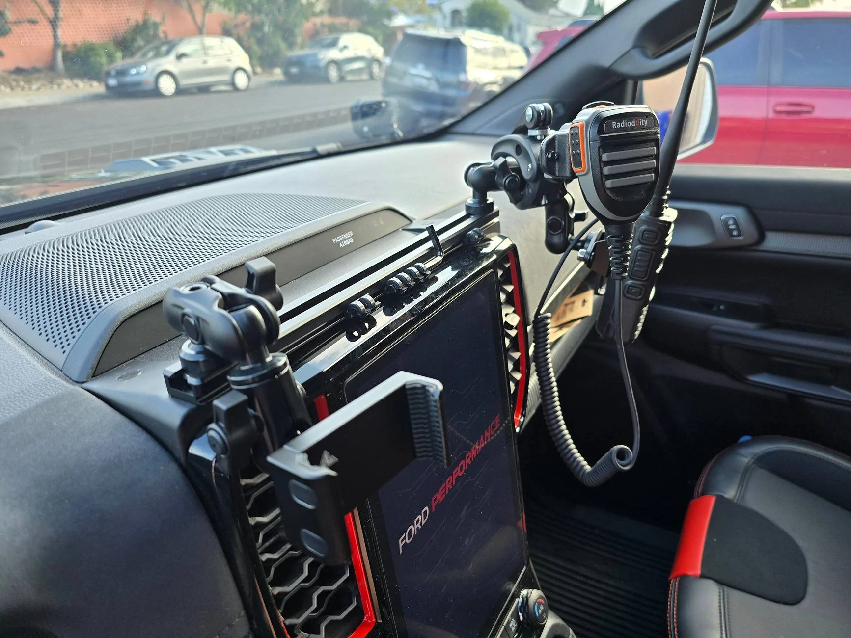

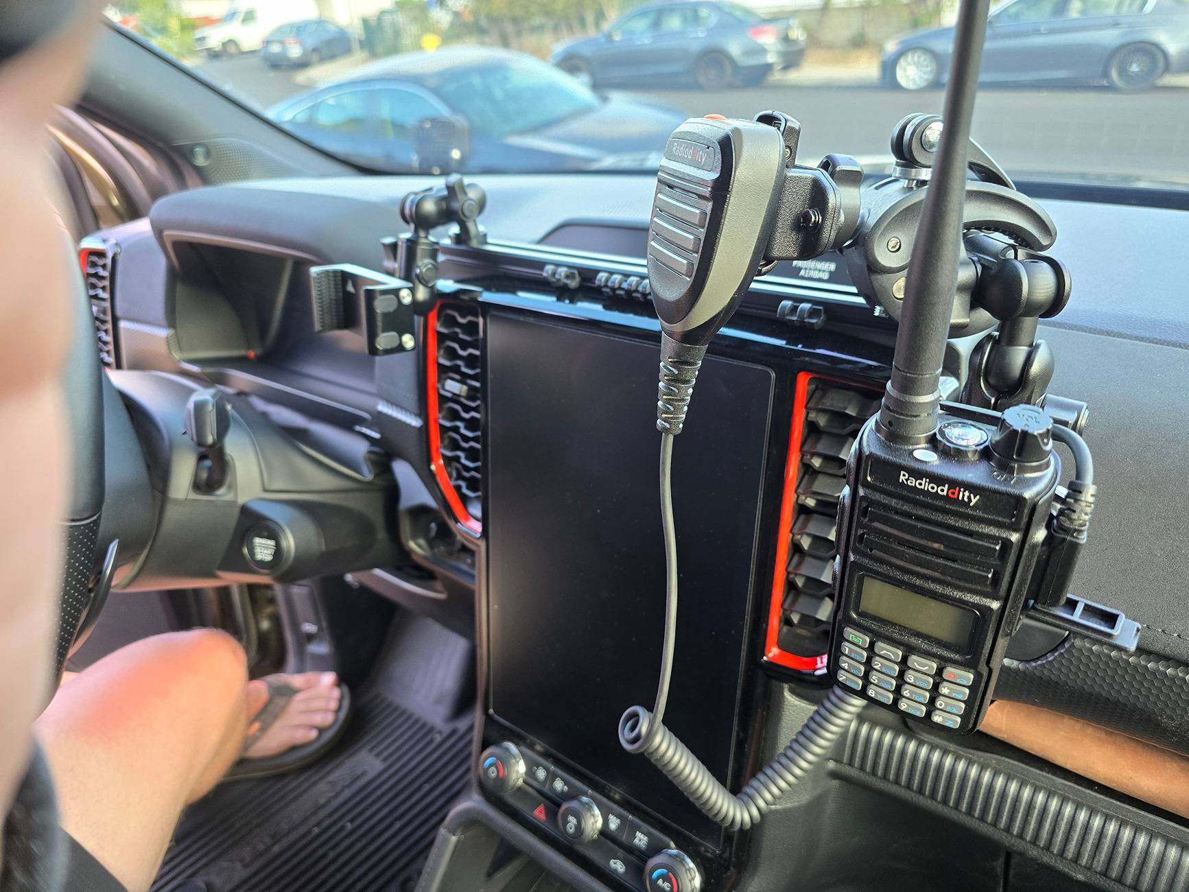

Installed.
1 trim piece to pop off w/ included pry tool; a 1-for-1 swap with the new track piece. Reuses 2 factory screws from the original trim piece, and drills 2 small (1/8", I think; drill bit is included) holes to give it additional strength. Took about 5 minutes.
I wasn't familiar with these RAM ball systems, so I ordered a few extra pieces I didn't end up using. Oh well.
It's really friggin solid, there's no play in any of the components whatsoever.
If you don't want crap across your line of sight, just buy the proper accessory to drop it down where appropriate.

What are those round things holding onto the allen wench?

They're rubber clips for cable organizing - for running power to your phone/tablet/radio, etc.
They happen to fit the allen wrench, and I'm still tweaking where I want everything so I just leave it there for now.
