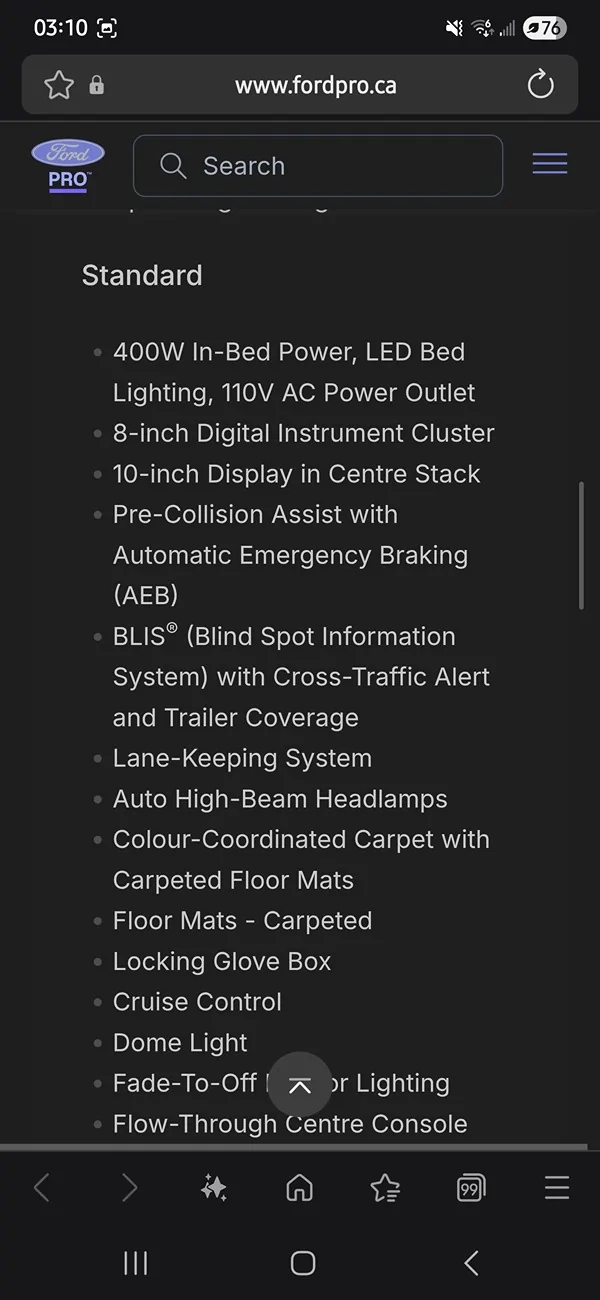

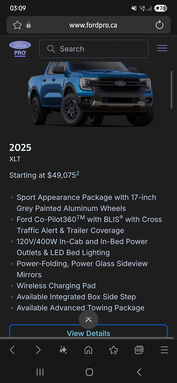

was there an option for them to come on with the cargo lights? My 25 xlt came with them, even without the convenience package, apparently 24 and 25 canadian xlts came standard with them according to ford pro canada.

We’ve (my tech savvy son and I) done about everything in FORScan we can find with no results. My 2026 XLT did not come with a standard 400w power panel and AC outlet, integrated box side step, power folding mirrors, or wireless charging pad. I’m jealous! Our conclusion is the BCM module that communicates with the cargo lights has been deleted.
I need to go back and investigate the two zone and 4 zone aspects you brought up. Thank you for the reply.
