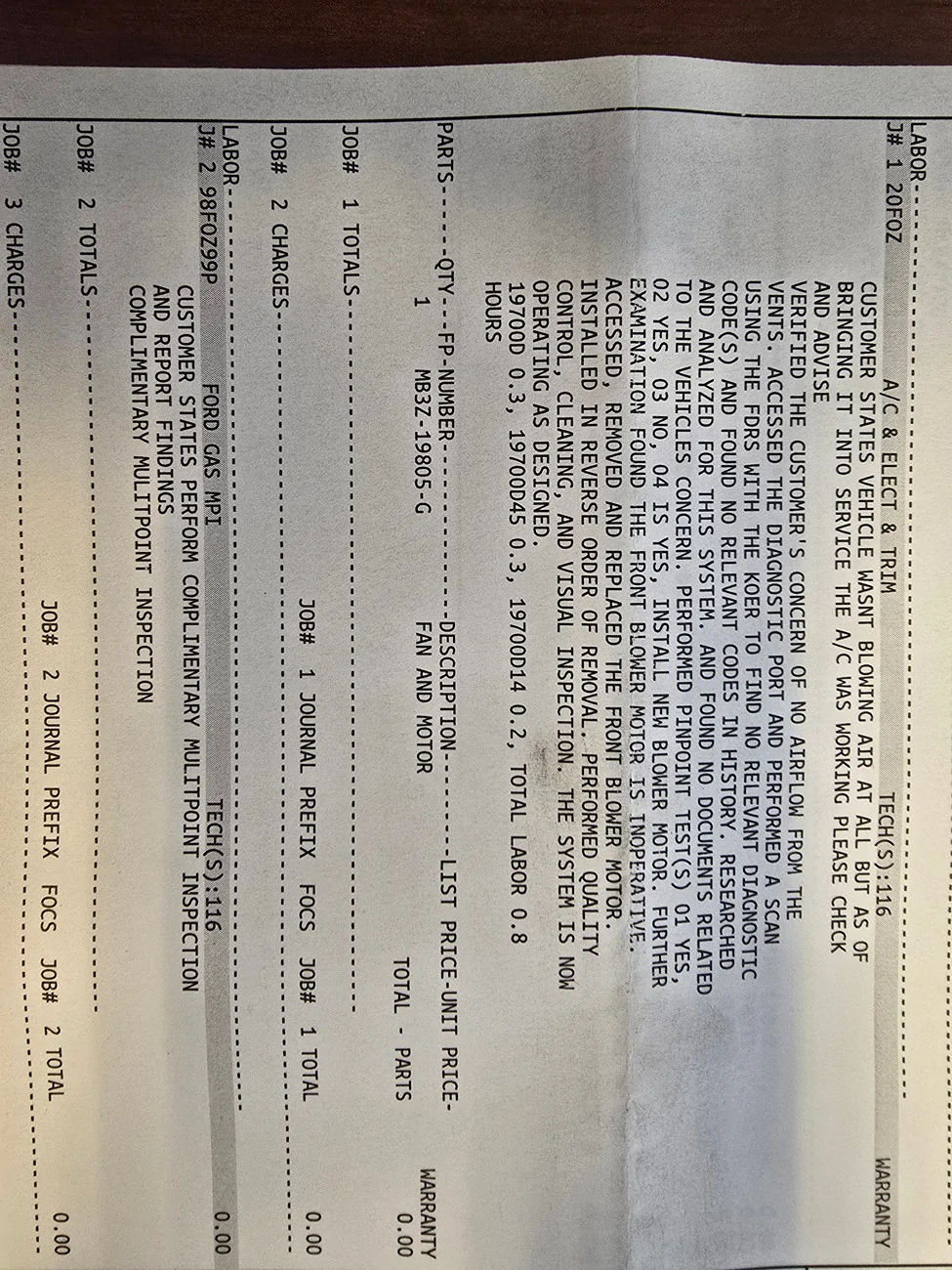

As an update to this, the dealer called and let me know it was a bad blower motor...new part should be in by Wed.
I was prepared for a shitty ordeal since the issue was intermittent and of course the fan started blowing again on my way over to the dealer, but after providing them a couple videos of the issue they were apparently able to figure it out.

I'm always late for this kind of stuff, but the issue was fixed under warranty. Dealer put in a new blower motor (apparently there's more than 1?) and the timeline was basically as advertised once diagnosis was complete. AC works fine now.
If you live in the SD metro area, Aaron Ford of Poway is pretty good. They kept the truck for as long as it took to do due diligence, reproduce the issue, and troubleshoot; the technical writeup I have from them is basically a short story, haha.

Here's the dealer commentary for anyone who cares. I thought the writeup was longer, like a whole page...I might need to dig some more.
Ford Ranger Delayed AC on Startup 20260529_062323
