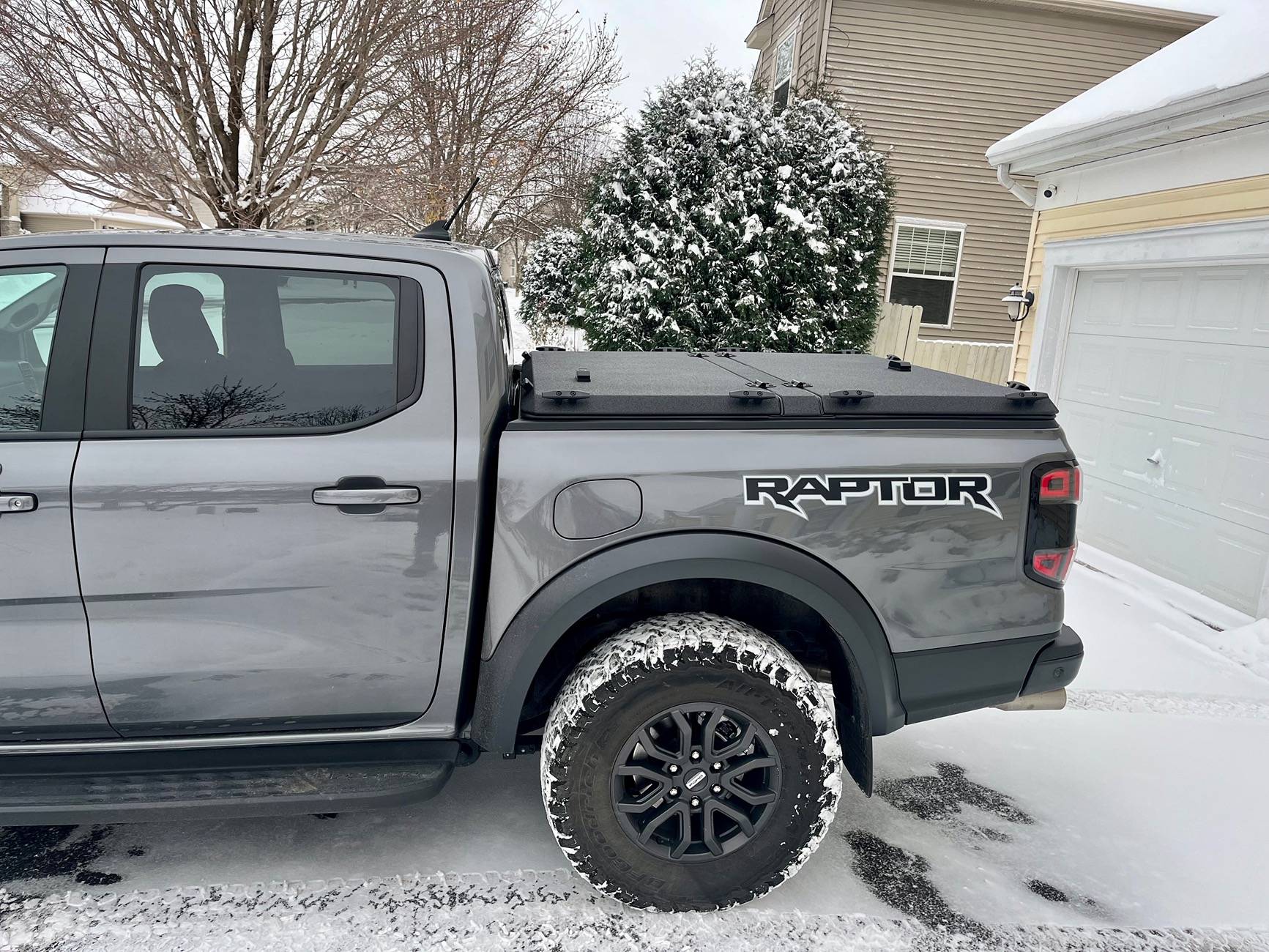

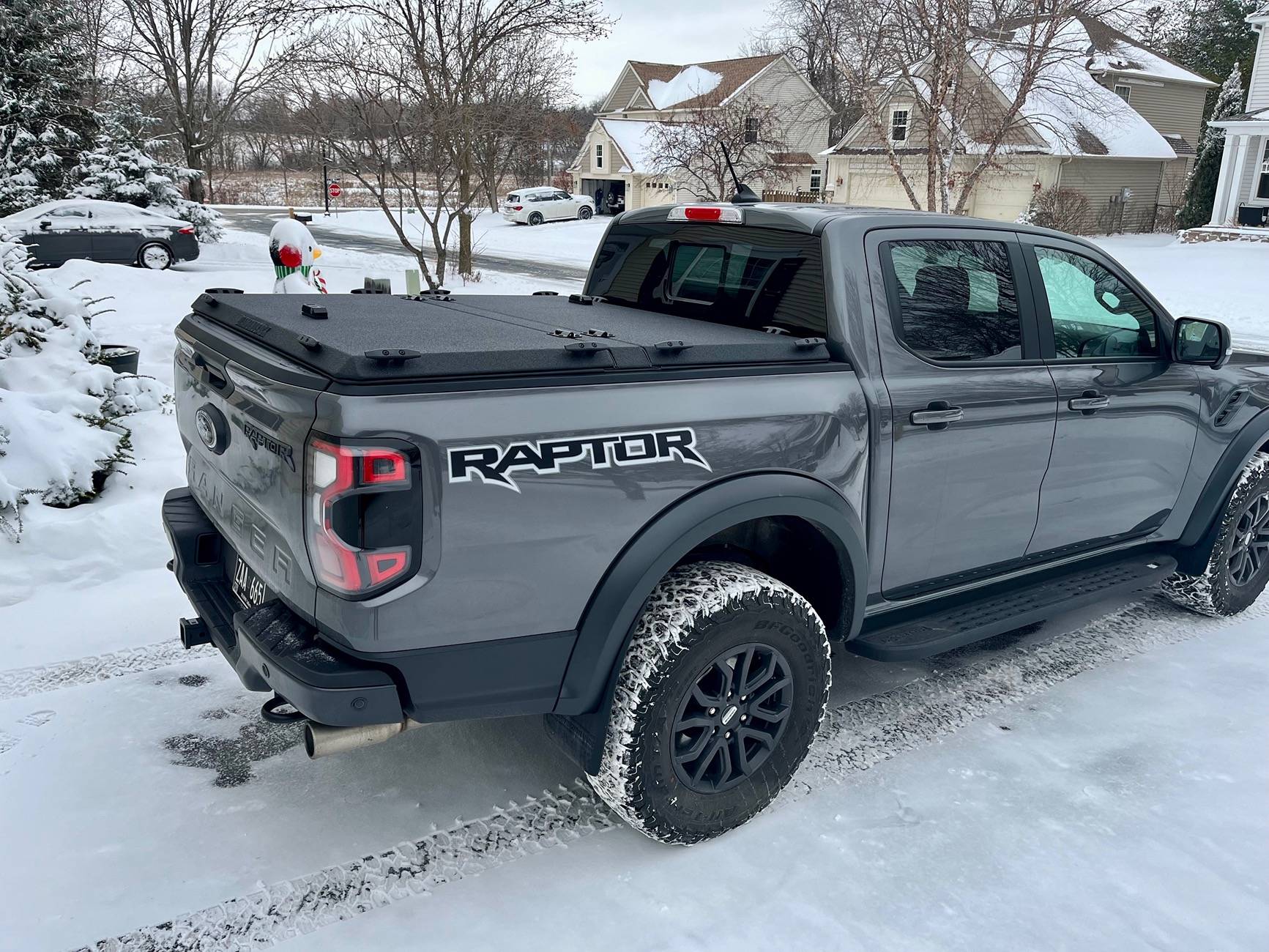

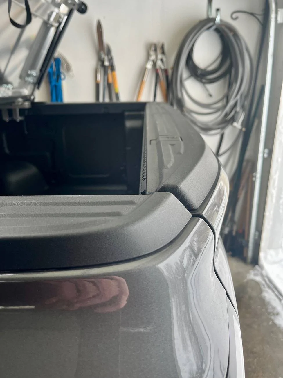

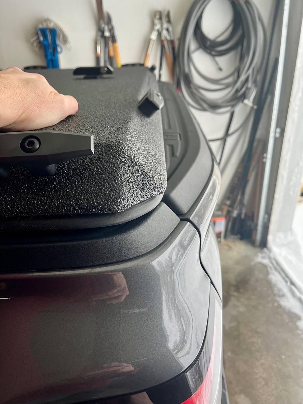

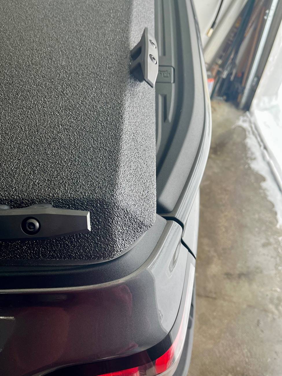

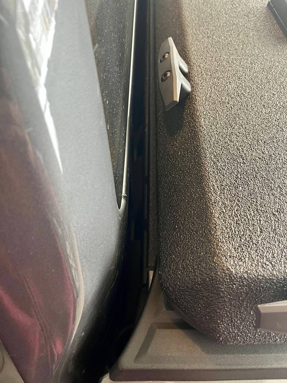

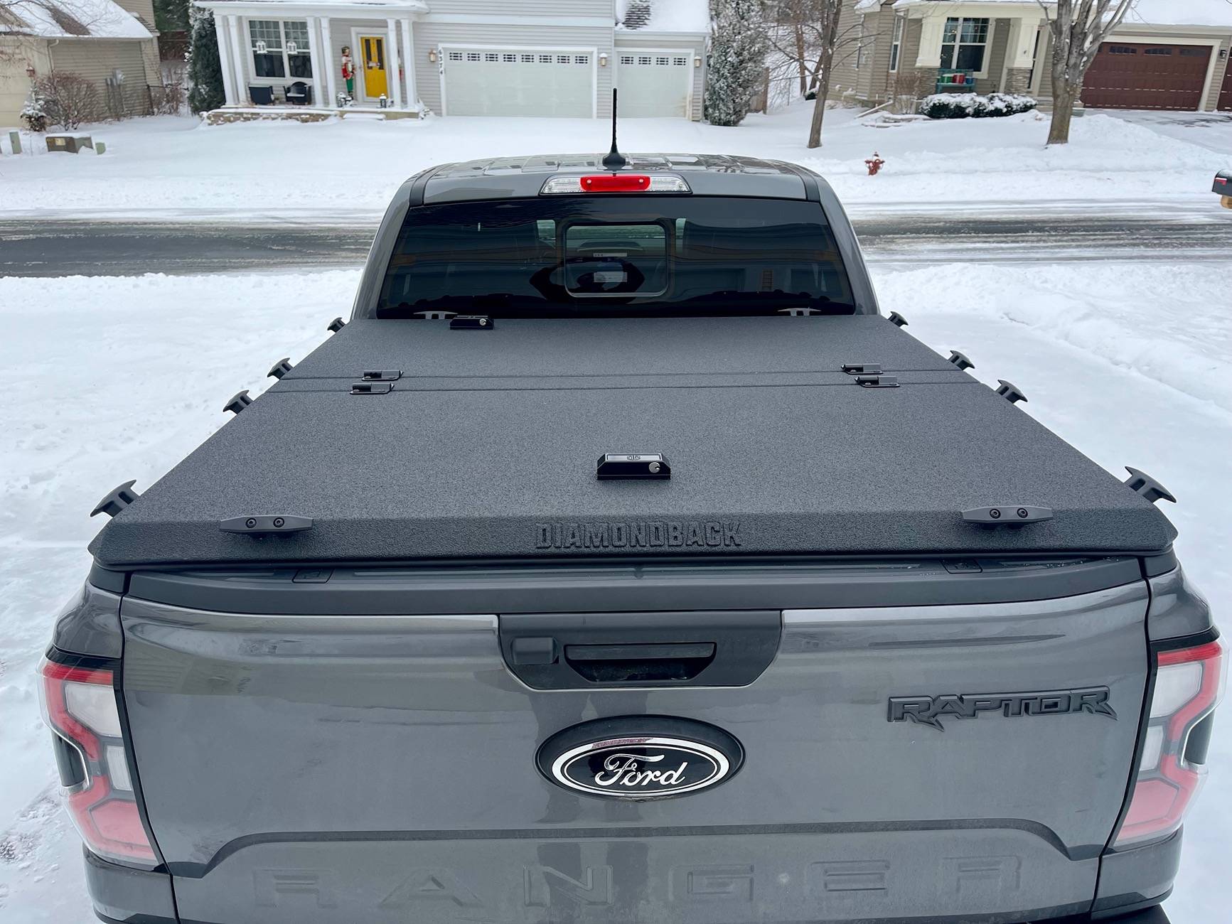

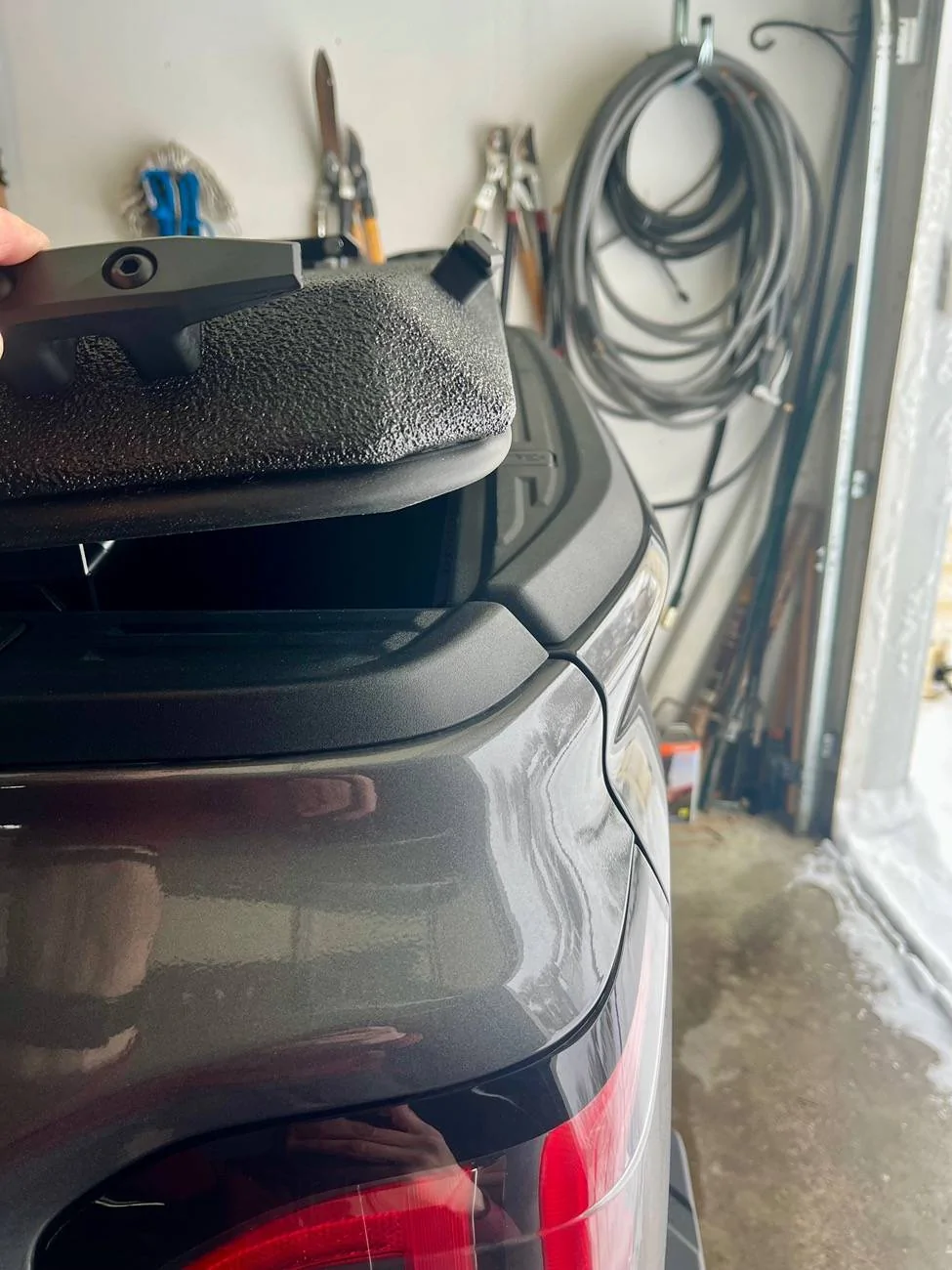

here are some pictures
You can see I put it as far back to the tailgate as I could without it actually lapping over the tail lights, and it still only gets about 1/2” of contact width on the tail gate. I’m fine with that. I’ll just address it at the cab side where I already was debating raising the level with tube metal vs using the rubber. Easy enough. I do like how the cover looks on the truck.

First of all, it looks great! I am very jealous right now. Second, I didn't realize how odd the back of our bed is. It makes complete sense now, I see what you mean. Personally, I wouldn't want it to hang over the tail lights.
I also see those inner cleats, I like them. Mine also came with 4 more in a separate bag as well. Maybe I'll have to install those! I assume the inner cleats do not come in contact with the middle portion or the other panel when up?

Correct, they clear just fine. And should also clear with the UpTop bars... as I plan to put 2 bars on. One across the rear set of cleats of each panel.
I had to call Diamondback to request some additional bed rail edge trim pieces (the little plastic pieces that stick on to allow the rods to move smoothly), and while on the phone talked to them about the cover length. They said they'll look at the instructions and make a correction because the intent is to center it and split the difference between the bulkhead and the tail gate. They said 1/2" bearing is fine and will make a good seal. Overall I'm not worried about it but I will be sealing up that front bulkhead with my own custom solution. From a rigidity standpoint, I just want a solid front bulkhead anyway. And with my solution, I won't have to worry about the length issue.
And while I don't care if it's 100% waterproof, I do want to address the massive holes in the very front under the rails. I might do a little fiberglass molding for those corners and then flexseal it in. I'm curious to see what steps others have taken, because outside the tailgate itself these front corners are the biggest holes in the bed construction and they face forward where water can flow in quite easily.

Good to know about centering the cover, I would have done that for sure. I'd also have to see what you're referring to, regarding where water can come in. I am the same as you, don't care much about water ingress (well, to a point of course) but big enough gaps would be annoying.
