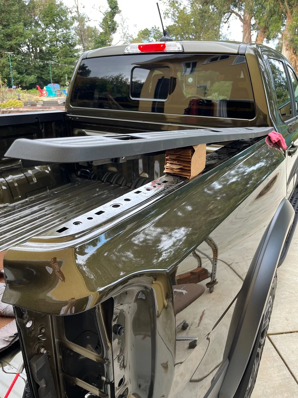

@jacksdad , where you said, "The toughest clips are at the cab side of the bed. A combo of pry tools and flatheads helped work those free.", were you working those clips from under the top cap?
I am thinking about expanding spray foam. I would need to be careful, though, and mask off any exterior surfaces in case I squirt too much.
pry tool between bed rail and bed cap, long flathead underneath bed rail to manipulate “clip”
Ah, of course. that makes sense (now that my brain is functioning on caffeine).

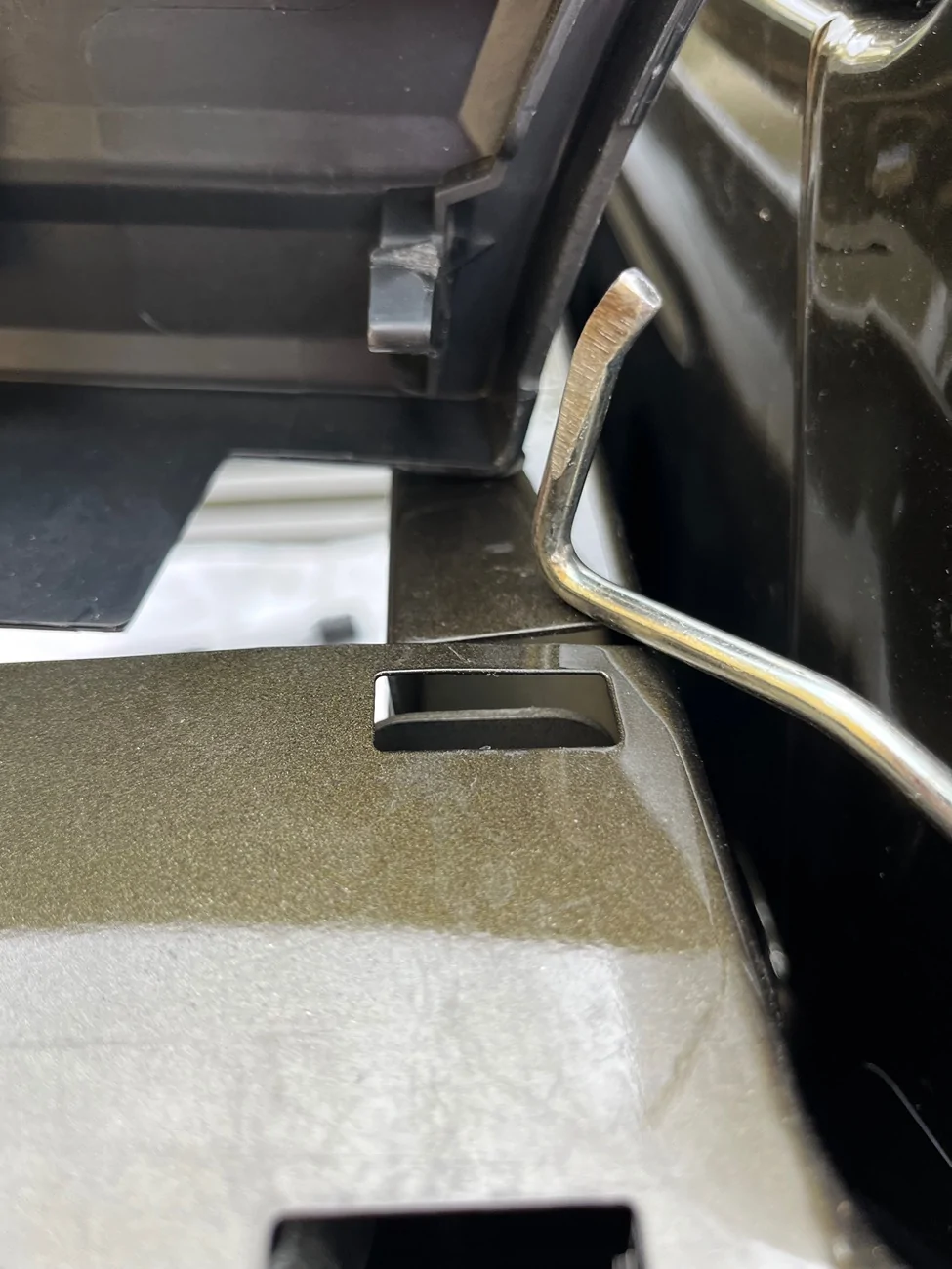

That last freakin’ clip…
Dean Nelson
Dean
Feb 11, 2026
52
SF Bay Area
2025 RR Shelter Green
HA!
I was able to push the backside of that clip through the hole up by the bulkhead, using a “tool“ that I made out of some scrap metal in my garage.
