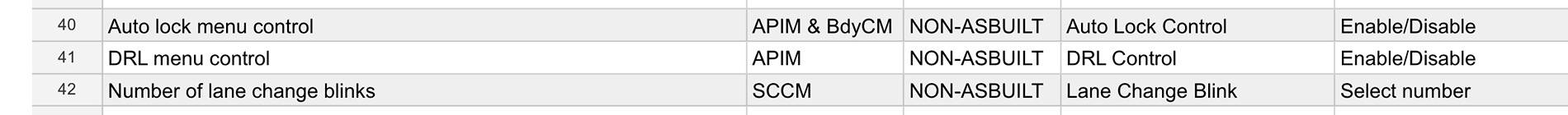

I wanted to include DRL Menu Control within Sync 4.
Prior to starting the mod, the DRL’s were active as soon as the vehicle was started and only dimmed when the dipped beams were switched on.
When the mod was completed, using APIM Non-Asbuilt (Enable/Disable), the menu became available which included a toggle-switch and a note stating that the DRL’s would only come on if the main light switch was set to auto. The toggle-switch within Sync 4 would allow the DRL’s to be switched on/off but only if the main switch was left in the auto position.
I decided that this configuration wasn’t for me and reverted the changes to what they were prior to starting.
Once completed, I noted that the DRL’s would not default to on with the engine running, however with the main switch set in the auto position, they would.
As mentioned above, prior to starting the mod, the DRL’s would default to on regardless of the main switch position.

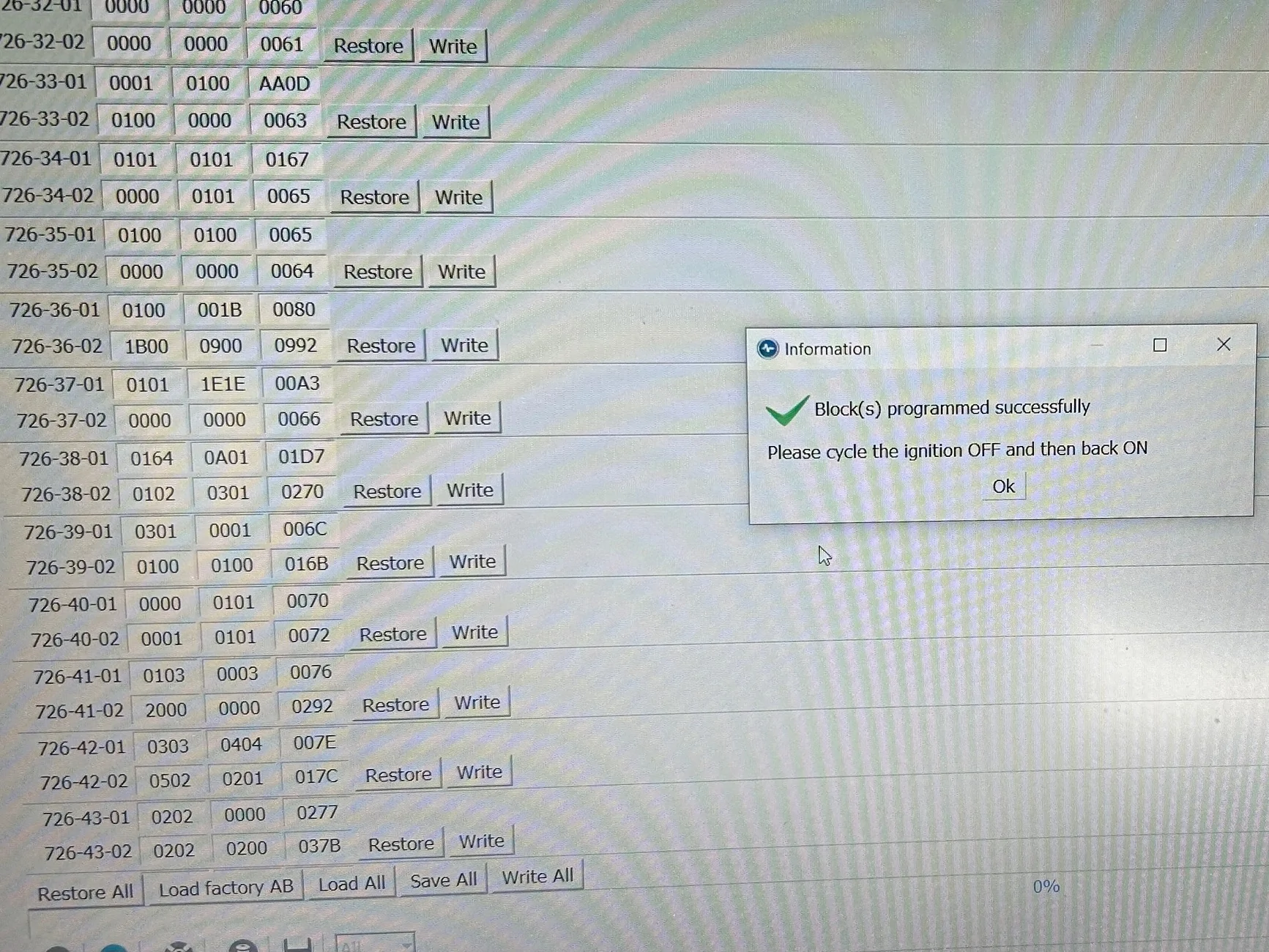

I’ve since sorted the issue by re-installing the AsBuilt data and returning the DRL’s to default on.
Maybe I’ll add the DRL Control Menu at a later date.

Which module did you restore? I’m currently facing the same issue after messing around with Forscan LOL. I hope I don’t have to reset all modules.
