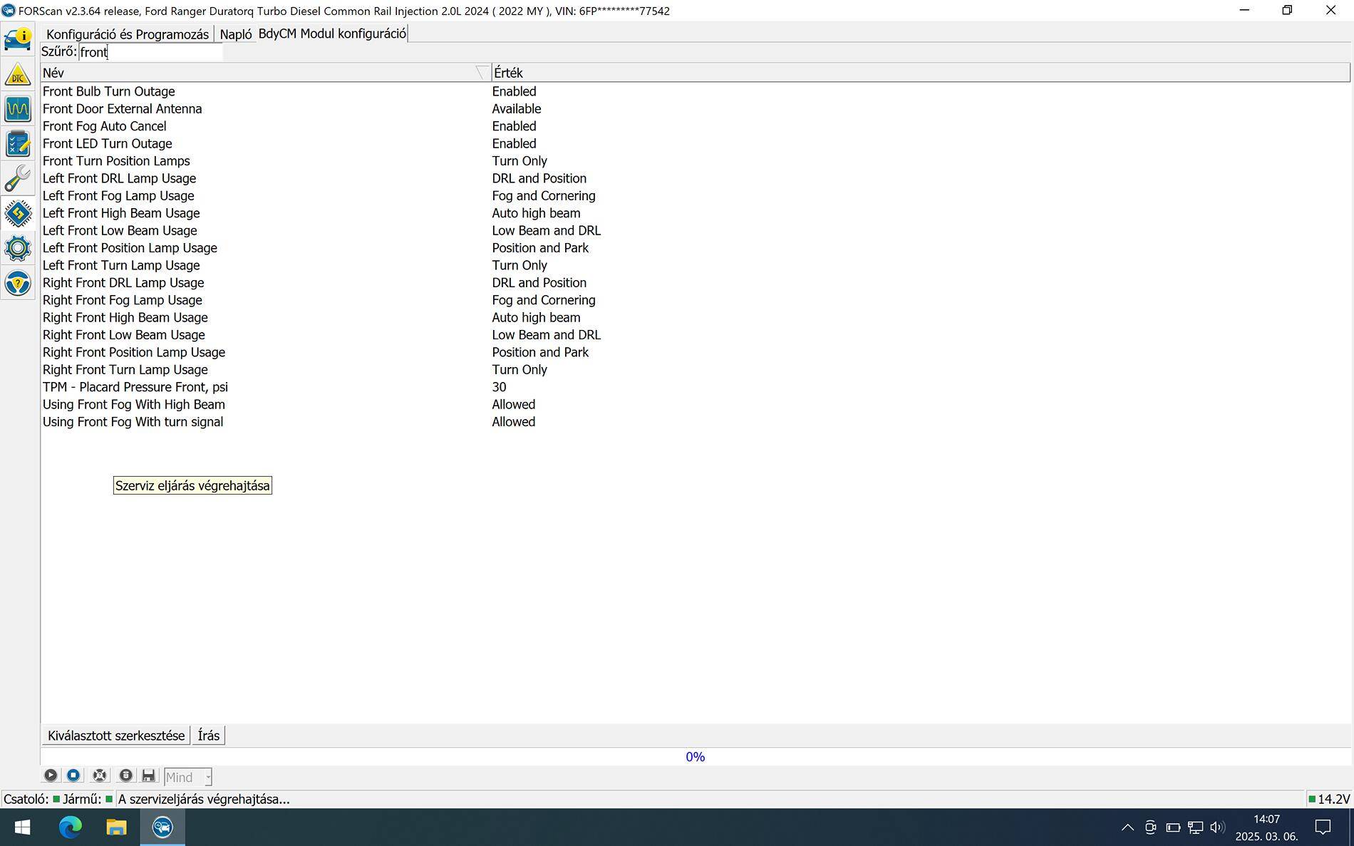

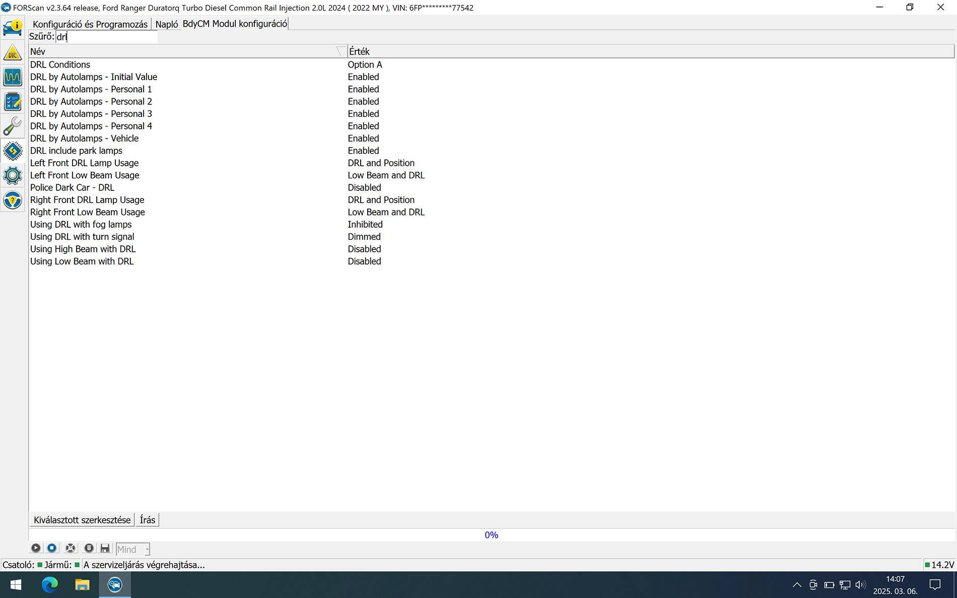

Hey guys!
I was just playing with DRL settings, and now im totally confused. Can't turn on DRL, in any ways. Is there any default settings for the headlights?
Headlamps are normal LED, not the performance model.
Of course i didn't make a backup from factoy settings.
Any idea, how to get back the lights?
Thanks!

If you're willing to lose any other Forscan changes you made, you can find the original As Built file from Ford and restore it back to the way it came from the factory.
Ford As Built files
Thank you! It worked!
