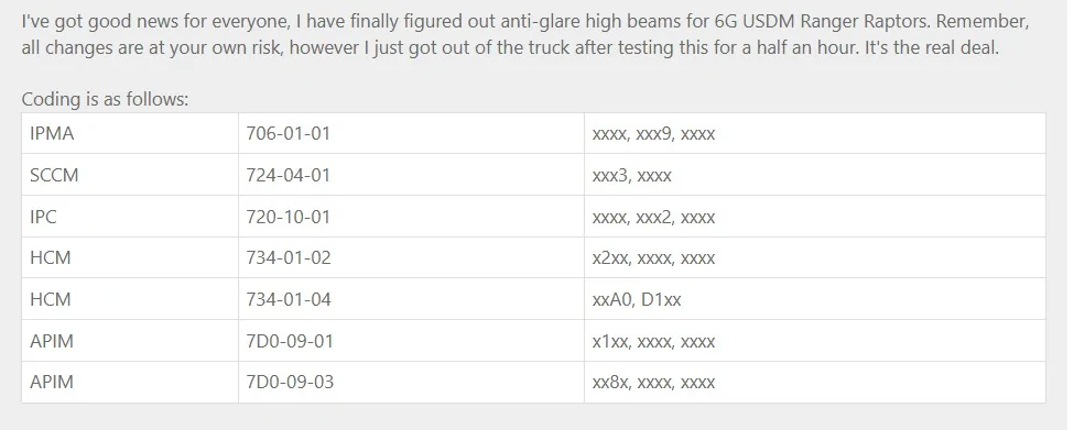

Hello, if anyone has a spreadsheet for right hand drive anti-glare lights please let me know the numbers. The photo seems to be for left hand drive.

Take a better picture of the headlights on your truck. There is a very good chance your truck is not capable of Matrix functionality.
In short, in every other market except for USA matrix functionality will be enabled by default if the truck is capable. The USA is behind on lighting standards.

Thank you very .
I managed to solve the problem myself, and now the matrix headlights work on the Thai model.
