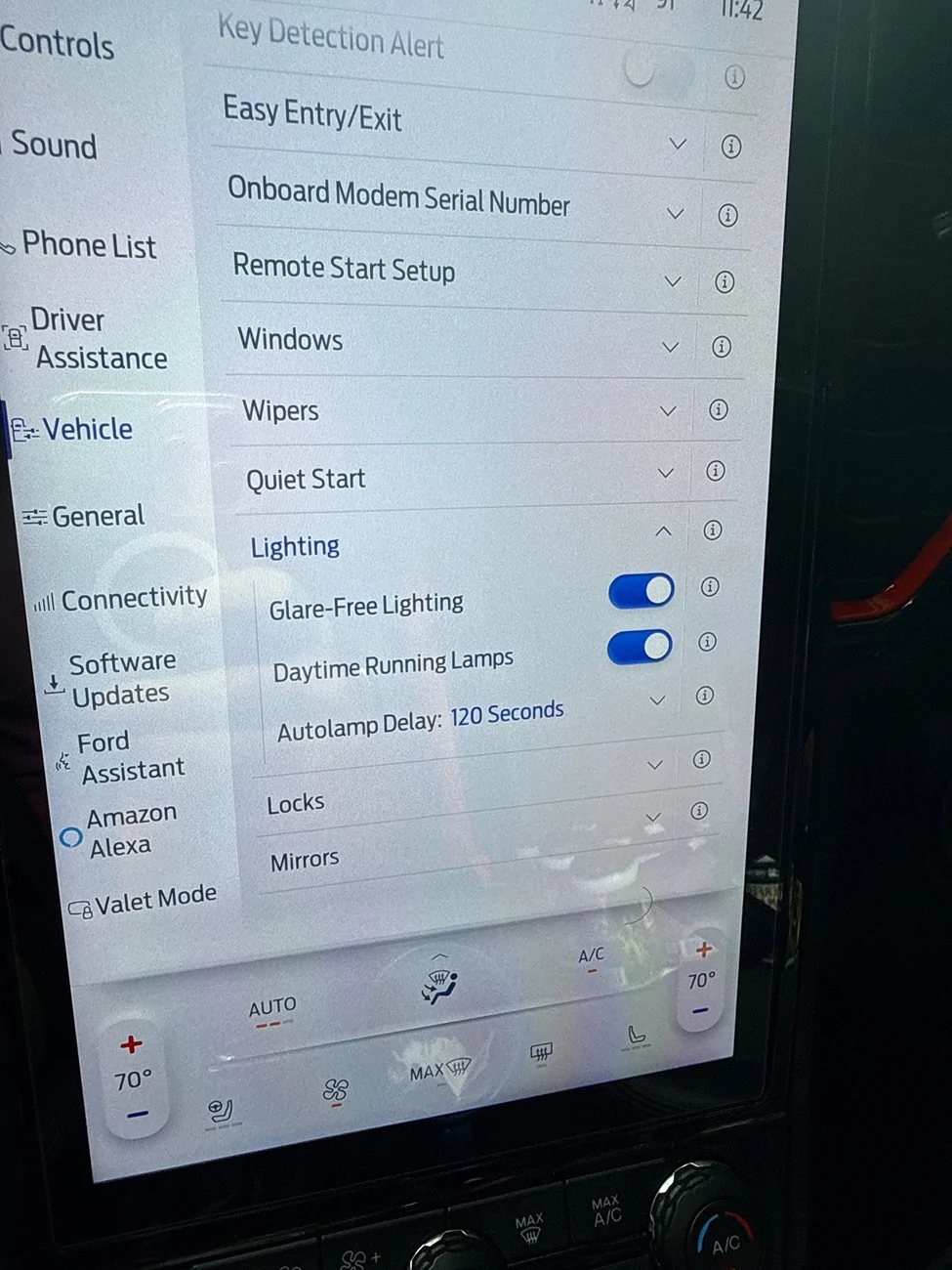

also don’t really remember what my lighting menu looked like before the FORScan changes. I tried enabling Welcome Lighting but never got it to work. Might play around with it again this weekend
I have a 25 RR and was able to get the glare free headlights working. I can’t find the link but I found it on a Forscan page on a F150 forum. Then in the vehicle menu under lighting they’ll be a listing for it and you just turn it on. It’s a very nice feature.

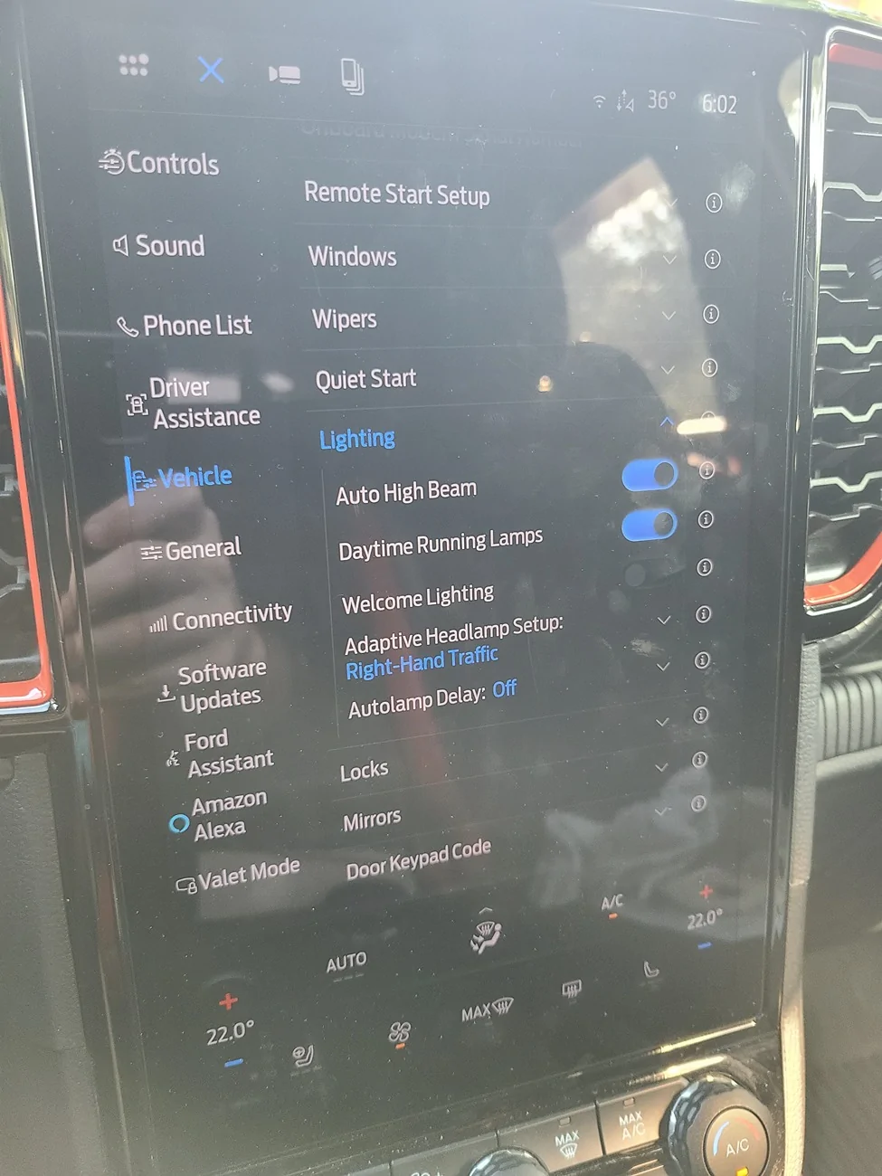

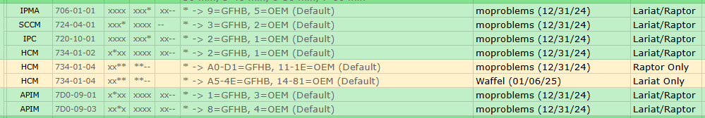

We hadn't cracked the code yet when I did all my FORscan stuff, so this is what I have. Is yours a Lariat or something? I've got two more settings than you.

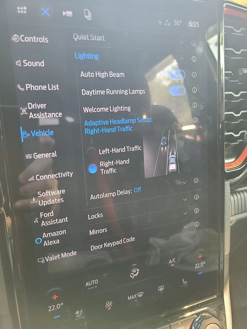

The setting I was talking about earlier is in this second pic.
Interesting mine just has a tab for on or off. No choice of left or right.

Your coding looks spot on to me. I made the exact same changes on my '25 Raptor and got them to function. I would suggest triple checking your work and possibly resetting those modules to ASBUILT before trying again.
Will triple check today and let you know!
Thanks for this. Looks like I'll be playing with Forscan again soon.

25 raptor, I rebooted all modules and now have all the toggles in sync. After I rebooted, took truck for a spin and everything popped up. Before i had no left/right toggle.
I wonder where I went wrong, I don’t get a left v right toggle.
Rebooted the modules where you changed the codes?

Problem solved! Though the option to choose left or right hand traffic never showed up but whatever. I was missing the second APIM line. Thanks to everyone that chimed in
