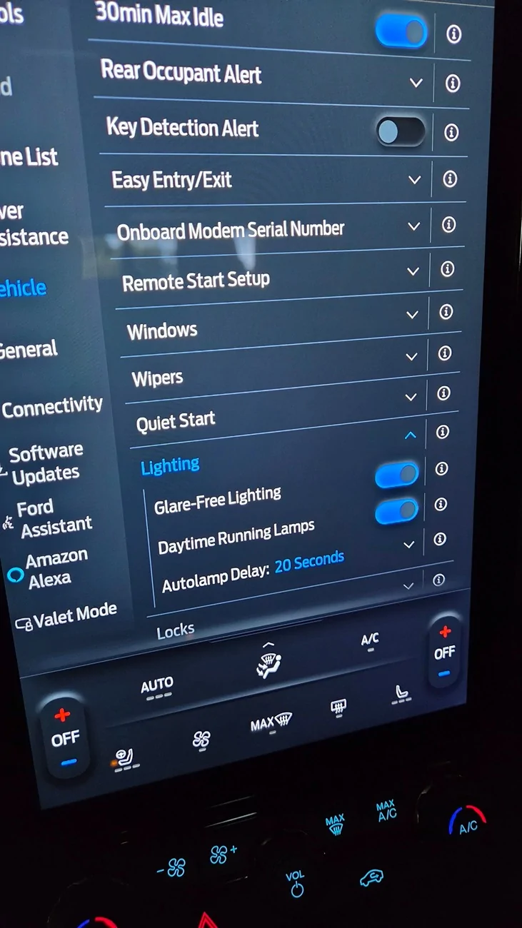

I just enabled mine last night but have yet to test them out.
No errors that I can see.

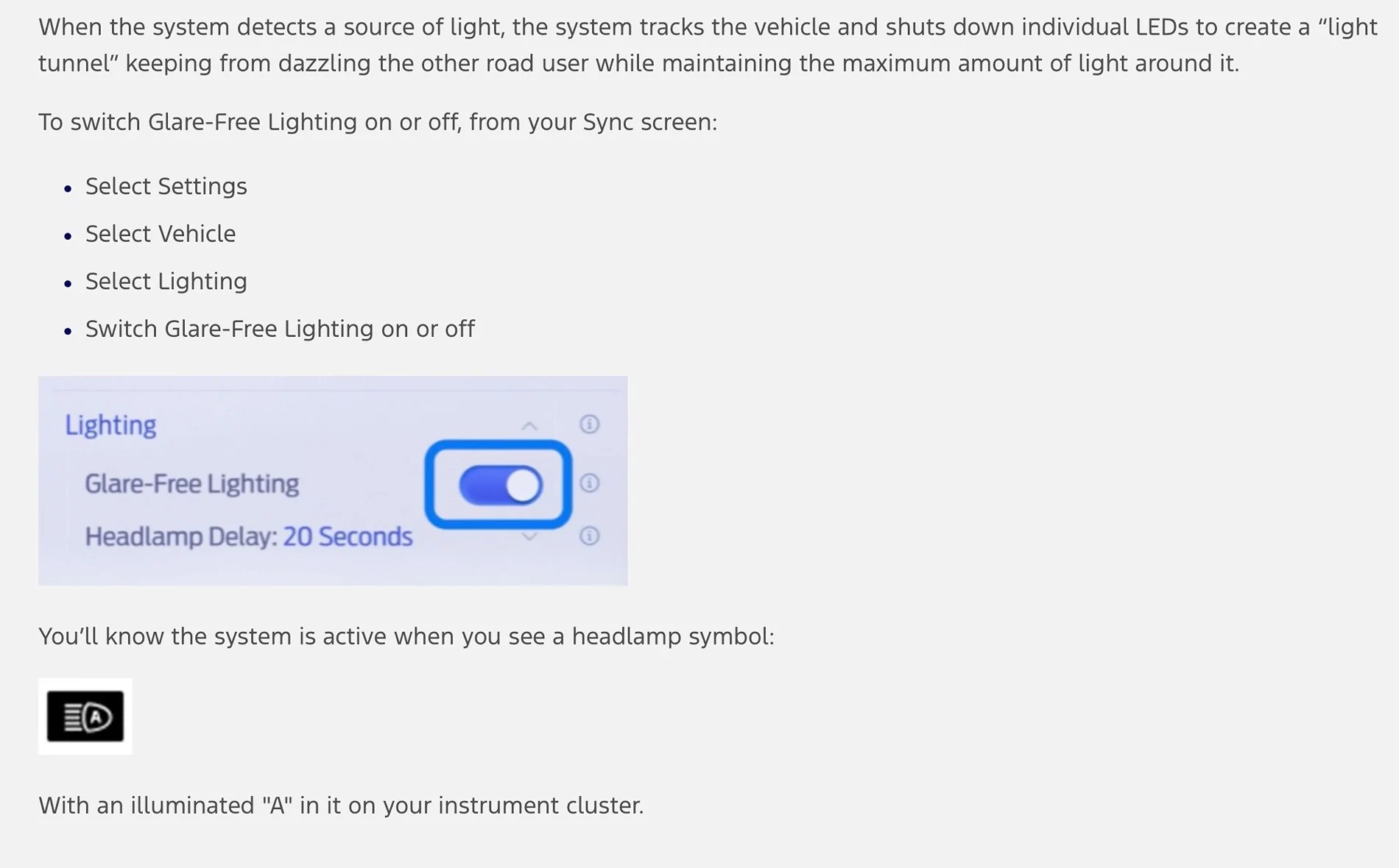

Here are a couple Ford AU pages on Glare Free for Ranger and Everest.
From Everest page:
When the system detects a source of light, the system tracks the vehicle and shuts down individual LEDs to create a “light tunnel” keeping from dazzling the other road user while maintaining the maximum amount of light around it.
To switch Glare-Free Lighting on or off, from your Sync screen:
  • Select Settings
  • Select Vehicle
  • Select Lighting
  • Switch Glare-Free Lighting on or off
You’ll know the system is active when you see a headlamp symbol:
With an illuminated "A" in it on your instrument cluster.
There might be some situations where you want to override the glare-free high beam. To do that, simply push the lever away from you to activate full high beam, pull the lever towards you to switch them off, and push the lever away from you a third time to switch glare-free lighting back on.
