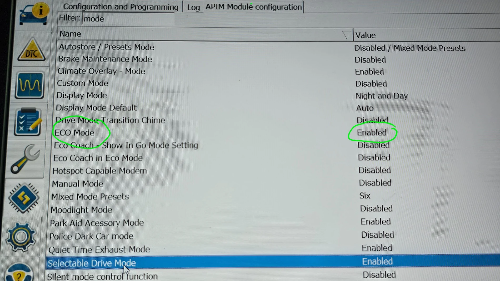

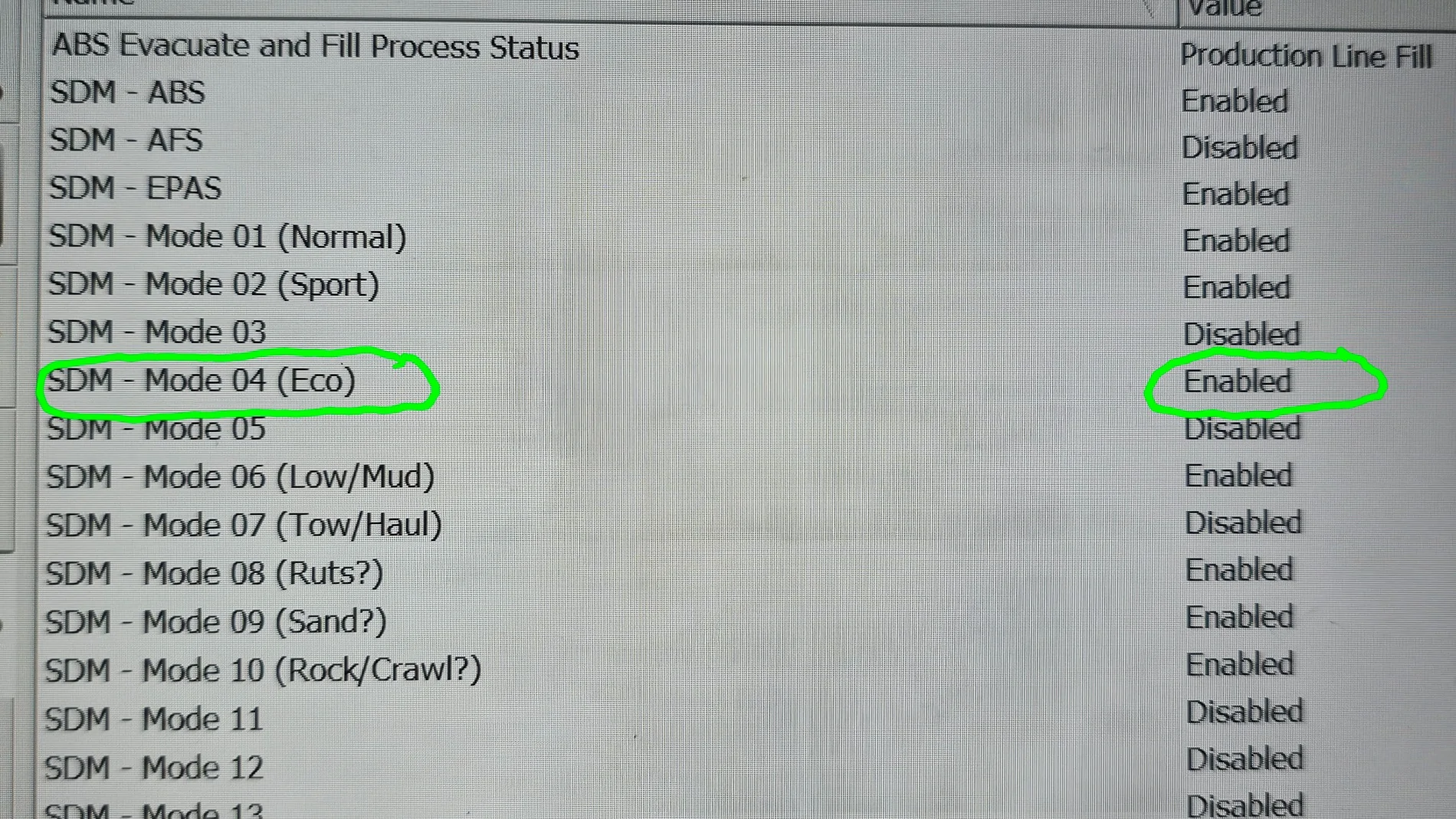

Please check to make sure ECO mode is enabled in the ABS screen and APIM screen. Under service options in Forscan is where you can select reboot modules.
Ford Ranger Drive Modes mod via Forscan APIM Drive Modes Enabled(1)
Ford Ranger Drive Modes mod via Forscan ABS eco enabled(1)

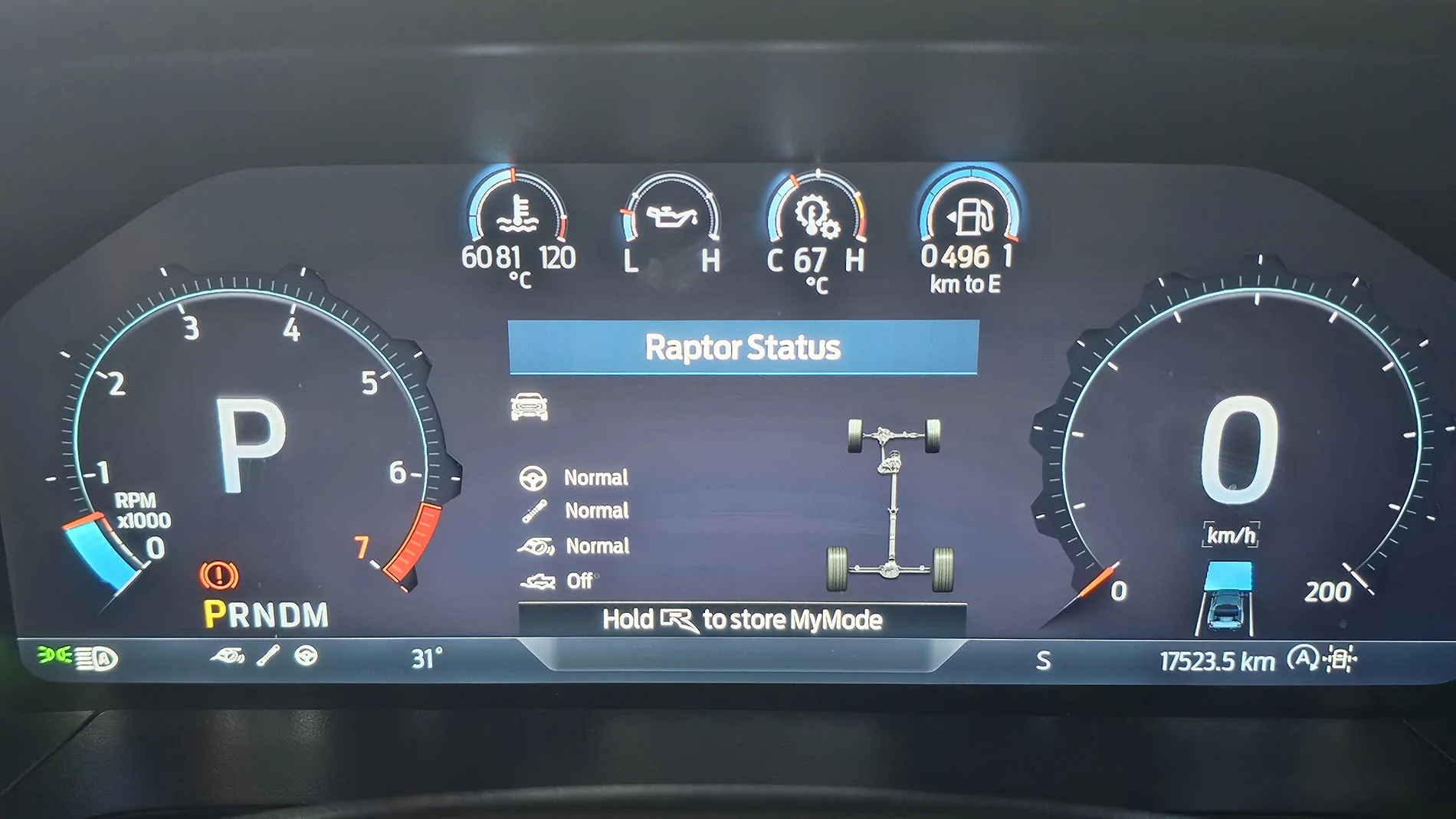

Yes, it does and I use it sometimes. There is a noticeable difference in power drop. I use it for long range driving. Trust me. It's there and it works. Your RR has the latest newest version of sync. That is why your screen looks different than mine. My model is a 2022. I never upgraded to that new version and I don't plan to. However, a friend of mine upgraded his and he lost that screen and got the screen like yours with just the three modes available. However, one of the three modes on his screen is eco mode. Check my reply to you and recheck using the screenshots I attached. Here is what the Raptor status looks like when it's in eco mode. You cannot access it using the dial! It is only available through the touch screen.
Yes, both have been enabled and double checked. Understand now that I have the latest version of SYNC 4 and that is likely the reason behind the center info-screen not allowing the modes to present themselves correctly... go figure! One more thing I will try... looks like there is limited room for mode icons to appear (horizontally), I wonder if I disabled Tow/Haul that this space might get populated by another available mode. Prolly worth a try anyway, since I love tinkering in FORScan. It's like repairing someone's PC that got infected, I always say at the end "I beat you, you POS". I see FORScan as a backdoor, allowing us to hack the system Ford is trying to prevent most everyone from changing, to meet their needs and/or get rid of annoyances at the same time.

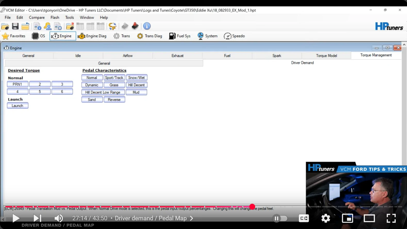

Here's my thoughts on this. Worth nothing though. I think there is a finite number of spots in the PCM for modes. XLT and Lariats probably don't have one or two of the modes that the Raptor has. Like rock crawl on Raptor vs Eco on Lariat and XLT. Winfield at Goosetuned could probably look and tell how many spots are there. I watched some of HPtuners MPVI3 videos. This is a screenshot from a generic HPtuner video.
