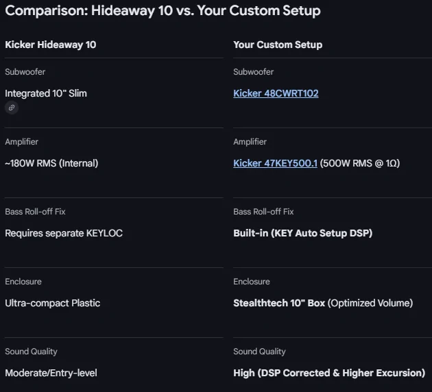

My virtual audio advice guy agrees with me (Gemini) :
Ford Ranger Disabling bass roll-off via Forscan? 1774362734084-s1

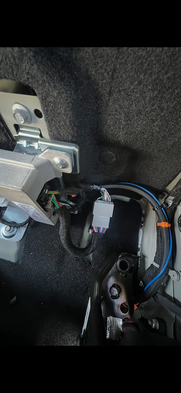

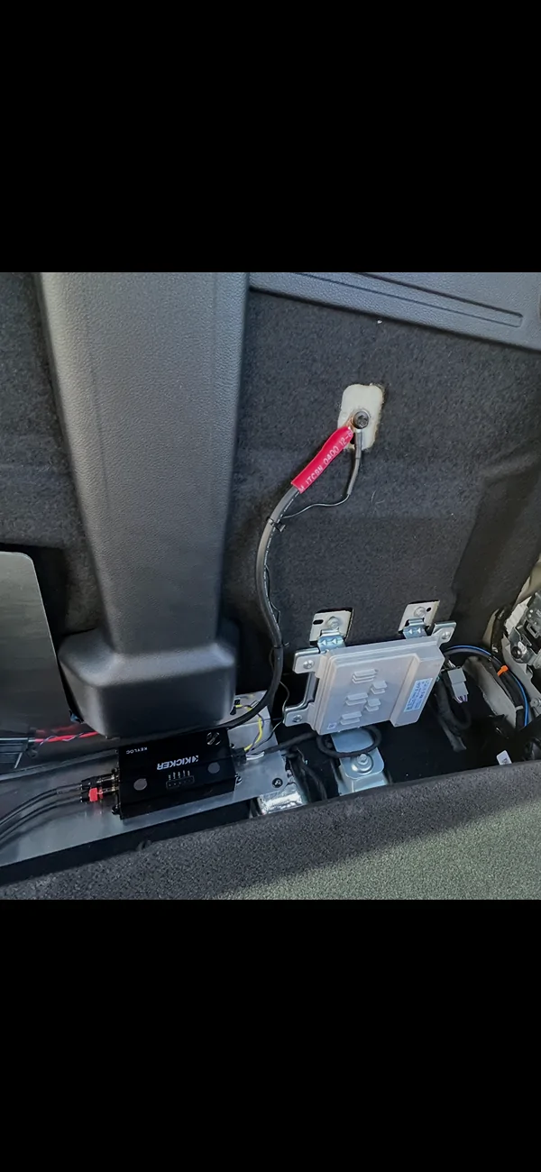

If you already have the investment in the Hideaway sub then definitely the Keyloc is the way to go. Sounds Good Stereo sells a kit that includes their in house fabricated jumper harness that keeps you from having to do an ounce of splicing into your Ford harness at the factory amp. It’s LITERALLY plug & play. The Keyloc even comes dialed in for the Rangers interior and requires zero programming or fiddling with when you use their kit.
I’d say it’s worth every penny and did wonders for the bass roll off.
Basic pics of my setup except that I’m running a dedicated Fosgate Punch 300.1 to a Hertz 10” shallow mount in the rear passenger tub. But here’s the parts that’ll interest your style of install. The gray harness at the amp is the jumper from SGS that comes in their kit. Plug & Play!
Ford Ranger Disabling bass roll-off via Forscan? IMG_2610
